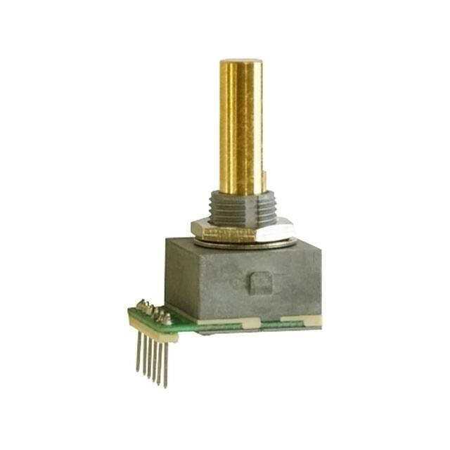

    16MM MANUAL ENCODER, SINGLE SHAF
REC16K25-201 数据手册
MANUAL SETTING TYPE OPTICAL ENCODERS REC16K/REC16L/REC16M ■ FEATURES RoHS compliant O16mm square compact size OExcellent click & switch feelings OLong life of 2 million cycles ■ PART NUMBER DESIGNATION REC16 K 25 - 201 Series name Output interface REC:With click 1:Voltage 5:Open collector Push switch function and shaft Output M:Single shaft without push switch K :Single shaft with push switch L :Double shaft with push switch 2:“A” & “B” Resolution (P/R) 25 ■ LIST OF PART NUMBERS Resolution Click Push switch function Shaft No Single Shaft 25 (P/R) Output interface Voltage (PIN HEADER Type) Part number REC16M25-201 REC16K25-201 With Click Yes Double Shaft The products indicated by A mark are manufactured upon receipt of order basis. Open Collector (SCOKET Type) A REC16K25-205-B A REC16L25-205-B REC16K/REC16L/REC16M OPTICAL ENCODERS ■ STANDARD SPECIFICATIONS OElectrical characteristics OMechanical characteristics Click torque 7.35 mN·m ± 2.5 maximum (75 ± 25 gf·cm) 〈REC:With click〉 Click number 25 DC5 ± 5 % Input voltage 30 mA maximum Input current Square wave Output wave form A, B Output phases (P/R) Shaft loading (Pull-push) 25 Resolution Switch operation force 90° ± 45° Phase difference of outputs A & B “1 (High)” + 4.5 V minimum “0 (Low)” + 0.5 V maximum Output signal Rotational life (Mechanical) 2 million cycles Switching life 1 million cycles Shaft loading (When mounting) LED Light source Radial 4.90 N maximum (500 gf) Axial 2.94 N maximum (300 gf) Net weight OSwitch characteristics Strength of tighten screw Maximum contact rating 2.45 ± 1.47 N (250 ± 150 gf) 0.3 ± 0.2 mm Switch stroke 100 Hz Maximum frequency response 19.6 N maximum (2 kgf) Approx. 12 g 1 N·m {10.2 kgf·cm} maximum DC15 V, 20 mA 2 Ω maximum Contact resistance (Initial value) OEnvironmental characteristics Note) Manual setting only. Operating temp. range Storage temp. range Protection grade 0 ~ 50 °C – 20 ~ 80 °C IP40 ■ OUTPUT Click spot for 25P/R Output “A” Output “B” Click spot a b c The click spot is located somewhere outputs A & B are at Lo level. d CW a, b, c, d ≧ 100 s REC16K/REC16L/REC16M OPTICAL ENCODERS ■ RELIABILITY TEST The output shall satisfy the criteria below after the following tests. Test item Test conditions Vibration Power OFF Amplitude : 1.52 mm or 98.1 m/s2 (10 G) whichever is smaller. 10 ~ 500 Hz excursion 15 min/cycle, 8 cycles each for X, Z, directions. Shock Power OFF 3 times each in directions (X, Z) at 490 m/s2 (50 G), 11 ms. High temperature exposure Power OFF 80 °C 96 h Power ON 50 °C 96 h Low temperature exposure Power OFF − 20 °C 96 h Power ON 0 °C 96 h Humidity Power OFF 40 °C Relative humidity 90 ∼ 95 % 96 h (To be measured after wiping out moisture and leaving samples for 1 h at normal temperature and humidity after the test.) Thermal shock Power OFF To be done 10 cycles with the following condition (To be measured after leaving samples for 1 h at normal temperature and humidity after the test.) (To be measured after leaving samples for 1 h at normal temperature and humidity after the test.) 80 °C 0.5 h、− 20 °C 0.5 h ■ OUTLINE DIMENSIONS Unless otherwise specified, tolerance: ± 0.4 M9P = 0.5 OSingle shaft and PIN HEADER 16 〈 Accessories 〉 10.5 MAX 23 2 - 0.5 14 6.5 3 4 φ 6 ± 0.5 M9 P = 0.75 16 ( 11.43 ) 4 5.5 ± 0.1 φ 0.5 1 2. Washer ±0 4.9 6 - □0.5 φ 9.4 φ 12.9 2 12 1. Nut 6 5 4 3 2 1 PIN 5 - 2.54 (Unit: mm) .1 ±0 .1 .2 φ9 9.2 PIN HEADER : Made by IRISO ELECTRONICS CO., LTD 9208B - 1 - 6Z032 - PT1 ( 7.6 ) ( 9.4 ) Panel Cut-out Dimensions 8.2 ±0.1 ( 16.6 ) Panel Cut-out Dimensions (Locking type) ■ OUTPUT CIRCUITRY AND RECEIVING CIRCUITRY ■ PIN ASSIGNMENT Vcc (5V) Pin No. Without switch With switch 1 Power 0 (V) Power 0 (V) 2 NC For switch 3 NC For switch 4 Output “B” Output “B” 5 Output “A” Output “A” 6 Power ĸ 5V Power ĸ 5V 4.7kΩ Output "A", "B" GND (OV) Switch Switch Output Circuitry Receiving Circuitry Transistor:RN1707JE eqivalent Schmitt IC:TC7W14FK eqivalent REC16K/REC16L/REC16M OPTICAL ENCODERS ■ OUTLINE DIMENSIONS Unless otherwise specified, tolerance: ± 0.4 ● Single shaft and  SOCKET (Unit: mm) 〈Accessories〉  ( 17.4 ) 2- 0.5 6.35 10.5 MAX 6.5 6 5 4 3 2 1 2.54 M9 P = 0.75 11 1. Nut ( 3.6 ) ( 6.9 ) φ 12.9 2. Washer 0.8 ±0.05 6 90 ˚ φ1 3.05 ±0.08 3.16 ±0.25 Locking Ring .1 ±0 .2 φ9 2.4 ±0.1 5.6 ±0.1 ( 11.43 ) 4 M9P = 0.75 11.1+0.25 0 φ 3.18 10.5 MAX 6.35 ( 3.6 ) φ 11.2 ±0.05 φ 6.35 6.5 SOCKET (SAMTEC) CES-106-01-S-S ±0.05 6.35 4 2 -3 2 - 0.5 ( 17.4 ) 16 4.9 2.54 0.5 1 〈Option〉 ( 9.5 ) 6 5 4 3 2 1 φ 9.4 ( 7.5 ) ● Double shaft and SOCKET 16 2 5.6 ±0.1 ( 11.43 ) M9P = 0.75 4.9 4 16 4 2- 3 φ 6.35 SOCKET (SAMTEC) CES-106-01-S-S ±0.05 16 ( 6.9 ) .1 ±0 .3 φ3 ( 7.5 ) Panel Cut-out Dimensions ■ OUTPUT CIRCUITRY AND RECEIVING CIRCUITRY Vcc (5V) ■ PIN ASSIGNMENT 2.2kΩ Pin No. Function 1 Power 0 (V) 2 For switch 3 For switch 4 Output “B” 5 Output “A” 6 Power +5 V Output "A", "B" GND (OV) Switch Switch Output Circuitry Receiving Circuitry Transistor:RN1707JE eqivalent Schmitt IC:TC7W14FK eqivalent REC16K/REC16L/REC16M OPTICAL ENCODERS ■ OptionĦQl_n+glFmjbcpħ ● Available mounting on PC board with Snap-in Holder as an optional item separately. 15.2 10 2- 0.5 3. 2 6 3 2 12 6 3.5 4- 1.8 12 16.2 ±0. 1 3 ●With Snap-in Holder 10 4- 1.8 6-□0.5 0.3 11.4 6 2 6 0.3 2 5.8 5 6 PIN No. 16 11.4 2.3 1.5 1 2 3 4 5- 2.54 5- 2.54 6- φ 0.8 Mou nting hole dimentions ( Tolerance : ±0. 1 ) ( Thickness : t = 1. 6 )
