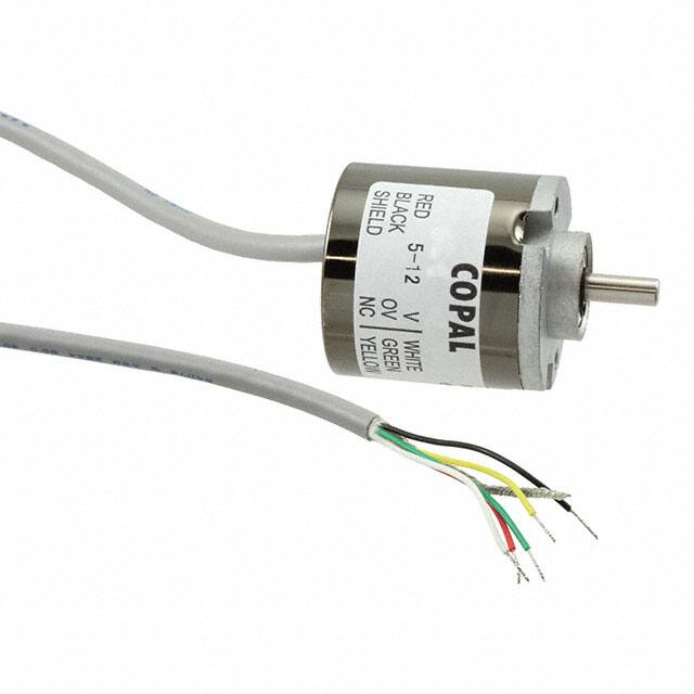

RE30E OPTICAL ENCODERS ■ FEATURES RoHS compliant OWith temp. compensation circuit OWith zero index signal OPower supply voltage is for 5 ~ 12 V, 24V OEconomy type ORoHS compliant ■ PART NUMBER DESIGNATION RE30E - 100 - 2 1 3 - 1 Series name Output connection 1:Cable wire Input voltage Resolution (P/R) 100, 200, 300, 360, 400, 500, 600, 800, 900, 1000, 1024 3:5 ~ 12 V 8:24 V 4:5 ~ 12 V Open collector A:24 V Open collector Output phase Output phase “Z” 2:“A” & “B” 1:Provided ■ LIST OF PART NUMBERS Item Resolution Input voltage 5 ~ 12 V 5 ~ 12 V Open collector 24 V 24 V Open collector 100 (P/R) RE30E-100-213-1 A RE30E-100-214-1 A RE30E-100-218-1 A RE30E-100-21A-1 200 (P/R) RE30E-200-213-1 A RE30E-200-214-1 A RE30E-200-218-1 A RE30E-200-21A-1 300 (P/R) RE30E-300-213-1 A RE30E-300-214-1 A RE30E-300-218-1 A RE30E-300-21A-1 360 (P/R) RE30E-360-213-1 A RE30E-360-214-1 A RE30E-360-218-1 A RE30E-360-21A-1 400 (P/R) RE30E-400-213-1 A RE30E-400-214-1 A RE30E-400-218-1 A RE30E-400-21A-1 500 (P/R) RE30E-500-213-1 A RE30E-500-214-1 A RE30E-500-218-1 A RE30E-500-21A-1 600 (P/R) RE30E-600-213-1 A RE30E-600-214-1 A RE30E-600-218-1 A RE30E-600-21A-1 800 (P/R) RE30E-800-213-1 A RE30E-800-214-1 A RE30E-800-218-1 A RE30E-800-21A-1 RE30E-900-214-1 A RE30E-900-218-1 A RE30E-900-21A-1 900 (P/R) RE30E-900-213-1 A 1000 (P/R) RE30E-1000-213-1 A RE30E-1000-214-1 A RE30E-1000-218-1 A RE30E-1000-21A-1 1024 (P/R) RE30E-1024-213-1 A RE30E-1024-214-1 A RE30E-1024-218-1 A RE30E-1024-21A-1 ※ Verify the above part numbers when placing orders. The products indicated by A mark are manufactured upon receipt of order basis. RE30E OPTICAL ENCODERS ■ STANDARD SPECIFICATIONS OElectrical characteristics OMechanical characteristics Input voltage DC5 ~ 12 V ± 10 % DC24 V ± 10 % Input current 50 mA maximum Shaft loading (When mounting) A, B, Z Output phases 100, 200, 300, 360, 400, 500 600, 800, 900, 1000, 1024 (P/R) Resolution 90° ± 45° Maximum frequencys response 10 kHz (100 P/R), 20 kHz (200P/R) 25 kHz (300 ~ 500 P/R), 60 kHz (600 P/R) 80 kHz (800 P/R), 90 kHz (900P/R) 100 kHz (1000 ~ 1024 P/R) “1 (High)” (Vcc − 1) V min. (Vcc − 2) V min. “0 (Low)” + 0.5 V max. + 1.0 V max. 2 g·cm2 maximum Radial 19.6 N {2 kgf} maximum Axial 9.81 N {1 kgf} maximum Net weight Phase difference of outputs A & B Output signal 0.29 mN·m {3 gf·cm} maximum Inertia Square wave Output wave form Starting torque Approx. 70 g OEnvironmental characteristics Operating temp. range Storage temp. range Protection grade 0 ~ 70 °C – 20 ~ 80 °C IP40 2.2 kΩ Output impedance LED Light source ■ RELIABILITY TEST The output wave form shall satisfy the STANDARD SPECIFICATIONS after the following tests. Test item Test conditions Vibration Power OFF Amplitude : 1.52 mm or 98.1 m/s2 (10 G) whichever is smaller. 10 ~ 500 Hz excursion 0.25 h/cycle, 8 cycles each for X, Y, Z, directions. Shock Power OFF 3 times each in 6 directions (X, Y, Z) at 490 m/s2 (50 G), 11 ms. High temperature exposure Power OFF 80 °C 96 h Power ON 70 °C 96 h Low temperature exposure Power OFF − 20 °C 96 h Power ON 0 °C 96 h Humidity Power OFF 40 °C Relative humidity 90 ∼ 95 % 96 h (To be measured after wiping out moisture and leaving samples for 1 h at normal temperature and humidity after the test.) Thermal shock Power OFF To be done 10 cycles with the following condition (To be measured after leaving samples for 1 h at normal temperature and humidity after the test.) 80 °C 1 h、− 20 °C 1 h (To be measured after leaving samples for 1 h at normal temperature and humidity after the test.) RE30E OPTICAL ENCODERS ■ OUTLINE DIMENSIONS Unless otherwise specified, tolerance: ± 0.4 (Unit: mm) AWG28 Shield cable 8 φ 30 0 φ 15 –0.05 8 3.5 φ 4 –0.003 –0.013 φ2 4± 0 .1 Cable length = 500 min. 2 – M 3, D = 4 min. 10±0.5 4 30 ■ ELECTRICAL WIRING Power B Power 0 (V) Output “A” Output “B” Output “Z” NC Red Black White Green Yellow Cable shield ■ OUTPUT CW CCW T a, b, c, d = 1/4±T1/8T ℓ= T±3/4T The “Z” phase, however, includes no more than two “B” phase startups (CW rotation) Output “A” Output “B” a b c d Output “Z” ℓ ■ OUTPUT CIRCUIT ORE30E Vcc Vcc 2.2 kΩ Output Output 0V 5∼12 V type 0V 5∼12 V open collector type Sink current of output circuit 80 mA maximum (at 25 ℃)
RE30E-800-213-1
物料型号:RE30E系列编码器,有多种分辨率和输入电压选项。
器件简介:RE30E编码器具有温度补偿电路和零位信号,适用于5~12V或24V电源,属于经济型且符合RoHS标准。
引脚分配:文档提供了详细的电气连接和输出信号分配,包括电源、输出"A"、"B"和"Z",以及电缆屏蔽。
参数特性:包括输入电压、输入电流、输出波形、分辨率、相位差、最大频率响应、输出信号电平和输出阻抗。
功能详解:编码器的工作原理,包括输出信号的相位差异,以及在顺时针(CW)和逆时针(CCW)旋转时的输出"A"、"B"和"Z"信号。
应用信息:适用于需要精确位置和速度反馈的应用场合。
封装信息:提供了编码器的外形尺寸和电缆规格,包括屏蔽电缆AWG28和最小电缆长度500mm。
