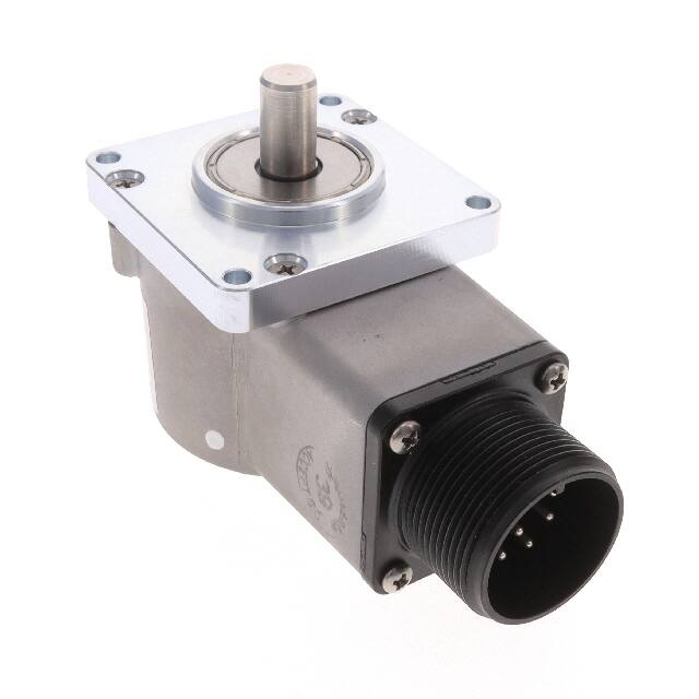

    ROTARY ENCODER OPTICAL 32PPR
01039-3330 数据手册
MODEL H20 | INCREMENTAL ENCODER Product Description The H20 is an extremely rugged encoder designed to economically fill the resolution range up to 4096 cycles per turn. This compact unit features a shock resistant disc, heavy duty bearings, and EMI shielding. The H20 conforms to NEMA 4 and 13 requirements. The H20 is also available in a hub shaft style with a flexmount for easy mounting directly to small motors. Typical applications of the H20 include machine control, process control, agricultural machinery, textile equipment, robotics, food processing, and metering. SPECIFICATIONS Mechanical Specifications Shaft Diameter 1/4” thru 3/8” and metric versions. Hollow shaft, hub shaft or thru-shaft versions available. Flats On Shaft 0.75” long X 0.03” deep Shaft Loading Up to 40 lbs. axial and 40 lbs. radial Shaft Runout .001 T.I.R. maximum Starting Torque at 25°C 1.0 in-oz maximum without shaft seal; 2.5 in-oz maximum with shaft seal; 4.0 in-oz thru-shaft Bearings 52100 bearing steel Shaft Material 303 stainless steel Bearing Housing Cover Bearing Life Maximum RPM Moment of Inertia Weight Die cast aluminum with iridite finish; stainless steel (special feature) Die cast aluminum with protective finish (For MS or CS terminations), otherwise drawn aluminum with protective finish; stainless-steel (special feature) 1.5 X 109 revs at rated load (10,000 hrs at 2500 RPM) 8,000 RPM (see frequency response, below) 2.0 X 10-4 oz-in-sec2 9 oz. typical Page 1 Copyright © 2018 Sensata Technologies, Inc. www.sensata.com Specification No. 02055-001 Rev. 02/18 Electrical Specifications Code Output Format Cycles per Shaft Turn Supply Voltage Current Requirements Incremental 2 channels in quadrature, 1/2 cycle index gated with negative B channel as standard. Ungated index when OC is specified as the output device 1 to 4096 (see table A) For resolutions above 1024 contact BEI for interpolation options 5 to 28 VDC available 100 mA typical + output load, 250 mA (max) Voltage/Output (see note 5) 28V/V: Line Driver, 5–28 VDC in, Vout = Vin 28V/5: Line Driver, 5–28 VDC in, Vout = 5 VDC 28V/OC: Open Collector, 5 – 28 VDC in, OCout Protection Level Reverse, overvoltage and output short circuit (see note 5) Frequency Response 100 KHz (up to 1024 cpt; 400KHz with interpolation option (see note 7)) Output Terminations see Table 1, following pages Note: Contact factory for other electrical options Environmental Specifications Enclosure Rating Temperature Shock NEMA 4 & 13 (IP66) when ordered with shaft seal (on units with an MS connector) and a cable gland (on units with cable termination) Operating, 0° to 70°C; extended temperature testing available (see note 8); Storage, -25° to 90°C unless extended temperature option called out 50 g’s at 11msec duration Vibration 5 to 2000 Hz @ 20 g’s Humidity 98% RH without consideration Notes and Tables: All notes and tables referred to in the text can be found in the pages that follow. Page 2 Copyright © 2018 Sensata Technologies, Inc. www.sensata.com DIMENSIONS Dimensions in inches Page 3 Copyright © 2018 Sensata Technologies, Inc. www.sensata.com TABLES Table 1 — Incremental Output Terminations The connector style will determine pinouts. For example, an encoder with ABC channels and an M18 connector uses the table to the right. M14 Connector M16 Connector Channels Designed in Model No. PIN PIN ABZ ABC PIN Function E A A A A A D B B B B B C C Z A C Z B D D +V F E E — A F 0V (Circuit Common) F 0V G Case Ground (CG) (Except H20) G — H A I B J Z +V (Supply Voltage) — B Channels Designed in Model No. Wire Color (22AWG) DA 15P Connector ABZ ABC ABZC YEL 13 A A A BLUE 14 B B B ORN 15 Z — Z W-YEL 10 — A A W-BLU 11 — B B W-ORN 12 — — Z RED 6 +V (Supply Voltage) BLK 1 0V (Circuit Common) GRN 9 Case Ground (CG) (Except H20) WHITE M18 Connector Shield Drain (Shielded Cable Only) Table A — H20 Disc Resolutions 1*, 2, 3, 5, 6, 8, 10, 11, 12, 24, 25, 30, 32, 40, 50, 60, 64, 75, 80, 95, 100, 105, 115, 120, 125, 150, 192, 200, 240, 250, 256, 300, 336, 360, 400, 500, 510, 512, 600, 625, 635, 720, 785, 1000, 1024, 1200** Resolutions shown in blue are not available as Express Encoders. * No index. For interpolation please specify the multiplied output (up to 4,096 for H20) in the model number, i.e. 4,096-T4. ** Consult factory for this resolution Page 4 Copyright © 2018 Sensata Technologies, Inc. www.sensata.com FIGURE 1 Output Waveform 1 CYCLE 90¡ HI A LO B Z A B Z CCW Rotation Viewing Face Page 5 Copyright © 2018 Sensata Technologies, Inc. www.sensata.com ORDERING OPTIONS Encoder X H20 D B Items highlighted in blue are standard Express Encoders and ship in one to three days. 37 TS F5 SS 500 ABZ C 28V/V S M18 EX S X: Express Encoder Type H: Heavy Duty 20: 2.00” DIA. Housing Configuration D: Square Flange E: 2.00 Dia. See Dimensions Pilot Configuration A: 1.181 (30mm) Female (No shaft seal available) B: 1.25 Shaft Diameter 25: 0.2497, 0.2495 37: 0.3747, 0.3745 39: 0.3935, 0.3932 Shaft Type TS: Thru Shaft HS: Hollow Shaft HBS: Hub Shaft Blank: Single Ended Shaft (Standard) Face Mount F5, F12, F28 Blank: None See Dimensions Shaft Seal SS: Shaft Seal (Must use Pilot B, except HBS unites can take SS with Pilot A) (See Note 2) Cycles Per Turn (Enter Cycles) (See Table A) No. of Channels A: Single Channel AB: Dual Quad. Ch. ABZ: Dual with Index AZ: Single with Index (See Note 3) Compliments C: Complimentary Outputs Blank: None (See note 4) Voltage / Output 28V/V: 5-28Vin/out 28V/5: 5-28Vin/5Vout 28V/OC: 5-28Vin/OCout Output Termination Location E: End S: Side Output Termination M14: MS3102R14S-6P M16: MS3102R16S-1P M18: MS3102R18S-1P C: Pigtail Cable CS: Cable with Seal (Side or End Term) (See Table 1 & Note 9) Add cable length (i.e., C18=18” cable) Hazardous Area Ratings Blank: None EX: Intrinsically Scale NI: Non-Incendive Contact Factory for Voltage Options Special Features S: Special features specified on purchase order. (Consult factory) (See Note 6) Page 6 Copyright © 2018 Sensata Technologies, Inc. www.sensata.com NOTES 1. Mounting is usually done either using the D-style square flange mount, E- or G-style servo mounts, or one of the standard face mounts, F1 for example. Consult factory for additional face mount options. 2. The shaft seal is recommended in virtually all installations. The most common exceptions are applications requiring a very low starting torque or those requiring operation at both high temperature and high speed. 3. Non-standard index widths and multiple indices are available by special order. Consult factory. 4. Complementary outputs are recommended for use with line driver type (source/sink) outputs. When used with differential receivers, this combination provides a high degree of noise immunity. 5. Output IC’s: Output IC’s are available as either Line Driver (LD) or NPN Open Collector (OC) types. Open Collectors require pull-up resistors, resulting in higher output source impedance (sink impedance is similar to that of line drivers). In general, use of a Line Driver style output is recommended. Line Drivers source or sink current and their lower impedance mean better noise immunity and faster switching times. Warning: Do not connect any line driver outputs directly to circuit common/OV, which may damage the driver. Unused outputs should be isolated and left floating. Our applications specialists would be pleased to discuss your system requirements and the compatibility of your receiving electronics with Line Driver type outputs. 28V/V: Multi-voltage Line Driver (7272*): 100 mA source/sink. Input voltage 5 to 28 VDC +/- 5% standard (Note: Vout = Vin). This driver is TTL compatible when used with 5 volt supply. Supply lines are protected against overvoltage to 60 volts and reverse voltage. Outputs are short circuit protected for one minute. Supply current is 120 mA typical (plus load current). This is the recommended replacement for 3904R and 7406R open collector outputs with internal pullup resistors. It is also a direct replacement for any 4469, 88C30, 8830 or 26LS31 line driver 28V/5: Multi-voltage Line Driver (7272*): 100 mA source/sink. Input voltage 5 to 28 VDC +/- 5% standard, internally regulated with 5V (TTL compatible) logic out. Supply lines are protected against overvoltage to 60 volts and reverse voltage. Outputs are short circuit protected for one minute. Supply current is 90 mA typical (plus load current). 15V/V: Multi-voltage Line Driver (4469*): 100 mA source/sink. Input voltage 5 to 15 VDC +/- 5% standard (Note: Vout = Vin). TTL compatible when used with 5 volt supply. Supply lines are protected against overvoltage to 60 volts and reverse voltage. Outputs are short circuit protected for one minute. Supply current is 90 mA typical (plus load current). This is a direct replacement for the 4469 Line Driver. 28V/OC: NPN Open Collector (3904*, 7273*). Current sink of 80 mA max. Current sourced by external pull- up resistor. Output can be pulled up to voltage other than supply voltage (30 V max). Input voltage 5 to 28 VDC +/- 5% standard. Supply current is 120 mA typical. This replaces prior IC’s with designations of 3904, 7406, 3302, 681 and 689. 5V/OCR, 15V/OCR, 24V/OCR: Open Collector (3904R*, 7406R*, 7273R*): Current sink of 70 mA max. Includes internal pull-ups sized at approximately 100 ohms/volt. Max current source is 10 mA. Supply current is 100 mA typical, 120 mA with internal pullups. 5V/V. 5V/OC, 5V/OCR and 9V/OC can be intrinsically safe line driver and open collector outputs available on certain model variations. They are intrinsically safe only when installed per the control drawing noted on the certification label affixed to the encoder body. 6. Special –S at the end of the model number is used to define a variety of non-standard features such as special shaft lengths, voltage options, or special testing. Please consult the factory to discuss your special requirements. 7. Higher frequency response may be available. Please consult with the factory. 8. Extended temperature ratings are available in the following ranges: -40 to 70°C, -40 to 85°C, –20 to 105°C and –40 to 105°C depending on the particular model. Some models can operate down to -55°C. Extended temperature ranges can affect other performance factors. Consult with factory for more specific information. 9. Mating straight plug receptacles may be ordered from the factory: For M12 use MS3116F12-10S, For M14 use MS3106F14S-6S For M14/19 use MS3116J14-19S, For M16 use MS3106F16S-1S For M18 use MS3106F18-1S, For M20 use MS3106F20-29S * Products manufactured prior to April 2007 used the line driver IC number instead of voltage output in model number. Page 7 Copyright © 2018 Sensata Technologies, Inc. www.sensata.com AGENCY APPROVALS & AVAILABLE CERTIFICATIONS Model H20 Hazardous Area Ratings Ratings and Markings (for all standard product configurations) Agency Blank EX Intrinsic Safety CE EN 55011: Electromagnetic Disturbance (EMI) EN 61000-6-2: Electromagnetic Compatibility (EMC) UL Class I, Groups A, B, C, D Class II, Groups E, F, G DEMKO NI Non-Incendive 20180302-E78446 II 1 G Ex ia IIC T4 Ga (9V/OC is II 1 G Ex ia IIB T4 Ga) DEMKO 06 ATEX 0614247X Ex ia IIC T4 Ga IEC/IECEx (9V/OC is Ex ia IIB T4 Ga) -40°C ≤ Ta ≤ +85°C UL DEMKO File Number IECEx UL 12.0035X Class I, Div. 2, Groups A, B, C, D Class II, Div. 2, Groups F, G 20170321-E78446 II 3 G Ex nA IIB T3 Gc T3B: -40°C ≤ Ta ≤ +85°C T4: -40°C ≤ Ta ≤ +55°C DEMKO 13 ATEX 1209038X Ex nA IIB T3 Gc IEC/IECEx T3B: -40°C ≤ Ta ≤ +85°C T4: -40°C ≤ Ta ≤ +55°C IECEx UL 13.0071X Consult factory for more details. Page 8 Sensata Technologies, Inc. (“Sensata”) data sheets are solely intended to assist designers (“Buyers”) who are developing systems that incorporate Sensata products (also referred to herein as “components”). Buyer understands and agrees that Buyer remains responsible for using its independent analysis, evaluation and judgment in designing Buyer’s systems and products. Sensata data sheets have been created using standard laboratory conditions and engineering practices. Sensata has not conducted any testing other than that specifically described in the published documentation for a particular data sheet. Sensata may make corrections, enhancements, improvements and other changes to its data sheets or components without notice. Buyers are authorized to use Sensata data sheets with the Sensata component(s) identified in each particular data sheet. HOWEVER, NO OTHER LICENSE, EXPRESS OR IMPLIED, BY ESTOPPEL OR OTHERWISE TO ANY OTHER SENSATA INTELLECTUAL PROPERTY RIGHT, AND NO LICENSE TO ANY THIRD PARTY TECHNOLOGY OR INTELLECTUAL PROPERTY RIGHT, IS GRANTED HEREIN. SENSATA DATA SHEETS ARE PROVIDED “AS IS”. SENSATA MAKES NO WARRANTIES OR REPRESENTATIONS WITH REGARD TO THE DATA SHEETS OR USE OF THE DATA SHEETS, EXPRESS, IMPLIED OR STATUTORY, INCLUDING ACCURACY OR COMPLETENESS. SENSATA DISCLAIMS ANY WARRANTY OF TITLE AND ANY IMPLIED WARRANTIES OF MERCHANTABILITY, FITNESS FOR A PARTICULAR PURPOSE, QUIET ENJOYMENT, QUIET POSSESSION, AND NON-INFRINGEMENT OF ANY THIRD PARTY INTELLECTUAL PROPERTY RIGHTS WITH REGARD TO SENSATA DATA SHEETS OR USE THEREOF. All products are sold subject to Sensata’s terms and conditions of sale supplied at www.sensata.com SENSATA ASSUMES NO LIABILITY FOR APPLICATIONS ASSISTANCE OR THE DESIGN OF BUYERS’ PRODUCTS. BUYER ACKNOWLEDGES AND AGREES THAT IT IS SOLELY RESPONSIBLE FOR COMPLIANCE WITH ALL LEGAL, REGULATORY AND SAFETY-RELATED REQUIREMENTS CONCERNING ITS PRODUCTS, AND ANY USE OF SENSATA COMPONENTS IN ITS APPLICATIONS, NOTWITHSTANDING ANY APPLICATIONS-RELATED INFORMATION OR SUPPORT THAT MAY BE PROVIDED BY SENSATA. Mailing Address: Sensata Technologies, Inc., 529 Pleasant Street, Attleboro, MA 02703, USA. Copyright © 2018 Sensata Technologies, Inc. Rev. 12/16/2020 CONTACT US Americas +1 (800) 350 2727 – Option 1 sales.beisensors@sensata.com Europe, Middle East & Africa +33 (3) 88 20 8080 position-info.eu@sensata.com Asia Pacific sales.isasia@list.sensata.com China +86 (21) 2306 1500 Japan +81 (45) 277 7117 Korea +82 (31) 601 2004 India +91 (80) 67920890 Rest of Asia +886 (2) 27602006 ext 2808 www.sensata.com
