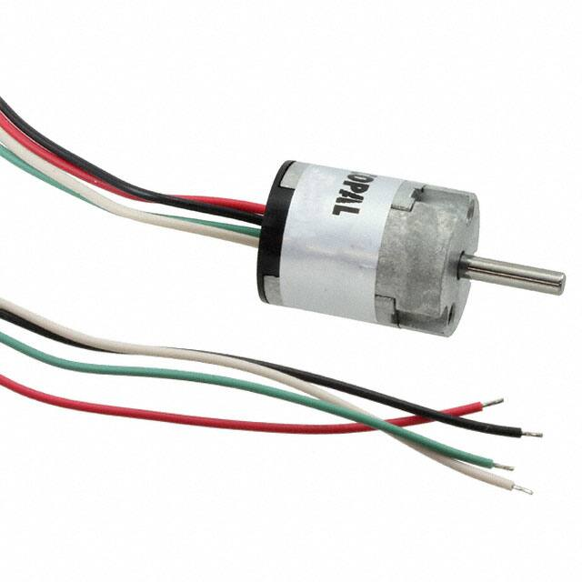

    ROTARY ENCODER OPTICAL 200PPR
RE12D-200-201-1 数据手册
RE12D OPTICAL ENCODERS ■ FEATURES RoHS compliant Oφ 12 mm, 2 phases square wave OHigh resolution 100 to 300 P/R OLow torque, low inertia OCost effective ORoHS compliant ■ PART NUMBER DESIGNATION RE12D – 100 – 201 – 1 Series name Output connection 1:Cable wire Resolution (P/R) Input voltage 100, 200, 300 1:5 V Output phase Output phase “Z” 2:“A” & “B” 0:Non ■ LIST OF PART NUMBERS Item ■ ELECTRICAL CHARACTERISTICS Part number Input voltage DC5 V ± 5 % 100 (P/R) RE12D-100-201-1 Input current 50 mA maximum 200 (P/R) RE12D-200-201-1 Output wave form 300 (P/R) RE12D-300-201-1 Output phases Resolution ※ Verify the above part numbers when placing orders. Square ware A, B Resolution (P/R) 100, 200, 300 Phase difference of A & B outputs ■ MECHANICAL CHARACTERISTICS Starting torque 0.05 mN·m {0.5 gf·cm} maximum Inertia Shaft loading (When mounting) Net weight 0.01 g·cm Maximum frequencies response 1.96 N {200 gf} maximum Axial 1.96 N {200 gf} maximum 10 kHz “1 (High)” + 4.5 V minimum “0 (Low)” + 0.5 V maximum Output signal 2 Radial 90° ± 45° Output impedance 1 kΩ Light source LED 10 g ■ Environmental characteristics Operating temp. range Storage temp. range Protection grade 0 ~ 50 °C − 20 ~ 80 °C IP40 RE12D OPTICAL ENCODERS ■ RELIABILITY TEST Test item Test conditions Vibration Power OFF Amplitude : 1.52 mm or 98.1 m/s2 (10 G) whichever is smaller. 10 ~ 500 Hz excursion 5 min/cycle, 1 hour each for X, Y, Z, directions. Shock Power OFF 1 time each in 6 directions (X, Y, Z) at 490 m/s2 (50 G), 11 ms. High temperature exposure Power OFF 80 °C 96 h Power ON 50 °C 96 h Low temperature exposure Power OFF − 20 °C 96 h Power ON 0 °C 96 h Humidity Power OFF 40 °C Relative humidity 90 ∼ 95 % 96 h (To be measured after wiping out moisture and leaving samples for 1 h at normal temperature and humidity after the test.) Thermal shock Power OFF To be done 5 cycles with the following condition (To be measured after leaving samples for 1 h at normal temperature and humidity after the test.) (To be measured after leaving samples for 1 h at normal temperature and humidity after the test.) 70 °C 0.5 h、− 20 °C 0.5 h ■ OUTPUT ■ OUTPUT CIRCUIT CW CCW Vcc T 1 kΩ a, b, c, d = 1/4T±1/8T Output A/B Output “A” Output “B” a b c d 0V ■ OUTLINE DIMENSIONS Unless otherwise specified, tolerance : ± 0.4 (Unit : mm) 100 +20 0 AWG28 φ2 8.5±0.2 0 –0.01 φ 12 2 – M2 D = 3.0 min. 8.5±0.5 15.5 (24) ■ ELECTRICAL WIRING Red Black White Green Power B Power 0 (V) Output “A” Output “B”
RE12D-200-201-1
物料型号:RE12D系列,包括不同分辨率的型号,如RE12D-100-201-1、RE12D-200-201-1和RE12D-300-201-1。
器件简介:φ12毫米,2相方波,高分辨率100至300 P/R,低扭矩,低惯性,成本效益高,符合RoHS标准。
引脚分配:文档中提到了输出信号“A”和“B”,以及Vcc和地线。
参数特性:包括分辨率(100、200、300 P/R)、输入电压(DC5V±5%)、最大输入电流(50mA)、输出波形(方波)、输出相位(A、B)、相位差(90°±45°)、最大频率响应(10kHz)、输出信号电平、输出阻抗(1kΩ)和光源(LED)。
功能详解:文档中详细描述了编码器的机械特性、环境特性和可靠性测试,包括振动、冲击、高温暴露、低温暴露、湿度和热冲击测试。
应用信息:适用于需要高精度位置检测和速度反馈的应用。
封装信息:提供了外形尺寸和电气接线信息,包括电源线、输出“A”和“B”线的颜色编码。
