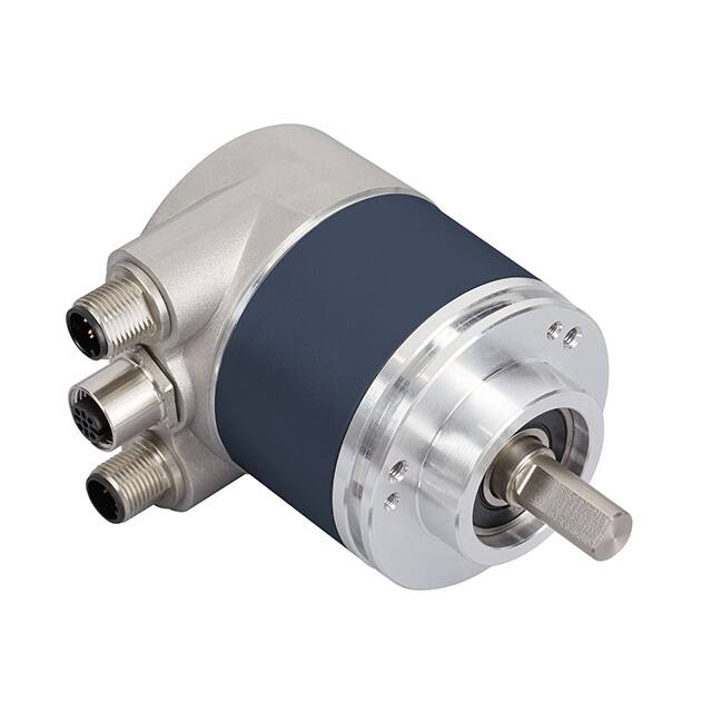

| MHM5 SERIES PROFINET ABSOLUTE MULTI -TURN ENCODER Features • • • • • • • • • • • Robust and compact design Solid shaft version Ø 10mm standard, with Ø 6mm optional Precision ball bearings with sealing flange High temperature performance -40° to +85°C Code disc made of unbreakable and durable plastic Precision, robust, gear train for turns counting - immune to stray magnetics or electrical interference Resolution: 13 bits = 8192 steps/turn (Optional 16 bits) Number of turns: 12 bits = 4096 turns (Optional 14 bits) Polarity inversion and short circuit protection Highly integrated circuit in SMD-technology Available in Stainless Steel SPECIFICATIONS Mechanical Housing Diameter: 58mm Housing Diameter Shaft Diameter: 10mm standard, 6mm optional Flat on shaft: 18mm long Max. Shaft Loading Starting Torque Axial: 40 N Radial: 110 N ≤ 3 N•cm Shaft Material: Stainless Steel Material Bearing Housing: Aluminum (stainless steel option, consult factory) Cover: Coated Steel (Stainless Steel option) 40 N / 60 N = 150 X 108 Bearing Life @ Load (Axial/Radial) 40 N / 80 N = 100 X 108 40 N / 110 N = 55 X 108 Maximum RPM (Continuous) 12,000 RPM Moment of Inertia < 30 g•cm2 Weight 370 g Page 1 Copyright © 2018 Sensata Technologies, Inc. www.sensata.com Electrical Code Binary Output Profile Profidrive Profile 4.X, Encoder Profile 4.X Counts per Revolution 13 Bits Standard, 16 Bits Optional Revolution Counter 12 Bits Standard, 14 Bits Optional Accuracy ± 0.0220° (14-16bit), ± 0.0439 (≤13bit) Supply Voltage 10 – 30 Vdc (for power supplies that comply with EN 50178) Current consumption ≤ 230mA @ 10Vdc, ≤100mA @ 24 Vdc Power Consumption ≤ 2.5 W Protection Level Reverse Polarity and Short Circuit Protection Transmission Rate 10 / 100 Mbits EMC: Emitted Interference DIN EN61000-6-4 EMC: Noise Immunity DIN EN 61000-6-2 Environmental Protection Class IP65 (EN 60529) Temperature Range (Operation and Storage) -40 to +85°C Shock: ≤ 100 g half-sine, 6ms (EN 60068-2-27); ≤ 10 g half-sine, 16ms (EN 60068-2-29) Mechanical Resistance Vibration: ≤ 10 g (10 Hz to 1 kHz) (EN 60068-2-6) Humidity 98% Non-Condensing Technology and Interface Sensor Optical Turns Counting Mechanical gearing Diagnostics Memory Programming Functions Resolution, time base, velocity filter, preset, count direction, IP address Features Boot loader, Round axis, LED Indicator lights Interface Cycle Time ≥ 1 ms Start-up time < 250 ms MTTF 65 years @ 60°C CONNECTION Profinet Connector Power Supply Connector 4 pinouts, female, D coded Pinout Signal 1 4 pinouts male, A coded Encoder view Pinout Signal Tx+ 1 VS (10-30Vdc) 2 Rx+ 2 N.C. 3 Tx- 3 GND (0V) 4 Rx- 4 N.C. Encoder view Page 2 Copyright © 2018 Sensata Technologies, Inc. www.sensata.com DIMENSIONS All dimensions are in millimeters MHM5 - 10 mm Shaft and facemount 80 48 10 20 60 18 53 58 36 f7 1 3xM3 (x120°) 6mm 10 h8 47 3xM4 (x120°) 6mm 3 3 14,8 40 MHM5 - 06 mm Shaft and servomount 84 3 3 4 47 50 f7 3xM4 6mm (x120°) 58 6 g6 42 10 14,8 40 60 MHM5 -9.58 mm (3/8”) Shaft and square flange mount 82 63,5 52,37 47 59 20 31,75 f7 1 5,6 9,52 h6 6,35 4x 7,62 30 14,8 40 60 Page 3 Copyright © 2018 Sensata Technologies, Inc. www.sensata.com Example : MHM5-EIB1B-1213-C100-PRM ORDERING OPTIONS MHM5 - EIB1B - 1213 - C100 - PRM Family 58 mm diameter, Absolute Geared Multi-Turn. MHM5 = Aluminum, Shafted Encoder MXM5 = Stainless Steel Shafted some specifications may change, consult factory. Electronics EIB1B = Profinet Note: the profinet option is now designated as EIBAB everywhere it appears. This is a global change. Resolution 12 13 12 16 14 13 14 16 First number is the turns counter Second number is the single turn resolution Mechanics MHM5 C100 = Aluminum version & 10mm shaft & clamping flange & IP65 S060 = Aluminum version & 6 mm shaft & servo flange & IP65 C10S = Aluminum version & 10mm shaft & clamping flange & IP67 9A70 = Aluminum version & 9.52 mm (3/8”) shaft & 2.5” (63.5mm) square flange & IP65 MXM5 C10V = Stainless steel version & 10mm shaft & clamping flange & IP67 Connection PRM = Radial M12 AGENCY APPROVALS & CERTIFICATIONS Page 4 Copyright © 2018 Sensata Technologies, Inc. www.sensata.com ACCESSORIES Mounting Bracket Right Angle M9202 Note: for mounting aluminum version Bellows Type Coupling 9403/6-6 = 6mm x 6mm 9403/6-10 = 6mm x 10mm 9403/10-9 = 10mm x 10mm Mounting Bracket Spring Loaded For Use with Measuring Wheel M9212 Measuring Wheel 200mm Circumference Measuring Wheel 500mm Circumference 9108/10 = Smooth, Polyurethane 9109/10 = Studded, Rubber 9110/10 = Knurled, Aluminum Uses 10mm shaft diameter 9101/10 = Smooth, Polyurethane 9102/10 = Studded, Rubber 9103/10 = Knurled, Aluminum Uses 10mm shaft diameter Page 5 Sensata Technologies, Inc. (“Sensata”) data sheets are solely intended to assist designers (“Buyers”) who are developing systems that incorporate Sensata products (also referred to herein as “components”). Buyer understands and agrees that Buyer remains responsible for using its independent analysis, evaluation and judgment in designing Buyer’s systems and products. Sensata data sheets have been created using standard laboratory conditions and engineering practices. Sensata has not conducted any testing other than that specifically described in the published documentation for a particular data sheet. Sensata may make corrections, enhancements, improvements and other changes to its data sheets or components without notice. Buyers are authorized to use Sensata data sheets with the Sensata component(s) identified in each particular data sheet. HOWEVER, NO OTHER LICENSE, EXPRESS OR IMPLIED, BY ESTOPPEL OR OTHERWISE TO ANY OTHER SENSATA INTELLECTUAL PROPERTY RIGHT, AND NO LICENSE TO ANY THIRD PARTY TECHNOLOGY OR INTELLECTUAL PROPERTY RIGHT, IS GRANTED HEREIN. SENSATA DATA SHEETS ARE PROVIDED “AS IS”. SENSATA MAKES NO WARRANTIES OR REPRESENTATIONS WITH REGARD TO THE DATA SHEETS OR USE OF THE DATA SHEETS, EXPRESS, IMPLIED OR STATUTORY, INCLUDING ACCURACY OR COMPLETENESS. SENSATA DISCLAIMS ANY WARRANTY OF TITLE AND ANY IMPLIED WARRANTIES OF MERCHANTABILITY, FITNESS FOR A PARTICULAR PURPOSE, QUIET ENJOYMENT, QUIET POSSESSION, AND NON-INFRINGEMENT OF ANY THIRD PARTY INTELLECTUAL PROPERTY RIGHTS WITH REGARD TO SENSATA DATA SHEETS OR USE THEREOF. All products are sold subject to Sensata’s terms and conditions of sale supplied at www.sensata.com SENSATA ASSUMES NO LIABILITY FOR APPLICATIONS ASSISTANCE OR THE DESIGN OF BUYERS’ PRODUCTS. BUYER ACKNOWLEDGES AND AGREES THAT IT IS SOLELY RESPONSIBLE FOR COMPLIANCE WITH ALL LEGAL, REGULATORY AND SAFETY-RELATED REQUIREMENTS CONCERNING ITS PRODUCTS, AND ANY USE OF SENSATA COMPONENTS IN ITS APPLICATIONS, NOTWITHSTANDING ANY APPLICATIONS-RELATED INFORMATION OR SUPPORT THAT MAY BE PROVIDED BY SENSATA. Mailing Address: Sensata Technologies, Inc., 529 Pleasant Street, Attleboro, MA 02703, USA. Copyright © 2018 Sensata Technologies, Inc. 02311-002 Rev:09/11/18 CONTACT US Americas +1 (800) 350 2727 sensors@sensata.com Europe, Middle East & Africa +33 (3) 88 20 8080 position-info.eu@sensata.com Asia Pacific sales.isasia@list.sensata.com China +86 (21) 2306 1500 Japan +81 (45) 277 7117 Korea +82 (31) 601 2004 India +91 (80) 67920890 Rest of Asia +886 (2) 27602006 ext 2808 www.sensata.com
