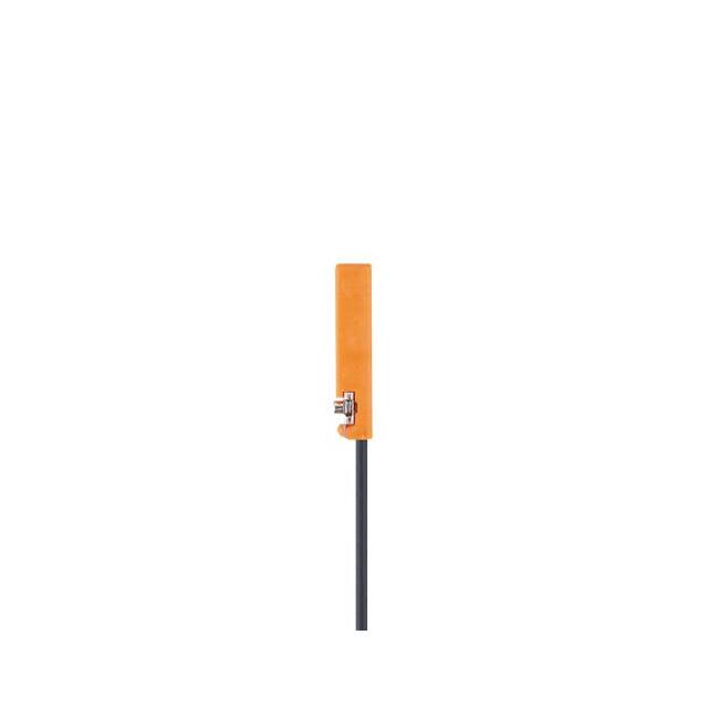

MK5325 C-slot cylinder sensor MKC3020BBPKG/A/ZH 1 fastening clamp Product characteristics Electrical design PNP Output function normally open Dimensions [mm] 26.1 x 2.8 x 5.5 Electrical data Operating voltage Current consumption [V] [mA] Protection class < 10 III Reverse polarity protection Max. power-on delay time 10...30 DC; ("supply class 2" to cULus) yes [ms] 30 Outputs Electrical design PNP Output function normally open Max. voltage drop switching output DC [V] 2.5 Permanent current rating of switching output DC [mA] 100 Switching frequency DC [Hz] 5000 Short-circuit protection yes Overload protection yes Detection zone Response sensitivity [mT] 2 Travel speed [m/s] > 10 Hysteresis [mm] 1 Repeatability [mm] < 0.2 Accuracy / deviations ifm electronic gmbh • Friedrichstraße 1 • 45128 Essen — We reserve the right to make technical alterations without prior notice. — EN-GB — MK5325-01 — 12.11.2020 — MK5325 C-slot cylinder sensor MKC3020BBPKG/A/ZH Operating conditions Ambient temperature [°C] -25...85 Protection IP 65; IP 67 Tests / approvals EMC MTTF EN 61000-4-2 ESD - CD / 8 kV AD EN 61000-4-3 HF radiated 10 V/m EN 61000-4-4 Burst 2 kV EN 61000-4-6 HF conducted 10 V EN 55011 class B [years] UL approval 2064 UL Approval no. C008 Mechanical data Weight [g] 18.4 Mounting flush mountable Cylinder type C-slot cylinders Dimensions [mm] Materials 26.1 x 2.8 x 5.5 housing: PA; fastening clamp: stainless steel Tightening torque [Nm] < 0.24 Displays / operating elements Display switching status 1 x LED, yellow Remarks Pack quantity 1 pcs. Electrical connection Cable: 2 m, PUR; 3 x 0.08 mm² Connection Core colours : BK = black BN = brown BU = blue ifm electronic gmbh • Friedrichstraße 1 • 45128 Essen — We reserve the right to make technical alterations without prior notice. — EN-GB — MK5325-01 — 12.11.2020 —
