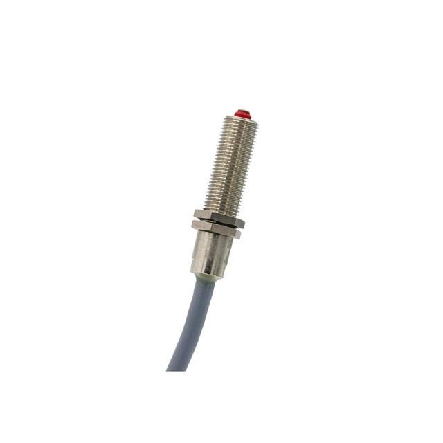

| | 07/2020 ››2-in-1 Position Sensor High Accuracy Mechanical Sensor 99600 Series ››M8 threaded metal housing ››Pin or ball actuator ››No hysteresis ››Detects 2 positions ››Special adaptations upon request 99600 Pin Actuator 99600 Ball Actuator Selection Guide Contact Configuration Pin Actuator Ball Actuator NC+NO 99600001 99600004 NC 99600002 99600005 NO 99600003 99600006 Pin Actuator Ball Actuator General Characteristics Certification b h (UL in progress) Termination Cable Cable length 2 m Cable material PVC Actuator Pin Form factor M8 Ball Mechanical Characteristics Contact distance NC+NO, 0.5 mm NC only, 0 mm NO only, 0.5 mm Operating Force max (OF) Max 1 N to open NC contact Max 1.6 N to close NO contact Hysteresis 0 mm Repeatability < 5 µm Pre-Travel 0 mm for NC contact 0.5 mm for NO contact Over-Travel 2 mm after NC opening 1.7 mm after NC opening Electrical Characteristics Max DC voltage 30 Vc Max DC Current 100 mA Environmental Characteristics Degree of Protection IP67 Temperature -20 °C to +105 °C with PVC cable (-40 °C to +130 °C) with silicone cable upon request Mechanical Life 10 000 000 cycles | | SWITCHES.CROUZET.COM || 2 | | 2-IN-1 POSITION SENSOR Pin Actuator | | 07/2020 Ball Actuator Dimensions (mm) Form factor M8 - Ball actuator Form factor M8 - Pin actuator Connection Sensor contact Cable option wire color Common brown Connector option pin number 1 NC black 2 NO blue 4 Principles *Contact distance can be customized upon request The sensors are built with a NC and NO contact. There is no pre-travel of the pin plunger to open the NC contact. The NO closes after a customized length of travel between 0.3 mm to 1.5 mm. Special adaptations Our dedicated design engineering experts have access to the the latest design tools and test facilities. Our DesignLab is ready to collaborate with you to adapt the product to provide the solution you need: › Cable length 0.5 m, 1 m or 2 m › M8 and M12 threaded housing › Actuator Pin, Ball, Hard Metal Pin or Telescopic › Silicone cable (-40 °C to +130 °C) upon request About Microprecision Electronics SA Microprecision Electronics SA is a Swiss manufacturer of electromechanical components for more than 60 years. It specialises in highly precise snap-action switches, sensors and custom-engineered solutions for industrial and challenging applications. Microprecision supplies to industrial and building automation, elevation systems, machinery, marine and medical industries, in applications where quality, precision and reliability are of utmost importance. Microprecision Electronics is a company of Crouzet Warning: The product information contained in this catalogue is given purely as information and does not constitute a representation, warranty or any form of contractual commitment. Crouzet Automatismes SAS and its subsidiaries reserve the right to modify their products without notice. It is imperative that we should be consulted over any particular use or application of our products and it is the responsibility of the buyer to establish, particularly through all the appropriate tests, that the product is suitable for the use or application. Under no circumstances will our warranty apply, nor shall we be held responsible for any application (such as any modification, addition, deletion, use in conjunction with other electrical or electronic components, circuits or assemblies, or any other unsuitable material or substance) which has not been expressly agreed by us prior to the sale of our products.
