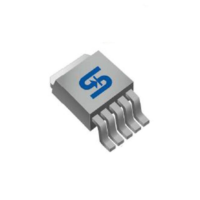

TS19601 700mA High Voltage Adjustable Current Regulator With Enable Control TO-252-5L (PPAK) Pin Definition: 1. VIN 2. ISET 3. GND 4. EN 5. OUT General Description The TS19601 is a high voltage, low dropout current regulator of maximum output current up to 700mA. The output en de d current is decided by an external resistor, and the output sink current could be disabled via OE pin. TS19601 has internally also build-in thermal protection to prevent the chip over heat damage. Features Typical Application Circuit 0.5V VDROP @ 700mA ● 700mA Maximum Output Current ● Output Current Controlled by External Resistor ● 3µs Fast Response Output Stage Enable Control ● Output Sustaining Voltage up to 75V ● Wide Supply Voltage Range: 5~50V Applications mm ● High Power LED Driver ● RGB Full Color Power LED Driver ● LCD Monitor/TV LED Backlight Driver ● LED Table Lamp eco ● Ordering Information Package Packing tR Part No. TS19601CP5 ROG TO-252-5L 2.5kpcs / 13” Reel Note: “G” denotes for Halogen- and Antimony-free as those which No contain
