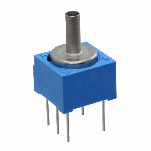

P-3000S PRESSURE TRANSDUCERS P-3000S 構造図 INTERNAL STRUCTURE (Gauge type) 1 4 2 3 6 5 Part name ■ FEATURES ● For non-corrosive gases ● Built-in temp. compensation function (0 〜 50 °C) ● Three pressure reference to choose from Gauge, Differential and Absolute pressure ● Compact and light weight ● PC board mountable Material 1 Pressure port 2 Housing 3 Resin compound 4 Sensor chip Silicone 5 Resistor board for temp. compensation Ceramic 6 Terminal pin Iron/Nickel alloy + Nickel-plated PBT (Polybutyleneterephthalate) Silicone gel Copper + solder-plated ■ MODEL NUMBER DESIGNATION P-3000S - 501 G - 02 Series name Thermal error Rated pressure range 02:± 0.02 % F.S./°C 04:± 0.04 % F.S./°C 500:0 ~ 4.9 kPa {0 ~ 0.05 kgf/cm2} 102:0 ~ 98.1 kPa {0 ~ 1 kgf/cm2} 101:0 ~ 9.81 kPa {0 ~ 0.1 kgf/cm2} *502:0 ~ 490 kPa {0 ~ 5.0 kgf/cm2} 351:0 ~ 34.3 kPa {0 ~ 0.35 kgf/cm2} *702:0 ~ 686 kPa {0 ~ 7.0 kgf/cm2} 501:0 ~ 49.0 kPa {0 ~ 0.5 kgf/cm2} *… Built-to-order 10:± 0.10 % F.S./°C Pressure reference G:Gauge D:Differential A:Absolute ■ LIST OF MODEL NUMBERS Pressure reference Thermal error Gauge Differential Absolute kPa {kgf/cm2} 0 ~ 4.9 0 ~ 9.81 0 ~ 49.0 0 ~ 98.1 0 ~ 490 0 ~ 686 0 ~ ± 9.81 0 ~ ± 49.0 0 ~ ± 98.1 0 ~ 34.3 0 ~ 98.1 Rated pressure range {0 ~ 0.05} {0 ~ 0.1} {0 ~ 0.5} {0 ~ 1} {0 ~ 5.0} {0 ~ 7.0} {0 ~ ± 0.1} {0 ~ ± 0.5} {0 ~ ± 1} {0 ~ 0.35} {0 ~ 1} ± 0.02 % F.S./°C ± 0.04 % F.S./°C ± 0.1 % F.S./°C P-3000S P-3000S -501G-02 -102G-02 P-3000S P-3000S -501D-02 -102D-02 P-3000S P-3000S P-3000S P-3000S → P-3000S → P-3000S P-3000S P-3000S P-3000S P-3000S P-3000S -500G-04 -101G-04 -501G-04 -102G-04 -502G-04 -702G-04 -101D-04 -501D-04 -102D-04 -351A-04 -102A-04 P-3000S P-3000S P-3000S -101G-10 -501G-10 -102G-10 P-3000S P-3000S P-3000S P-3000S P-3000S -101D-10 -501D-10 -102D-10 -351A-10 -102A-10  :Not available ※ Verify the above model numbers when placing orders. → The products marked → are built-to-order items. Please contact us separately to buy these products. P-3000S PRESSURE TRANSDUCERS ■標準仕様 STANDARD SPECIFICATIONS ● 特記ない場合、周囲温度 25 ± 5℃、駆動電流 1.5 mA DC で規定します。 Unless otherwise specified, the specs are defined at an ambient temperature of 25±5 °C and excitation current of 1.5 mA DC. Item Model number Pressure reference P-3000S 500G 101G 501G 102G 502G 702G 101D 501D 102D 351A 102A Gauge Differential Absolute General specifications 4.9 9.81 49.0 98.1 490 686 ± 9.81 ± 49.0 ± 98.1 34.3 (abs) 98.1 (abs) Rated pressure range kPa {kgf/cm2} {0.05} {0.1} {0.5} {1.0} {5.0} {7.0} {± 0.1} {± 0.5} {± 1.0} {0.35} {1.0} 9.8 19.6 98.1 196 981 1372 19.6 98.1 196 103 (abs) 196 (abs) kPa {kgf/cm2} Maximum pressure {0.1} {0.2} {1.0} {2.0} {10} {14} {0.2} {1.0} {2.0} {1.05} {2.0} 24.5 49.0 245 490 1471 2058 49.0 245 490 147 (abs) 490 (abs) Break-down pressure kPa {kgf/cm2} {0.25} {0.5} {2.5} {5.0} {15} {21} {0.5} {2.5} {5.0} {1.5} {5.0} Operating temp. range °C − 20 ~ 100 Compensated temp. range °C 0 ~ 50 Operating humidity 35 ~ 85(No condensation) %RH Storage temp. °C − 40 ~ 120(Atmospheric pressure, humidity 65 %RH maximum) Bridge resistance Ω 4700 ± 30 % Pressure medium Insulation resistance Non-corrosive gases MΩ minimum 100 (50 V DC) 50 V AC, 60 s(Leakage current 1 mA maximum) Dielectric strength Pressure port Power Net weight Analog output φ 3.5 mm g Excitation current Approx. 5 mV Span voltage mV 70 ± 30 50 ± 20 %F.S. ± 0.5 ZERO %F.S./°C Thermal error (Reference temp.: 25 °C) SPAN %F.S./°C Response Approx. 5 1.5(Constant current) mA DC Offset voltage Linearity/Hysteresis Approx. 7 ± 3 ±5 100 ± 30 ± 0.3 ± 0.25 50 ± 20 ± 0.5 100 ± 30 ± 0.3 80 ± 40 ± 0.5 ± 0.04 ± 0.04/0.1 ± 0.02/0.04/0.1 ± 0.04 ± 0.04/0.1 ± 0.02/0.04/0.1 ± 0.04/0.1 ± 0.04 ± 0.04/0.1 ± 0.02/0.04/0.1 ± 0.04 ± 0.04/0.1 ± 0.02/0.04/0.1 ± 0.04/0.1 Approx. 1 ms ■ ENVIRONMENTAL CHARACTERISTICS Test item Test conditions (At 25 ± 5 °C) Permissible change Vibration 10 ~ 500 Hz, 1.5 mm maximum/98.1 m/s , 3 directions for 2 hours each Shock 981 m/s2, 3 directions for 3 times each Pressure cycling 0 ~ Rated pressure, 10 cycles Moisture resistance 40 °C, 90 ~ 95 %RH, 240 hrs. 2 6 Offset voltage/Span voltage: ±1 %F.S. maximum each ※ P-3000S series can be operated at the vacuum pressure. P-3000S PRESSURE TRANSDUCERS 00S外形図 ■ OUTLINE DIMENSIONS Unless otherwise specified, tolerance : ± 0.5 (Unit: mm) ● Gauge Absolute type 9.52 17 10±1 10±1 21.5 2 3 10.2 15 3 Terminal pin No. Φ 3.5±0.1 2 4 5 .1 5 .1 15 10.2 G Vent hole 1 1 4 ゲージ圧タイプ Pressure port Terminal pin 5 –Φ 0.7 COPAL JAPAN 10±1 B 17 差圧タイプ A +1 10.5 0 1 Φ 3.5±0.1 COPAL Φ 3.5±0.1 ● Differential type JAPAN Pressure port B Terminal pin No. 81± Pressure port A G 4 3 2 1 Aux. pin 4×2.54 2 –Φ 0.75 ■ INTERNAL ELECTRICAL SCHEMATICS Thick film resistors for temp. compensation Metal housing Input 4 (+) G 3 (–) 2 (–) 1 (+) Output 7.62 Terminal pin 5 – Φ 0.75 ■ TERMINAL NUMBER Pin Connection 1 Output ⊕ 2 Output ⊖ 3 Input ⊖ 4 Input ⊕ G Housing

物料型号:P-3000S - 501 G - 02
器件简介:P-3000S是一款适用于非腐蚀性气体的压力传感器,具有内置温度补偿功能(0至50°C),可选择三种压力参考:表压、差压和绝对压力。它体积小巧、重量轻,可安装在PCB板上。
引脚分配:文档中提供了两种类型的引脚分配图,分别是Gauge(表压)和Differential(差压)类型。表压类型有5个引脚,差压类型有7个引脚。
参数特性: - 额定压力范围:0至49.0 kPa(0至0.5 kgf/cm²) - 最大压力:98.1 kPa(1.0 kgf/cm²) - 工作温度范围:-20至100°C - 补偿温度范围:0至50°C - 工作湿度:35至85%RH(无凝结) - 存储温度:-40至120°C - 桥式电阻:4700±30% - 压力介质:非腐蚀性气体 - 绝缘电阻:最小100MΩ(50VDC) - 介电强度:50V AC,60秒(漏电流最大1mA)
功能详解:P-3000S传感器具有多种型号,每种型号都有不同的额定压力范围和热误差。传感器可以测量表压、差压或绝对压力,并且具有不同的热误差选项,如±0.02% F.S./°C、±0.04% F.S./°C和±0.10% F.S./°C。
应用信息:P-3000S适用于需要测量压力的多种应用场景,特别是在需要小巧、轻量级传感器的场合。
封装信息:文档提供了压力传感器的外形尺寸图和内部电气原理图,包括压力端口、通气孔和端子引脚的详细信息。
