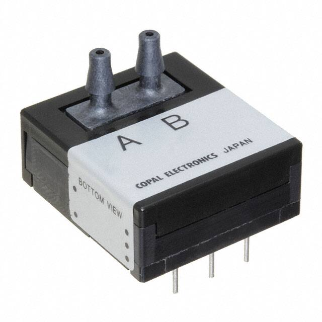

PRESSURE TRANSDUCERS WITH AMP. PA-100 INTERNAL STRUCTURE 1 2 3 4 Part name ■ FEATURES 1 Pressure Port ● Covers low pressure range ● Buit-in a compact amplifier circuit ● Measures differential pressure 2 Sensor chip 3 Housing 4 Terminal pin Material LCP (Liquid crystal polymer) Silicone POM (Polyoxymethylene) PPS (Polyphenylene sulphide) Brass + Tin-plated ■ MODEL NUMBER DESIGNATION PA-100-100D-S Rated pressure range Series name 100D-S: 0 ~ 1 kPa {102 mmH2O} 200D-S: 0 ~ 2 kPa {204 mmH2O} 500D-S: 0 ~ 5 kPa {510 mmH2O} 100D-W:− 1 ~ 1 kPa {± 102 mmH2O} 200D-W:− 2 ~ 2 kPa {± 204 mmH2O} 500D-W:− 5 ~ 5 kPa {± 510 mmH2O} ■ LIST OF MODEL NUMBERS Pressure reference Differential kPa Rated pressure range Model number 0 ~ 1 0 ~ 2 0 ~ 5 − 1 ~ 1 − 2 ~ 2 −5~5 PA-100-100D-S PA-100-200D-S PA-100-500D-S PA-100-100D-W PA-100-200D-W PA-100-500D-W ※ Verify the above model numbers when placing orders. PA-100 PRESSURE TRANSDUCERS WITH AMP. ■ STANDARD SPECIFICATIONS ● Unless otherwise specified, the specs are defined at an ambient temperature of 25±5 °C and excitation voltage of 5 V DC. Item PA-100 Model number 100D-S 200D-S 500D-S 100D-W 200D-W 500D-W General specifications Pressure reference Differential Rated pressure range kPa 1 2 5 ± 1 ± 2 ±5 Maximum pressure kPa 5 ± 10 ± 25 Break-down pressure kPa 50 Line pressure kPa 50 Operating temp. range °C − 20 ~ 70 Compensated temp. range °C 0 ~ 50 Storage temp. ± 5 − 20 ~ 80(Atmospheric pressure, humidity 65 %RH maximum) °C Pressure medium Non-corrosive gases MΩ minimum 100 (50 V DC) 50 V AC, 60 s(Leakage current 1 mA maximum) Pressure port φ 2.5 mm Net weight Power 25 35 ~ 85(No condensation) Dielectric strength Supply voltage g Approx. 8 V DC 5 ± 10 % maximum Consumption current 5 mA V Output voltage Analog output 10 %RH Operating humidity Insulation resistance ※2 ※1 0.5 ~ 4.5 Zero voltage ※3 V 0.5 ± 0.08 2.5 ± 0.08 Span voltage ※3 V 4.0 ± 0.08 2.0 ± 0.08 Output current Linearity/Hysteresis Thermal error (Reference temp.: 25 °C) Response mA maximum 0.5(10 kΩ 以上 Load resistance 10 kΩ minimum) ± 0.5 %F.S. ZERO %F.S. SPAN %F.S. ± 5 ± 3 ± 2 ± 5 ± 3 ±2 − 2 − 1 − 0.4 ±2  5 ms Gravitational effect %F.S. (From vertical position to horizontal position) max. − 2 − 1 − 0.4 ※ 1 PA-100- □□□ D-S pressure range Pressure A port − B port = 0 ~ Rated pressure range PA-100- □□□ D-W pressure range Pressure A port − B port = − Rated pressure range ~ Rated pressure range ※ 2 Defined at 5 V of supply voltage. ※ 3 The zero and span voltages vary in proportion to the supply voltage. PA-100 PRESSURE TRANSDUCERS WITH AMP. ■ ENVIRONMENTAL CHARACTERISTICS Test item Test conditions (At 25 ± 5 °C) Permissible change Vibration 10 ~ 500 Hz, 1.5 mm maximum/49 m/s , 3 directions for 2 hours each Shock 490 m/s2, 3 directions for 3 times each Pressure cycling 0 ~ Rated pressure, 106 cycles Moisture resistance 40 °C, 90 ~ 95 %RH, 240 hrs. 2 Zero voltage/Span voltage: ± 2 %F.S. (100D/200D) maximum and ± 1 %F.S. (500D) each ■ OUTPUT VOLTAGE VS PRESSURE PA-100- □□□ D-W type 0.5 V 0 4.5 V –Pr 0 25 ± 0.4 7.6 10.5 Common 4 N.C. 5 N.C. Label 4.9 ± 0.5 0.5 5.08 2– φ 1.0 Pressure port φ 3.5 5– φ 0.7 ± 0.1 Terminal pin (Tin-plated) C0.2 3 A POM 5.08 LCP PPS 5 1 2 4 3 [ Projection A Tolerance : 0.2 (mm) ■ INTERNAL ELECTRICAL SCHEMATICS PressureA Power B Sensor PressureB φ 2.5 20.32 B JAPAN Output 3 Unless otherwise specified, tolerance : ± 0.5 (Unit: mm) Port B PA–100–※※※D–※ 7H4 COPAL ELECTRONICS 2 Press. (Port A – Port B) Projection A 7 Power B Pr ■ OUTLINE DIMENSIONS 22.5 ± 0.4 1 0.5 V Pr Port A Connection 2.5 V Press. (Port A – Port B) 5.7 Pin 1.7 4.5 V Output voltage Output voltage PA-100- □□□ D-S type Main circuit Output Common ]
