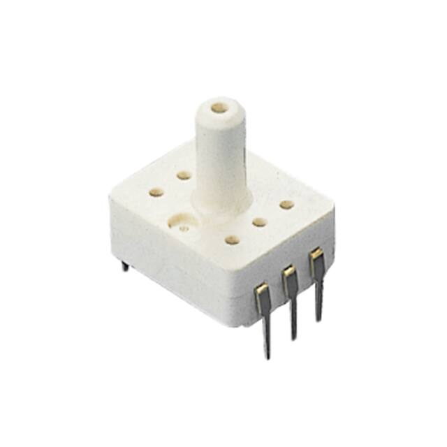

P-2000 構造図 PRESSURE TRANSDUCERS P-2000 INTERNAL STRUCTURE (BN type) 1 3 2 5 4 Part name ■ FEATURES ● Compact and light weight ● For non-corrosive gases ● Dual in line package ● Pressure range ~9.81, ~981 kPa {~0.1, ~10 kgf/cm2} Material 1 Housing 2 Cover 3 Sensor chip Silicone 4 Chip resistor (compensatory resistor) Ceramic 5 Terminal pin LCP (Liquid crystal polymer) Aluminum Phosphor bronze + Au-plated ■ MODEL NUMBER DESIGNATION P-2000 - 501 G - 15 - BN Series name Terminal direction AN:Same direction as the pressure port BN:Opposite direction to the pressure port Rated pressure range 101:0 ~ 9.81 kPa {0 ~ 0.1 kgf/cm } 501:0 ~ 49.0 kPa {0 ~ 0.5 kgf/cm2} 102:0 ~ 98.1 kPa {0 ~ 1 kgf/cm2} 352:0 ~ 343 kPa {0 ~ 3.5 kgf/cm2} 502:0 ~ 490 kPa {0 ~ 5 kgf/cm2} 702:0 ~ 686 kPa {0 ~ 7 kgf/cm2} 103:0 ~ 981 kPa {0 ~ 10 kgf/cm2} 2 Thermal error 15:± 0.15 % (± 0.12 %) F.S./°C Pressure reference G:Gauge ■ LIST OF MODEL NUMBERS Terminal direction Rated pressure range kPa {kgf/cm2} 0 ~ 9.81 {0 ~ 0.1} 0 ~ 49.0 {0 ~ 0.5} 0 ~ 98.1 {0 ~ 1} 0 ~ 343 {0 ~ 3.5} 0 ~ 490 {0 ~ 5} 0 ~ 686 {0 ~ 7} 0 ~ 981 {0 ~ 10} AN A P-2000-101G-15-AN A P-2000-501G-15-AN A P-2000-102G-15-AN A P-2000-352G-15-AN A P-2000-502G-15-AN A P-2000-702G-15-AN A P-2000-103G-15-AN BN P-2000-101G-15-BN P-2000-501G-15-BN P-2000-102G-15-BN P-2000-352G-15-BN P-2000-502G-15-BN P-2000-702G-15-BN P-2000-103G-15-BN ※ Verify the above model numbers when placing orders. The AN version, marked A is manufactured upon receipt of order basis. P-2000 PRESSURE TRANSDUCERS ■ STANDARD SPECIFICATIONS ● Unless otherwise specified, the specs are defined at an ambient temperature of 25±5 °C and excitation current of 1.5 mA DC. Item P-2000 Model number 101G 501G 102G 352G 502G 702G 103G Gauge Pressure reference 9.81 49.0 98.1 343 490 686 981 kPa {kgf/cm2} {0.1} {0.5} {1.0} {3.5} {5} {7} {10.0} 19.6 98.1 196 686 981 1373 1471 kPa {kgf/cm2} {0.2} {1.0} {2.0} {7.0} {10} {14} {15.0} 49.0 245 490 1030 1471 1961 1961 kPa {kgf/cm2} {0.5} {2.5} {5} {10.5} {15} {20} {20} Rated pressure range Maximum pressure General specifications Break-down pressure Operating temp. range °C − 20 ~ 80 Compensated temp. range °C 0 ~ 50 Operating humidity %RH 35 ~ 85(No condensation) Storage temp. °C − 20 ~ 80(Atmospheric pressure, humidity 65 %RH maximum) Bridge resistance Ω 3300 ± 30 % Non-corrosive gases Pressure medium Insulation resistance MΩ minimum 100 (500 V DC) 500 V AC, 60 s(Leakage current 1 mA maximum) Dielectric strength g Power Net weight Analog output φ 3.2 mm Pressure port Approx. 1 mA DC Excitation current 1.5(Constant current) Offset voltage mV Span voltage mV 50 ± 20 90 ± 30 Linearity/Hysteresis Thermal error (Reference temp.: 25 °C) Response ± 20 ± 15 ± 0.3 %F.S. ZERO %F.S./°C ± 0.15 ± 0.12 SPAN %F.S./°C ± 0.05 ± 0.04 ms Approx. 1 ■ ENVIRONMENTAL CHARACTERISTICS Test item Test conditions (At 25 ± 5 °C) Permissible change Vibration 10 ~ 500 Hz, 1.5 mm maximum/98.1 m/s , 3 directions for 2 hours each Shock 981 m/s2, 3 directions for 3 times each Pressure cycling 0 ~ Rated pressure, 10 cycles Moisture resistance 40 °C, 90 ~ 95 %RH, 240 hrs. 2 6 ※ P-2000 series can be operated at the vacuum pressure. Offset voltage/Span voltage: ±1 %F.S. maximum each B 外形図 P-2000 PRESSURE TRANSDUCERS A 外形図 ■ OUTLINE DIMENSIONS Unless otherwise specified, tolerance : ± 0.3 (Unit: mm) 2.5 φ 3.2 7.3 5.2 3 ± 0.5 Vent hole G P-2000 PRESSURE +0.1 0 6 12 COPAL JAPAN 2.5 0.5(t = 0.3) R1 TRANSDUCER 4 Pressure port φ 1.2 5 2 1 10 3 BN type Pressure range marking Pressure range marking 5.2 ■ INTERNAL ELECTRICAL SCHEMATICS 4 1 R 5 (+) 2 3 Input 6 (–) (–) (+) Output R : Built-in chip resistor for temp. compensation 7.3 4 6 5 2 1 2.5 φ 3.2 +0.1 0 10 3 Vent hole G P-2000 PRESSURE TRANSDUCER COPAL JAPAN 3.5 ± 0.5 2.5 0.5(t = 0.3) AN type Pressure port φ 1.2 12 ■ TERMINAL NUMBER Pin 1 2 3 4 5 6 Connection Output C Input B Input C Output B Input C Input B
