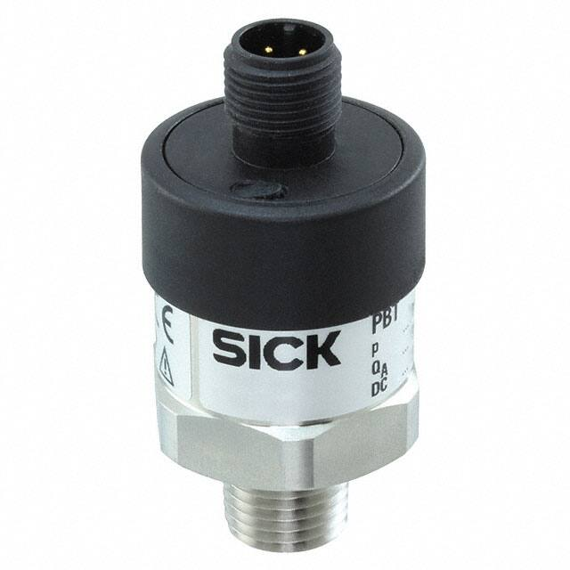

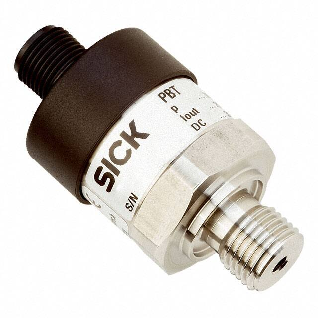

PBT-RP200SN1SS0AMA0Z 数据手册
Product data sheet PBT-RP200SN1SS0AMA0Z PBT PRESSURE SENSORS PBT-RP200SN1SS0AMA0Z | PBT PRESSURE SENSORS A B C D E F H I J K L M N O P Q R S T Ordering information Type Part no. PBT-RP200SN1SS0AMA0Z 6047847 Other models and accessories www.sick.com/PBT Illustration may differ Detailed technical data Features Medium Liquid, gaseous Pressure type Gauge pressure Pressure unit psi Measuring range 0 psi ... 200 psi Process temperature 0 °C ... +80 °C Output signal 4 mA ... 20 mA, 2-wire Specialty Without Mechanics/electronics Process connection ¼'' NPT Wetted parts Pressure Connection: stainless steel 316L Pressure sensor: stainless steel 316L (for measurement ranges from 0 bar ... 10 bar rel stainless steel 13-8 PH) Internal transmission fluid Silicone oil (only with pressure ranges < 0 bar ... 10 bar and ≤ 0 bar abs ... 25 bar abs) Pressure port , Standard Housing material Stainless steel Connection type Round connector M12 x 1, 4-pin, IP67 Supply voltage 8 V DC ... 30 V DC with output signal 4 mA ... 20 mA and 0 V ... 5 V 14 V DC ... 30 V DC with output signal 0 V ... 10 V 8 V DC ... 30 V DC 1) Power consumption Signal current (max. 25 mA) for current output Max. 8 mA for voltage output signal Electrical safety Overvoltage protection: 32 V DC, 36 V DC with 4 mA ... 20 mA Short-circuit protection: QA towards M Reverse polarity protection: L+ to M Protection class: III Isolation voltage 500 V DC CE-conformity Pressure equipment directive: 2014/68/EU, EMC directive: 2014/30/EU, EN 61 326-2-3 Weight sensor Approx. 80 g 1)  The pressure transmitter must be supplied with power by a limited energy circuit compliant with 9.3 of UL/EN/IEC 601010-1 or LPS to UL/EN/IEC 60950-1 or Class 2 to UL 1310/UL1585 (NEC or CEC). The power supply must be suitable for operation above 2,000 m if the pressure transmitter is used above this altitude. 2 FLUID SENSORS | SICK Product data sheet | 2021-09-10 15:22:32 Subject to change without notice PBT-RP200SN1SS0AMA0Z | PBT PRESSURE SENSORS Seal Without seal Enclosure rating IP67 Protection class III ✔ Reference conditions Reference conditions: According to IEC 61298-1 MTTF 815 years 1)  The pressure transmitter must be supplied with power by a limited energy circuit compliant with 9.3 of UL/EN/IEC 601010-1 or LPS to UL/EN/IEC 60950-1 or Class 2 to UL 1310/UL1585 (NEC or CEC). The power supply must be suitable for operation above 2,000 m if the pressure transmitter is used above this altitude. Performance Non-linearity ≤ ± 0.5 %, (Best Fit Straight Line, BFSL) according to IEC 61298-2 Accuracy ≤ ± 1 % of the span Adjustment accuracy of zero signal ≤ 0.5 % of span typ., ≤ 0.8 % of span max. (with non-linerarity 0.5 %) Hysteresis ≤ 0.16 % of the span Non-repeatability ≤ 0.1 % of the span Response time
