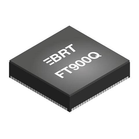

FT900/1/2/3 Embedded Microcontroller Datasheet Version 1.2 Document No.: BRT_000022 Clearance No.: BRT#025 Future Technology Devices International Ltd. FT900/1/2/3 (Embedded Microcontroller) The FT90x series includes the FT900, FT901, FT902 and FT903 which are complete SystemOn-Chip 32-bit RISC microcontrollers for embedded applications featuring a high level of integration and low power consumption. It has the following features:  Two SPI slaves support single data transfer with 25MHz clock.  Two I2C bus interfaces can be configured as master or slave, which support standard / fast / fast plus / high speed mode data transfers. Max data transfer rate up to 3.4 Mbit/s. Clock stretching is supported.  I2S bus interface can be configured as master or slave. Two clock input options (24.576 MHz and 22.5792 MHz) to support I2S master mode for different audio sample rates.  UART interface can be configured as one full programmable UART0 or two simple interfaces, UART0 and UART1 with CTS / RTS control function.  High performance, low power 32-bit FT32 core processor, running at a frequency of 100MHz.  256kB on-chip Flash memory.  256kB on-chip shadow program memory.  True Zero Wait States (0WS) up to 3.1 DMIPS per MHz performance  64kB on-chip data memory.  EFUSE for security configuration.   Integrated Phase-Locked Loop (PLL) supports external 12MHz crystal and direct external clock source input. Four user timers watchdog function.  8-bit parallel data interface supports camera data capturing.  32.768 kHz real time clock support.   One USB2.0 EHCI compatible host controller supports high-speed (480 Mbit/s), full-speed (12 Mbit/s), and low-speed (1.5 Mbit/s). Support 7 independent PWM channels. Channel 0 and 1 can be configured as PCM 8-bit/16-bit stereo audio output.  SD host controller is compatible to standard specification V3.0, it supports up to 25 MHz SD clock speed and software supports SD card format in SD/SDHC/SDXC.  Support two 10-bit DAC 0/1 channels output, sample rate at ~1 MS/s.  Support seven 10-bit ADC 1/7 channels input, sample rate is up to ~960 kS/s.  Single 3.3 volt power supply, built-in 1.2 V regulators.  3.3 volt I/O power supply.  Support USB Battery Charging Specification Rev 1.2. Downstream port can be configured as SDP, CDP or DCP. Upstream port can perform BCD mode detection.  Support VBUS current control.  Power-On Reset (POR).  -40°C to 85°C extended operating temperature range.  Available in compact Pb-free 100-Pin packages (all RoHS compliant).  One USB2.0 peripheral controller supports highspeed (480 Mbit/s) and full-speed (12 Mbit/s).  USB2.0 host and peripheral controllers support the Isochronous, Interrupt, Control, and Bulk transfers.  10/100 Mbps Ethernet that is compliant with the IEEE 802.3/802.3u standards. (FT900 and FT901 only)  Supports One-Wire debugger for downloading firmware to Flash memory or shadow program memory, and supports a software debugger.  Two CAN controllers support CAN protocol 2.0 parts A & B, data rate is up to 1 Mbit/s. (FT900 and FT902 only)  One SPI master supports single / dual / quad modes of data transfer. Clock rate is up to 25 MHz Copyright © Bridgetek Limited with power pre-scaling switching and and a over 1 FT900/1/2/3 Embedded Microcontroller Datasheet Version 1.2 Document No.: BRT_000022 Clearance No.: BRT#025 Neither the whole nor any part of the information contained in, or the product described in this manual, may be adapted or reproduced in any material or electronic form without the prior written consent of the copyright holder. This product and its documentation are supplied on an as-is basis and no warranty as to their suitability for any particular purpose is either made or implied. Future Technology Devices International Ltd will not accept any claim for damages howsoever arising as a result of use or failure of this product. Your statutory rights are not affected. This product or any variant of it is not intended for use in any medical appliance, device or system in which the failure of the product might reasonably be expected to result in personal injury. This document provides preliminary information that may be subject to change without notice. No freedom to use patents or other intellectual property rights is implied by the publication of this document. Future Technology Devices International Ltd, Unit 1, 2 Seaward Place, Centurion Business Park, Glasgow G41 1HH United Kingdom. Scotland Registered Company Number: SC136640 Copyright © Bridgetek Limited 2 FT900/1/2/3 Embedded Microcontroller Datasheet Version 1.2 Document No.: BRT_000022 Clearance No.: BRT#025 Typical Applications 1  Home security system  CCTV monitor  Home Automation  Industrial automation  Embedded audio application  Medical appliances  Motor drive and application control  Instrumentation  E-meter  DAQ System 1.1 Part Numbers Part Number Package FT900Q-X 100 Pin QFN, pitch 0.4mm, body 12mm x 12mm x 0.75mm, support both CAN Bus and Ethernet features. FT900L-X 100 Pin LQFP, pitch 0.5mm, body 14mm x 14mm x 1.40mm, support both CAN Bus and Ethernet features. FT901Q-X 100 Pin QFN, pitch 0.4mm, body 12mm x 12mm x 0.75mm, support Ethernet, doesn’t support CAN Bus. FT901L-X 100 Pin LQFP, pitch 0.5mm, body 14mm x 14mm x 1.40mm, support Ethernet, doesn’t support CAN Bus. FT902Q-X 100 Pin QFN, pitch 0.4mm, body 12mm x 12mm x 0.75mm, support CAN Bus, doesn’t support Ethernet. FT902L-X 100 Pin LQFP, pitch 0.5mm, body 14mm x 14mm x 1.40mm, support CAN Bus, doesn’t support Ethernet. FT903Q-X 100 Pin QFN, pitch 0.4mm, body 12mm x 12mm x 0.75mm, doesn’t support both CAN Bus and Ethernet features. FT903L-X 100 Pin LQFP, pitch 0.5mm, body 14mm x 14mm x 1.40mm, doesn’t support both CAN Bus and Ethernet features. Table 1-1 FT90x series Part Numbers Common Interfaces on all packages include: USB Host, USB Peripheral, SPI, UART, ADC, DAC, I2S, PWM, RTC, Timers/Watchdog, Interrupt Controller. Note: Packaging codes for X is: -R: Tape and Reel (Qty per reel is 1000) -T: Tray packing (Qty per tray for LQFP is 90, qty per tray for QFN is 152) 1.2 USB2.0 Compliant The FT90x series contains a USB2.0 host controller and peripheral controller that both are compliant with USB2.0 specification. Copyright © Bridgetek Limited 3 FT900/1/2/3 Embedded Microcontroller Datasheet Version 1.2 Document No.: BRT_000022 Clearance No.: BRT#025 2 FT900 Block Diagram Figure 2-1 FT900 Block Diagram For a description of each function please refer to Section 5. Copyright © Bridgetek Limited 4 FT900/1/2/3 Embedded Microcontroller Datasheet Version 1.2 Document No.: BRT_000022 Clearance No.: BRT#025 Table of Contents 1 Typical Applications ...................................................................... 3 1.1 Part Numbers...................................................................................... 3 1.2 USB2.0 Compliant ............................................................................... 3 2 FT900 Block Diagram.................................................................... 4 3 Device Pin Out and Signal Description .......................................... 8 3.1 Pin Out – FT900 QFN-100 ................................................................... 8 3.2 Pin Out – FT900 LQFP-100 ................................................................ 12 3.3 Pin Description ................................................................................. 16 4 Function Description................................................................... 23 4.1 Architectural Overview ..................................................................... 23 4.2 FT32 Core Processor ......................................................................... 23 4.3 256kB Flash Memory......................................................................... 23 4.4 Boot Sequence .................................................................................. 23 4.5 Interrupt........................................................................................... 23 4.6 Memory Mapping .............................................................................. 25 4.7 USB2.0 Host Controller ..................................................................... 26 4.7.1 4.8 Features ................................................................................................................... 26 USB2.0 Peripheral Contoller.............................................................. 26 4.8.1 4.9 Features ................................................................................................................... 26 Ethernet Controller ........................................................................... 27 4.9.1 4.10 Features ................................................................................................................... 27 CAN Bus Controller ......................................................................... 27 4.10.1 4.11 Features................................................................................................................ 27 Real Time Clock .............................................................................. 28 4.11.1 4.12 Features................................................................................................................ 28 One-Wire Debugger Interface ........................................................ 28 4.12.1 4.13 Features................................................................................................................ 28 SPI Interface ................................................................................. 28 4.13.1 4.14 Features................................................................................................................ 28 I2C Interface .................................................................................. 28 4.14.1 4.15 Features................................................................................................................ 29 UART Interface .............................................................................. 29 4.15.1 4.16 Features................................................................................................................ 29 Timers and Watchdog Timer .......................................................... 29 4.16.1 4.17 Features................................................................................................................ 30 2 I S Interface .................................................................................. 30 Copyright © Bridgetek Limited 5 FT900/1/2/3 Embedded Microcontroller Datasheet Version 1.2 Document No.: BRT_000022 Clearance No.: BRT#025 4.17.1 4.18 Features................................................................................................................ 30 Camera Parallel Interface (Data Capture) ...................................... 30 4.18.1 4.19 Features................................................................................................................ 30 PWM............................................................................................... 30 4.19.1 4.20 Features................................................................................................................ 31 SD host controller .......................................................................... 31 4.20.1 4.21 Features................................................................................................................ 31 Analog to Digital Converter (ADC) ................................................. 31 4.21.1 4.22 Features................................................................................................................ 31 Digital to Analog Converter (DAC) ................................................. 32 4.22.1 4.23 Features................................................................................................................ 32 General Purpose Input Output ....................................................... 32 4.23.1 4.24 Features................................................................................................................ 32 System Clocks ................................................................................ 32 4.24.1 12 MHz Oscillator ................................................................................................... 32 4.24.2 Phase Locked Loop ................................................................................................. 32 4.24.3 32.768 KHz RTC Oscillator ....................................................................................... 33 4.24.4 Internal Slow Clock Oscillator................................................................................... 33 4.25 Power Management ....................................................................... 33 4.25.1 Power Supply ......................................................................................................... 33 4.25.2 Power Down Mode .................................................................................................. 33 5 Devices Characteristics and Ratings ........................................... 34 5.1 Absolute Maximum Ratings............................................................... 34 5.2 DC Characteristics............................................................................. 35 5.3 AC Characteristics ............................................................................. 40 6 Application Information ............................................................. 50 6.1 Crystal Oscillator .............................................................................. 50 6.1.1 Crystal oscillator application circuit .............................................................................. 50 6.1.2 External clock input.................................................................................................... 50 6.2 RTC Oscillator ................................................................................... 50 6.3 Standard I/O Pin Configuration ........................................................ 51 6.4 USB2.0 Peripheral and Host Interface .............................................. 52 6.5 10/100 Mb/s Ethernet Interface ...................................................... 53 6.6 Ethernet Connection when Unused (FT900 & FT901) ........................ 54 6.7 USB Connection when Unused (FT900_1_2_3) ................................. 55 7 Package Parameters ................................................................... 56 7.1 QFN-100 Package Dimensions .......................................................... 56 7.2 QFN-100 Device Marking .................................................................. 57 7.2.1 FT90XQ Top Side ....................................................................................................... 57 Copyright © Bridgetek Limited 6 FT900/1/2/3 Embedded Microcontroller Datasheet Version 1.2 Document No.: BRT_000022 Clearance No.: BRT#025 7.3 LQFP-100 Package Dimensions ......................................................... 58 7.4 LQFP-100 Device Marking ................................................................. 59 7.4.1 7.5 8 FT90XL Top Side ........................................................................................................ 59 Solder Reflow Profile ........................................................................ 60 Contact Information ................................................................... 61 Appendix A – References ................................................................... 62 Document References ................................................................................ 62 Acronyms and Abbreviations ..................................................................... 62 Appendix B - List of Figures and Tables.............................................. 64 List of Figures ............................................................................................ 64 List of Tables ............................................................................................. 65 Appendix C - Revision History ............................................................ 66 Copyright © Bridgetek Limited 7 FT900/1/2/3 Embedded Microcontroller Datasheet Version 1.2 Document No.: BRT_000022 Clearance No.: BRT#025 VETH3V3 EREFSET VOUT2 VETH3V3 78 77 76 RXIP 80 79 TXOP RXIN 81 83 82 RTC_XIO TXON 84 NC ADC1/CAM_XCLK/GPIO6 87 RTC_XI/RTC_CLKIN ADC2/CAM_PCLK/GPIO7 88 85 ADC3/CAM_VD/GPIO8 89 86 ADC5/CAM_D7/GPIO10 ADC4/CAM_HD/GPIO9 90 ADC6/CAM_D6/GPIO11 92 91 AGND ADC7/CAM_D5/GPIO12 93 VCC3V3A 95 94 DAC1/CAM_D4/GPIO13 DAC_REFP 98 96 DAC0/CAM_D3/GPIO14 99 97 CAN0_RXD/CAM_D1/GPIO16 CAN0_TXD/CAM_D2/GPIO15 100 Pin Out – FT900 QFN-100 CAN1_TXD/CAM_D0/GPIO17 CAN1_RXD/GPIO18 SD_CLK/GPIO19 SD_CMD/GPIO20 SD_DATA3/GPIO21 1 2 3 75 4 5 72 H_DM 71 DRREF SD_DATA2/GPIO22 SD_DATA1/GPIO23 6 70 D_DP SD_DATA0/GPIO24 SD_CD/GPIO25 D_DM 8 69 68 VUSB3V3 67 VCC1V2 66 XIO XI/CLKIN FTDI 7 9 SD_WP/GPIO26 10 SPIM_CLK/GPIO27 SPIM_SS0/GPIO28 11 SPIM_MOSI/GPIO29 SPIM_MISO/GPIO30 13 SPIM_IO2/GPIO31 SPIM_IO3/GPIO32 15 XXXXXXXXXX FT900Q YYWW-X 12 14 16 SPIM_SS1/GPIO33 17 SPIM_SS2/GPIO34 18 SPIM_SS3/GPIO35 19 AGND 73 H_DP 65 64 VCCIO3V3 63 VOUT1 62 ENET_LED1/GPIO5 ENET_LED0/GPIO4 61 60 59 57 49 50 48 PWM1/GPIO57 PWM2/GPIO58 47 I2S_SDAO/GPIO60 46 VCCIO3V3 PWM0/GPIO56 45 41 UART0_DTR/UART1_TXD/PWM4/GPIO52 44 40 UART0_CTS/GPIO51 GND 39 UART0_RTS/GPIO50 UART0_RI/UART1_CTS/PWM7/GPIO55 38 42 37 UART0_TXD/GPIO48 UART0_RXD/GPIO49 43 36 DEBUG UART0_DCD/UART1_RTS/PWM6/GPIO54 35 UART0_DSR/UART1_RXD/PWM5/GPIO53 34 RESETN 33 VPP STESTRESTN 32 25 31 SPIS1_SS/GPIO41 53 52 51 FSOURCE 24 I2C1_SDA/GPIO47 23 SPIS1_CLK/GPIO40 30 SPIS0_MISO/GPIO39 I2C1_SCL/GPIO46 54 29 55 22 28 56 21 I2C0_SCL/GPIO44 20 SPIS0_SS/GPIO37 SPIS0_MOSI/GPIO38 I2C0_SDA/GPIO45 SPIS0_CLK/GPIO36 27 HRREF 74 58 26 3.1 Device Pin Out and Signal Description SPIS1_MOSI/GPIO42 SPIS1_MISO/GPIO43 3 VBUS_DTC/GPIO3 PSW_N/GPIO2 OC_N/GPIO1 VBUS_DISCHG/GPIO0 I2SM_CLK24/GPIO66 I2SM_CLK22/GPIO65 I2S_MCLK/GPIO64 I2S_LRCLK/GPIO63 I2S_BCLK/GPIO62 I2S_SDAI/GPIO61 Figure 3-1 Pin Configuration FT900Q (top-down view) Copyright © Bridgetek Limited 8 FT900/1/2/3 Embedded Microcontroller Datasheet Version 1.2 RXIP VETH3V3 EREFSET VOUT2 VETH3V3 80 79 78 77 76 TXOP RXIN 81 83 82 RTC_XIO TXON 84 NC ADC1/CAM_XCLK/GPIO6 87 RTC_XI/RTC_CLKIN ADC2/CAM_PCLK/GPIO7 88 85 ADC3/CAM_VD/GPIO8 89 86 ADC5/CAM_D7/GPIO10 92 ADC4/CAM_HD/GPIO9 ADC6/CAM_D6/GPIO11 93 90 ADC7/CAM_D5/GPIO12 94 91 VCC3V3A AGND 95 DAC1/CAM_D4/GPIO13 DAC_REFP DAC0/CAM_D3/GPIO14 98 96 CAM_D2/GPIO15 99 97 CAM_D1/GPIO16 100 Document No.: BRT_000022 Clearance No.: BRT#025 CAM_D0/GPIO17 GPIO18 SD_CLK/GPIO19 SD_CMD/GPIO20 SD_DATA3/GPIO21 1 2 3 75 4 5 72 H_DM 71 DRREF SD_DATA2/GPIO22 SD_DATA1/GPIO23 6 70 D_DP SD_DATA0/GPIO24 SD_CD/GPIO25 D_DM 8 69 FTDI 7 9 SD_WP/GPIO26 10 SPIM_CLK/GPIO27 SPIM_SS0/GPIO28 11 SPIM_MOSI/GPIO29 SPIM_MISO/GPIO30 13 SPIM_IO2/GPIO31 SPIM_IO3/GPIO32 15 SPIM_SS1/GPIO33 17 SPIM_SS2/GPIO34 18 XXXXXXXXXX FT901Q YYWW-X 12 14 16 AGND 73 H_DP 68 VUSB3V3 67 VCC1V2 66 XIO XI/CLKIN 65 64 VCCIO3V3 63 VOUT1 62 ENET_LED1/GPIO5 ENET_LED0/GPIO4 61 60 59 58 SPIM_SS3/GPIO35 19 SPIS0_CLK/GPIO36 20 56 SPIS0_SS/GPIO37 SPIS0_MOSI/GPIO38 21 55 22 54 SPIS0_MISO/GPIO39 23 SPIS1_CLK/GPIO40 24 SPIS1_SS/GPIO41 25 53 52 51 48 49 50 PWM2/GPIO58 I2S_SDAO/GPIO60 41 UART0_DTR/UART1_TXD/PWM4/GPIO52 PWM1/GPIO57 40 UART0_CTS/GPIO51 47 39 UART0_RTS/GPIO50 46 38 VCCIO3V3 37 UART0_TXD/GPIO48 UART0_RXD/GPIO49 PWM0/GPIO56 36 DEBUG 45 35 STESTRESTN 44 34 GND 33 VPP RESETN UART0_RI/UART1_CTS/PWM7/GPIO55 32 FSOURCE 42 31 I2C1_SDA/GPIO47 43 30 I2C1_SCL/GPIO46 UART0_DCD/UART1_RTS/PWM6/GPIO54 29 I2C0_SDA/GPIO45 UART0_DSR/UART1_RXD/PWM5/GPIO53 28 I2C0_SCL/GPIO44 26 27 57 SPIS1_MOSI/GPIO42 SPIS1_MISO/GPIO43 HRREF 74 VBUS_DTC/GPIO3 PSW_N/GPIO2 OC_N/GPIO1 VBUS_DISCHG/GPIO0 I2SM_CLK24/GPIO66 I2SM_CLK22/GPIO65 I2S_MCLK/GPIO64 I2S_LRCLK/GPIO63 I2S_BCLK/GPIO62 I2S_SDAI/GPIO61 Figure 3-2 Pin Configuration FT901Q (top-down view) Copyright © Bridgetek Limited 9 FT900/1/2/3 Embedded Microcontroller Datasheet Version 1.2 NC NC NC 78 77 76 NC 81 NC NC 82 NC NC 83 79 RTC_XIO 84 80 NC ADC1/CAM_XCLK/GPIO6 87 RTC_XI/RTC_CLKIN ADC2/CAM_PCLK/GPIO7 88 85 ADC3/CAM_VD/GPIO8 89 86 ADC5/CAM_D7/GPIO10 92 ADC4/CAM_HD/GPIO9 ADC6/CAM_D6/GPIO11 93 90 ADC7/CAM_D5/GPIO12 94 91 VCC3V3A AGND 95 DAC1/CAM_D4/GPIO13 DAC_REFP 98 96 DAC0/CAM_D3/GPIO14 99 97 CAN0_RXD/CAM_D1/GPIO16 CAN0_TXD/CAM_D2/GPIO15 100 Document No.: BRT_000022 Clearance No.: BRT#025 CAN1_TXD/CAM_D0/GPIO17 CAN1_RXD/GPIO18 SD_CLK/GPIO19 SD_CMD/GPIO20 SD_DATA3/GPIO21 1 2 3 75 4 5 72 H_DM 71 DRREF SD_DATA2/GPIO22 SD_DATA1/GPIO23 6 70 D_DP SD_DATA0/GPIO24 SD_CD/GPIO25 D_DM 8 69 68 VUSB3V3 67 VCC1V2 66 XIO XI/CLKIN FTDI 7 9 SD_WP/GPIO26 10 SPIM_CLK/GPIO27 SPIM_SS0/GPIO28 11 SPIM_MOSI/GPIO29 SPIM_MISO/GPIO30 13 SPIM_IO2/GPIO31 SPIM_IO3/GPIO32 15 XXXXXXXXXX FT902Q YYWW-X 12 14 16 AGND 73 H_DP 65 64 VCCIO3V3 63 VOUT1 62 GPIO5 GPIO4 61 60 SPIM_SS1/GPIO33 17 SPIM_SS2/GPIO34 18 SPIM_SS3/GPIO35 19 SPIS0_CLK/GPIO36 20 56 SPIS0_SS/GPIO37 SPIS0_MOSI/GPIO38 21 55 22 54 SPIS0_MISO/GPIO39 23 SPIS1_CLK/GPIO40 24 SPIS1_SS/GPIO41 25 53 52 51 59 58 48 49 50 PWM2/GPIO58 I2S_SDAO/GPIO60 41 UART0_DTR/UART1_TXD/PWM4/GPIO52 PWM1/GPIO57 40 UART0_CTS/GPIO51 47 39 UART0_RTS/GPIO50 PWM0/GPIO56 38 46 37 UART0_TXD/GPIO48 UART0_RXD/GPIO49 VCCIO3V3 36 DEBUG 45 35 STESTRESTN GND 34 44 33 VPP RESETN UART0_RI/UART1_CTS/PWM7/GPIO55 32 FSOURCE 42 31 I2C1_SDA/GPIO47 43 30 I2C1_SCL/GPIO46 UART0_DCD/UART1_RTS/PWM6/GPIO54 29 UART0_DSR/UART1_RXD/PWM5/GPIO53 28 I2C0_SCL/GPIO44 I2C0_SDA/GPIO45 26 27 57 SPIS1_MOSI/GPIO42 SPIS1_MISO/GPIO43 HRREF 74 VBUS_DTC/GPIO3 PSW_N/GPIO2 OC_N/GPIO1 VBUS_DISCHG/GPIO0 I2SM_CLK24/GPIO66 I2SM_CLK22/GPIO65 I2S_MCLK/GPIO64 I2S_LRCLK/GPIO63 I2S_BCLK/GPIO62 I2S_SDAI/GPIO61 Figure 3-3 Pin Configuration FT902Q (top-down view) Copyright © Bridgetek Limited 10 FT900/1/2/3 Embedded Microcontroller Datasheet Version 1.2 NC NC NC 78 77 76 NC 81 NC NC 82 NC NC 83 79 RTC_XIO 84 80 NC ADC1/CAM_XCLK/GPIO6 87 RTC_XI/RTC_CLKIN ADC2/CAM_PCLK/GPIO7 88 85 ADC3/CAM_VD/GPIO8 89 86 ADC5/CAM_D7/GPIO10 ADC4/CAM_HD/GPIO9 90 ADC6/CAM_D6/GPIO11 92 91 AGND ADC7/CAM_D5/GPIO12 93 VCC3V3A 95 94 DAC1/CAM_D4/GPIO13 DAC_REFP DAC0/CAM_D3/GPIO14 98 96 CAM_D2/GPIO15 99 97 CAM_D1/GPIO16 100 Document No.: BRT_000022 Clearance No.: BRT#025 CAM_D0/GPIO17 GPIO18 SD_CLK/GPIO19 SD_CMD/GPIO20 SD_DATA3/GPIO21 1 2 3 75 4 5 72 H_DM 71 DRREF SD_DATA2/GPIO22 SD_DATA1/GPIO23 6 70 D_DP SD_DATA0/GPIO24 SD_CD/GPIO25 D_DM 8 69 FTDI 7 9 SD_WP/GPIO26 10 SPIM_CLK/GPIO27 SPIM_SS0/GPIO28 11 SPIM_MOSI/GPIO29 SPIM_MISO/GPIO30 13 SPIM_IO2/GPIO31 SPIM_IO3/GPIO32 15 SPIM_SS1/GPIO33 17 SPIM_SS2/GPIO34 18 XXXXXXXXXX FT903Q YYWW-X 12 14 16 AGND 73 H_DP 68 VUSB3V3 67 VCC1V2 66 65 XIO XI/CLKIN 64 VCCIO3V3 63 VOUT1 62 GPIO5 GPIO4 61 60 59 58 SPIM_SS3/GPIO35 19 SPIS0_CLK/GPIO36 20 56 SPIS0_SS/GPIO37 SPIS0_MOSI/GPIO38 21 55 22 54 SPIS0_MISO/GPIO39 23 SPIS1_CLK/GPIO40 24 SPIS1_SS/GPIO41 25 53 52 51 48 50 I2S_SDAO/GPIO60 47 PWM0/GPIO56 49 46 VCCIO3V3 PWM2/GPIO58 45 GND PWM1/GPIO57 44 41 UART0_DTR/UART1_TXD/PWM4/GPIO52 UART0_RI/UART1_CTS/PWM7/GPIO55 40 UART0_CTS/GPIO51 42 39 UART0_RTS/GPIO50 43 38 UART0_DCD/UART1_RTS/PWM6/GPIO54 37 UART0_TXD/GPIO48 UART0_RXD/GPIO49 UART0_DSR/UART1_RXD/PWM5/GPIO53 36 33 VPP DEBUG 32 FSOURCE 35 31 I2C1_SDA/GPIO47 34 30 I2C1_SCL/GPIO46 RESETN 29 I2C0_SDA/GPIO45 STESTRESTN 28 I2C0_SCL/GPIO44 26 27 57 SPIS1_MOSI/GPIO42 SPIS1_MISO/GPIO43 HRREF 74 VBUS_DTC/GPIO3 PSW_N/GPIO2 OC_N/GPIO1 VBUS_DISCHG/GPIO0 I2SM_CLK24/GPIO66 I2SM_CLK22/GPIO65 I2S_MCLK/GPIO64 I2S_LRCLK/GPIO63 I2S_BCLK/GPIO62 I2S_SDAI/GPIO61 Figure 3-4 Pin Configuration FT903Q (top-down view) Copyright © Bridgetek Limited 11 FT900/1/2/3 Embedded Microcontroller Datasheet Version 1.2 Document No.: BRT_000022 Clearance No.: BRT#025 VETH3V3 EREFSET VOUT2 VETH3V3 77 76 RXI P 80 78 RXI N 81 79 TXON TXOP 82 RTC_XI O 83 RTC_XI/ RTC_CLKI N 85 84 ADC4/ CAM_HD/ GPI O9 90 ADC1/ CAM_XCLK/ GPI O6 ADC5/ CAM_D7/ GPI O10 91 NC ADC6/ CAM_D6/ GPI O11 92 86 ADC7/ CAM_D5/ GPI O12 93 87 AGND 94 ADC3/ CAM_VD/ GPI O8 VCC3V3A 95 ADC2/ CAM_PCLK/ GPI O7 DAC_REFP 96 88 DAC1/ CAM_D4/ GPI O13 97 89 CAN0_TXD/ CAM_D2/ GPI O15 DAC0/ CAM_D3/ GPI O14 98 CAN0_RXD/ CAM_D1/ GPI O16 99 Pin Out – FT900 LQFP-100 100 3.2 CAN1_TXD/CAM_D0/GPIO17 1 75 HRREF CAN1_RXD/GPIO18 2 74 AGND SD_CLK/GPIO19 3 73 H_DP SD_CMD/GPIO20 4 72 H_DM SD_DATA3/GPIO21 5 71 DRREF SD_DATA2/GPIO22 6 70 D_DP SD_DATA1/GPIO23 7 69 D_DM SD_DATA0/GPIO24 8 68 VUSB3V3 SD_CD/GPIO25 9 67 VCC1V2 SD_WP/GPIO26 10 SPIM_CLK/GPIO27 11 SPIM_SS0/GPIO28 12 SPIM_MOSI/GPIO29 13 SPIM_MISO/GPIO30 14 SPIM_IO2/GPIO31 15 SPIM_IO3/GPIO32 16 SPIM_SS1/GPIO33 17 SPIM_SS2/GPIO34 SPIM_SS3/GPIO35 FTDI XXXXXXXXXX FT900L YYWW-X 66 XIO 65 XI/CLKIN 64 VCCIO3V3 63 VOUT1 62 ENET_LED1/GPIO5 61 ENET_LED0/GPIO4 60 VBUS_DTC/GPIO3 59 PSW_N/GPIO2 18 58 OC_N/GPIO1 19 57 VBUS_ DISCHG/ GPIO0 SPIS0_CLK/GPIO36 20 56 I2SM_CLK24/GPIO66 41 42 43 44 45 46 47 48 49 50 UART0_DCD/ UART1_RTS/ PWM6/ GPI O54 UART0_RI/ UART1_CTS/ PWM7/ GPI O55 GND VCCIO3V3 PWM0/ GPI O56 PWM1/ GPI O57 PWM2/ GPI O58 I2S_SDAO/ GPI O60 38 UART0_RXD/ GPI O49 UART0_DTR/ UART1_TXD/ PWM4/ GPI O52 37 UART0_TXD/ GPI O48 UART0_DSR/ UART1_RXD/ PWM5/ GPI O53 36 DEBUG 40 35 STESTRESTN 39 34 RESETN UART0_RTS/ GPI O50 33 VPP UART0_CTS/ GPI O51 32 FSOURCE I2S_SDAI/GPIO61 31 51 I2C1_SDA/ GPI O47 25 30 I2S_BCLK/GPIO62 SPIS1_SS/GPIO41 29 I2S_LRCLK/GPIO63 52 I2C1_SCL/ GPI O46 53 24 I2C0_SDA/ GPI O45 23 SPIS1_CLK/GPIO40 28 SPIS0_MISO/GPIO39 I2C0_SCL/ GPI O44 I2S_MCLK/GPIO64 27 I2SM_CLK22/GPIO65 54 26 55 22 SPI S1_MI SO/ GPI O43 21 SPI S1_MOSI/ GPI O42 SPIS0_SS/GPIO37 SPIS0_MOSI/GPIO38 Figure 3-5 Pin Configuration FT900L (top-down view) Copyright © Bridgetek Limited 12 FT900/1/2/3 Embedded Microcontroller Datasheet Version 1.2 VETH3V3 EREFSET VOUT2 VETH3V3 77 76 RXI P 80 78 RXI N 81 79 TXON TXOP 82 RTC_XI O 83 RTC_XI/ RTC_CLKI N 85 84 ADC4/ CAM_HD/ GPI O9 90 ADC1/ CAM_XCLK/ GPI O6 ADC5/ CAM_D7/ GPI O10 91 NC ADC6/ CAM_D6/ GPI O11 92 86 ADC7/ CAM_D5/ GPI O12 93 87 AGND 94 ADC3/ CAM_VD/ GPI O8 VCC3V3A 95 ADC2/ CAM_PCLK/ GPI O7 DAC_REFP 96 88 DAC1/ CAM_D4/ GPI O13 97 89 CAM_D2/ GPI O15 DAC0/ CAM_D3/ GPI O14 98 CAM_D1/GPIO16 99 100 Document No.: BRT_000022 Clearance No.: BRT#025 CAM_D0/GPIO17 1 75 HRREF GPIO18 2 74 AGND SD_CLK/GPIO19 3 73 H_DP SD_CMD/GPIO20 4 72 H_DM SD_DATA3/GPIO21 5 71 DRREF SD_DATA2/GPIO22 6 70 D_DP SD_DATA1/GPIO23 7 69 D_DM SD_DATA0/GPIO24 8 68 VUSB3V3 SD_CD/GPIO25 9 67 VCC1V2 SD_WP/GPIO26 10 SPIM_CLK/GPIO27 11 SPIM_SS0/GPIO28 12 SPIM_MOSI/GPIO29 13 SPIM_MISO/GPIO30 14 SPIM_IO2/GPIO31 15 SPIM_IO3/GPIO32 16 SPIM_SS1/GPIO33 17 SPIM_SS2/GPIO34 SPIM_SS3/GPIO35 FTDI XXXXXXXXXX FT901L YYWW-X 66 XIO 65 XI/CLKIN 64 VCCIO3V3 63 VOUT1 62 ENET_LED1/GPIO5 61 ENET_LED0/GPIO4 60 VBUS_DTC/GPIO3 59 PSW_N/GPIO2 18 58 OC_N/GPIO1 19 57 VBUS_ DISCHG/ GPIO0 SPIS0_CLK/GPIO36 20 56 I2SM_CLK24/GPIO66 41 42 43 44 45 46 47 48 49 50 UART0_DCD/ UART1_RTS/ PWM6/ GPI O54 UART0_RI/ UART1_CTS/ PWM7/ GPI O55 GND VCCIO3V3 PWM0/ GPI O56 PWM1/ GPI O57 PWM2/ GPI O58 I2S_SDAO/ GPI O60 38 UART0_RXD/ GPI O49 UART0_DTR/ UART1_TXD/ PWM4/ GPI O52 37 UART0_TXD/ GPI O48 UART0_DSR/ UART1_RXD/ PWM5/ GPI O53 36 DEBUG 40 35 STESTRESTN 39 34 RESETN UART0_RTS/ GPI O50 33 VPP UART0_CTS/ GPI O51 32 FSOURCE I2S_SDAI/GPIO61 31 51 I2C1_SDA/ GPI O47 25 30 I2S_BCLK/GPIO62 SPIS1_SS/GPIO41 29 I2S_LRCLK/GPIO63 52 I2C1_SCL/ GPI O46 53 24 I2C0_SDA/ GPI O45 23 SPIS1_CLK/GPIO40 28 SPIS0_MISO/GPIO39 I2C0_SCL/ GPI O44 I2S_MCLK/GPIO64 27 I2SM_CLK22/GPIO65 54 26 55 22 SPI S1_MI SO/ GPI O43 21 SPI S1_MOSI/ GPI O42 SPIS0_SS/GPIO37 SPIS0_MOSI/GPIO38 Figure 3-6 Pin Configuration FT901L (top-down view) Copyright © Bridgetek Limited 13 FT900/1/2/3 Embedded Microcontroller Datasheet Version 1.2 NC NC NC NC 77 76 NC 80 78 NC 81 79 NC NC 82 RTC_XI O 83 RTC_XI/ RTC_CLKI N 85 84 ADC4/ CAM_HD/ GPI O9 90 ADC1/ CAM_XCLK/ GPI O6 ADC5/ CAM_D7/ GPI O10 91 NC ADC6/ CAM_D6/ GPI O11 92 86 ADC7/ CAM_D5/ GPI O12 93 87 AGND 94 ADC3/ CAM_VD/ GPI O8 VCC3V3A 95 ADC2/ CAM_PCLK/ GPI O7 DAC_REFP 96 88 DAC1/ CAM_D4/ GPI O13 97 89 CAN0_TXD/ CAM_D2/ GPI O15 DAC0/ CAM_D3/ GPI O14 98 CAN0_RXD/ CAM_D1/ GPI O16 99 100 Document No.: BRT_000022 Clearance No.: BRT#025 CAN1_TXD/CAM_D0/GPIO17 1 75 HRREF CAN1_RXD/GPIO18 2 74 AGND SD_CLK/GPIO19 3 73 H_DP SD_CMD/GPIO20 4 72 H_DM SD_DATA3/GPIO21 5 71 DRREF SD_DATA2/GPIO22 6 70 D_DP SD_DATA1/GPIO23 7 69 D_DM SD_DATA0/GPIO24 8 68 VUSB3V3 SD_CD/GPIO25 9 67 VCC1V2 SD_WP/GPIO26 10 SPIM_CLK/GPIO27 11 FTDI XXXXXXXXXX FT902L YYWW-X 66 XIO 65 XI/CLKIN 64 VCCIO3V3 63 VOUT1 62 GPIO5 SPIM_SS0/GPIO28 12 SPIM_MOSI/GPIO29 13 SPIM_MISO/GPIO30 14 SPIM_IO2/GPIO31 15 SPIM_IO3/GPIO32 16 SPIM_SS1/GPIO33 17 SPIM_SS2/GPIO34 18 SPIM_SS3/GPIO35 19 57 VBUS_ DISCHG/ GPIO0 SPIS0_CLK/GPIO36 20 56 I2SM_CLK24/GPIO66 61 GPIO4 60 VBUS_DTC/GPIO3 59 PSW_N/GPIO2 58 OC_N/GPIO1 41 42 43 44 45 46 47 48 49 50 UART0_DCD/ UART1_RTS/ PWM6/ GPI O54 UART0_RI/ UART1_CTS/ PWM7/ GPI O55 GND VCCIO3V3 PWM0/ GPI O56 PWM1/ GPI O57 PWM2/ GPI O58 I2S_SDAO/ GPI O60 38 UART0_RXD/ GPI O49 UART0_DTR/ UART1_TXD/ PWM4/ GPI O52 37 UART0_TXD/ GPI O48 UART0_DSR/ UART1_RXD/ PWM5/ GPI O53 36 DEBUG 40 35 STESTRESTN 39 34 RESETN UART0_RTS/ GPI O50 33 VPP UART0_CTS/ GPI O51 32 FSOURCE I2S_SDAI/GPIO61 31 51 I2C1_SDA/ GPI O47 25 30 I2S_BCLK/GPIO62 SPIS1_SS/GPIO41 29 I2S_LRCLK/GPIO63 52 I2C1_SCL/ GPI O46 53 24 I2C0_SDA/ GPI O45 23 SPIS1_CLK/GPIO40 28 SPIS0_MISO/GPIO39 I2C0_SCL/ GPI O44 I2S_MCLK/GPIO64 27 I2SM_CLK22/GPIO65 54 26 55 22 SPI S1_MI SO/ GPI O43 21 SPI S1_MOSI/ GPI O42 SPIS0_SS/GPIO37 SPIS0_MOSI/GPIO38 Figure 3-7 Pin Configuration FT902L (top-down view) Copyright © Bridgetek Limited 14 FT900/1/2/3 Embedded Microcontroller Datasheet Version 1.2 NC NC NC 76 79 77 NC 80 78 NC NC 81 NC NC 82 RTC_XI O 83 RTC_XI/ RTC_CLKI N 85 84 ADC4/ CAM_HD/ GPI O9 90 ADC1/ CAM_XCLK/ GPI O6 ADC5/ CAM_D7/ GPI O10 91 NC ADC6/ CAM_D6/ GPI O11 92 86 ADC7/ CAM_D5/ GPI O12 93 87 AGND 94 ADC3/ CAM_VD/ GPI O8 VCC3V3A 95 ADC2/ CAM_PCLK/ GPI O7 DAC_REFP 96 88 DAC1/ CAM_D4/ GPI O13 97 89 CAM_D2/ GPI O15 DAC0/ CAM_D3/ GPI O14 98 CAM_D1/ GPI O16 99 100 Document No.: BRT_000022 Clearance No.: BRT#025 CAM_D0/GPIO17 1 75 HRREF GPIO18 2 74 AGND SD_CLK/GPIO19 3 73 H_DP SD_CMD/GPIO20 4 72 H_DM SD_DATA3/GPIO21 5 71 DRREF SD_DATA2/GPIO22 6 70 D_DP SD_DATA1/GPIO23 7 69 D_DM SD_DATA0/GPIO24 8 68 VUSB3V3 SD_CD/GPIO25 9 67 VCC1V2 SD_WP/GPIO26 10 SPIM_CLK/GPIO27 11 FTDI XXXXXXXXXX FT903L YYWW-X 66 XIO 65 XI/CLKIN 64 VCCIO3V3 63 VOUT1 62 GPIO5 SPIM_SS0/GPIO28 12 SPIM_MOSI/GPIO29 13 SPIM_MISO/GPIO30 14 SPIM_IO2/GPIO31 15 SPIM_IO3/GPIO32 16 SPIM_SS1/GPIO33 17 SPIM_SS2/GPIO34 18 SPIM_SS3/GPIO35 19 57 VBUS_ DISCHG/ GPIO0 SPIS0_CLK/GPIO36 20 56 I2SM_CLK24/GPIO66 61 GPIO4 60 VBUS_DTC/GPIO3 59 PSW_N/GPIO2 58 OC_N/GPIO1 49 50 I2S_SDAO/ GPI O60 46 PWM2/ GPI O58 45 GND VCCIO3V3 48 44 UART0_RI/ UART1_CTS/ PWM7/ GPI O55 47 43 UART0_DCD/ UART1_RTS/ PWM6/ GPI O54 PWM0/ GPI O56 42 PWM1/ GPI O57 41 38 UART0_RXD/ GPI O49 UART0_DTR/ UART1_TXD/ PWM4/ GPI O52 37 UART0_TXD/ GPI O48 UART0_DSR/ UART1_RXD/ PWM5/ GPI O53 36 DEBUG 40 35 STESTRESTN 39 34 RESETN UART0_RTS/ GPI O50 33 VPP UART0_CTS/ GPI O51 32 FSOURCE I2S_SDAI/GPIO61 31 51 I2C1_SDA/ GPI O47 25 30 I2S_BCLK/GPIO62 SPIS1_SS/GPIO41 29 I2S_LRCLK/GPIO63 52 I2C1_SCL/ GPI O46 53 24 I2C0_SDA/ GPI O45 23 SPIS1_CLK/GPIO40 28 SPIS0_MISO/GPIO39 I2C0_SCL/ GPI O44 I2S_MCLK/GPIO64 27 I2SM_CLK22/GPIO65 54 26 55 22 SPI S1_MI SO/ GPI O43 21 SPI S1_MOSI/ GPI O42 SPIS0_SS/GPIO37 SPIS0_MOSI/GPIO38 Figure 3-8 Pin Configuration FT903L (top-down view) Copyright © Bridgetek Limited 15 FT900/1/2/3 Embedded Microcontroller Datasheet Version 1.2 Document No.: BRT_000022 Clearance No.: BRT#025 3.3 Pin Description Pin No. Name Type 1 CAN1_TXD/CAM_D0/GPIO17 I/O Description GPIO17 input/output. (By default is GPIO input, internal pull-low) Camera data 0 input. CAN1 transmitter output. 2 CAN1_RXD/GPIO18 I/O 3 SD_CLK/GPIO19 I/O 4 SD_CMD/GPIO20 I/O 5 SD_DATA3/GPIO21 I/O 6 SD_DATA2/GPIO22 I/O 7 SD_DATA1/GPIO23 I/O 8 SD_DATA0/GPIO24 I/O 9 SD_CD/GPIO25 I/O 10 SD_WP/GPIO26 I/O 11 SPIM_CLK/GPIO27 I/O 12 SPIM_SS0/GPIO28 I/O [1] GPIO18 input/output. (By default is GPIO input, internal pull-low) CAN1 receiver input.[1] GPIO19 input/output. (By default is GPIO input, internal pull-low) SD card serial clock output. GPIO20 input/output. (By default is GPIO input, internal pull-low) SD card command signal input/output. GPIO21 input/output. (By default is GPIO input, internal pull-low) SD card data bus line 3 input/output. GPIO22 input/output. (By default is GPIO input, internal pull-low) SD card data bus line 2 input/output. GPIO23 input/output. (By default is GPIO input, internal pull-low) SD card data bus line 1 input/output. GPIO24 input/output. (By default is GPIO input, internal pull-low) SD card data bus line 0 input/output. GPIO25 input/output. (By default is GPIO input, internal pull-low) SD card detect input. GPIO26 input/output. (By default is GPIO input, internal pull-low) SD card write protection input. GPIO27 input/output. (By default is GPIO input, internal pull-low) Serial clock output for SPI master. GPIO28 input/output. (By default is GPIO input, internal pull-low) Slave select 0 output for SPI master. GPIO29 input/output. (By default is GPIO input, internal pull-low) 13 SPIM_MOSI/GPIO29 I/O Master out slave in for SPI master. Data line 0 input/output for SPI master dual & quad mode. GPIO30 input/output. (By default is GPIO input, internal pull-low) 14 SPIM_MISO/GPIO30 I/O Master in slave out for SPI master. Data line 1 input/output for SPI master dual & quad mode. 15 SPIM_IO2/GPIO31 I/O 16 SPIM_IO3/GPIO32 I/O Copyright © Bridgetek Limited GPIO31 input/output. (By default is GPIO input, internal pull-low) Data line 2 input/output for SPI master quad mode. GPIO32 input/output. (By default is GPIO input, internal pull-low) Data line 3 input/output for SPI master quad mode. 16 FT900/1/2/3 Embedded Microcontroller Datasheet Version 1.2 Document No.: BRT_000022 Clearance No.: BRT#025 Pin No. Name Type 17 SPIM_SS1/GPIO33 I/O 18 SPIM_SS2/GPIO34 I/O 19 SPIM_SS3/GPIO35 I/O 20 SPIS0_CLK/GPIO36 I/O 21 SPIS0_SS/GPIO37 22 SPIS0_MOSI/GPIO38 23 SPIS0_MISO/GPIO39 24 SPIS1_CLK/GPIO40 25 SPIS1_SS/GPIO41 26 SPIS1_MOSI/GPIO42 I/O 27 SPIS1_MISO/GPIO43 I/O 28 I2C0_SCL/GPIO44 I/O 29 I2C0_SDA/GPIO45 I/O 30 I2C1_SCL/GPIO46 I/O 31 I2C1_SDA/GPIO47 I/O I/O Description GPIO33 input/output. (By default is GPIO input, internal pull-low) Slave select 1 output for SPI master. GPIO34 input/output. (By default is GPIO input, internal pull-low) Slave select 2 output for SPI master. GPIO35 input/output. (By default is GPIO input, internal pull-low) Slave select 3 output for SPI master. GPIO36 input/output. (By default is GPIO input, internal pull-low) Serial clock input for SPI slave 0. GPIO37 input/output. (By default is GPIO input, internal pull-low) Slave select input for SPI slave 0. I/O GPIO38 input/output. (By default is GPIO input, internal pull-low) Master out slave in for SPI slave 0. I/O GPIO39 input/output. (By default is GPIO input, internal pull-low) Master in slave out for SPI slave 0. I/O GPIO40 input/output. (By default is GPIO input, internal pull-low) Serial clock input for SPI slave 1. I/O GPIO41 input/output. (By default is GPIO input, internal pull-low) Slave select input for SPI slave 1. GPIO42 input/output. (By default is GPIO input, internal pull-low) Master out slave in for SPI slave 1. GPIO43 input/output. (By default is GPIO input, internal pull-low) Master in slave out for SPI slave 1. GPIO44 input/output. (By default is GPIO input, internal pull-low) I2C 0 serial clock input/output. (By default is I2C 0 master) GPIO45 input/output. (By default is GPIO input, internal pull-low) I2C 0 data line input/output. (By default is I2C 0 master) GPIO46 input/output. (By default is GPIO input, internal pull-low) I2C 1 serial clock input/output. (By default is I2C 1 slave) GPIO47 input/output. (By default is GPIO input, internal pull-low) I2C 1 data line input/output. (By default is I2C 1 slave) EFUSE Program source input (3.6V-3.8V). 32 FSOURCE I 33 VPP I Copyright © Bridgetek Limited If not used for EFUSE programming, leave this pin floating or short to Ground. EFUSE Program source input (1.8V-1.9V). If not used for EFUSE programming, leave this pin floating. 17 FT900/1/2/3 Embedded Microcontroller Datasheet Version 1.2 Document No.: BRT_000022 Clearance No.: BRT#025 Pin No. Name Type 34 RESETN I 35 STESTRESETN I 36 DEBUG I/O 37 UART0_TXD/GPIO48 I/O 38 UART0_RXD/GPIO49 I/O 39 UART0_RTS/GPIO50 I/O 40 UART0_CTS/GPIO51 I/O Description Chip reset input for normal operation. Active low. Connect external 10k pull-up to VCC3V3 for safe operation. Chip reset input for test mode. Short to Ground for normal operation. One-wire debugger interface input/output. GPIO48 input/output. (By default is GPIO input, internal pull-low) Transmitter output for UART0. GPIO49 input/output. (By default is GPIO input, internal pull-low) Receiver input for UART0. GPIO50 input/output. (By default is GPIO input, internal pull-low) Request to send output for UART0. GPIO51 input/output. (By default is GPIO input, internal pull-low) Clear to send input for UART0. GPIO52 input/output. (By default is GPIO input, internal pull-low) 41 UART0_DTR/UART1_TXD/ PWM4/GPIO52 I/O PWM channel 4, output. Transmitter output for UART1. Data terminal ready output for UART0. GPIO53 input/output. (By default is GPIO input, internal pull-low) 42 UART0_DSR/UART1_RXD/ PWM5/GPIO53 I/O PWM channel 5, output. Receiver input for UART1. Data set ready input for UART0. GPIO54 input/output. (By default is GPIO input, internal pull-low) 43 UART0_DCD/UART1_RTS/ PWM6/GPIO54 I/O PWM channel 6, output. Request to send output for UART1. Data carrier detection input for UART0. GPIO55 input/output. (By default is GPIO input, internal pull-low) 44 UART0_RI/UART1_CTS/ PWM7/GPIO55 I/O PWM channel 7, output. Clear to send input for UART1. Ring indicator input for UART0. 45 GND P 46 VCCIO3V3 P Ground +3.3V supply voltage. This is the supply voltage for all the I/O ports. Connect 10uF and 0.1uF decoupling capacitors to GND. This pin must be connected to pin 64. GPIO56 input/output. (By default is GPIO input, internal pull-low) 47 PWM0/GPIO56 I/O PWM channel 0, output. A stereo 16/8-bit PCM audio data channel output. 48 PWM1/GPIO57 Copyright © Bridgetek Limited I/O GPIO57 input/output. (By default is GPIO input, internal pull-low) 18 FT900/1/2/3 Embedded Microcontroller Datasheet Version 1.2 Document No.: BRT_000022 Clearance No.: BRT#025 Pin No. Name Type Description PWM channel 1, output. A stereo 16/8-bit PCM audio data channel output. 49 PWM2/GPIO58 I/O 50 I2S_SDAO/GPIO60 I/O 51 I2S_SDAI/GPIO61 I/O 52 I2S_BCLK/GPIO62 I/O 53 I2S_LRCLK/GPIO63 I/O 54 I2S_MCLK/GPIO64 I/O 55 I2SM_CLK22/GPIO65 I/O 56 I2SM_CLK24/GPIO66 I/O 57 VBUS_DISCHG/GPIO0 I/O 58 OC_N/GPIO1 I/O 59 PSW_N/GPIO2 I/O 60 VBUS_DTC/GPIO3 I/O 61 ENET_LED0/GPIO4 I/O 62 ENET_LED1/GPIO5 I/O GPIO58 input/output. (By default is GPIO input, internal pull-low) PWM channel 2, output. GPIO60 input/output. (By default is GPIO input, internal pull-low) Serial data line output for I2S master or slave. GPIO61 input/output. (By default is GPIO input, internal pull-low) Serial data line input for I2S master or slave. GPIO62 input/output. (By default is GPIO input, internal pull-low) Bit clock line output for I2S master transmitter or input for I2S slave receiver. GPIO63 input/output. (By default is GPIO input, internal pull-low) Left / Right clock line output for I2S master transmitter or input for I2S slave receiver. GPIO64 input/output. (By default is GPIO input, internal pull-low) I2S master transmitter clock output. GPIO65 input/output. (By default is GPIO input, internal pull-low) I2S master external 22.5792MHz clock input. GPIO66 input/output. (By default is GPIO input, internal pull-low) I2S master external 24.576MHz clock input. GPIO0 input/output. (By default is GPIO input, internal pull-high) USB host VBUS discharge. GPIO1 input/output. (By default is GPIO input, internal pull-high) USB host port over current status output. Active low. GPIO2 input/output. (By default is GPIO input, internal pull-high) USB host port external VBUS power switcher. Active low. GPIO3 input/output. (By default is GPIO input, internal pull-low) USB peripheral VBUS detection. GPIO4 input/output. (By default is GPIO input, internal pull-low) Ethernet activity indicator LED 0.[2] GPIO5 input/output. (By default is GPIO input, internal pull-low) Ethernet activity indicator LED 1.[2] +1.2V Regulator power output. 63 VOUT1 P This is internal regulator output. Connect 4.7uF and 0.1uF decoupling capacitors to GND. This pin must be connected to pin 67. 64 VCCIO3V3 Copyright © Bridgetek Limited P +3.3V supply voltage. 19 FT900/1/2/3 Embedded Microcontroller Datasheet Version 1.2 Document No.: BRT_000022 Clearance No.: BRT#025 Pin No. Name Type Description This is the supply voltage for all the I/O ports. Connect a 0.1uF decoupling capacitor. This pin must be connected to pin 46. 65 XI/CLKIN AI 12MHz clock frequency input to the Oscillator circuit or to internal clock generator circuit. 66 XIO AO Output from the Oscillator amplifier. 67 VCC1V2 P +1.2V Regulator power supply for USB. Provide +1.2V power to this pin. This pin must be connected to pin 63. Connect 0.1uF decoupling capacitor. +3.3V supply voltage. This is the supply voltage for USB peripheral and host I/O ports. Connect 10uF and 0.1uF decoupling capacitors. This pin could be connected to all +3.3V power supply pins without 10uF capacitor. 68 VUSB3V3 P 69 D_DM AI/O USB peripheral bidirectional DM line. 70 D_DP AI/O USB peripheral bidirectional DP line. 71 DRREF AI 72 H_DM AI/O USB host bidirectional DM line. 73 H_DP AI/O USB host bidirectional DP line. 74 AGND P 75 HRREF AI USB peripheral reference voltage input. Connect 12Kohm +/- 1% resistor to GND. Analog Ground USB host reference voltage input. Connect 12Kohm +/- 1% resistor to GND. +3.3V supply voltage. 76 VETH3V3 P This is the supply voltage for Ethernet I/O ports. Connect 10uF and 0.1uF decoupling capacitors. This pin could be connected to all +3.3V power supply pins without 10uF capacitor. +1.2V Regulator power supply.[2] 77 VOUT2 P 78 EREFSET AI 79 VETH3V3 P 80 RXIP I 81 RXIN I 82 TXOP O This is an internal regulator output. Connect 0.1uF decoupling capacitors. Ethernet reference voltage input.[2] Connect 12.3Kohm +/- 1% resistor to GND. +3.3V supply voltage. Copyright © Bridgetek Limited This is the supply voltage for Ethernet I/O ports. Connect a 0.1uF decoupling capacitor. This pin must be connected to pin 76. Ethernet receive data positive input.[2] Differential receive signal pair. Ethernet receive data negative input.[2] Differential receive signal pair. Ethernet transmit data positive output.[2] 20 FT900/1/2/3 Embedded Microcontroller Datasheet Version 1.2 Document No.: BRT_000022 Clearance No.: BRT#025 Pin No. Name Type Description Differential transmit signal pair. Ethernet transmit data negative output.[2] 83 TXON O 84 RTC_XIO AO Output from the RTC Oscillator amplifier. 85 RTC_XI/RTC_CLKIN AI 32.768KHz clock frequency input to the RTC Oscillator circuit or to internal RTC clock generator circuit. 86 NC - 87 ADC1/CAM_XCLK/GPIO6 I/O Differential transmit signal pair. Not connected. GPIO6 input/output. (By default is GPIO input, internal pull-low) Camera external clock output. 10-bit A/D converter 1, input. GPIO7 input/output. (By default is GPIO input, internal pull-low) 88 ADC2/CAM_PCLK/GPIO7 I/O Camera pixel clock input. 10-bit A/D converter 2, input. GPIO8 input/output. (By default is GPIO input, internal pull-low) 89 ADC3/CAM_VD/GPIO8 I/O Camera vertical sync input. 10-bit A/D converter 3, input. GPIO9 input/output. (By default is GPIO input, internal pull-low) 90 ADC4/CAM_HD/GPIO9 I/O Camera horizontal reference input. 10-bit A/D converter 4, input. GPIO10 input/output. (By default is GPIO input, internal pull-low) 91 ADC5/CAM_D7/GPIO10 I/O Camera data 7 input. 10-bit A/D converter 5, input. GPIO11 input/output. (By default is GPIO input, internal pull-low) 92 ADC6/CAM_D6/GPIO11 I/O Camera data 6 input. 10-bit A/D converter 6, input. GPIO12 input/output. (By default is GPIO input, internal pull-low) 93 ADC7/CAM_D5/GPIO12 I/O Camera data 5 input. 10-bit A/D converter 7, input. 94 AGND P Analog Ground +3.3V supply voltage. 95 VCC3V3A P This is the supply voltage for Analog I/O ports. Connect 10uF and 0.1uF decoupling capacitors. This pin could be connected to all VCC3V3 pins without 10uF capacitor. 96 DAC_REFP I 10-bit DAC positive reference voltage. GPIO13 input/output. (By default is GPIO input, internal pull-low) 97 DAC1/CAM_D4/GPIO13 I/O Camera data 4 input. 10-bit D/A converter 1, output. Copyright © Bridgetek Limited 21 FT900/1/2/3 Embedded Microcontroller Datasheet Version 1.2 Document No.: BRT_000022 Clearance No.: BRT#025 Pin No. Name Type Description GPIO14 input/output. (By default is GPIO input, internal pull-low) 98 DAC0/CAM_D3/GPIO14 I/O Camera data 3 input. 10-bit D/A converter 0, output. GPIO15 input/output. (By default is GPIO input, internal pull-low) 99 CAN0_TXD/CAM_D2/GPIO15 I/O CAN0 transmitter output. [1] Camera data 2 input. GPIO16 input/output. (By default is GPIO input, internal pull-low) 100 CAN0_RXD/CAM_D1/GPIO16 I/O CAN0 receiver input. [1] Camera data 1 input. Table 3-1 FT900 pin description [1] CAN Bus 0/1 only are featured on both FT900 and FT902 packages. [2] Ethernet pins are available on FT900 and FT901 only. For FT902 and FT903, shall leave all Ethernet pins as NC pin floating except for pin61 and pin62 as GPIO by default. Notes: P : Power or ground I/O : Bi-direction Input and Output I : Input AI : Analog Input O : Output AO : Analog Output OD : Open drain output AI/O : Analog Input / Output Copyright © Bridgetek Limited 22 FT900/1/2/3 Embedded Microcontroller Datasheet Version 1.2 Document No. BRT_000022 Clearance No.: BRT#025 Function Description 4 4.1 Architectural Overview The FT90x series embedded microcontrollers include a high performance 32-bit FT32 RISC core processor and 256kB hi-speed Flash memory for software program downloading with a One-Wire debugger interface. The core processor uses a 32-bit I/O system bus to connect to all of the peripherals.                  USB2.0 host controller USB2.0 peripheral controller 10/100Mbps Ethernet controller (FT900 and FT901 only) Two CAN bus interfaces (FT900 and FT902 only) Real Time Clock One-Wire debugger interface One SPI master interface and two SPI slave interfaces Two I2C bus interfaces One I2S bus interface UART interface Four timers and a 32-bit watchdog timer Camera parallel interface SD host controller PWM motor controller 10-bit DAC0/1 channel 10-bit ADC1-7 channel General purpose I/O interface The functions for each controller / interface are briefly described in the following subsections. 4.2 FT32 Core Processor The FT32 core processor is running at frequencies of up to 100MHz. The processor contains the CPU itself with control logic and its 256kB program memory and 64kB data memory. The outside connections for the core processor are the memory-mapped I/O interface, the interrupt interface, asynchronous reset and the system clock. 4.3 256kB Flash Memory The internal 256kB Flash memory is used to store a boot loader or user application of the FT90x series. It is a high performance and low power consumption memory that supports upto 80MHz serial clock. The system will perform memory copy from Flash memory to CPU program memory automatically after system power on. 4.4 Boot Sequence After the initial memory copy completes, the CPU jumps to program memory location zero. This may be the start of the user application which is stored in advance in Flash memory, or a boot loader only which allows program memory to perform modification via (e.g.) UART or USB. The option of a boot loader is a special purpose routine in the FT90x series embedded microcontroller. It is a small routine stored in the Flash memory. Typically the boot loader is 1-4kbytes in size, and is loaded at the top of the available memory. 4.5 Interrupt The FT900 interrupt controller handles 32 interrupt inputs. When an interrupt occurred, the Interrupt Service Route (ISR) will process this event via the CPU. The ISR vector range is from 0 to 31, which corresponds to interrupt 0 to 31. See Table 4-1 information. Copyright © Bridgetek Limited 23 FT900/1/2/3 Embedded Microcontroller Datasheet Version 1.2 Document No. BRT_000022 Clearance No.: BRT#025 Each interrupt shall be assigned the interrupt vector number and priority before use. By default, the highest priority interrupt is interrupt 0, and the lowest is interrupt 31. However, the interrupt priority can be rearranged by register settings and also allows multiple interrupts at the same priority. To prevent the loss and delay of high priority interrupts, the FT90x series uses nested interrupts if enabled. Nested interrupts allow interrupt requests of a high priority to pre-empt interrupt requests of a lower priority. FT90x series supports up to 16-levels deep of nested interrupts. The interrupt controller has a global interrupt mask bit to temporarily block all interrupts. If this bit is set to “1”, then with the exception of an interrupt assigned priority as “0”, which is a non-maskable interrupt (NMI) input, all interrupts are masked. See Table 4-2 for FT90x series default interrupt priority. Peripherals of Interrupt Interrupt Vector Index Default Priority Power Management 0 0 (NMI) USB2.0 Host Controller 1 1 USB2.0 Peripheral Controller 2 2 Ethernet Controller 3 3 SD Host Controller 4 4 CAN Bus 0 5 5 CAN Bus 1 6 6 Camera 7 7 SPI Master 8 8 SPI Slave 0 9 9 SPI Slave 1 10 10 I2C 0 11 11 I2C 1 12 12 UART 0 13 13 UART 1 14 14 I2S Bus 15 15 PWM 16 16 Timers 17 17 GPIO 18 18 RTC 19 19 ADC 20 20 DAC 21 21 Slow Clock Timer 22 22 Copyright © Bridgetek Limited 24 FT900/1/2/3 Embedded Microcontroller Datasheet Version 1.2 Document No. BRT_000022 Clearance No.: BRT#025 Peripherals of Interrupt Interrupt Vector Index Default Priority UNUSED 23-31 23-31 Table 4-1 FT90x series default interrupt priority 4.6 Memory Mapping A list of the I/O memory mapping for registers and memory in the FT90x series is given below in table 42. Please refer to FT900 User Manual for detail description of registers. Function Address Memory Range Comment General setup registers 0x10000 0x100BF DW/W/B Interrupt controller registers 0x100C0 0x100FF DW/W/B USB2.0 host controller registers 0x10100 0x1017F DW/W/B USB2.0 host controller RAM memory 0x11000 0x12FFF DW/W/B USB2.0 peripheral controller registers 0x10180 0x1021F DW/W/B Ethernet controller registers 0x10220 0x1023F DW/W/B (Uses DW to access FIFO) CAN BUS 0 registers 0x10240 0x1025F B CAN BUS 1 registers 0x10260 0x1027F B RTC registers 0x10280 0x1029F DW SPI master registers 0x102A0 0x102BF DW SPI slave 0 registers 0x102C0 0x102DF DW SPI slave 1 registers 0x102E0 0x102FF DW I2C master registers 0x10300 0x1030F B (I2C 0 and I2C 1 both can be configure as master or slave) I2C slave registers 0x10310 0x1031F B (I2C 0 and I2C 1 both can be configure as master or slave) UART 0 register 0x10320 0x1032F B UART 1 registers 0x10330 0x1033F B Timers (include Watchdog) registers 0x10340 0x1034F B I2S master or slave registers 0x10350 0x1035F W Camera registers 0x10360 0x1036F DW Copyright © Bridgetek Limited 25 FT900/1/2/3 Embedded Microcontroller Datasheet Version 1.2 Document No. BRT_000022 Clearance No.: BRT#025 Function Address Memory Range Comment Reserved 0x10370 0x103BF PWM registers 0x103C0 0x103FF SD host controller registers 0x10400 0x107FF DW Flash controller registers 0x10800 0x108BF B Reserved 0x108C0 0x10FFF - Registers: B access FIFO: W access Table 4-2 FT90x series I/O memory mapping Notes: DW / W / B are length of register operation. DW: Double Word (32-bit) W: 4.7 USB2.0 Host Controller Word (16-bit) B: Byte (8-bit) The Hi-Speed USB2.0 single-port host controller is compliant with the USB2.0 specification and the Enhanced Host Controller Interface (EHCI) specification. There is an option to enable a downstream port with a Battery Charging (BC) feature, which can be configured as Standard Downstream Port (SDP), or Charging Downstream Port (CDP), or Dedicated Charging Port (DCP). The battery charging feature is compatible with the Battery Charging Specification Revision 1.2 (BC 1.2) by USB-IF. 4.7.1 Features • • • • • • • • • 4.8 Compliant with the USB specification revision 2.0. Compliant with EHCI specification revision 1.0. The USB1.1 host is integrated into the USB2.0 EHCI compatible host controller. Supports data transfer at hi-speed (480 Mbit/s), full-speed (12 Mbit/s) and low-speed (1.5 Mbit/s). Supports the split transaction for hi-speed Hubs and the preamble transaction full-speed hubs. Supports the Isochronous/Interrupt/Control/Bulk data transfers. 8kB high speed RAM memory integrated. Supports Battery Charging specification revision 1.2. Supports VBUS power switching and over current control. USB2.0 Peripheral Contoller The USB 2.0 peripheral controller is fully compliant with the USB2.0 specification. There is also an option to enable a battery charger detection (BCD) feature on the upstream port, which can identify whether the connected downstream port supports SDP, CDP or DCP charging function. Battery charge detection allows the USB device to determine if higher currents may be available from the USB connection for rapid battery charging. 4.8.1 Features      Supports data transfer at hi-speed (480 Mbit/s) and full-speed (12 Mbit/s). Software configurable EP0 control endpoint size 8-64 bytes Software configurable 7 IN/OUT endpoints. EP1-EP7 has double buffering which contains 2kB IN and 2kB OUT buffers. Supports the Isochronous/Interrupt/Control/Bulk data transfers. Copyright © Bridgetek Limited 26 FT900/1/2/3 Embedded Microcontroller Datasheet Version 1.2 Document No. BRT_000022 Clearance No.: BRT#025      4.9 Max endpoint packet sizes upon 1024 bytes. Supports VBUS detection. Supports suspend and resume power management functions. Supports remote wakeup feature. Supports Battery Charging specification revision 1.2. Ethernet Controller The Ethernet controller contains an on-chip 10/100BASE-TX Ethernet transceiver and Media Access Control (MAC) designed to provide high performance of frame transmission and reception. The Ethernet transceiver is compliant with 10/100BASE-TX Ethernet standards, such as IEEE802.3/802.3u and ANSI X3.263-1995, and MAC protocol refers to an IEEE standard 802.3-2000. 4.9.1 Features          10/100 Mbps data transfer. Conforms to IEEE 802.3-2002 specification. Supports full-duplex and half-duplex modes. - Supports CSMA/CD protocol for half-duplex operation. - Supports IEEE802.3x flow control for full-duplex operation. Programmable MAC address. CRC-32 algorithm calculates the FCS nibble at a time, automatic FCS generation and checking, able to capture frames with CRC errors if required. Promiscuous mode support. Station Management (STA) entity included. Supports double buffering for 2kB TX and 2kB RX memory. Two LED indicators used by Ethernet multi-function. 4.10 CAN Bus Controller The FT90x series contains two CAN controllers, CAN bus 0 and CAN bus 1. Controller Area Network (CAN) is a high performance communication protocol for serial data communication. It is widely used in automotive and industrial applications. However this is expanding due to its reliability and feasibility. CAN bus uses a multi-master bus scheme with one logic bus line and equal nodes. The number of nodes is not limited by the protocol. Nodes do not have specific addresses. Instead, message identifiers are used, indicating the message content and priority of the message. FT900 CAN bus supports multicasting and broadcasting with an external CAN transceiver. 4.10.1 Features           Conforms to protocol version 2.0 parts A and B. Supports bit rates of up to 1 Mbit/s. Supports standard (11-bit identifier) and extended (29-bit identifier) frames. Support hardware message filtering with dual/single filters. 64 Bytes receiver and 16 Bytes transmitter FIFO. No overload frames are generated. Supports normal and listen-only modes. Supports single shot transmission. Supports an abort transmission feature. Readable error counters and last error code capture supported. Copyright © Bridgetek Limited 27 FT900/1/2/3 Embedded Microcontroller Datasheet Version 1.2 Document No. BRT_000022 Clearance No.: BRT#025 4.11 Real Time Clock The Real Time Clock (RTC) is a set of counters for measuring time when system power is on, and the internal regulator will provide power to the RTC. It is clocked by a 32.768 kHz oscillator. 4.11.1 Features    No need external battery power supply. Alarm interrupt can be generated for a specific data/time setting. Hardware reset does not interrupt the RTC counter. 4.12 One-Wire Debugger Interface The Debugger interface provides the capability, over a One-Wire half duplex serial link, to access memory mapped address space, such as the FT900 Flash memory, program memory, data memory and I/O memory. However, there is no transfer capability from any of the internal memory to the debugger interface. 4.12.1 Features       Single wire half duplex link that has one Start, eight Data and one Stop bits at a 1M bit/s rate. Supports debugger command read / write operation with variable data transfer. Supports CHIP ID read out. Supports checksum check by Flash memory operation. Supports CPU software debugging to execute Run, Stop, Step, Halt, Set software breakpoint, etc. operations. Use semaphore flag to control resource allocated by CPU or Debugger. 4.13 SPI Interface The FT90x series contains an SPI master and SPI0, SPI1 slave controllers. SPI is a full duplex serial interface designed to handle multiple masters and slaves connected to a given bus. 4.13.1 Features           Maximum SPI data bit rate 25MHz in master and slave modes. Full duplex synchronous serial data transfer. Compliant with SPI specification, support four transfer formats. SPI master supports Single, Dual and Quad SPI transfer. SPI0, SPI1 slave support Single transfer only. Support SPI mode and FIFO mode operations. Multi-master system supported. Support bus error detection. SPI master can address up to 4 SPI slave devices. Support 64 Bytes receiver and 64 Bytes transmitter FIFO respectively. 4.14 I2C Interface The FT90x series supports an I2C bus controller which is a bidirectional two wire interface. The two wires are Serial Clock line (SCL) and Serial Data line (SDA). The interface can be programed to operate with arbitration and clock synchronization allowing it to operate in multi-master systems. I2C0 and I2C1 support transmission speed up to 3.4Mb/s. Copyright © Bridgetek Limited 28 FT900/1/2/3 Embedded Microcontroller Datasheet Version 1.2 Document No. BRT_000022 Clearance No.: BRT#025 4.14.1 Features        Conforms to v2.1 and v3.0 of the I2C specification. - UM10204 I2C-bus specification and user manual Rev. 6 – 4 April 2014 Support flexible transmission speed modes: - Standard (up to 100 kb/s) - Fast (up to 400 kb/s) - Fast-plus (up to 1 Mb/s) - High-speed (up to 3.4 Mb/s) 2 I C0 and I2C1 can be configured for Master or Slave mode. Perform arbitration and clock synchronization. Multi-master systems supported. Support both 7-bit and 10-bit addressing modes on the I2C bus. Support clock stretching. 4.15 UART Interface The FT90x series contains two UART controllers with standard transmit and receive data lines. UART0 provides a full modem control handshake interface and support for 9-bit data, allowing automatic address detection while 9-bit data mode is enabled. UART1 is a simplified programmable serial interface with CTS and RTS flow control logic. The signals are multiplexed with UART0 and can only be used if UART0 is used in simple mode (CTS/RTS only). 4.15.1 Features            Maximum UART data bit rate of 8 Mbit/s. Support UART mode and FIFO mode operation. 128 Bytes buffering both Receive and Transmit FIFOs used. Software compatible with 16450, 16550, 16750 and 16950 industry standard. Modem control function (CTS, RTS, DSR, DTR, RI, and DCD) support for UART0. Programmable automatic out-of- band flow control logic through Auto-RTS and Auto-CTS. Programmable automatic flow control logic using DTR and DSR. Programmable automatic in-band flow control logic using XON/XOFF characters. Support external RS-485 buffer enable. Fully programmable serial interface characteristics: - 5-, 6-, 7-, 8-, or 9-bit data characters - Even, Odd, or No-parity bit generation and detection - 1-, 1.5- or 2-stop bit generation - Baud rate generation - Detection of bad data in Receive FIFO Support Transmitter and Receiver disable capability. 4.16 Timers and Watchdog Timer The FT90x series has four 16-bit user timers with pre-scaling and a 32-bit watchdog feature. The watchdog timer is controlled from the main clock. The watchdog can be initialized with a 5-bit register. The value of this register points to a bit of the 32-bit counter which will be set by the application firmware. As the timer decrements, an interrupt occurs when the timer rolls over. Once started and initialized the watchdog can’t be stopped. It can only be cleared by writing into a register. The four user timers can be controlled from the main clock or a common 16-bit pre-scaler, which can be selected by each timer individually. These timers can be started, stopped and cleared / initialized. The current value of all timers can be read from registers. All timers can count up / down and signal an interrupt when the timer rolls over. The timers can also be configured to be one-shot or in continuous mode. Copyright © Bridgetek Limited 29 FT900/1/2/3 Embedded Microcontroller Datasheet Version 1.2 Document No. BRT_000022 Clearance No.: BRT#025 4.16.1 Features       Four user timers with pre-scaler. Supports 16-bit pre-scaler with system clock reference. Supports individual timer interrupt generated. Supports one-shot and continuous count for timer. Supports 32-bit counter watchdog. Supports watchdog interrupt generated. 4.17 I2S Interface The FT900 I2S interface supports both Master and Slave modes. The formats supported are I2S, Left Justified and Right Justified. In Master mode, two clock sources are to be provided externally. One is 24.576MHz and the other is 22.5792MHz. The LRCLK, BCLK and MCLK as output signals will be generated by the Master based on sampling rate and data bit length. In Slave mode, the LRCLK and BCLK are input signals to the FT900. The MCLK source is not used in this case. The application can configure the two clock source pins (I2SM_CLK22, I2SM_CLK24) to GPIO operation. 4.17.1 Features        Configure I2S interface as master or slave. Support I2S, Left Justified and Right Justified format. Support different sample rates: 11.025KHz, 22.05KHz, 44.1KHz, 16KHz, 32KHz, 48KHz, 96KHz and 192KHz. Support different audio data bit length: 16 bits, 20 bits, 24 bits and 32 bits. 2kB FIFO for I2S receiver and 2kB FIFO for transfer audio data. Support FIFO flow control. Support master clock sources: 24.576MHz and 22.5792MHz. 4.18 Camera Parallel Interface (Data Capture) The Camera Parallel Interface (CPI) implements an 8-bit parallel link from an image sensor to the FT900. The interface will provide a clock to the external camera module at a Max rate of 25MHz. Camera control signals are VSYNC, HREF and PCLK. The VSYNC signal determines when a new frame begins. The HREF signal represents the period of data transfer of a row in the transmitted frame. When the HREF signal is active, there is valid data over the data lines every pixel clock (PCLK) cycle. The PCLK signal indicates a valid data byte over the data lines and it is used as a transfer trigger. 4.18.1 Features      Configure camera registers via I2C two-wire interface. 8-bit data is clocked by an external clock provided by the camera module. With VSYNC, HREF and PCLK control signals. Programmable data capture trigger position. 2kB FIFO for camera capture data. 4.19 PWM The FT90x series supports 7 separate independent PWM output channels. All channels share an 8-bit prescaler to scale the system clock frequency to the desired channels. Each channel has its own 16-bit comparator value. This is the value that would be matched to a preset 16-bit counter. When a channel’s 16-bit comparator value matches that of the 16-bit counter, the corresponding PWM channel output will toggle. This 16-bit comparator value will continue to count until it reaches its preset value, and the counter will just roll over. Copyright © Bridgetek Limited 30 FT900/1/2/3 Embedded Microcontroller Datasheet Version 1.2 Document No. BRT_000022 Clearance No.: BRT#025 A special feature allows the 7 channels each to also toggle its own output based on the comparison results of other channels. Hence each channel potentially can have up to 8 toggle edges. The PWM signal generated can be output as a single-shot or continuous output. The PWM counter also supports an external trigger. There are 6 GPIOs selectable for an external trigger. PWM channel 0 and channel 1 can double as a stereo 11 KHz or 22 KHz PCM audio channel. Once this feature is setup, the 16-bit or 8-bit PCM audio data can be downloaded to the PWM local FIFO which can hold up to 64 bytes stereo or 128 bytes mono audio data. The data will playback based on the pre-scaler and 16-bit counter, and the data will be automatically scaled to fit in the playback period if necessary. 4.19.1 Features       Support 7 PWM output channels. Support single-shot or continuous PWM data output. Support external GPIO trigger. Support 16-bit / 8-bit stereo PCM audio data output. Control PCM FIFO full, empty, half-empty, overflow and underflow buffer management. Support PCM volume control for audio playback. 4.20 SD host controller The FT90x series contains one SD host controller offering access to external large capacity non-volatile memory. 4.20.1 Features             Compliant with SD host controller standard specification, version 3.0. Supports both streaming and non-streaming data transfers. Compliant with SD physical layer specification, version 3.0. Supports configurable SD bus modes: 4-bit mode and 8-bit mode. Compliant with SDIO card specification, version 2.0. Support 4K SRAM for data FIFO. Supports configurable 1-bit/4-bit SD card bus. Configurable CPRM function for security. Built-in generation and check for 7-bit and 16-bit CRC data. Card detection (Insertion/Removal). Supports read wait mechanism for SDIO function. Supports suspend/resume mechanism for SDIO function. 4.21 Analog to Digital Converter (ADC) The FT90x series has a low-power, high-speed, successive approximation Analog-to-Digital Converter (ADC) that supports a 10-bit resolution and superior maximum sampling frequencies of up to 1 Mega Samples Per-second (MSPS). This ADC accepts analog inputs ranging from the ground supplies to the power supplies. This ADC can be used in various low-power and medium-resolution applications. 4.21.1 Features        10-bit successive approximation ADC. Supports 7 channel input. Individual channels can be selected for conversion. Power-down mode support. Max conversion rate up to 1MSPS. Measurement range 0 to VCC3V3A, by default the range voltage is 10% off of VCC3V3A. See Table 5-7. INL: 0.56/-1.05 LSB (Typ.). Copyright © Bridgetek Limited 31 FT900/1/2/3 Embedded Microcontroller Datasheet Version 1.2 Document No. BRT_000022 Clearance No.: BRT#025  DNL: 0.66/-0.58 LSB (Typ.). 4.22 Digital to Analog Converter (DAC) The FT90x series has two 10-bit, 1 Mega Samples Per-second (MSPS) Digital-Analog converter (DAC). It includes digital logic for registering the DAC value and a unity-gain buffer capable of driving off-chip. The module can also be switched to a power-down state where it consumes a minimum amount of current. The maximum output value of the DAC is DAC_REFP. 4.22.1 Features       Two 10-bit DACs (0/1). 10-bit R-2R DAC ladder structure. Buffered output. Power-down mode support. Programmable conversion rate, the maximum rate is 1MHz. Selectable output drive. 4.23 General Purpose Input Output The FT90x series provides up to 65 configurable Input / Output pins controlled by GPIO registers. All pins have multiple functions with special peripheral connection. Separate registers allow setting or clearing any number of outputs simultaneously. All GPIO pins default to inputs with pull-down resistors enabled on reset except GPIO0/1/2 inputs that have pull-up resistors enabled. All GPIOs can function as an interrupt. The polarity can be either positive edge or negative edge if its interrupt capability is enabled. In this case, the GPIO pin must be configured as a GPIO input. 4.23.1 Features       All GPIO default to inputs after reset (except GPIO0/1/2). Multi-function selection on GPIO pins. Pull-up/Pull-down resistor configuration and open-drain configuration can be programmed through the pin connect block for each GPIO pin. Direction control of individual bits. Supports GPIO input Schmitt trigger to help remove noise. Supports GPIO interrupt, where each enabled GPIO interrupt can be used to wake-up the system from power-down mode. 4.24 System Clocks 4.24.1 12 MHz Oscillator The oscillator generates a 12 MHz reference frequency output to the clock multiplier PLL. The oscillator clock source comes from either an external 12 MHz crystal or a 12 MHz square wave clock. The external crystal is connected across XI/CLKIN and XIO in the configuration shown in Section 6.1. The optional external clock input is connected to XI/CLKIN only. 4.24.2 Phase Locked Loop The internal PLL takes a 12 MHz clock input from a crystal oscillator. The PLL outputs the 100 MHz system clock frequency to the CPU processor and other peripheral circuits. Each peripheral has an individual enable control signal to gate the clock source. Copyright © Bridgetek Limited 32 FT900/1/2/3 Embedded Microcontroller Datasheet Version 1.2 Document No. BRT_000022 Clearance No.: BRT#025 4.24.3 32.768 KHz RTC Oscillator The RTC oscillator provides a clock to the RTC time counter. Either an external 32.768 kHz crystal or a 32.768 kHz square wave clock can be used as the clock source. The external crystal is connected across RTC_XI/RTC_CLKIN and RTC_XIO in the configuration shown in Section 6.2. The optional external clock input is connected to RTC_XI/RTC_CLKIN only. 4.24.4 Internal Slow Clock Oscillator The internal slow clock oscillator provides at least 5ms slow clock source to generate an interrupt for the USB2.0 device remote wake-up feature. A USB2.0 device with remote wake-up capability may not generate resume signalling unless the bus has been continuously in the idle state for 5ms. The detail description for USB2.0 suspend/resume, please refer to USB2.0 specification chapter7.1.7.7. 4.25 Power Management 4.25.1 Power Supply The FT90x series may be operated with a single supply of +3.3V applied to VCCIO3V3, VUSB3V3, VETH3V3 and VCC3V3A pins. The +1.2V internal regulator VOUT1 provides the power to the core circuit after VCCIO3V3 power on and the system will generate a Power on Reset (POR) pulse when the output voltage rises above the POR threshold. The second +1.2V internal regulator VOUT2 will provide the power to the Ethernet transceiver when VETH3V3 gets the power supply. 4.25.2 Power Down Mode Power down mode applies to the entire system. In the power down mode, the system 12MHz oscillator and PLL both switch off and the system clock to the core and all peripherals stop except for the RTC oscillator and internal regulator. The internal regulator retains the power for the core and RTC running. An interrupt from GPIO or wake-up events from the USB2.0 peripheral controller and host controller can wake-up the system from the power down mode independently. If the USB2.0 host controller was used and the respective interrupt bit enabled before the system entered into power down mode, then the following events can wake-up the system.     Remote wake-up interrupt to USB2.0 host controller. USB device connected interrupt to USB2.0 host controller. USB device disconnected interrupt to USB2.0 host controller. USB host controller detected the over-current (OC) protection event. If the USB2.0 peripheral controller was used and the respective interrupt bit was also enabled before the system entered into power down mode, then the following events can wake-up the system.     USB2.0 peripheral controller detects connect interrupt. USB2.0 peripheral controller detects disconnect interrupt. USB host issue reset signal to USB2.0 peripheral controller. USB host issue resume signal to USB2.0 peripheral controller. Copyright © Bridgetek Limited 33 FT900/1/2/3 Embedded Microcontroller Datasheet Version 1.2 Document No. BRT_000022 Clearance No.: BRT#025 Devices Characteristics and Ratings 5 5.1 Absolute Maximum Ratings The absolute maximum ratings for the FT900 series devices are as follows. These are in accordance with the Absolute Maximum Rating System (IEC 60134). Exceeding these may cause permanent damage to the device. Parameter Value Unit Storage Temperature -65 to +150 °C Floor Life (Out of Bag) At Factory Ambient 168 Hours (30°C / 60% Relative Humidity) (IPC/JEDEC J-STD-033A MSL Level 3 Compliant)* Hours Ambient Temperature (Power Applied) -40 to +85 °C VCC3V3 Supply Voltage -0.5 to +4.6 V DC Input Voltage – Host H_DP and H_DM -0.5 to +5 V DC Input Voltage – Peripheral D_DP and D_DM -0.5 to +5 V DC Input Voltage – Ethernet TXON, TXOP, RXIN and RXIP -0.5 to +5.6 V DC Input Voltage – 5V tolerance I/O cells -0.5 to +5.8 V Others (ADC, DAC) – 3V I/O cells -0.5 to VCC3V3+0.5 V Table 5-1 Absolute Maximum Ratings * If devices are stored out of the packaging beyond this time limit the devices should be baked before use. The devices should be ramped up to a temperature of +125°C and baked for up to 17 hours. Copyright © Bridgetek Limited 34 FT900/1/2/3 Embedded Microcontroller Datasheet Version 1.2 Document No. BRT_000022 Clearance No.: BRT#025 5.2 DC Characteristics Electrical Characteristics (Ambient Temperature = -40°C to +85°C) The typical values are obtained at room temperature (Tj = 25°C), VCC3V3 = 3.3V, and VCC1V2 = 1.2V. Parameter Description Minimum Typical Maximum Units Conditions VCCIO3V3 I/O operating supply voltage 2.97 3.3 3.63 V Normal Operation Icc1 Power down current - 700 - uA Power Down Mode Icc2 Idle current - 42 - mA Idle mA USB2.0 Host controller high speed transfer data - Icc3 VOUT1 System operating current* Internal LDO voltage 75 - - 75 - mA USB2.0 Peripheral controller high speed transfer data - 100 - mA 10/100 Mbit/s Ethernet transfer data - 50 - mA ADC / DAC Operation - 1.2 - V Normal Operation Table 5-2 Operating Voltage and Current Note*: The system operating typical current measured based on each function implements normal operation with FT32 core active, and other peripherals keep idle status. DC characteristics of I/O cells Parameter Description Minimum Typical Maximum Units Conditions Voh Output Voltage High 2.4 - - V |Ioh|=2mA~16mA Vol Output Voltage Low - - 0.4 V |Iol|=2mA~16mA Vopu* Output pull-up Voltage for 5V tolerance I/Os VCCIO3V 3-0.9 - - V |Ipu| = 1uA Vih Input High Voltage 2.0 - - V LVTTL Vil Input Low Voltage - - 0.8 V LVTTL Vth Schmitt trigger positive threshold Voltage - 1.6 2.0 V LVTTL Copyright © Bridgetek Limited 35 FT900/1/2/3 Embedded Microcontroller Datasheet Version 1.2 Document No. BRT_000022 Clearance No.: BRT#025 Vtl Rpu Rpd Schmitt-trigger negative threshold Voltage Input pull-up resistance equivalent Input pull-down resistance equivalent 0.8 1.1 - V LVTTL 40 75 190 KΩ Vin = 0V 40 75 190 KΩ Vin = VCCIO3V3 Iin Input leakage current -10 ±1 +10 uA Cin* Input Capacitance - 2.8 - pF Vin = VCCIO3V3 or 0 VCCIO3V3 with 5V tolerance I/O Table 5-3 Digital I/O Pin Characteristics (VCCIO3V3 = +3.3V, Standard Drive Level) Note*: This parameter indicates that the pull-up resistor for the 5V tolerance I/O cells cannot reach VCCIO3V3 DC level even without DC loading current. Cin includes the cell layout capacitance and pad capacitance. DC characteristics of USB I/O cells Parameter Description Minimum Typical Maximum Units Conditions General characteristics VUSB3V3 USB power supply voltage 2.97 3.3 3.63 V Normal operation VCC1V2* USB core supply voltage 1.08 1.2 1.32 V Normal operation Input level for high speed Vhscm Vhssq Vhsdsc Voltage of high speed data signal in the common mode -50 - 500 mV - - - 100 mV Squelch is detected 150 - - mV Squelch is not detected 625 - - mV Disconnection is detected - - 525 mV Disconnection is not detected High speed squelch detection threshold High speed disconnection detection threshold Output level for high speed Vhsoi High speed idle output voltage (Differential) -10 - 10 mV - Vhsol High speed low level output voltage (Differential) -10 - 10 mV - Vhsoh High speed high level output voltage -360 - 400 mV - Copyright © Bridgetek Limited 36 FT900/1/2/3 Embedded Microcontroller Datasheet Version 1.2 Document No. BRT_000022 Clearance No.: BRT#025 Parameter Description Minimum Typical Maximum Units Conditions (Differential) Vchirpj Chirp-J output voltage (Differential) 700 - 1100 mV - Vchirpk Chirp-K output voltage (Differential) -900 - -500 mV - Input level for full speed and low speed Vdi Differential input voltage sensitivity 0.2 - - V |Vdp-Vdm| Vcm Differential common mode voltage 0.8 - 2.5 V - Vse Single ended receiver threshold 0.8 - 2.0 V - Output level for full speed and low speed Vol Low level output voltage 0 - 0.3 V - Voh High level output voltage 2.8 - 3.6 V - 49.5 ohm Equivalent resistance used as an internal chip Resistance Rdrv Driver output impedance 40.5 45 Table 5-4 USB I/O Pin (D_DP/D_DM, H_DP/H_DM) Characteristics Note*: The VCC1V2 is USB Host or Peripheral transceiver core power supply input which need connect to external +1.2V voltage power while USB Host or Peripheral controller is active. DC characteristics of Ethernet I/O cells Parameter Description Minimum Typical Maximum Units Conditions General characteristics VETH3V3 Ethernet power supply voltage 2.97 3.3 3.63 V Normal operation VOUT2* Ethernet LDO voltage - 1.2 - V Normal operation - - 510 mW 10Base-TX mode - - 147 mW 10Base-TX mode - - 310 mW 100Base-TX mode 10Base-TX mode (Including TX current) Total dissipative power 10Base-TX mode (Excluding TX current) 100Base-TX mode Copyright © Bridgetek Limited 37 FT900/1/2/3 Embedded Microcontroller Datasheet Version 1.2 Document No. BRT_000022 Clearance No.: BRT#025 Parameter Description Minimum Typical Maximum Units Conditions (Including TX current) 100Base-TX mode (Excluding TX current) Auto-negotiation mode - - 165 mW 100Base-TX mode - - 550 mW 100Base-TX mode - - 187 mW 100Base-TX mode - - 10 mW Ethernet power down (Including TX current) Auto-negotiation mode (Excluding TX current) Power down mode Table 5-5 Ethernet I/O pin (TXON/TXOP, RXIN/RXIP) characteristics Note*: The VOUT2 is the internal Regulator +1.2V voltage output which provides a power supply for the internal Ethernet transceiver. DC characteristics of DAC I/O cells Parameter Description Minimum Typical Maximum Units Conditions VCC3V3A DAC power supply voltage 2.97 3.3 3.63 V Normal Operation VREFP Reference voltage 0 - VCC3V3A V DCAP_REFP positive reference RES Resolution 10 - - Bits - INL Integral nonlinearity error -2 - 2 LSB DNL Differential nonlinearity error -1 - 1.5 LSB VREFP = VCC3V3A - Conversion latency - - 1 Clock cycle - CLOAD Output load: rated capacitance - - 10 pF - RLOAD Output load: rated resistance 6.7 - - KΩ - VREFP = VCC3V3A Table 5-6 DAC I/O pin (DAC_REFP, DAC0/1) characteristics Copyright © Bridgetek Limited 38 FT900/1/2/3 Embedded Microcontroller Datasheet Version 1.2 Document No. BRT_000022 Clearance No.: BRT#025 DC characteristics of ADC I/O cells Parameter Description Minimum Typical Maximum Units VCC3V3A Analog power supply voltage 2.97 3.3 3.63 V XAIN Analog input range 0 - VCC3V3A V - RES Resolution - 10 - Bit - -3 0.56/1.05 3 LSB 10%-90% of VCC3V3A Reference -4 0.56/1.05 4 LSB Rail-to-Rail VCC3V3A reference INL Integral nonlinearity error Conditions Normal operation DNL Differential nonlinearity error -1 0.66/0.58 1.75 LSB - Xsampleclk Sample rate - - 1 MSPS - Table 5-7 ADC I/O Pin Characteristics DC characteristics EFUSE cells Parameter Description Minimum Typical Maximum Units Conditions EFUSE Program Mode VDD Operating voltage 1.08 1.2 1.32 V - VFSOURCE FSOURCE voltage 3.6 3.7 3.8 V - VPP VPP voltage 1.8 1.85 1.9 V - IVPP VPP current - - 3 mA - Table 5-8 EFUSE I/O Pin Characteristics Copyright © Bridgetek Limited 39 FT900/1/2/3 Embedded Microcontroller Datasheet Version 1.2 Document No. BRT_000022 Clearance No.: BRT#025 5.3 AC Characteristics AC Characteristics (Ambient Temperature = -40°C to +85°C) System clock dynamic characteristics Value Parameter Unit Minimum Typical Maximum - 12.00 - MHz external clock jitter - - 500 ps clock duty cycle 45 50 55 % - 3.3 - V Crystal oscillator Clock frequency External clock input Input voltage on pin XI/CLKIN Table 5-9 System clock characteristics Note: Recommended accuracy of the clock frequency is 50ppm for the crystal. RTC clock dynamic characteristics Value Parameter Unit Minimum Typical Maximum - 32768 - Hz external clock jitter - - 500 ps clock duty cycle 45 50 55 % Startup time - 0.5 5 s Input voltage on pin RTC_XI/RTC_CLKIN - 1.2 - V Crystal oscillator Clock frequency External clock input Table 5-10 RTC clock characteristics Copyright © Bridgetek Limited 40 FT900/1/2/3 Embedded Microcontroller Datasheet Version 1.2 Document No. BRT_000022 Clearance No.: BRT#025 Analog USB I/O pins dynamic characteristics Parameter Description Minimum Typical Maximum Units Conditions Driver characteristic for high speed Thsr High speed differential rise time 500 - - ps - Thsf High speed differential fall time 500 - - ps - Driver characteristic for full speed Tfr Rise time of DP/DM 4 - 20 ns Tff Fall time of DP/DM 4 - 20 ns Tfrma Differential rise/fall time matching 90 - 110 % Cl=50pF 10%~90% of |Voh–Vol| Cl=50pF 10%~90% of |Voh–Vol| The first transition exclude from the idle mode Driver characteristic for low speed Tlr Rise time of DP/DM 75 - 300 ns Tlf Fall time of DP/DM 75 - 300 ns Tlrma Differential rise/fall time matching 80 - 125 % Cl=200pF~600pF 10%~90% of |Voh–Vol| Cl=200pF~600pF 10%~90% of |Voh–Vol| The first transition exclude from the idle mode Table 5-11 Analog I/O pins (D_DP/D_DM, H_DP/H_DM) characteristics Figure 5-1 USB Rise and Fall Times for DP/DM Copyright © Bridgetek Limited 41 FT900/1/2/3 Embedded Microcontroller Datasheet Version 1.2 Document No. BRT_000022 Clearance No.: BRT#025 Analog Ethernet I/O pins dynamic characteristics Parameter Description Minimum Typical Maximum Units Conditions Transmitter characteristics 2 x Vtxa Peak-to-peak differential output voltage 1.9 2.0 2.1 V 100Base-TX mode Tr / Tf Signal rise/fall time 3.0 4.0 5.0 ns 100Base-TX mode Tj Output jitter - - 1.4 ns 100Base-TX mode, scrambled idle signal Vtxov Overshoot - - 5.0 % 100Base-TX mode Receiver characteristics - Common-mode input voltage 2.97 3.3 3.63 V - - Error-free cable length 100 - - meter - Table 5-12 Analog I/O pins (TXON/TXOP, RXIN/RXIP) characteristics Figure 5-2 100Base-TX Tr/f Timing Figure 5-3 100Base-TX Jitter Timing Copyright © Bridgetek Limited 42 FT900/1/2/3 Embedded Microcontroller Datasheet Version 1.2 Document No. BRT_000022 Clearance No.: BRT#025 Figure 5-4 100Base-TX Transmission Waveform I2C Bus I/O pins dynamic characteristics (Vcc (I/O) = 3.3V) Parameter Description FSCL SCL clock frequency TSCLL Standard mode (SM) Min Max Fast mode (FM) Min Max Fast mode Plus (FM+) Min Max High Speed mode (HS) Min Max Unit 0 100 0 400 0 1000 0 3400 kHz SCL clock low period 4.7 - 1.3 - 0.5 - 0.320 - µs TSCLH SCL clock high period 4.0 - 0.6 - 0.26 - 0.120 - µs TSU data setup time 250 - 100 - 50 - 10 - ns THD data hold time 0 - 0 - 0 - 0 150 ns Tr rise time - 1000 - 300 - 120 20 160 ns TrCL1 rise time 1st clock 20 160 ns TrCL rise time clock (HS) 20 80 ns Tf fall time 20 (SCL) after Sr (HS) 80 - 300 - 300 - 300 160 ns (SDA) Table 5-13 I2C I/O pins (I2C0_SCL/SDA, I2C1_SCL/SDA) characteristics Copyright © Bridgetek Limited 43 FT900/1/2/3 Embedded Microcontroller Datasheet Version 1.2 Document No. BRT_000022 Clearance No.: BRT#025 Figure 5-5 Definition of I2C Timing F/S mode Figure 5-6 Definition of I2C Timing HS mode Copyright © Bridgetek Limited 44 FT900/1/2/3 Embedded Microcontroller Datasheet Version 1.2 Document No. BRT_000022 Clearance No.: BRT#025 SPI Master I/O pins dynamic characteristics (Vcc (I/O) = 3.3V) Parameter Description Vcc (I/O) 3.3V Min Typ Unit Max TSCLK SPI clock period 25 ns TSCLKL SPI clock low duration 19 ns TSCLKH SPI clock high duration 19 ns TOD output data delay 19 20 ns Table 5-14 SPI I/O pins (SPIM_CLK/MOSI/MISO/SS0/SS1/SS2/SS3) characteristics Figure 5-7 Definition of SPI Master Timing Mode 0 Copyright © Bridgetek Limited 45 FT900/1/2/3 Embedded Microcontroller Datasheet Version 1.2 Document No. BRT_000022 Clearance No.: BRT#025 SPI Slave I/O pins dynamic characteristics (Vcc (I/O) = 3.3V) Parameter Description Min Vcc (I/O) 3.3V Typ Max Unit TSCLK SPI clock period 40 ns TSCLKL SPI clock low duration 16 ns TSCLKH SPI clock high duration 16 ns TSAC SPI access time 20 ns TOD output data delay TZO output enable delay 10 ns TOZ output disable delay 10 ns TCSH CS hold time 0 ns 7 27 ns Table 5-15 SPI I/O pins (SPIS0_CLK/MOSI/MISO/SS, SPIS1_CLK/MOSI/MISO/SS) characteristics Figure 5-8 Definition of SPI Slave Timing Mode 0 Copyright © Bridgetek Limited 46 FT900/1/2/3 Embedded Microcontroller Datasheet Version 1.2 Document No. BRT_000022 Clearance No.: BRT#025 I2S Master I/O pins dynamic characteristics (Vcc (I/O) = 3.3V) Parameter Description TD(LRCLK) LRCLK delay time TD(SDAO) Min Typ Max Unit 0 10 ns SDAO delay time 0 15 ns TSU(SDAI) setup time 10 ns TH(SDAI) hold time 10 ns Conditions fs = 48kHz BCLK = 256fs Table 5-16 I2S Master I/O pins (I2S_LRCLK/BCLK/SDAI/SDAO) characteristics Figure 5-9 Definition of I2S Master Timing Copyright © Bridgetek Limited 47 FT900/1/2/3 Embedded Microcontroller Datasheet Version 1.2 Document No. BRT_000022 Clearance No.: BRT#025 I2S Slave I/O pins dynamic characteristics (Vcc (I/O) = 3.3V) Parameter Description Min TSU(LRCLK) LRCLK setup time TH(LRCLK) Typ Max Units Conditions 10 ns fs = 48kHz BCLK = 256fs LRCLK hold time 10 ns TH(SDAO) SDAO delay time 0 TSU(SDAI) SDAI setup time 10 ns TH(SDAI) SDAI hold time 10 ns 10 ns Table 5-17 I2S Slave I/O pins (I2S_LRCLK/BCLK/SDAI/SDAO) characteristics Figure 5-10 Definition of I2S Slave Timing Copyright © Bridgetek Limited 48 FT900/1/2/3 Embedded Microcontroller Datasheet Version 1.2 Document No. BRT_000022 Clearance No.: BRT#025 SD Host I/O pins dynamic characteristics (Vcc (I/O) = 3.3V) Parameter Description Conditions Min Max TSCLK clock period on pin SD_CLK 40 ns TISU data input setup time 16 ns TIH data input hold time -2 ns TZO data output valid delay time TOZ data output hold time 12 0.3 Unit ns ns Table 5-18 SD Host I/O pins (SD_CLK, SD_CMD, SD_DATA3/DATA2/DATA1/DATA0, SD_CD, SD_WP) characteristics Figure 5-11 Definition of SD Host Timing Copyright © Bridgetek Limited 49 FT900/1/2/3 Embedded Microcontroller Datasheet Version 1.2 Document No. BRT_000022 Clearance No.: BRT#025 6 6.1 Application Information Crystal Oscillator The crystal oscillator operates at a frequency of 12MHz. The oscillator can operate one of two following configuration. 6.1.1 Crystal oscillator application circuit FT900 XI/CLKIN XIO XTAL 12MHz CL CL Figure 6-1 Crystal oscillator connection Feedback resistance is integrated on chip, only a crystal and capacitors C L need to be connected externally. With the proper selection of crystal, the oscillator circuit can generate better quality signals for FT900. Parameter CL is typically 27pF but should be checked with the crystal manufacturer. 6.1.2 External clock input FT900 XI/CLKIN XIO NC 12MHz Figure 6-2 External clock input The 12MHz input clock signal connects XI/CLKIN to internal oscillator directly. The XIO pin can be left unconnected. 6.2 RTC Oscillator In the RTC oscillator circuit Figure 6-3, only a 32.768 KHz crystal and capacitors CRTCL need to be connected externally. The parameter CRTCL should be checked with the crystal manufacturer. An external input clock Figure 6-4 can be connected to RTC_XI/RTC_CLKIN if RTC_XIO is left open. Copyright © Bridgetek Limited 50 FT900/1/2/3 Embedded Microcontroller Datasheet Version 1.2 Document No. BRT_000022 Clearance No.: BRT#025 FT900 RTC_XI/ RTC_CLKIN RTC_XIO XTAL 32.768 KHz CRTCL CRTCL Figure 6-3 RTC 32.768 KHz oscillator connection FT900 RTC_XI/ RTC_CLKIN RTC_XIO NC 32.768KHz Figure 6-4 External 32.768 KHz clock input 6.3 Standard I/O Pin Configuration Figure 6-5 shows the possible pin modes for standard I/O pins with multiplex functions:         Output driver enabled Output driver capability control Output slew rate control Open drain output Input with pull-up enabled Input with pull-down enabled Input with keeper enabled Input with Schmitt trigger The default configuration for standard I/O pins is input with pull-down enabled except GPIO 0/1/2. All I/O pins have ESD protection. Copyright © Bridgetek Limited 51 FT900/1/2/3 Embedded Microcontroller Datasheet Version 1.2 Document No. BRT_000022 Clearance No.: BRT#025 FT900 I/O VDDIO ESD Slew rate bit Enable output driver Data output PIN Output driver capability VDDIO Pull-up enable bit ESD Rpu Data input Keeper Schmitt trigger Keeper enable bit PU Rpd PD Pull-down enable bit Figure 6-5 GPIO I/O ports connection 6.4 USB2.0 Peripheral and Host Interface The example diagram in Figure 6-6 shows the FT90x series supporting one USB2.0 host port and one USB2.0 device port, which makes FT90x system data transfer easier via a USB adapter. VCC3V3 USB2.0 Host Port VBUS R VBUS R (59) PSW_N/GPIO2 R (58) OC_N/GPIO1 (57) VBUS_DISCHG/ GPIO0 VBUS H_DM (72) DM H_DP (73) DP HRREF (75) GND R FT900 USB R VBUS_DTC/GPIO3 (60) VBUS DM D_DM (69) DP D_DP (70) DRREF (71) GND R GND (67) VCC1V2 (68) VUSB3V3 USB2.0 Device Port Figure 6-6 USB2.0 ports connection Copyright © Bridgetek Limited 52 FT900/1/2/3 Embedded Microcontroller Datasheet Version 1.2 Document No. BRT_000022 Clearance No.: BRT#025 The FT90x System shall provide I/O power (+3.3V supply) on VUSB3V3 and core power (+1.2V supply) on VCC1V2 for the USB2.0 peripheral / host controller. The internal band-gap gets a reference voltage from DRREF or HRREF with an external reference resistor R (12 KΩ ±1%) respective connected to GND. The USB2.0 host control will provide a +5V power voltage output for VBUS and go through the PSW_N signal to control power switching on/off. 6.5 10/100 Mb/s Ethernet Interface Figure 6-7 shows the 10/100 Mb/s Ethernet port configuration via the transmit (TXON & TXOP) and receive (RXIN & RXIP) differential pair pins. R TXON ( 83) FT 900 10/100 Mb/s Ethernet R TXOP ( 82) R RXIN (81) R RXIP (80) RD - VETH3 V3 RJ 45 RD + C VETH3 V3 TD- 1: 1 Magnetics Transformer NC NC TD+ C NC NC GND ENET_ LED1/GPIO5 (62) R ENET _LED0 /GPIO4 (61) R C R GN D (77) V OUT2 (7 6) VE TH3 V3 (7 9) VE TH3 V3 EREFSET ( 78) Figure 6-7 10/100Mbps Ethernet Interface The FT90x Ethernet connection to a termination network should go through a 1:1 magnetics transformer and an RJ-45. For space saving, the magnetics and RJ-45 may be a single integrated component. The system shall provide +3.3V power supply for VETH3V3. The internal regulator will generate +1.2V output on VOUT2. The EREFSET connects an external resistor R (12 KΩ ±1%) to GND to provide a reference voltage for the Ethernet transceiver. There are two Ethernet LEDs output for TX/RX transmission, Full-duplex/Half-duplex, Collision, Link or 10/100 Mb/s Speed indication. The required function should be set in the chip registers before using the LED indicator. Copyright © Bridgetek Limited 53 FT900/1/2/3 Embedded Microcontroller Datasheet Version 1.2 Document No. BRT_000022 Clearance No.: BRT#025 6.6 Ethernet Connection when Unused (FT900 & FT901) If the Ethernet peripheral is not used in the end application, connect VETH3V3 to ground. See Figure 6-8 and Figure 6-9. Figure 6-8 Unused Ethernet Connection (QFN) Figure 6-9 Unused Ethernet Connection (LQFP) Copyright © Bridgetek Limited 54 FT900/1/2/3 Embedded Microcontroller Datasheet Version 1.2 Document No. BRT_000022 Clearance No.: BRT#025 6.7 USB Connection when Unused (FT900_1_2_3) If the USB peripheral (Host and Device) is not used in the end application, connect VUSB3V3, HRREF, and DRREF to ground. See Figure 6-10 and Figure 6-11. Figure 6-10 Unused USB Connection (QFN) Figure 6-11 Unused USB Connection (LQFP) Copyright © Bridgetek Limited 55 FT900/1/2/3 Embedded Microcontroller Datasheet Version 1.2 Document No. BRT_000022 Clearance No.: BRT#025 7 Package Parameters The FT90x series is available in two different packages. The FT900Q/FT901Q/FT902Q/FT903Q are the QFN-100 package and the FT900L/FT901L/FT902L/FT903L are in the LQFP-100 package. The dimensions, markings and solder reflow profile for all packages are described in following sections. 7.1 QFN-100 Package Dimensions Figure 7-1 QFN-100 Package Dimensions Note: On the underside of the package, the exposed thermal pad should be connected to GND. Copyright © Bridgetek Limited 56 FT900/1/2/3 Embedded Microcontroller Datasheet Version 1.2 Document No. BRT_000022 Clearance No.: BRT#025 QFN-100 Device Marking 7.2 7.2.1 FT90XQ Top Side 100 1 FTDI XXXXXXXXXX FT90XQ YYWW-B Line 1 – FTDI Logo Line 2 – Wafer Lot Number Line 3 – FTDI Part Number Line 4 – Date Code, Revision Figure 7-2 FT90XQ Top side Notes: 1. FT90XQ symbol stands for FT900Q, FT901Q, FT902Q and FT903Q. 2. YYWW = Date Code, where YY is year and WW is week number and following character B indicates the silicon revision B. 3. Marking alignment should be centre justified. 4. Laser marking should be used. All marking dimensions should be marked proportionally. Marking font should be using standard font (Roman Simplex). Copyright © Bridgetek Limited 57 FT900/1/2/3 Embedded Microcontroller Datasheet Version 1.2 Document No. BRT_000022 Clearance No.: BRT#025 7.3 LQFP-100 Package Dimensions Figure 7-3 LQFP-100 Package Dimensions Copyright © Bridgetek Limited 58 FT900/1/2/3 Embedded Microcontroller Datasheet Version 1.2 Document No. BRT_000022 Clearance No.: BRT#025 LQFP-100 Device Marking 7.4 7.4.1 FT90XL Top Side 100 1 FTDI XXXXXXXXXX FT90XL YYWW-B Line 1 – FTDI Logo Line 2 – Wafer Lot Number Line 3 – FTDI Part Number Line 4 – Date Code, Revision Figure 7-4 FT90XL Top side Notes: 1. FT90XL symbol stands for FT900L, FT901L, FT902L and FT903L. 2. YYWW = Date Code, where YY is year and WW is week number and following character B indicates the silicon revision B. 3. Marking alignment should be centre justified. 4. Laser marking should be used. 5. All marking dimensions should be marked proportionally. Marking font should be using standard font (Roman Simplex). Copyright © Bridgetek Limited 59 FT900/1/2/3 Embedded Microcontroller Datasheet Version 1.2 Document No. BRT_000022 Clearance No.: BRT#025 7.5 Solder Reflow Profile The FT90x series is supplied in Pb free QFN-100 and LQFP-100 packages. The recommended solder reflow profile for all packages options is shown in Figure 7-5. Temperature, T (Degrees C) tp Tp Critical Zone: when T is in the range TL to Tp Ramp Up TL tL TS Max Ramp Down TS Min tS Preheat 25 T = 25º C to TP Time, t (seconds) Figure 7-5 FT900 Solder Reflow Profile The recommended values for the solder reflow profile are detailed in Table 7-1 . Values are shown for both a completely Pb free solder process (i.e. the FT900 is used with Pb free solder), and for a non-Pb free solder process (i.e. the FT900 is used with non-Pb free solder). Profile Feature Pb Free Solder Process Non-Pb Free Solder Process Average Ramp Up Rate (Ts to Tp) 3°C / second Max. 3°C / Second Max. - Temperature Min (Ts Min.) 150°C 100°C - Temperature Max (Ts Max.) 200°C 150°C - Time (ts Min to ts Max) 60 to 120 seconds 60 to 120 seconds 217°C 183°C 60 to 150 seconds 60 to 150 seconds 260°C 240°C 20 to 40 seconds 20 to 40 seconds Ramp Down Rate 6°C / second Max. 6°C / second Max. Time for T= 25°C to Peak Temperature, Tp 8 minutes Max. 6 minutes Max. Preheat Time Maintained Above Critical Temperature TL: - Temperature (TL) - Time (tL) Peak Temperature (Tp) Time within 5°C of actual Peak Temperature (tp) Table 7-1 Reflow Profile Parameter Values Copyright © Bridgetek Limited 60 FT900/1/2/3 Embedded Microcontroller Datasheet Version 1.2 Document No. BRT_000022 Clearance No.: BRT#025 8 Contact Information Head Quarters – Singapore Branch Office – Taipei, Taiwan Bridgetek Pte Ltd 178 Paya Lebar Road, #07-03 Singapore 409030 Tel: +65 6547 4827 Fax: +65 6841 6071 Bridgetek Pte Ltd, Taiwan Branch 2 Floor, No. 516, Sec. 1, Nei Hu Road, Nei Hu District Taipei 114 Taiwan, R.O.C. Tel: +886 (2) 8797 5691 Fax: +886 (2) 8751 9737 E-mail (Sales) E-mail (Support) E-mail (Sales) E-mail (Support) sales.apac@brtchip.com support.apac@brtchip.com sales.apac@brtchip.com support.apac@brtchip.com Branch Office - Glasgow, United Kingdom Branch Office – Vietnam Bridgetek Pte. Ltd. Unit 1, 2 Seaward Place, Centurion Business Park Glasgow G41 1HH United Kingdom Tel: +44 (0) 141 429 2777 Fax: +44 (0) 141 429 2758 Bridgetek VietNam Company Limited Lutaco Tower Building, 5th Floor, 173A Nguyen Van Troi, Ward 11, Phu Nhuan District, Ho Chi Minh City, Vietnam Tel : 08 38453222 Fax : 08 38455222 E-mail (Sales) E-mail (Support) E-mail (Sales) E-mail (Support) sales.emea@brtichip.com support.emea@brtchip.com sales.apac@brtchip.com support.apac@brtchip.com Web Site http://brtchip.com/ Distributor and Sales Representatives Please visit the Sales Network page of the Bridgetek Web site for the contact details of our distributor(s) and sales representative(s) in your country. System and equipment manufacturers and designers are responsible to ensure that their systems, and any Future Technology Devices International Ltd (FTDI) devices incorporated in their systems, meet all applicable safety, regulatory and system-level performance requirements. All application-related information in this document (including application descriptions, suggested FTDI devices and other materials) is provided for reference only. While FTDI has taken care to assure it is accurate, this information is subject to customer confirmation, and FTDI disclaims all liability for system designs and for any applications assistance provided by FTDI. Use of FTDI devices in life support and/or safety applications is entirely at the user’s risk, and the user agrees to defend, indemnify a nd hold harmless FTDI from any and all damages, claims, suits or expense resulting from such use. This document is subject to change without notice. No freedom to use patents or other intellectual property rights is implied by the publication of this document. Neither the whole nor any part of the information contained in, or the product described in this document, may be adapted or reproduced in any material or electronic form without the prior written consent of the copyright holder. Future Technology Devices International Ltd, Un it 1, 2 Seaward Place, Centurion Business Park, Glasgow G41 1HH, United Kingdom. Scotland Registered Company Number: SC136640 Copyright © Bridgetek Limited 61 FT900/1/2/3 Embedded Microcontroller Datasheet Version 1.2 Document No. BRT_000022 Clearance No.: BRT#025 Appendix A – References Document References AN_324 FT900_User_Manual AN_341 FT32_Technical_Manual (available under NDA. Contact FTDI for more information). Acronyms and Abbreviations Terms Description ADC Analog-to-Digital Converter BCD Battery Charge Device CAN Controller Area Network CDP Charging Downstream Port CPI Camera Parallel Interface DAC Digital-to-Analog Converter DAQ Data Acquisition DCP Dedicated Charging Port DNL Differential Nonlinearity FCS Ethernet Frame Check Sequence FIFO First In First Out GPIO General Purpose Input / Output INL Integral Nonlinearity I/O Input / Output LQFP Low profile Quad Flat Package LSB Least Significant Bit MMC Multimedia Card MSPS Mega Samples Per Second Copyright © Bridgetek Limited 62 FT900/1/2/3 Embedded Microcontroller Datasheet Version 1.2 Document No. BRT_000022 Clearance No.: BRT#025 NMI Non-Maskable Interrupt input POR Power On Reset PWM Pulse Width Modulator QFN Quad Flat No-Lead RTC Real Time Clock SD Secure Digital SDIO Secure Digital Input Output SDP Standard Downstream Port SPI Serial Peripheral Interface UART Universal Asynchronous Receiver/Transmitter UHS Ultra High Speed USB Universal Serial Bus NDA Non-Disclosure Agreement Copyright © Bridgetek Limited 63 FT900/1/2/3 Embedded Microcontroller Datasheet Version 1.2 Document No. BRT_000022 Clearance No.: BRT#025 Appendix B - List of Figures and Tables List of Figures Figure 2-1 FT900 Block Diagram ..................................................................................................... 4 Figure 3-1 Pin Configuration FT900Q (top-down view) ....................................................................... 8 Figure 3-2 Pin Configuration FT901Q (top-down view) ....................................................................... 9 Figure 3-3 Pin Configuration FT902Q (top-down view) ..................................................................... 10 Figure 3-4 Pin Configuration FT903Q (top-down view) ..................................................................... 11 Figure 3-5 Pin Configuration FT900L (top-down view) ..................................................................... 12 Figure 3-6 Pin Configuration FT901L (top-down view) ..................................................................... 13 Figure 3-7 Pin Configuration FT902L (top-down view) ..................................................................... 14 Figure 3-8 Pin Configuration FT903L (top-down view) ..................................................................... 15 Figure 5-1 USB Rise and Fall Times for DP/DM ............................................................................... 41 Figure 5-2 100Base-TX Tr/f Timing ................................................................................................ 42 Figure 5-3 100Base-TX Jitter Timing ............................................................................................. 42 Figure 5-4 100Base-TX Transmission Waveform ............................................................................. 43 Figure 5-5 Definition of I2C Timing F/S mode ................................................................................. 44 Figure 5-6 Definition of I2C Timing HS mode .................................................................................. 44 Figure 5-7 Definition of SPI Master Timing Mode 0 .......................................................................... 45 Figure 5-8 Definition of SPI Slave Timing Mode 0 ............................................................................ 46 Figure 5-9 Definition of I2S Master Timing ...................................................................................... 47 Figure 5-10 Definition of I2S Slave Timing ...................................................................................... 48 Figure 5-11 Definition of SD Host Timing ....................................................................................... 49 Figure 6-1 Crystal oscillator connection ......................................................................................... 50 Figure 6-2 External clock input ..................................................................................................... 50 Figure 6-3 RTC 32.768 KHz oscillator connection ............................................................................ 51 Figure 6-4 External 32.768 KHz clock input .................................................................................... 51 Figure 6-5 GPIO I/O ports connection ............................................................................................ 52 Figure 6-6 USB2.0 ports connection .............................................................................................. 52 Figure 6-7 10/100Mbps Ethernet Interface ..................................................................................... 53 Figure 6-8 Unused Ethernet Connection (QFN) ............................................................................... 54 Figure 6-9 Unused Ethernet Connection (LQFP) .............................................................................. 54 Figure 6-10 Unused USB Connection (QFN) .................................................................................... 55 Figure 6-11 Unused USB Connection (LQFP) ................................................................................... 55 Figure 7-1 QFN-100 Package Dimensions ....................................................................................... 56 Figure 7-2 FT90XQ Top side ......................................................................................................... 57 Figure 7-3 LQFP-100 Package Dimensions ..................................................................................... 58 Figure 7-4 FT90XL Top side .......................................................................................................... 59 Figure 7-5 FT900 Solder Reflow Profile .......................................................................................... 60 Copyright © Bridgetek Limited 64 FT900/1/2/3 Embedded Microcontroller Datasheet Version 1.2 Document No. BRT_000022 Clearance No.: BRT#025 List of Tables Table 1-1 FT90x series Part Numbers .............................................................................................. 3 Table 3-1 FT900 pin description .................................................................................................... 22 Table 4-1 FT90x series default interrupt priority ............................................................................. 25 Table 4-2 FT90x series I/O memory mapping ................................................................................. 26 Table 5-1 Absolute Maximum Ratings ........................................................................................... 34 Table 5-2 Operating Voltage and Current ....................................................................................... 35 Table 5-3 Digital I/O Pin Characteristics (VCCIO3V3 = +3.3V, Standard Drive Level) .......................... 36 Table 5-4 USB I/O Pin (D_DP/D_DM, H_DP/H_DM) Characteristics ................................................... 37 Table 5-5 Ethernet I/O pin (TXON/TXOP, RXIN/RXIP) characteristics ................................................. 38 Table 5-6 DAC I/O pin (DAC_REFP, DAC0/1) characteristics ............................................................. 38 Table 5-7 ADC I/O Pin Characteristics ........................................................................................... 39 Table 5-8 EFUSE I/O Pin Characteristics ........................................................................................ 39 Table 5-9 System clock characteristics .......................................................................................... 40 Table 5-10 RTC clock characteristics ............................................................................................. 40 Table 5-11 Analog I/O pins (D_DP/D_DM, H_DP/H_DM) characteristics ............................................. 41 Table 5-12 Analog I/O pins (TXON/TXOP, RXIN/RXIP) characteristics ................................................ 42 Table 5-13 I2C I/O pins (I2C0_SCL/SDA, I2C1_SCL/SDA) characteristics .......................................... 43 Table 5-14 SPI I/O pins (SPIM_CLK/MOSI/MISO/SS0/SS1/SS2/SS3) characteristics ........................... 45 Table 5-15 SPI I/O pins (SPIS0_CLK/MOSI/MISO/SS, SPIS1_CLK/MOSI/MISO/SS) characteristics ........ 46 Table 5-16 I2S Master I/O pins (I2S_LRCLK/BCLK/SDAI/SDAO) characteristics ................................... 47 Table 5-17 I2S Slave I/O pins (I2S_LRCLK/BCLK/SDAI/SDAO) characteristics..................................... 48 Table 5-18 SD Host I/O pins (SD_CLK, SD_CMD, SD_DATA3/DATA2/DATA1/DATA0, SD_CD, SD_WP) characteristics ............................................................................................................................ 49 Table 7-1 Reflow Profile Parameter Values ..................................................................................... 60 Copyright © Bridgetek Limited 65 FT900/1/2/3 Embedded Microcontroller Datasheet Version 1.2 Document No. BRT_000022 Clearance No.: BRT#025 Appendix C - Revision History Document Title: FT900/1/2/3 Embedded Microcontroller Datasheet Document Reference No.: BRT_000022 Clearance No.: BRT#025 Product Page: http://brtchip.com/product Document Feedback: Send Feedback Revision Changes Date Version 1.0 Initial Release 2014-02-24 Version 1.1 Second Release 2015-09-24 Version 1.2 Updated hyperlink to AN_324 ; Clarified AN_341 requires an NDA; Dual branding to reflect the migration of the product to the Bridgetek name – logo changed, copyright changed, contact information changed Copyright © Bridgetek Limited 2016-09-16 66
