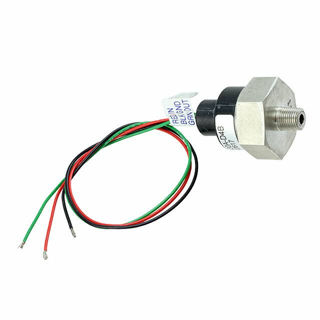

| P265 STAINLESS STEEL PRESSURE TRANSDUCER Introduction The model P265 is based on Kavlico’s field proven ceramic capacitive technology with the latest state-of-the-art ASIC. Featuring a 303SS housing, the P265 is designed for general use wherever a rugged and reliable pressure transducer is required. The P265 package has a built-in MetriPack 150, electrical connector and supports popular process connection threads. The P265 is offered with a variety of seal materials and is suitable for many diverse applications. Specifically intended for OEM applications, the P265 delivers a cost effective solution without compromising performance or reliability. Features • Dry Media (1) • Superior Long Term Stability • Excellent Repeatability/Hysteresis • Superior EMI/RFI Rejection • Low Power Consumption • Linear Output • Temperature Compensated • Over-Voltage, Reverse Polarity & Short Circuit Protection • Ten Million Cycle Life Expectancy • Outstanding Shock & Vibration Performance Applications • Steam Sterilizers • Gasoline & Diesel Engines • Natural Gas & CNG Engines • Agricultural Chemical Equipment • Level Measurement • Test Equipment • Injection Molding • Coolant Pressure • Industrial Compressors MAIN FEATURES Pressure Ranges 0 to 15 up to 0 to 1000 PSI Electrical Connection Packard Electric Metri-Pack 150 Series, 12” 20” AWG leads Pressure Connection 1/4-18 NPT (external), 3/8-24 UNF-2A (male) (2) Housing Material 303 Stainless Steel Output Signal 0.5 - 4.5 VDC Page 1 Copyright © 2018 Sensata Technologies, Inc. www.sensata.com SPECIFICATIONS Pressure Ranges From 0 to … PSIA, PSIG, PSIS (gage) 15 20 30 50 75 100 150 200 300 500 750 1000 Proof pressure PSIA, PSIG, PSIS 75 100 150 250 375 300 450 600 900 1500 1500 2000 Burst pressure PSIA, PSIG, PSIS 1000 1000 1000 1000 1000 2000 2000 2000 2000 2000 2000 2000 Physical Operating Life Cycle min. 10 million full pressure cycles over the full range Vibration Resistance 10 G’s peak to peak sinusoidal (10 to 2000 Hz) Shock Resistance 75 G’s ½ sinewave Drop Test 1 meter drop on concrete as per SAE J1455 / DIN EN 60068-2-3-1 Weight ≤ 100 grams (without mating connector) Ingress Protection IP 65 or IP67 - depending on electrical connector Operating Temperature -40°C to 125°C (depending on seal material) (2) Storage Temperature -40°C to 125°C (depending on seal material) (2) Media All class II fluids and gases compatible with stainless steel 303 and the internal seal ring material Total error band (3) +/-2% of span (-20 ≤ T ≤ 100° C) +/-3% of span (T < -20° C,T < 100° C) Stability coefficient +/-0.5 % of full span over 1 year Temp. Coefficients - Zero 0.2 % of span / 10 K within temperature range 0°C to + 80°C.2 % Temp. Coefficients - Span 0.2 % of span / 10 K within temperature range 0°C to + 80°C.2 % Performance Electrical Output Signal 0.5…4.5 VDC Ratiometric Operating Supply Signal 5 VDC ± 10% Power Consumption ≤ 25 mW Overvoltage Protection 16 VDC Short-circuit Proofness Yes (4) Insulation Voltage 500 VDC Reverse Polarity Protection Yes (5) Load ≥ 25 kΩ Response Time 15 ms max. to 63% of full scale pressure with step change on input Page 2 Copyright © 2018 Sensata Technologies, Inc. www.sensata.com DIMENSIONS Dimensions in mm [Inch] Before installation and operation, ensure that the appropriate pressure sensor has been selected in terms of pressure range, design and specific measuring conditions. Non-compliance can result in serious injury and/or damage to the equipment. Warning: The product information contained in this catalogue is given purely as information and does not constitute a representation, warranty or any form of contractual commitment. Kavlico reserve the right to modify their products without notice. It is imperative that we should be consulted over any particular use or application of our products and it is the responsibility of the buyer to establish, particularly through all the appropriate tests, that the product is suitable for the use or application. Under no circumstances will our warranty apply, nor shall we be held responsible for any application (such as any modification, addition, deletion, use in conjunction with other electrical or electronic components, circuits or assemblies, or any other unsuitable material or substance) which has not been expressly agreed by us prior to the sale of our products. GENERAL NOTES For wet conductive media please contact us For more options see Ordering Options (3) Including non-linearity, hysteresis, non-repeatability, zero point and full scale error corresponds to error of measurement per IEC 61298-2). Adjusted in vertical mounting position with pressure port down (4) For min. 3 intervals at 5 minutes each (5) For min. 10 seconds on assigned pins (1) (2) Page 3 Copyright © 2018 Sensata Technologies, Inc. www.sensata.com Example : P265-500S-F1A ORDERING OPTIONS P265 Family 500 P265 Pressure Transmiter, 0-500 PSIS (Sealed Gage), with Ethylene Propylene Seal Material, 1/4 - 18 NPT Pressure Connection and Mating Connector S F 1 A P265 Pressure Ranges 15: 0 - 15 PSI 20: 0 - 20 PSI 30: 0 - 30 PSI 50: 0 - 50 PSI 75: 0 - 75 PSI 100: 0 - 100 PSI 150: 0 - 150 PSI 200: 0 - 200 PSI 300: 0 - 300 PSI 500: 0 - 500 PSI 750: 0 - 750 PSI 1000: 0 - 1000 PSI Reference A: Absolute G: Gage S: Sealed Gauge Seal Material B: Nitrile C: Neoprene D: Fluorocarbon E: Fluorosilicone F: Ethylene Propylene Pressure Connection 1: 1/4 - 18 NPT (External Threads) 2: 3/8 - 24 UNF-2A (Male) 4: 1/8 - 27 NPT Built-in Electrical Connection A: Packard with Mating Connector B: 12”, 18 AWG Leads C: Packard without Mating Connector AGENCY APPROVALS & CERTIFICATIONS ROHS 2011/65/EU ROHS Directive Page 4 Sensata Technologies, Inc. (“Sensata”) data sheets are solely intended to assist designers (“Buyers”) who are developing systems that incorporate Sensata products (also referred to herein as “components”). Buyer understands and agrees that Buyer remains responsible for using its independent analysis, evaluation and judgment in designing Buyer’s systems and products. Sensata data sheets have been created using standard laboratory conditions and engineering practices. Sensata has not conducted any testing other than that specifically described in the published documentation for a particular data sheet. Sensata may make corrections, enhancements, improvements and other changes to its data sheets or components without notice. Buyers are authorized to use Sensata data sheets with the Sensata component(s) identified in each particular data sheet. HOWEVER, NO OTHER LICENSE, EXPRESS OR IMPLIED, BY ESTOPPEL OR OTHERWISE TO ANY OTHER SENSATA INTELLECTUAL PROPERTY RIGHT, AND NO LICENSE TO ANY THIRD PARTY TECHNOLOGY OR INTELLECTUAL PROPERTY RIGHT, IS GRANTED HEREIN. SENSATA DATA SHEETS ARE PROVIDED “AS IS”. SENSATA MAKES NO WARRANTIES OR REPRESENTATIONS WITH REGARD TO THE DATA SHEETS OR USE OF THE DATA SHEETS, EXPRESS, IMPLIED OR STATUTORY, INCLUDING ACCURACY OR COMPLETENESS. SENSATA DISCLAIMS ANY WARRANTY OF TITLE AND ANY IMPLIED WARRANTIES OF MERCHANTABILITY, FITNESS FOR A PARTICULAR PURPOSE, QUIET ENJOYMENT, QUIET POSSESSION, AND NON-INFRINGEMENT OF ANY THIRD PARTY INTELLECTUAL PROPERTY RIGHTS WITH REGARD TO SENSATA DATA SHEETS OR USE THEREOF. All products are sold subject to Sensata’s terms and conditions of sale supplied at www.sensata.com SENSATA ASSUMES NO LIABILITY FOR APPLICATIONS ASSISTANCE OR THE DESIGN OF BUYERS’ PRODUCTS. BUYER ACKNOWLEDGES AND AGREES THAT IT IS SOLELY RESPONSIBLE FOR COMPLIANCE WITH ALL LEGAL, REGULATORY AND SAFETY-RELATED REQUIREMENTS CONCERNING ITS PRODUCTS, AND ANY USE OF SENSATA COMPONENTS IN ITS APPLICATIONS, NOTWITHSTANDING ANY APPLICATIONS-RELATED INFORMATION OR SUPPORT THAT MAY BE PROVIDED BY SENSATA. Mailing Address: Sensata Technologies, Inc., 529 Pleasant Street, Attleboro, MA 02703, USA. Copyright © 2018 Sensata Technologies, Inc. Rev.02/09/18 CONTACT US Americas +1 (800) 350 2727 sensors@sensata.com Europe, Middle East & Africa +33 (3) 88 20 8080 position-info.eu@sensata.com Asia Pacific sales.isasia@list.sensata.com China +86 (21) 2306 1500 Japan +81 (45) 277 7117 Korea +82 (31) 601 2004 India +91 (80) 67920890 Rest of Asia +886 (2) 27602006 ext 2808 www.sensata.com
