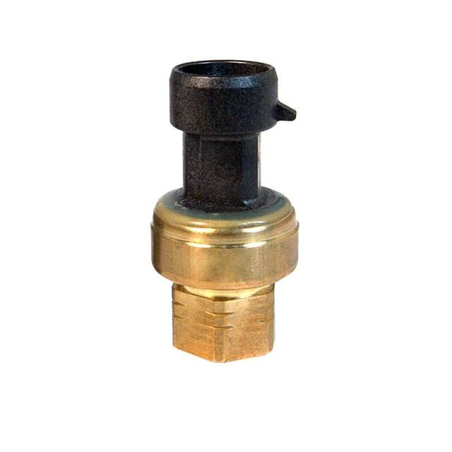

| 2CP5 & 2CP50 SERIES HVAC/Refrigeration Pressure Sensor Introduction The 2CP series is ideal for demanding air conditioning and refrigeration applications where long-term reliability and accuracy is a must. The 2CP series provides proven reliability at a competitive price. Sensata Technologies has been a leading global supplier of pressure sensors and switches for over 50 years. The 2CP has many options, consult the factory to customize a 2CP to meet your application’s needs. Features • • • • • UL recognized Ceramic capacitive sensor Durable, compact, low-cost design Accurate performance over wide temperatures Overvoltage and short circuit protected Applications • • • • • • • Discharge and suction pressure monitoring Subcooling and superheat calculations Compressor oil pressure monitoring Condenser fan control Compressor staging and unloading Electronic expansion valve control Remote systems diagnostics and trending SPECIFICATIONS Pressure Ranges Accuracy Total Error Band 0 to 15 psi, through 0 to 750 psi ±0.8% F.S. (linearity, hysteresis, repeatability and calibration) Static error band @ 25°C, 5.0VDC ±1.0% (-20°C to +85°C) ±1.5% (-40°C to +125°C) Operating Temperature -40°C to +135°C Storage Temperature 40°C to +150°C Proof Pressure 5X 15 to 75 psi, 3X 100 to 300 psi, 2X 500+ psi Burst Pressure 2CP5 - 5x operating pressure 2CP50 - 3x operating pressure Cycle Life Random Vibration Drop (any Axis) Electrical Connection 10M F.S. cycles 11g (50 to 2000 Hz) 1.5m Nema 4X, IP65 Page 1 Copyright © 2018 Sensata Technologies, Inc. www.sensata.com Supply Voltage 4.5 to 5.5 VDC Output Voltage 0.5 to 4.5 VDC typical Supply Current 7 mA (max @ 5.5 VDC no load) Output Current 2.5 mA (max sinked or source) Output Load 10K ohms typical Output Response Time 10mS Overvoltage Protection 16 VDC Reverse Voltage -14 VDC Short Circuit Protected Yes EMC (512MHz to 1 GHz) 50 V/m EMC (1 MHz to 512 MHz) 100 V/m ESD (CDF-AEC-Q100-002) 15 kV STANDARDS Sample PN Production PN Description 2CP5B0520150ANN 2CP5-71-46 Brass, 0 to 150 psia 2CP5B0520200ANN ANN 2CP5-71-49 Brass, 0 to 200 psia 2CP5B0520300SNN NN 2CP5-71-50 Brass, 0 to 300 psis 2CP5B0520400SNN N 2CP5-71-51 Brass, 0 to 400 psis 2CP5B0520500SNN 2CP5-71-47 Brass, 0 to 500 psis 2CP5S0520500SNN 2CP5-71-48 Steel, 0 to 500 psis SEAL MATERIALS Material HNBR (Hydrogenated Nitrile) Neoprene Refridgerant Maximum Seal Temperature Range R134a, R404a, R407c, R410a, R507 -20°C to 135°C R12, R22, R134a, R404a, R407c, R410a, R502, R507 -40°C to 120°C DIMENSIONAL DRAWINGS Page 2 Copyright © 2018 Sensata Technologies, Inc. www.sensata.com Example : 2CP5-S-05-2-XXXX-A-N-N ORDERING OPTIONS 2CP5 Pressure Range S 05 2 XXXX A N N 2CP5 = Up to 500 psi 2CP50 = Above 500 psi Pressure Connection Material S = Plated steel B = Brass (2CP5 only) Pressure Connection 05 = 1/4” SAE female flare with deflator, 7/16”-20 UNF-2B Electrical Connection 2 = Packard Metri-Pack (Mates with Packard # 12065287) Connector Harness N = None required Y = Packard wire harness, 1 meter standard wire Seal Material H = HNBR (Hydrogenated Nitrile) N = Neoprene Pressure Reference A = Absolute S = Sealed gage G = Vented gage Pressure Ranges (see standards below) From 0-15 psi (0015) to 0-750 psi (0750) From 0-1 bar (M001) to 0-50 bar (M050) AGENCY APPROVALS & CERTIFICATIONS UL recognized file #SA995 RoHS, REACH available Page 3 Sensata Technologies, Inc. (“Sensata”) data sheets are solely intended to assist designers (“Buyers”) who are developing systems that incorporate Sensata products (also referred to herein as “components”). Buyer understands and agrees that Buyer remains responsible for using its independent analysis, evaluation and judgment in designing Buyer’s systems and products. Sensata data sheets have been created using standard laboratory conditions and engineering practices. Sensata has not conducted any testing other than that specifically described in the published documentation for a particular data sheet. Sensata may make corrections, enhancements, improvements and other changes to its data sheets or components without notice. Buyers are authorized to use Sensata data sheets with the Sensata component(s) identified in each particular data sheet. HOWEVER, NO OTHER LICENSE, EXPRESS OR IMPLIED, BY ESTOPPEL OR OTHERWISE TO ANY OTHER SENSATA INTELLECTUAL PROPERTY RIGHT, AND NO LICENSE TO ANY THIRD PARTY TECHNOLOGY OR INTELLECTUAL PROPERTY RIGHT, IS GRANTED HEREIN. SENSATA DATA SHEETS ARE PROVIDED “AS IS”. SENSATA MAKES NO WARRANTIES OR REPRESENTATIONS WITH REGARD TO THE DATA SHEETS OR USE OF THE DATA SHEETS, EXPRESS, IMPLIED OR STATUTORY, INCLUDING ACCURACY OR COMPLETENESS. SENSATA DISCLAIMS ANY WARRANTY OF TITLE AND ANY IMPLIED WARRANTIES OF MERCHANTABILITY, FITNESS FOR A PARTICULAR PURPOSE, QUIET ENJOYMENT, QUIET POSSESSION, AND NON-INFRINGEMENT OF ANY THIRD PARTY INTELLECTUAL PROPERTY RIGHTS WITH REGARD TO SENSATA DATA SHEETS OR USE THEREOF. All products are sold subject to Sensata’s terms and conditions of sale supplied at www.sensata.com SENSATA ASSUMES NO LIABILITY FOR APPLICATIONS ASSISTANCE OR THE DESIGN OF BUYERS’ PRODUCTS. BUYER ACKNOWLEDGES AND AGREES THAT IT IS SOLELY RESPONSIBLE FOR COMPLIANCE WITH ALL LEGAL, REGULATORY AND SAFETY-RELATED REQUIREMENTS CONCERNING ITS PRODUCTS, AND ANY USE OF SENSATA COMPONENTS IN ITS APPLICATIONS, NOTWITHSTANDING ANY APPLICATIONS-RELATED INFORMATION OR SUPPORT THAT MAY BE PROVIDED BY SENSATA. Mailing Address: Sensata Technologies, Inc., 529 Pleasant Street, Attleboro, MA 02703, USA. Copyright © 2018 Sensata Technologies, Inc. Rev.02/08/18 CONTACT US Americas +1 (800) 350 2727 sensors@sensata.com switches@sensata.com Europe, Middle East & Africa +359 (2) 809 1826 pressure-info.eu@sensata.com Asia Pacific sales.isasia@list.sensata.com China +86 (21) 2306 1500 Japan +81 (45) 277 7117 Korea +82 (31) 601 2004 India +91 (80) 67920890 Rest of Asia +886 (2) 27602006 ext 2808 www.sensata.com
