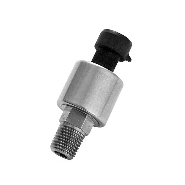

| P255 Stainless Steel Pressure Transducer Description The model P255 is based on Kavlico’s fieldproven ceramic capacitive technology with the latest state-of-the-art ASIC. Featuring a 316SS housing, the P255 is designed for general use wherever a rugged and reliable pressure transducer is required. The P255 package has a built-in Metri-Pack 150, electrical connector and supports popular process connection threads. The P255 is offered with a variety of seal materials and is suitable for many diverse applications. Specifically intended for OEM applications, the P255 delivers a cost effective solution without compromising performance or reliability. Features • Dry Media *1 • Superior Long Term Stability • Excellent Repeatability/Hysteresis • Superior EMI/RFI Rejection • Low Power Consumption • Linear Output • Temperature Compensated • Over-Voltage, Reverse Polarity & Short Circuit Protection • Ten Million Cycle Life Expectancy • Outstanding Shock & Vibration Performance 1. For wet conductive media please contact us Applications • Steam Sterilizers • Gasoline & Diesel Engines • Natural Gas & CNG Engines • Agricultural Chemical Equipment • Level Measurement • Test Equipment • Injection Molding • Coolant Pressure • Industrial Compressors MAIN FEATURES Pressure Ranges 0 to 15 up to 0 to 1000 PSI Electrical Connection Packard Electric Metri-Pack 150 Series Pressure Connection 1/4-18 NPT (external), 3/8-24 UNF-2A (male)*1 Housing Material Output Signal 316 Stainless Steel 0.5 - 4.5 VDC 1. for more options see how to order Page 1 Copyright © 2018 Sensata Technologies, Inc. www.sensata.com TECHNICAL SPECIFICATIONS Pressure Ranges PSIA, PSIG, PSIS (gage) 15 20 30 50 75 100 150 200 300 500 750 Proof Pressure (min) PSI (gage) 75 100 150 250 375 300 450 600 900 1500 1500 2000 Burst Pressure Factor PSI (gage) 100 1000 1000 1000 1000 2000 2000 2000 2000 2000 2000 2000 from 0 to... 1000 Physical Operating Life Cycle min. 10 million full pressure cycles over the full range Vibration Resistance 10 G’s peak to peak sinusoidal (10 to 2000 Hz) Shock Resistance Drop Test 75 G’s ½ sinewave 1 meter drop on concrete as per SAE J1455 / DIN EN 60068-2-3-1 Weight ≤ 100 grams (without mating connector) Ingress Protection IP67 - depending on electrical connector Operating Temperature -40°C to 125°C (depending on seal material) *2 Storage Temperature -40°C to + 125°C (depending on seal material) *2 Media All class II fluids and gases compatible with stainless steel 3/6 and the internal seal ring material 2. for more details see Ordering Options Performance Total error band *3 Stability coefficient +/-2% of span (-20 ≤ T ≤ 100° C) +/-3% of span (T < -20° C,T < 100° C) +/-0.5 % of full span over 1 year Temp. Coefficients - Zero 0.2 % of span / 10 K within temperature range 0°C to + 80°C.2 % Temp. Coefficients - Span 0.2 % of span / 10 K within temperature range 0°C to + 80°C.2 % 3. Including non-linearity, hysteresis, non-repeatability, zero point and full scale error (corresponds to error of measurement per IEC 61298-2). Adjusted in vertical mounting position with pressure port down Page 2 Copyright © 2018 Sensata Technologies, Inc. www.sensata.com Electrical Output Signal Operating Supply Signal Power Consumption 0.5…4.5 VDC Ratiometric 5 VDC ± 10% ≤ 25 mW Overvoltage Protection 16 VDC Short-circuit Proofness Yes *4 Insulation Voltage Reverse Polarity Protection Load Response Time 500 VDC Yes *5 ≥ 25 kΩ 15 ms max. to 63% of full scale pressure with step change on input 4. for min. 3 intervals at 5 minutes each 5. for min. 10 seconds on assigned pins Page 3 Copyright © 2018 Sensata Technologies, Inc. www.sensata.com DIMENSIONS Dimensions in mm [Inch] Page 4 Copyright © 2018 Sensata Technologies, Inc. www.sensata.com Example: P255-15A-B1A ORDERING OPTIONS P255Sensor, 0 - 15 PSI, Nitrile Seal Material, 1/4 - 18 NPT Pressure Connection with Mating Connector P255 Family 15 A B 1 A P255 Pressure Ranges 15 20 30 50 75 100 150 200 300 500 750 1000 0 - 15 0 - 20 0 - 30 0 - 50 0 - 75 0 - 100 0 - 150 0 - 200 0 - 300 0 -500 0 - 750 0 - 1000 Reference A: Absolute G: Gage S: Sealed Gauge (0 PSIS = 14.7 PSIA) Seal Material B: Nitrile C: Neoprene D: Fluorocarbon E: Fluorosilicone F: Ethylene Propylene Pressure Connection (Port) 1: 1/4 - 18 NPT (Male) 2: 3/8 - 24 UNF-2A (Male) 3: 3/8 - 24 UNF-2B (Female) 4: 1/8 - 27 NPT (Male) Built-in Electrical Connector A: Packard with Mating Connector C: Packard without Mating Connector AGENCY APPROVALS & CERTIFICATIONS 2011/65/EU ROHS Directive Page 5 Revised 2/7/18 Sensata Technologies, Inc. (“Sensata”) data sheets are solely intended to assist designers (“Buyers”) who are developing systems that incorporate Sensata products (also referred to herein as “components”). Buyer understands and agrees that Buyer remains responsible for using its independent analysis, evaluation and judgment in designing Buyer’s systems and products. Sensata data sheets have been created using standard laboratory conditions and engineering practices. Sensata has not conducted any testing other than that specifically described in the published documentation for a particular data sheet. Sensata may make corrections, enhancements, improvements and other changes to its data sheets or components without notice. Buyers are authorized to use Sensata data sheets with the Sensata component(s) identified in each particular data sheet. HOWEVER, NO OTHER LICENSE, EXPRESS OR IMPLIED, BY ESTOPPEL OR OTHERWISE TO ANY OTHER SENSATA INTELLECTUAL PROPERTY RIGHT, AND NO LICENSE TO ANY THIRD PARTY TECHNOLOGY OR INTELLECTUAL PROPERTY RIGHT, IS GRANTED HEREIN. SENSATA DATA SHEETS ARE PROVIDED “AS IS”. SENSATA MAKES NO WARRANTIES OR REPRESENTATIONS WITH REGARD TO THE DATA SHEETS OR USE OF THE DATA SHEETS, EXPRESS, IMPLIED OR STATUTORY, INCLUDING ACCURACY OR COMPLETENESS. SENSATA DISCLAIMS ANY WARRANTY OF TITLE AND ANY IMPLIED WARRANTIES OF MERCHANTABILITY, FITNESS FOR A PARTICULAR PURPOSE, QUIET ENJOYMENT, QUIET POSSESSION, AND NON-INFRINGEMENT OF ANY THIRD PARTY INTELLECTUAL PROPERTY RIGHTS WITH REGARD TO SENSATA DATA SHEETS OR USE THEREOF. All products are sold subject to Sensata’s terms and conditions of sale supplied at www.sensata.com SENSATA ASSUMES NO LIABILITY FOR APPLICATIONS ASSISTANCE OR THE DESIGN OF BUYERS’ PRODUCTS. BUYER ACKNOWLEDGES AND AGREES THAT IT IS SOLELY RESPONSIBLE FOR COMPLIANCE WITH ALL LEGAL, REGULATORY AND SAFETY-RELATED REQUIREMENTS CONCERNING ITS PRODUCTS, AND ANY USE OF SENSATA COMPONENTS IN ITS APPLICATIONS, NOTWITHSTANDING ANY APPLICATIONS-RELATED INFORMATION OR SUPPORT THAT MAY BE PROVIDED BY SENSATA. Mailing Address: Sensata Technologies, Inc., 529 Pleasant Street, Attleboro, MA 02703, USA. Copyright © 2018 Sensata Technologies, Inc. CONTACT US Americas +1 (800) 350 2727 sensors@sensata.com switches@sensata.com Europe, Middle East & Africa +359 (2) 809 1826 pressure-info.eu@sensata.com Asia Pacific sales.isasia@list.sensata.com China +86 (21) 2306 1500 Japan +81 (45) 277 7117 Korea +82 (31) 601 2004 India +91 (80) 67920890 Rest of Asia +886 (2) 27602006 ext 2808 www.sensata.com

物料型号:P255
器件简介: P255传感器基于Kavlico的陶瓷电容技术,采用最新的ASIC技术。它具有316SS不锈钢外壳,设计用于需要坚固可靠的压力传感器的场合。P255封装内置了Metri-Pack 150电气连接器,并支持流行的工艺连接螺纹。P255提供各种密封材料选项,适用于多种不同的应用。特别针对OEM应用设计,P255在不牺牲性能或可靠性的前提下,提供了成本效益的解决方案。
引脚分配: - A:地线 - B:供电电压 - C:输出信号 - 通过连接器的通气孔(量规):最大尺寸
参数特性: - 压力范围:0至1000 PSI - 电气连接:Packard Electric Metri-Pack 150系列 - 压力连接:1/4-18 NPT(外部),3/8-24 UNF-2A(公制) - 外壳材料:316不锈钢 - 输出信号:0.5-4.5VDC
功能详解: - 干燥介质 - 长期稳定性优越 - 出色的重复性/滞后性 - 优越的电磁干扰/射频干扰抑制 - 低功耗 - 线性输出 - 温度补偿 - 过压、反极性和短路保护 - 预期寿命为千万次循环 - 出色的抗冲击和抗振动性能
应用信息: - 蒸汽灭菌器 - 汽油和柴油发动机 - 天然气和CNG发动机 - 农业化学设备 - 液位测量 - 测试设备 - 注塑成型 - 冷却液压力 - 工业压缩机
封装信息: - 工作寿命周期:在全范围内至少1000万个全压力周期 - 抗振动性:10 G(峰-峰值)正弦波(10至2000 Hz) - 抗冲击性:75G正弦波 - 跌落测试:按照SAE J1455 / DIN EN 60068-2-3-1标准,从1米高度跌落到混凝土上 - 重量:≤ 100克(不含配对连接器) - 保护等级:IP67(取决于电气连接器) - 工作温度:-40°C至125°C(取决于密封材料) - 存储温度:-40°C至+125°C(取决于密封材料) - 介质:所有与不锈钢3/6和内部密封圈材料兼容的II类流体和气体
订购选项: 提供了不同压力范围、密封材料、压力连接(端口)和内置电气连接器的选项。
认证和合规性: 符合2011/65/EU ROHS指令。
