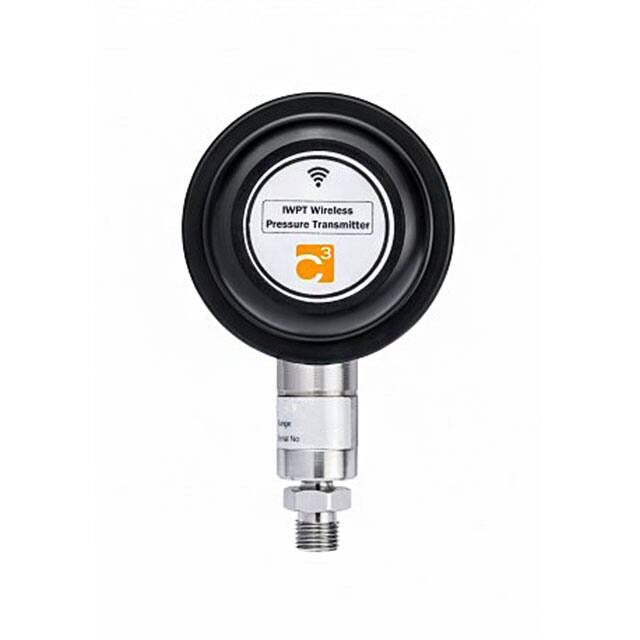

IWPTU Series Industrial Wireless Pressure Transducer Pressure ranges from -15 to +5800 psi gauge Up to 2500ft line-of-site range (depending on receiver) Piezo-resistive thick film ceramic sensor with stainless steel body Five year battery life at 10 second transmission update rate Simple DIL switch pairing with the single or five channel receiver Single or five channel receivers available User-selectable transmission update rates User-selectable 1-5V or 4-20mA receiver outputs Receiver clean contacts provide process alarm functions DESCRIPTION The IWPTU Wireless Pressure Transducer is a cost effective replacement to a traditionally wired pressure transducer that offers the advantages of a low-cost installation in inaccessible and expensive installation environments. TYPICAL APPLICATIONS INCLUDE:- Simple cable replacement installation – dispense with expensive cable runs - Environmental monitoring – pumping stations, sewage plants, water treatment - Facilities management – boiler rooms, plant hydraulics, plant pneumatics - Asset monitoring – tanks farms, process plants, HVAC and building management - Service Contract – temporary installation for servicing and field trials Transmitter Pressure Ranges Nominal Pressure, Gauge, psi Compound range psi Permissible Overpressure psi Burst Pressure psi Transmitter Output *Transmission Frequency Transmit Power System Channel Antenna *Compliant with EN 300 328, V1.8.1 Cynergy3 Components Ltd. Ferndown Industrial Estate 7 Cobham Road Wimborne, Dorset BH21 7PE Telephone +44 (0) 1202 897969 Email:sales@cynergy3.com It is easily paired to the compatible IWR family of single- or five-channel wireless receivers thus offering a “plug and play” solution to your pressure measurement applications. The instrument uses a piezo-resistive ceramic sensor mounted within a 316 stainless steel housing giving excellent media compatibility for the harshest of applications. The IWPT sensor should be used with either an IWR-1 or IWR-5 receiver. A line-of-sight range of up to 2500ft is possible depending on the wireless receiver used (refer to datasheets IWR-1 & IWR-5 for further information). Each device is temperature compensated, calibrated and supplied with a traceable serial number. 15 30 75 150 300 750 1500 -15 to 0 -15 to 30 -15 to 75 -15 to 1235 -15 to 285 -15 to 360 30 60 150 300 600 1500 3000 60 75 180 375 750 1800 3750 2.4 Ghz 18 dBm User selectable via DIL switch Integral 0dBi 6000 6000 7500 9750 9750 System Performance Accuracy (Non-Linearity & Hysteresis) Setting Errors (offsets) Instrument Power Source Battery Type Battery Life Battery Shelf Life
