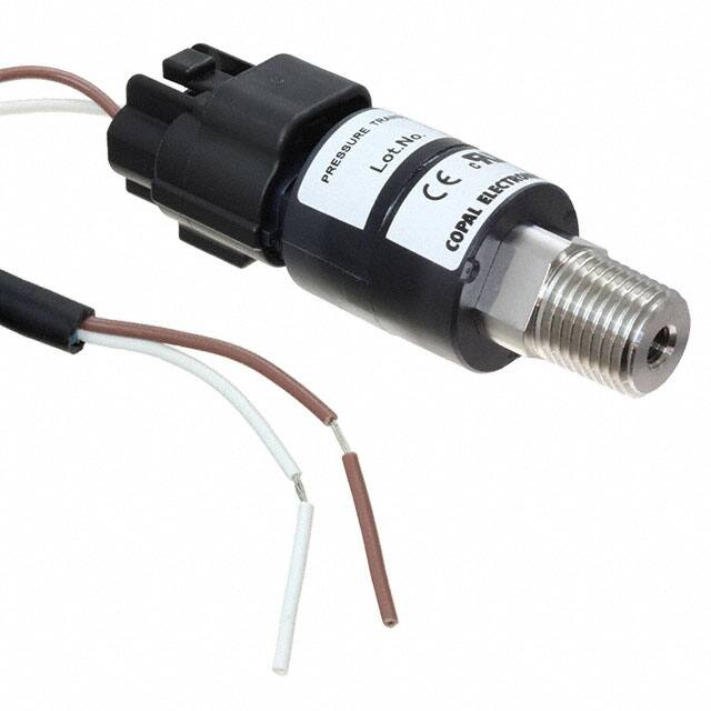

PRESSURE TRANSDUCERS WITH AMP. PA-758 マーキング EMC指令適合 INTERNAL STRUCTURE PA-758 (R 1/4) marking Compatible with EMC directive ③ ① ② Part name ■ FEATURES ① Fitting ② Housing ③ Stainless steel diaphragm Material SUS 304 PPS SUS 316L ● High corrosion resistance and drip-proof construction Pressure port attachment made of SUS 316L Proven IP65 grade gauge body (IP-65 in accordance with IEC) ● Cable connector connection ● Buit-in temperature compensation function (0 ~ 50°C) ● Absolute pressure type and compound pressure type which can control negative to positive pressure with only a single pressure gauge are all in line ● Current output mode ■ MODEL NUMBER DESIGNATION PA-758 - 102 R - R2 - 1 Series name Cable Blank:1.5m cable 1:Not attached Pressure reference Rated pressure range G:Gauge 102:0 352:0 103:0 353:0 ~ ~ ~ ~ 100 kPa 350 kPa 1 MPa 3.5 MPa V:Gauge(Vacuum) 102:0 ~ − 100 kPa R:Compound 102:− 100 ~ 100 kPa 302:− 100 ~ 300 kPa A:Absolute 102:0 ~ 100 kPa abs ※ Please refer to the LIST OF MODEL NUMBERS when placing orders. Fitting R1:R 1/8 with M 5 female screw R2:R 1/4 with M 5 female screw PA-758 PRESSURE TRANSDUCERS WITH AMP. ■ LIST OF MODEL NUMBERS Fitting R1 R2 Pressure reference Cable Gauge 0 ~ 100 Rated pressure range 0 ~ 350 PA-758102G-R1 PA-758102G-R1-1 PA-758102G-R2 PA-758102G-R2-1 Attached Not attached Attached Not attached PA-758352G-R1 PA-758352G-R1-1 PA-758352G-R2 PA-758352G-R2-1 0 ~ 1000 PA-758   103G-R1 PA-758   103G-R1-1 PA-758   103G-R2 PA-758   103G-R2-1 Absolute 0 ~ 3500 PA-758   353G-R1 PA-758   353G-R1-1 PA-758   353G-R2 PA-758   353G-R2-1 0 ~ − 100 − 100 ~ 100 − 100 ~ 300 0 ~ 100 (abs) PA-758102V-R1 PA-758102V-R1-1 PA-758102V-R2 PA-758102V-R2-1 PA-758   102R-R1 PA-758   102R-R1-1 PA-758   102R-R2 PA-758   102R-R2-1 PA-758   302R-R1 PA-758   302R-R1-1 PA-758   302R-R2 PA-758   302R-R2-1 PA-758   102A-R1 PA-758   102A-R1-1 PA-758   102A-R2 PA-758   102A-R2-1 ※ Verify the above model numbers when placing orders. The products marked are manufactured upon receipt of order basis. ■ STANDARD SPECIFICATIONS ● Unless otherwise specified, the specs are defined at an ambient temperature of 25 ± 5 °C and excitation voltage of 24 V DC, load resistance of 250 Ω . Item PA-758 Model number 102G Pressure reference General specifications kPa 103G 353G 102V 102R 302R     Gauge Rated pressure range 102A Absolute − 100 ~ 100 − 100 ~ 300 100 350 1000 3500 − 100 Maximum pressure kPa 200 700 2000 5000 200 200 600 200 (abs) Break-down pressure kPa 300 1050 3000 7000 300 300 900 300 (abs) Operating temp. range °C − 20 ~ 70 Compensated temp. range °C 0 ~ 50 Operating humidity Storage temp. %RH °C Pressure medium Insulation resistance 35 ~ 85(No condensation) − 20 ~ 80(Atmospheric pressure, humidity 65 %RH maximum) Corrosive gases/liquids compatible with SUS316L and SUS304 MΩ minimum 100 (500 V DC) 500 V AC, 60 s(Leakage current 1 mA maximum) Dielectric strength Sealed liquid Silicone oil Pressure port R 1/8、R 1/4 Net weight g Drip-proof structure Power 352G Supply voltage R2 : Approx. 50 IP65 V DC 24 ± 10 %(Including ripple percentage) 100 (abs) PA-758 PRESSURE TRANSDUCERS WITH AMP. Item PA-758 Model number Output current 102G 352G 103G 353G mA (at 25 °C) mA (at 25 °C) Span current 4 ± 0.2 302R 102A 12 ± 0.2 8 ± 0.2 4 ± 0.2 ± 0.1 ± 0.3 16 ± 0.2 0 ~ 500 Ω Load resistance Analog output 102R 4 ~ 20 mA mA Zero current 102V %F.S. ± 0.5 ZERO %F.S./°C ± 0.05 SPAN %F.S./°C ± 0.05 Linearity/Hysteresis Thermal error Response ms Approx. 2 Approx. 0.016 mA(Approx. 0.1%F.S.) resolving power Gravitational effect %F.S. (From horizontal position to vertical position) ± 0.3 ± 0.1 ± 0.3 ± 0.05 ■ ENVIRONMENTAL CHARACTERISTICS Test item Permissible change 内部電気回路 INTERNAL ELECTRICAL SCHEMATICS Test conditions (At 25 ± 5 °C) 10 ~ 500 Hz, 1.5 mm maximum/98.1 m/s , 3 directions for 2 hours each 490 m/s2 3 directions for 3 times each 2 Vibration Shock Pressure cycling 0 ~ Rated pressure/Rated pressure range 106 cycles Moisture resistance 40 °C, 90 ~ 95 %RH, 240 hrs. Zero current, Span current: ± 1 %F.S. maximum each Pressure ■ RECOMMENDED EXTERNAL SCHEMATICS 内部電気回路 INTERNAL ELECTRICAL SCHEMATICS Sensor 参考外部回路 RECOMMENDED EXTERNAL SCHEMATICS Power + Output Main circuit Main circuit CAL ■ INTERNAL ELECTRICAL SCHEMATICS Pressure Sensor Power + Output Pressure Sensor Main circuit Power + RL:250 V 24V DC Output CAL CAL(N.C) 参考外部回路 RECOMMENDED EXTERNAL SCHEMATICS Pressure Sensor Main circuit Power + RL:250 V Output CAL(N.C) ※ Do not wire the CAL connection. It may cause malfunction when voltage is applied. **…Calibration 24V DC 注) CAL端子には配線をしないでください。   電圧が付加されると故障の恐れがあります                 **…Calib ※ Do not wire the CAL connection.   It may cause malfunction when voltage                 **…Calib PA-758 PRESSURE TRANSDUCERS WITH AMP. ■ OUTLINE DIMENSIONS Unless otherwise specified, tolerance : 0.5 (Unit: mm) ● Configurations of joint R1 (R1/8) type φ23.5 43.6 11 7 Plug Housing 2822390-1 ① ② PRESSURE TRANSDUCER L O T . N o .  *** PA- 758-***□- R1 MADE IN JAPAN R1/8 Fitting (SUS304) 14 ③ Housing (PPS) PA-758 Output connector Plug Tyco Electronics Japan G.K. Econoseal Series〔Mark ll(+)〕 Label 2 14 Pressure Port M5 depth 6 18 Label 1 Power(+) Output CAL. 〈Note〉When CAL. is connected, the main unit of the sensor might malfunction or be damaged. Econoseal Series〔Mark ll(+)〕 Tyco Electronics Japan G.K Plug Housing:2822390-1 Receptacle contact:171630-5 30.9 With connector Wire color Brown White 3-core shield cable (φ5.3) L O T . N o .  *** PRESSURE TRANSDUCER MADE IN JAPAN PA- 758-***□-* AWG22UL2517 Connection Power ⊕ Output 50 ± 10 L = 1500 ± 100 ● Configurations of joint R2 (R1/4) type φ23.5 45.5 Pressure Port M5 depth 6 13 7 18 Label 1 Label 2  *** 14 Housing (PPS) PRESSURE TRANSDUCER LOT.No. R1/4 Fitting (SUS304) Tyco Electronics Japan G.K. Econoseal Series〔Mark ll(+)〕 Plug Housing 2822390-1 PA-758-***□-R2 MADE IN JAPAN 14 Output connector Plug ① Power(+) ② Output ③ CAL. 〈Note〉When CAL. is connected, the main unit of the sensor might malfunction or be damaged. PA-758 PRESSURE TRANSDUCERS WITH AMP. ■ CUSTOMIZATION We also offer customized solutions. Please contact your local sales office for details. Example of customizations Available with cable assembly (standard length:1.5m) Customized pressure range 402A(0~400kPa abs)*for sterilizer use 5V operation Customized joint (7/16-20UNF Male/Female screw etc.) ■ AVAILABLE WITH CABLE ASSEMBLY : REFERENCE DRAWING Unless otherwise specified, tolerance : ±0.5 (Unit: mm) ● Configurations of joint R1 (R1/8) type Φ 23.5 11 7 30.6 (20) Heat shrink tube 14 (Φ 7) (Φ 5.5) Pressure port 14 R1/8 Fitting (SUS304) Housing (PPS) L=1500 ± 100 Connection Blown Power White Output Blue Calibration Shield ● Configurations of joint R2 (R1/4) type ※Do not connect the blue wire. Φ 23.5 13 7 30.6 (20) 14 14 R1/4 Fitting (SUS304) Housing (PPS) L=1500 ± 100 (Φ 5.5) (Φ 7) Pressure port Heat shrink tube
