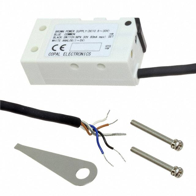

PS40 PRESSURE SWITCHES INTERNAL STRUCTURE (M5 female screw) 1 3 4 Part name ■ FEATURES ● Compatible with non-corrosive gases ● Solidstate pressure switch with no mechanical moving parts ● 2 types of pressure ports are available ● Open collector output of either NPN or PNP is available ● Analog output type available 2 Material POM (Polyoxymethylene) 1 Pressure port 2 Housing PC (Polycarbonate) 3 “O” ring Fluoro-rubber 4 Port block LCP (Liquid crystal polymer) ■ MODEL NUMBER DESIGNATION P S 4 0 - 1 0 2 G - N A R Series name Pressure port Rated pressure range R:R 1/8 male screw M:M 5 female screw 501:0 ~ 50 kPa 102:0 ~ 100 kPa 103:0 ~ 1000 kPa Outputs A:1 switch output with adjustable hysteresis and analog output W:2 switch output Pressure reference G:Gauge V :Gauge (Vacuum) Switch output interface N:NPN open collector P:PNP open collector ■ LIST OF MODEL NUMBERS Pressure port R 1/8 male screw M 5 female screw Outputs Adjustable hysteresis switch output + Analog output 2 points switch output Adjustable hysteresis switch output + Analog output 2 points switch output : Not available ❈ Verify the above model numbers when placing orders. Switch output NPN open collector output PNP open collector output NPN open collector output PNP open collector output NPN open collector output PNP open collector output NPN open collector output PNP open collector output    102V  −100 kPa 501G 50 kPa  102G   100 kPa 103G 1000 kPa PS40-102V-NAR PS40-501G-NAR PS40-102G-NAR PS40-103G-NAR PS40-102V-PAR PS40-102G-PAR PS40-103G-PAR PS40-102V-NWR PS40-501G-NWR PS40-102G-NWR PS40-103G-NWR PS40-102V-PWR PS40-102G-PWR PS40-103G-PWR PS40-102V-NAM PS40-501G-NAM PS40-102G-NAM PS40-103G-NAM PS40-102V-PAM PS40-102G-PAM PS40-103G-PAM PS40-102V-NWM PS40-501G-NWM PS40-102G-NWM PS40-103G-NWM PS40-102V-PWM PS40-102G-PWM PS40-103G-PWM PS40 PRESSURE SWITCHES ■ STANDARD SPECIFICATIONS ● Unless otherwise specified, the specs are defined at an ambient temperature of 25±5 °C and excitation voltage of 12 V DC. Item Model number 102V 501G General specifications Pressure reference Gauge kPa Maximum pressure kPa 200 100 200 1500 Break-down pressure kPa 500 250 500 2000 50 100 °C − 20 ~ 70 Compensated temp. range °C 0 ~ 50 Operating humidity Storage temp. %RH °C Pressure medium Net weight MΩ minimum Consumption current − 20 ~ 80 100 (500 V DC) 500 V AC, 60 s(Leakage current 1 mA maximum) R 1/8(Female screw)or “O” ring groove(Female screw) g Supply voltage 35 ~ 85(No condensation) Non-corrosive gases Pressure port Power − 100 Operating temp. range Dielectric strength V DC maximum No. of outputs Switch output 103G Rated pressure range Insulation resistance Approx. 50 10.8 ~ 30 V(Including ripple percentage) 17 mA(Only W type 25 mA maximum) 1 or 2 Output interface Open collector output (NPN or PNP) Setting method Adjustable by VR Adjustable range Zero through rated pressure minimum Display Accuracy Red LED ON (W type only : SW1 Red, SW2 Green) (Reference temp.: 25 °C) % F.S. Hysteresis Residual voltage Response ±3 Approx. 1 ~ 15 % of the set value (W type only 2 % F.S. maximum) 30 V 80 mA Switching capacity Analog output 102G V maximum ms 0.8 (NPN), 1.2 (PNP) Approx. 1 Output voltage V 1~5 Zero voltage V 1 ± 0.1 Span voltage V 4 ± 0.1 Output current mA maximum 1(Load resistance 5 kΩ minimum) 1000 PS40 PRESSURE SWITCHES ■ ENVIRONMENTAL CHARACTERISTICS Test item Test conditions (At 25 ± 5 °C) Permissible change Vibration 10 ~ 500 Hz, 1.5 mm maximum/98.1 m/s2, 3 directions for 2 hours each Shock 490 m/s2, 3 directions for 3 times each Pressure cycling 0~Rated pressure, 10 cycles Moisture resistance 40 °C, 90 ~ 95 %RH, 240 hrs. Switch output setting and analog output (Zero voltage/span voltage): ± 2 %F.S. maximum, each 6 ■ OUTLINE DIMENSIONS Unless otherwise specified, tolerance : ± 0.5 (Unit: mm) ● NAR, PAR, NWR, PWR 2 – q 3.3 Through hole Polyacetal Polycarbonate Indicator LED1 (Red) 3.1 ( 11 22.4 2 – q 3.3 Through hole Pressure setting VR ※No.1 switch setting in case of 2 switch outputs 2 ± 0.3 24.8 ± 0.3 M 5 depth 5 Pressure port R 1/8 15 ) Indicator LED 2 (Green) ※In case of 2 switch outputs ( q 3.8) 4-core shielded cable L = 1500 ± 50 AWG 26 ULNo.2844 Label 4.5 45 ± 0.5 8.5 ± 0.3 Hysteresis adjustment VR ※No.2 switch setting in case of 2 switch outputs ● NAM, PAM, NWM, PWM 2 – φ 3.3 Through hole Polyacetal Polycarbonate 3.1 Indicator LED1 (Red) 22.4 2 – M 3 depth 4.5 2 – φ 3.3 Through hole 10 15 φ 13 2 ± 0.3 12 24.8 ± 0.3 φ 8 19 M 5 depth 5 Pressure port ( 11 4.5 Label 45 ± 0.5 Indicator LED 2 (Green) ※In case of 2 switch outputs ) Pressure setting VR ※No.1 switch setting in case of 2 switch outputs ( φ 3.8) 4-core shielded cable L = 1500 ± 50 AWG 26 ULNo.2844 Hysteresis adjustment VR ※No.2 switch setting in case of 2 switch outputs PS40 PRESSURE SWITCHES PS40 (NAM, NAR, PAM, PAR) Wire color PS40 (NWM, NWR, PWM, PWR) Connection Wire color Connection Brown Power B Brown Power B Black Switch output Black Switch output 1 White Analog output White Switch output 2 Blue Common Blue Common Shield N.C. Shield N.C. ■ INTERNAL ELECTRICAL SCHEMATICS ● NAM, NAR(NPN) ●PAM, PAR(PNP) LED Indicator Power B Power B Load Pressure Sensor Main circuit Pressure S.Output Main circuit Sensor A.Output A.Output S.Output Load Common Common FG FG ● NWM, NWR(NPN) 1 2 ●PWM, PWR(PNP) LED Indicator 1 2 LED Indicator Power B Sensor Main circuit Power B Load Load Pressure S.Output1 S.Output2 Pressure Sensor S.Output1 S.Output2 Main circuit Load Common Load Common FG FG ■ SWITCH OUTPUT SCHEMATICS ● PS40- *** G ● PS40-102V Hysteresis Hysteresis ON ON OFF OFF -100 kPa Set value Barometic pressure Barometic pressure ※ * A * is adjustable hysteresis type. Set value Rated pressure
