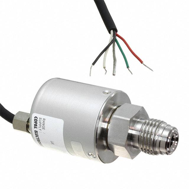

PA-830 PRESSURE TRANSDUCERS WITH AMP. INTERNAL STRUCTURE PA-830 (G 1/8) 5 3 4 1 2 Part name ■ FEATURES ● High corrosion resistance by double diaphragm structure ● Built-in amplifier circuit ● 2 types to choose from (Gauge and Absolute pressures) ● Incorporating temperature compensation function (0 ~ 50 °C) ● Voltage output mode ● Available with a ※ VCR® fitting 1 Fitting 2 “O” ring 3 Housing 4 Compensation resistor board 5 Sealed liquid Material SUS 316L (P15 or P12.5) Fluoro-rubber Aluminum Ceramic Silicone oil ■ MODEL NUMBER DESIGNATION PA-830-102 A-05 Series name Thermal error/Fitting Rated pressure range 05:± 0.05 % F.S./°C, G 1/8 10:± 0.1 % F.S./°C, G 1/8 R2:± 0.05 % F.S./°C, R 1/4 VCR:± 0.05 % F.S./°C, VCR® 101:0 ~ 9.8 kPa {0 ~ 0.1 kgf/cm2} 351:0 ~ 34.3 kPa {0 ~ 0.35 kgf/cm2} 501:0 ~ 49.0 kPa {0 ~ 0.5 kgf/cm2} 102:0 ~ 98.1 kPa {0 ~ 1 kgf/cm2} 352:0 ~ 343 kPa {0 ~ 3.5 kgf/cm2} 103:0 ~ 981 kPa {0 ~ 10 kgf/cm2} Pressure reference G:Gauge A:Absolute V:Gauge (Vacuum) ※ Please refer to the LIST OF MODEL NUMBERS when placing orders. ※ VCR® is a registered trade name of Cajon Co. CAJON® is a registered trade name of Swagelok Co. Note: For handling of VCR fittings, please contact a service center of Swagelok Co. PA-830 PRESSURE TRANSDUCERS WITH AMP. ■ LIST OF MODEL NUMBERS Pressure reference Output {% F.S./°C} Thermal error kPa {kgf/cm2} 0 ~ 9.8 Rated pressure range {0 ~ 0.1} ± 0.05 Fitting:R 1/4 Fitting:VCR ± 0.10 0 ~ 49.0 {0 ~ 0.5} PA-830 -501G-05 PA-830 -501G-R2 PA-830 -501G-VCR PA-830 PA-830 -101G-10 -501G-10 Fitting:G 1/8 Voltage output Gauge Absolute Fitting:G 1/8 0 ~ 98.1 {0 ~ 1} 0 ~ 343 {0 ~ 3.5} 0 ~ 981 {0 ~ 10} 0 ~ − 98.1 {0 ~ − 1} 0 ~ 34.3 {0 ~ 0.35} 0 ~ 98.1 {0 ~ 1} PA-830 -102G-05 PA-830 -102G-R2 PA-830 -102G-VCR PA-830 -102G-10 PA-830 -352G-05 PA-830 -352G-R2 PA-830 -352G-VCR PA-830 -352G-10 PA-830 -103G-05 PA-830 -103G-R2 PA-830 -103G-VCR PA-830 -103G-10 PA-830 -102V-05 PA-830 -102V-R2 PA-830 -102V-VCR PA-830 -102V-10 PA-830 -351A-05 PA-830 -351A-R2 PA-830 -351A-VCR PA-830 -351A-10 PA-830 -102A-05 PA-830 -102A-R2 PA-830 -102A-VCR PA-830 -102A-10 :Not available ※ Verify the above model numbers when placing orders. ■ STANDARD SPECIFICATIONS ● Unless otherwise specified, the specs are defined at an ambient temperature of 25±5 °C and excitation voltage of 12 V DC. Item PA-830 Model number 101G 501G 102G 352G 103G 102V 351A 102A Pressure reference Rated pressure range Maximum pressure General specifications Break-down pressure 9.8 49.0 98.1 343 981 − 98.1 34.3 (abs) 98.1 (abs) kPa {kgf/cm2} {0.1} {0.5} {1} {3.5} {10} {−1} {0.35} {1} 19.6 98.1 196 686 1961 196 103 (abs) 196 (abs) kPa {kgf/cm2} {0.2} {1} {2} {7} {20} {2} {1.05} {2} 147 294 1030 2942 294 147 (abs) 294 (abs) kPa {kgf/cm2} 29.4 {0.3} {1.5} {3} {10.5} {30} {3} {1.5} {3} Operating temp. range °C − 20 ~ 70 Compensated temp. range °C 0 ~ 50 Operating humidity Storage temp. %RH °C Pressure medium Insulation resistance 35 ~ 85(No condensation) − 20 ~ 70(Atmospheric pressure, humidity 65 %RH maximum) Corrosive gases/liquids compatible with SUS 316L MΩ minimum Dielectric strength 100 (500 V DC) 500 V AC, 60 s(Leakage current 1 mA maximum) Sealed liquid Silicone oil Pressure port G 1/8 (PF 1/8)、R 1/4 (PT 1/4)、1/4 VCR® ※ 2 Net weight Power Gauge Absolute g Approx. 140 Supply voltage V DC 12 ~ 24 ± 10 % Ripple content maximum 10 % (P-P) Consumption current mA maximum 20 ※ 1 PA-830-VCR : Also compatible with SUS316. ※ 2 An “O” ring is provided for only G1/8 type. (Positive pressure : P15, Negative/Absolute Pressure : P12.5) ※1 PA-830 PRESSURE TRANSDUCERS WITH AMP. Item Output voltage 101G 501G 102G 352G 103G 102V 351A 102A 1~5 V DC Zero voltage V 1 ± 0.04 (at 25 °C) Span voltage V 4 ± 0.04 (at 25 °C) mA maximum Output current Analog output PA-830 Model number Linearity/Hysteresis Thermal error 0 ~ 50 °C (Reference temp.: 25 °C) Supply voltage effect Response 1(Load resistance 5 kΩ minimum) %F.S. ± 0.5 ± 0.3 ± 0.5 ZERO %F.S./°C ± 0.05/± 0.1 ※ 3 SPAN %F.S./°C ± 0.05/± 0.1 ※ 3 V maximum ± 0.3 ± 0.5 ± 0.1 Approx. 2 ms Gravitational effect %F.S. (From vertical position to horizontal position) max. Approx. 1 Approx. 0.5 Approx. 0.3 Approx. 0.1 Approx. 0.05 Approx. 0.3 Approx. 0.5 Approx. 0.3 ※ 3 The thermal error of the PA-830-101G will be ± 0.1 %F.S./°C only. ■ ENVIRONMENTAL CHARACTERISTICS Test item Test conditions (At 25 ± 5 °C) Permissible change Vibration 10 ~ 500 Hz, 1.5 mm maximum/98.1 m/s , 3 directions for 2 hours each Shock 490 m/s2, 3 directions for 3 times each Pressure cycling 0 ~ Rated pressure, 106 cycles Moisture resistance 40 °C, 90 ~ 95 %RH, 240 hrs. 2 Zero voltage, Span voltage: ± 1 %F.S. maximum each and ±3 %F.S. (101G) each ■ INTERNAL ELECTRICAL SCHEMATICS Power B Pressure Sensor Main circuit Output Common Shield PA-830 PRESSURE TRANSDUCERS WITH AMP. ■ OUTLINE DIMENSIONS Unless otherwise specified, tolerance : ± 0.5 (Unit: mm) PA-830 ● G1/8 type 22.5 12 22 AWG26 ULNo.2844 (φ 3.8) 4 – core shielded cable L = 1500 ± 50 Part No. label 8 Wire color Red White Green Black Shield Cable bush (ESS-1) “O” ring groove depth 1.8 P 12.5 P 15 M 5 depth 6 Pressure port G 1/8 (PF 1/8) (SUS 316L) φ 30 8 1/4 外形図 5 ± 51 SN plate label (10) Housing (Aluminum with alumite finish) ● R1/4 type (10) 56 ± 1 SN plate label 23.5 22 13.5 AWG26 ULNo.2844(φ 3.8) 4 – core shielded cable L = 1500 ± 50 Part No. label VCR) 外形図 φ 30 (25.4) 8 8 Cable bush (ESS-1) M 5 depth 6 Pressure port Housing (Aluminum with alumite finish) R 1/4 (PT 1/4) (SUS 316L) ● VCR type (10) 59 ± 1 (26.5) (16) 8.5 SN plate label Part No. label AWG26 ULNo.2844 (φ 3.8) 4 – core shielded cable L = 1500 50 φ 30 8 19 Cable bush (ESS-1) 1/4 VCR (SUS 316) Housing (Aluminum with alumite finish) Connection Power B Output N.C. Common Fitting
