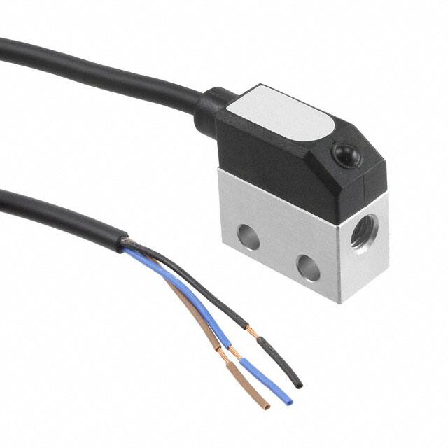

PA-20 PRESSURE TRANSDUCERS WITH AMP. マーキング EMC指令適合 INTERNAL STRUCTURE marking (Universal joint) Compatible with EMC directive 6 1 4 3 5 2 Part name ■ FEATURES ● Ultra-small size pressure transducer with Amp. ● 2 types of pressure ports are available ● Meet EMC standards Material SUS 304 1 Pressure Port 2 Housing 3 Sensor module 4 “O” ring Fluoro-rubber 5 Cable Vynyl chloride 6 Gasket POM (Polyoxymethylene) PC (Polycarbonate) PPS (Polyphenylene sulphide) ■ MODEL NUMBER DESIGNATION PA-20-102V-U-3M Series name Cable length Blank:1.5 m 3M:3 m Rated pressure range Pressure port 102V:0 ~ −100 kPa(Gauge – Vacuum) 302R:−100 ~ 300 kPa(Gauge – Compound) U:Universal joint (M5 male screw) M:2-M5 female screw ■ LIST OF MODEL NUMBERS Pressure port Universal joint 2-M5 female screw Cable length Rated pressure range [kPa] 0 ~ – 100           – 100 ~ 300 1.5 m PA-20-102V-U PA-20-302R-U 3 m PA-20-102V-U-3M PA-20-302R-U-3M 1.5 m PA-20-102V-M PA-20-302R-M 3 m PA-20-102V-M-3M PA-20-302R-M-3M ※ Verify the above model numbers when placing orders. 48 PA-20 PRESSURE TRANSDUCERS WITH AMP. ■ STANDARD SPECIFICATIONS ● Unless otherwise specified, the specs are defined at an ambient temperature of 25±5 °C and excitation voltage of 24 V DC. Item PA-20 Model number 102V General specifications Pressure reference Gauge Rated pressure range kPa Maximum pressure kPa 200 0 ~ –100 –100 ~ 300 °C –10 ~ 60 Compensated temp. range °C 0 ~ 50 %RH Operating humidity 35 ~ 85(No condensation) °C Storage temp. –20 ~ 70 Pressure medium Non-corrosive gases MΩ minimum 100 500 V AC, 60 s Dielectric strength Net weight (Without cable) Power 600 Operating temp. range Insulation resistance Analog output 302R g V DC Supply voltage 10.8 ~ 30(Including ripple percentage) mA maximum Consumption current Output voltage V Output current mA maximum 20 1~5 1(Load resistance : 5 kΩ minimum) %F.S. Linearity/Hysteresis Thermal error (Reference temp.: 25 °C) Response Approx. 5 (PA-20- **** -U) Approx. 8 (PA-20- **** -M) ± 0.5 ZERO %F.S. ± 2 SPAN %F.S. ± 2 ms Approx.1 ■ ENVIRONMENTAL CHARACTERISTICS Test item Test conditions Vibration 10 ~ 55 Hz, 1.5 mm, 3 directions for 2 hours each Shock 1000 m/s2, 3 directions for 3 times each Pressure cycling 0 ~ Rated pressure, 106 cycles Moisture resistance 40 °C, 90 ~ 95 %RH, 240 h. EMC EMI : EN55011: 2007, A2 : 2007 Group 1, class B  EMS : EN61326-1 : 2006/EN61326-2-3 : 2006 Table 2 permissible change Analog output : ± 2 %F.S. maximum after test Analog output ± 5 %F.S. maximum during test PA-20 PRESSURE TRANSDUCERS WITH AMP. ■ OUTLINE DIMENSIONS Unless otherwise specified, tolerance : ± 0.5 (Unit: mm) ● Universal joint type 3.53.5 10.5 10.5 Housing Housing 1010 M5 M5 Pressure port:SUS 304 Pressure port:SUS 304 Gasket Gasket 10.8 10.8 0.50.5 0 0 1010 –0.3 –0.3 φ 6.5 φ 6.5 0 8 –0.3 0 8 –0.3 20 20 5.5 5.5 3-core cable (φ 3.2) AWG26 UL No.2851 (φ 3.2) AWG26 UL No.2851 3-core I = 1500cable 75 (PA-20-****-*) II == 1500 3000 75 150(PA-20-****-*) (PA-20-****-*-3M) I = 3000 150 (PA-20-****-*-3M) ● M5 female screw type 2 – M5 depth 5 2 – M5 depth Pressure port :5AI Alumite Pressure port : AI Alumite 10 10 2 – φ 3.5 2 – φ 3.5hole Through Through hole 20.5 20.5 5 5 5 5 3.33.3 0 0 1010 –0.3 –0.3 Wire color Brown Blue Black ■ INTERNAL ELECTRICAL SCHEMATICS Power B Pressure Sensor Main circuit Output Common Connection Power B Common Output
