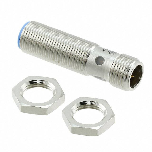

Product data sheet IME12-04BNSZC0K IME INDUCTIVE PROXIMITY SENSORS IME12-04BNSZC0K | IME INDUCTIVE PROXIMITY SENSORS A B C D E F H I J K L M N O P Q R S T Ordering information Type Part no. IME12-04BNSZC0K 1040771 Included in delivery: BEF-MU-M12 (1) Other models and accessories www.sick.com/IME Illustration may differ Detailed technical data Features Housing Cylindrical thread design Housing Short-body Thread size M12 x 1 Diameter Ø 12 mm Sensing range Sn 4 mm Safe sensing range Sa 3.24 mm Installation type Flush Switching frequency 2,000 Hz Connection type Male connector M12, 4-pin Switching output NPN Output function NO Electrical wiring DC 3-wire Enclosure rating IP67 1) 1)  According to EN 60529. Mechanics/electronics Supply voltage 10 V DC ... 30 V DC Ripple ≤ 10 % Voltage drop ≤ 2 V 1) Current consumption 10 mA 2) 1) 2) 3) 4) 2  At Ia max.  Without load.  Ub and Ta constant.  Of Sr. INDUCTIVE PROXIMITY SENSORS | SICK Product data sheet | 2021-11-22 12:29:53 Subject to change without notice IME12-04BNSZC0K | IME INDUCTIVE PROXIMITY SENSORS Time delay before availability ≤ 100 ms Hysteresis 5 % ... 15 % Reproducibility ≤ 2 % 3) 4) Temperature drift (of Sr) ± 10 % EMC According to EN 60947-5-2 Continuous current Ia ≤ 200 mA Short-circuit protection ✔ Reverse polarity protection ✔ Power-up pulse protection ✔ Shock and vibration resistance 30 g, 11 ms/10 Hz ... 55 Hz, 1 mm Ambient operating temperature –25 °C ... +75 °C Housing material Brass, nickel-plated Sensing face material Plastic, PA 66 Housing length 46 mm Thread length 29 mm Tightening torque, max. ≤ 12 Nm Items supplied Mounting nut, brass, nickel-plated (2x) UL File No. NRKH.E181493 1) 2) 3) 4)  At Ia max.  Without load.  Ub and Ta constant.  Of Sr. Safety-related parameters MTTFD 1,735 years DCavg 0 % Reduction factors Note The values are reference values which may vary St37 steel (Fe) 1 Stainless steel (V2A, 304) Approx. 0.8 Aluminum (Al) Approx. 0.45 Copper (Cu) Approx. 0.4 Brass (Br) Approx. 0.4 Installation note Remark Associated graphic see "Installation" B 24 mm C 12 mm D 12 mm F 32 mm Classifications ECl@ss 5.0 27270101 ECl@ss 5.1.4 27270101 2021-11-22 12:29:53 | Product data sheet  Subject to change without notice INDUCTIVE PROXIMITY SENSORS | SICK 3 IME12-04BNSZC0K | IME INDUCTIVE PROXIMITY SENSORS A B C D E F H I J K L M N O P Q R S T ECl@ss 6.0 27270101 ECl@ss 6.2 27270101 ECl@ss 7.0 27270101 ECl@ss 8.0 27270101 ECl@ss 8.1 27270101 ECl@ss 9.0 27270101 ECl@ss 10.0 27270101 ECl@ss 11.0 27270101 ETIM 5.0 EC002714 ETIM 6.0 EC002714 ETIM 7.0 EC002714 ETIM 8.0 EC002714 UNSPSC 16.0901 39122230 Installation note Flush installation F B C D Connection diagram Cd-007 BN 1 BK 4 2 BU 4 3 + (L+) NO not connected - (M) INDUCTIVE PROXIMITY SENSORS | SICK Product data sheet | 2021-11-22 12:29:53 Subject to change without notice IME12-04BNSZC0K | IME INDUCTIVE PROXIMITY SENSORS Dimensional drawing (Dimensions in mm (inch)) IME12 Short-body housing, connector, flush 3 1 29 (1.14) 46 (1.81) M12 x 1 2 ①  Connection ②  Display LED ③  Fastening nuts (2x); width across 17, metal Recommended accessories Other models and accessories www.sick.com/IME Brief description Type Part no. Mounting plate for M12 sensors, steel, zinc coated, without mounting hardware BEF-WG-M12 5321869 Mounting bracket for M12 sensors, steel, zinc coated, without mounting hardware BEF-WN-M12 5308447 Head A: female connector, M12, 4-pin, straight, A-coded Head B: Flying leads Cable: Sensor/actuator cable, PVC, unshielded, 2 m YF2A14020VB3XLEAX 2096234 Head A: female connector, M12, 4-pin, straight, A-coded Head B: Flying leads Cable: Sensor/actuator cable, PVC, unshielded, 5 m YF2A14050VB3XLEAX 2096235 Head A: female connector, M12, 4-pin, straight, A-coded Head B: Flying leads Cable: Sensor/actuator cable, PVC, unshielded, 10 m YF2A14100VB3XLEAX 2096236 Head A: female connector, M12, 4-pin, angled, A-coded Head B: Flying leads Cable: Sensor/actuator cable, PVC, unshielded, 2 m YG2A14020VB3XLEAX 2095895 Head A: female connector, M12, 4-pin, angled, A-coded Head B: Flying leads Cable: Sensor/actuator cable, PVC, unshielded, 5 m YG2A14050VB3XLEAX 2095897 Head A: female connector, M12, 4-pin, angled, A-coded Head B: Flying leads Cable: Sensor/actuator cable, PVC, unshielded, 10 m YG2A14100VB3XLEAX 2095898 Head A: female connector, M12, 4-pin, straight Head B: Cable: unshielded DOS-1204-G 6007302 Head A: female connector, M12, 4-pin, angled Head B: Cable: unshielded DOS-1204-W 6007303 Mounting brackets and plates Plug connectors and cables 2021-11-22 12:29:53 | Product data sheet  Subject to change without notice INDUCTIVE PROXIMITY SENSORS | SICK 5 IME12-04BNSZC0K | IME INDUCTIVE PROXIMITY SENSORS A B C D E F H I J K L M N O P Q R S T Brief description Type Part no. Clamping block for round sensors M12, without fixed stop, plastic (PA12), glass-fiber reinforced, mounting hardware included BEF-KH-M12 2051479 Clamping block for round sensors M12, with fixed stop, plastic (PA12), glass-fiber reinforced, mounting hardware included BEF-KHF-M12 2051480 Terminal and alignment brackets 6 INDUCTIVE PROXIMITY SENSORS | SICK Product data sheet | 2021-11-22 12:29:53 Subject to change without notice Online data sheet SICK at a glance SICK is one of the leading manufacturers of intelligent sensors and sensor solutions for industrial applications. A unique range of products and services creates the perfect basis for controlling processes securely and efficiently, protecting individuals from accidents and preventing damage to the environment. We have extensive experience in a wide range of industries and understand their processes and requirements. With intelligent sensors, we can deliver exactly what our customers need. In application centers in Europe, Asia and North America, system solutions are tested and optimized in accordance with customer specifications. All this makes us a reliable supplier and development partner. Comprehensive services complete our offering: SICK LifeTime Services provide support throughout the machine life cycle and ensure safety and productivity. For us, that is “Sensor Intelligence.” Worldwide presence: Contacts and other locations – www.sick.com SICK AG | Waldkirch | Germany | www.sick.com
