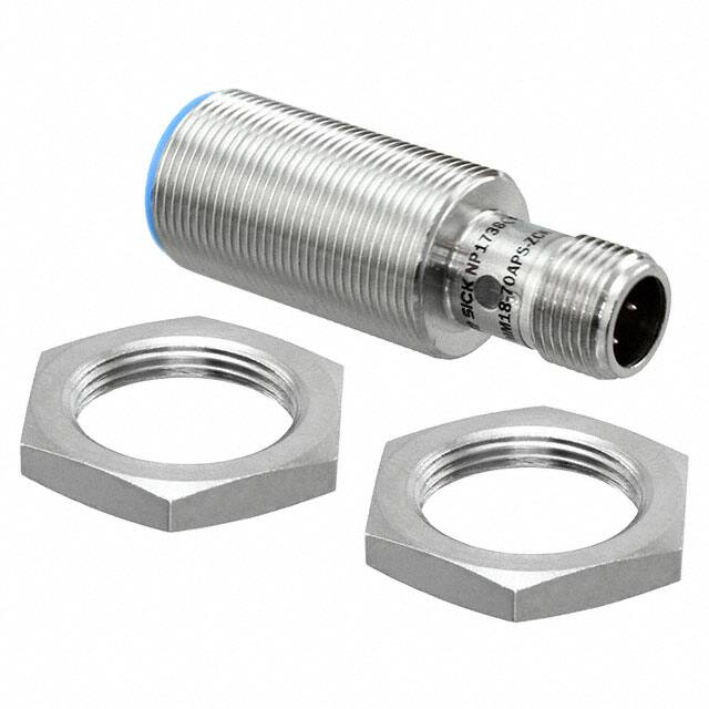

Product data sheet MM18-70APS-ZCK MM MAGNETIC PROXIMITY SENSORS MM18-70APS-ZCK | MM MAGNETIC PROXIMITY SENSORS A B C D E F Ordering information Type Part no. MM18-70APS-ZCK 1040072 Included in delivery: BEF-MU-M18 (1) Other models and accessories www.sick.com/MM Illustration may differ Detailed technical data Features H I J K L M N O P Q R S T Housing Cylindrical thread design Housing Short-body Thread size M18 x 1 Diameter Ø 18 mm Sensing range Sn 0 mm ... 70 mm 1) Safe sensing range Sa 56.7 mm Magnetic sensitivity 0.7 mT Switching frequency 5,000 Hz Connection type Male connector M12, 4-pin Switching output PNP Output function NO Electrical wiring DC 3-wire Magnetic alignment Axial Enclosure rating IP67 2) 1) 2)  Sensing range based on installation in non-magnetic material using Magnet MAG-3010-B (M4.0).  According to EN 60529. Mechanics/electronics Supply voltage 10 V DC ... 30 V DC Ripple ≤ 10 % 1) Voltage drop ≤ 2 V 2) Current consumption 10 mA 3) Time delay before availability ≤ 20 ms 1) 2) 3) 4) 5) 2  Of VS.  At Ia max.  Without load.  Von Sr (VS und Ta constant).  Pulsed. PROXIMITY SENSORS | SICK Product data sheet | 2021-11-22 11:07:35 Subject to change without notice MM18-70APS-ZCK | MM MAGNETIC PROXIMITY SENSORS Hysteresis 1 % ... 10 % Reproducibility ≤ 1 % 4) Temperature drift (of Sr) ± 10 % EMC According to EN 60947-5-2 Continuous current Ia ≤ 200 mA Short-circuit protection ✔ 5) Reverse polarity protection ✔ Power-up pulse protection ✔ Shock and vibration resistance 30 g, 11 ms / 10 ... 55 Hz, 1 mm Ambient operating temperature –25 °C ... +75 °C Housing material Metal, Nickel-plated brass Housing length 50 mm Thread length 32 mm Tightening torque, max. 40 Nm Items supplied Mounting nut, brass, nickel-plated (2x) 1) 2) 3) 4) 5)  Of VS.  At Ia max.  Without load.  Von Sr (VS und Ta constant).  Pulsed. Safety-related parameters MTTFD 1,980 years DCavg 0 % Classifications ECl@ss 5.0 27270104 ECl@ss 5.1.4 27270104 ECl@ss 6.0 27270104 ECl@ss 6.2 27270104 ECl@ss 7.0 27270104 ECl@ss 8.0 27270104 ECl@ss 8.1 27270104 ECl@ss 9.0 27270104 ECl@ss 10.0 27270104 ECl@ss 11.0 27270104 ETIM 5.0 EC002544 ETIM 6.0 EC002544 ETIM 7.0 EC002544 ETIM 8.0 EC002544 UNSPSC 16.0901 39122230 2021-11-22 11:07:35 | Product data sheet  Subject to change without notice PROXIMITY SENSORS | SICK 3 MM18-70APS-ZCK | MM MAGNETIC PROXIMITY SENSORS A B C D E F H I J K L M N O P Q R S T Installation note installation in magnetizable material installation in non-magnetizable material Ø A A M (mm) (Nm) M18 15 < 40 Connection diagram Cd-011 BN 1 BK 4 BU 3 WH 2 + (L+) NO - (M) not connected Sensing range diagram Sensing range 1 2 3 4 5 6 0 85 0 85 0 70 0 38 0 25 0 24 0 30 (1.18) 60 (2.36) 90 120 (3.54) (4.72) Distance in mm (inch) Max. sensing range Sn, flush or non-flush installation, non-magnetizable material Magnet type Part no. 1 MAG-3315-B (M 5.1) 2 MAG-3015-B (M 5.0) 3 MAG-3010-B (M 4.0) 4 MAG-2006-B (M 3.0) 5 MAG-0625-A (M 2.0) 6 MAG-1003-S (M 1.0) 7902086 4 7901786 7901785 7901784 7901783 7901782 PROXIMITY SENSORS | SICK Product data sheet | 2021-11-22 11:07:35 Subject to change without notice MM18-70APS-ZCK | MM MAGNETIC PROXIMITY SENSORS Dimensional drawing (Dimensions in mm (inch)) MM18, connector, short-body housing 3 M18 x 1 2 1 32 (1.26) 50 (1.97) ①  Connection ②  Display LED ③  Fastening nuts (2x); width across 17, metal Recommended accessories Other models and accessories www.sick.com/MM Brief description Type Part no. Magnet without mounting hole, Ø 6 mm, height 25 mm MAG-0625-A 7901783 Magnet without mounting hole, Ø 10 mm, height 3 mm MAG-1003-S 7901782 Magnet with mounting hole for M4 countersunk screw, Ø 20 mm, height 6.5 mm MAG-2006-B 7901784 Magnet without mounting hole, Ø 30 mm, height 10 mm MAG-3010-B 7901785 Magnet with mounting hole for M5 flat head screw, Ø 31 mm, height 15 mm MAG-3015-B 7901786 Magnet with mounting hole for M5 flat head screw, Ø 36 mm, height 19.5 mm MAG-3515-B 7902086 BEF-KHS-N06 2051612 BEF-KHS-N06N 2051622 BEF-WG-M18 5321870 Magnets Universal bar clamp systems Plate N06 for universal clamp bracket, M18, Zinc plated steel (sheet), Zinc die cast (clamping bracket), Universal clamp (5322626), mounting hardware Plate N06N for universal clamp bracket, M18, Stainless steel 1.4571 (sheet), Stainless steel 1.4408 (clamp), Universal clamp (5322627), mounting hardware Mounting brackets and plates Mounting plate for M18 sensors, steel, zinc coated, without mounting hardware 2021-11-22 11:07:35 | Product data sheet  Subject to change without notice PROXIMITY SENSORS | SICK 5 MM18-70APS-ZCK | MM MAGNETIC PROXIMITY SENSORS A B C D E F H I J K L M N O P Q R S T Brief description Type Part no. BEF-WN-M18 5308446 Head A: female connector, M12, 4-pin, straight, A-coded Head B: Flying leads Cable: Sensor/actuator cable, PVC, unshielded, 2 m YF2A14020VB3XLEAX 2096234 Head A: female connector, M12, 4-pin, straight, A-coded Head B: Flying leads Cable: Sensor/actuator cable, PVC, unshielded, 5 m YF2A14050VB3XLEAX 2096235 Head A: female connector, M12, 4-pin, angled, A-coded Head B: Flying leads Cable: Sensor/actuator cable, PVC, unshielded, 2 m YG2A14020VB3XLEAX 2095895 Head A: female connector, M12, 4-pin, angled, A-coded Head B: Flying leads Cable: Sensor/actuator cable, PVC, unshielded, 5 m YG2A14050VB3XLEAX 2095897 Head A: female connector, M12, 4-pin, straight Head B: Cable: unshielded DOS-1204-G 6007302 Head A: female connector, M12, 4-pin, angled Head B: Cable: unshielded DOS-1204-W 6007303 Head A: male connector, M12, 4-pin, straight Head B: Cable: unshielded STE-1204-G 6009932 Head A: male connector, M12, 4-pin, angled Head B: Cable: unshielded STE-1204-W 6022084 Clamping block for round sensors M18, without fixed stop, plastic (PA12), glass-fiber reinforced, mounting hardware included BEF-KH-M18 2051481 Clamping block for round sensors M18, with fixed stop, plastic (PA12), glass-fiber reinforced, mounting hardware included BEF-KHF-M18 2051482 Mounting bracket for M18 sensors, steel, zinc coated, without mounting hardware Plug connectors and cables Terminal and alignment brackets 6 PROXIMITY SENSORS | SICK Product data sheet | 2021-11-22 11:07:35 Subject to change without notice Online data sheet SICK at a glance SICK is one of the leading manufacturers of intelligent sensors and sensor solutions for industrial applications. A unique range of products and services creates the perfect basis for controlling processes securely and efficiently, protecting individuals from accidents and preventing damage to the environment. We have extensive experience in a wide range of industries and understand their processes and requirements. With intelligent sensors, we can deliver exactly what our customers need. In application centers in Europe, Asia and North America, system solutions are tested and optimized in accordance with customer specifications. All this makes us a reliable supplier and development partner. Comprehensive services complete our offering: SICK LifeTime Services provide support throughout the machine life cycle and ensure safety and productivity. For us, that is “Sensor Intelligence.” Worldwide presence: Contacts and other locations – www.sick.com SICK AG | Waldkirch | Germany | www.sick.com
