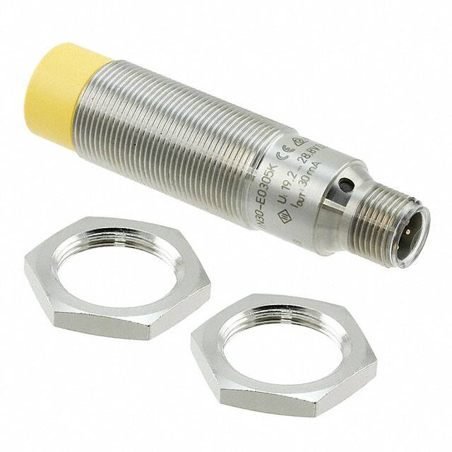

Product data sheet IN30-E0305K IN3000 Direct NON-CONTACT SAFETY SWITCHES IN30-E0305K | IN3000 Direct NON-CONTACT SAFETY SWITCHES A B C D E F H I J K L M N O P Q R S T Ordering information Type Part no. IN30-E0305K 6034576 Other models and accessories www.sick.com/IN3000_Direct Detailed technical data Features Sensor principle Inductive Number of safe outputs 2 Housing diameter M18 Enable zone 1 mm ... 8 mm 1) Safe switch off distance Sar 12 mm Actuation directions 5 Active sensor surfaces 1 1)  Values apply for steel (FE360). Safety-related parameters Safety integrity level SIL2 (IEC 61508) SILCL2 (EN 62061) Category Applicable up to category 3 (EN ISO 13849) Performance level PL d (EN ISO 13849) PFHD (mean probability of a dangerous failure per hour) 1.0 x 10-7 (EN ISO 13849) TM (mission time) 10 years (EN ISO 13849) 1) 20 years (EN ISO 13849) 2) Type Type 3 (EN ISO 14119) Actuator coding level Uncoded (EN ISO 14119) 1) 2)  At –25 °C ... +70 °C and 5 % ... 95 % relative air humidity.  At +10 °C ... +40 °C and 5 % ... 70 % relative air humidity. Functions Safe series connection With Flexi Loop (with diagnostics) Interfaces Connection type Plug connector, M12, 4-pin Power indication ✔ Status display ✔ 2 SAFETY SWITCHES | SICK Product data sheet | 2020-10-15 14:42:24 Subject to change without notice IN30-E0305K | IN3000 Direct NON-CONTACT SAFETY SWITCHES Electrical data Protection class III (EN 50178) Supply voltage Vs 24 V DC (19.2 V DC ... 28.8 V DC) Type of output Semiconductor Response time ≤ 1 ms Mechanical data Design Cylindrical Housing diameter M18 Weight 0.1 kg Material Housing V4A (housing), PBT (cover) Installation type Non-flush Ambient data Enclosure rating IP65 (IEC 60529) IP67 Ambient operating temperature –25 °C ... +70 °C Storage temperature –25 °C ... +70 °C Classifications ECl@ss 5.0 27272401 ECl@ss 5.1.4 27272401 ECl@ss 6.0 27272401 ECl@ss 6.2 27272401 ECl@ss 7.0 27272401 ECl@ss 8.0 27272401 ECl@ss 8.1 27272401 ECl@ss 9.0 27272401 ECl@ss 10.0 27272401 ECl@ss 11.0 27272401 ETIM 5.0 EC001818 ETIM 6.0 EC001818 ETIM 7.0 EC001818 UNSPSC 16.0901 39122205 2020-10-15 14:42:24 | Product data sheet  Subject to change without notice SAFETY SWITCHES | SICK 3 IN30-E0305K | IN3000 Direct NON-CONTACT SAFETY SWITCHES Dimensional drawing (Dimensions in mm (inch)) 70.5 (2.78) LED 2 x 180° 35 10 (1.38) (0.39) 24 M18 x 1 57 (2.24) M12 x 1 A B C D E F 4 (0.16) Response range Near range Safe switch off distance Sar Safe switch on distance Sao*) H I J K L M N O P Q R S T Actuating object (metal) Sensor 0 Safe switch on distance Sao*) Material of the actuating object Steel FE360 1.0 mm … 8.0 mm Stainless steel 1.4302 0.5 mm … 5.6 mm AlMg 3G22 0 mm … 3.2 mm CuZn 37 0 mm ... 3.2 mm Cu 0 mm … 2.4 mm Distance Safe switch off distance Sar 12 mm *) Typical values for damping with a reference target plate of 24 x 24 x 1 mm and non-flush installation according to IEC 60947-5-2 at an ambient temperature of 20 °C. Connection diagram safety controller 4 SAFETY SWITCHES | SICK Product data sheet | 2020-10-15 14:42:24 Subject to change without notice Online data sheet SICK at a glance SICK is one of the leading manufacturers of intelligent sensors and sensor solutions for industrial applications. A unique range of products and services creates the perfect basis for controlling processes securely and efficiently, protecting individuals from accidents and preventing damage to the environment. We have extensive experience in a wide range of industries and understand their processes and requirements. With intelligent sensors, we can deliver exactly what our customers need. In application centers in Europe, Asia and North America, system solutions are tested and optimized in accordance with customer specifications. All this makes us a reliable supplier and development partner. Comprehensive services complete our offering: SICK LifeTime Services provide support throughout the machine life cycle and ensure safety and productivity. For us, that is “Sensor Intelligence.” Worldwide presence: Contacts and other locations – www.sick.com SICK AG | Waldkirch | Germany | www.sick.com
