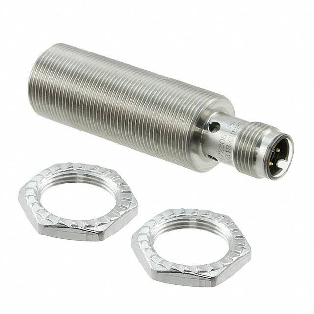

Product data sheet IMB18-08BPSVC0S IMB INDUCTIVE PROXIMITY SENSORS IMB18-08BPSVC0S | IMB INDUCTIVE PROXIMITY SENSORS A B C D E F H I J K L M N O P Q R S T Ordering information Type Part no. IMB18-08BPSVC0S 1072806 Included in delivery: BEF-MU-M18N (1) Other models and accessories www.sick.com/IMB Illustration may differ Detailed technical data Features Housing Cylindrical thread design Housing Standard Thread size M18 x 1 Diameter Ø 18 mm Sensing range Sn 8 mm Safe sensing range Sa 6.48 mm Installation type Quasi-flush 1) Switching frequency 1,000 Hz Connection type Male connector M12, 4-pin 2) Switching output PNP Output function NO Electrical wiring DC 3-wire Enclosure rating IP68 3) IP69K 4) Special features Resistant against coolant lubricants, Visual adjustment indicator, IO-Link, Temperature resistance Special applications Zones with coolants and lubricants, Mobile machines, Difficult application conditions 1) 2) 3) 4) 2  When installed in conductive materials, the sensors must protrude by distance E (E = 2 mm).  With gold plated contact pins.  According to EN 60529.  According to ISO 20653:2013-03. INDUCTIVE PROXIMITY SENSORS | SICK Product data sheet | 2021-11-26 15:21:34 Subject to change without notice IMB18-08BPSVC0S | IMB INDUCTIVE PROXIMITY SENSORS Mechanics/electronics Supply voltage 10 V DC ... 30 V DC Ripple ≤ 10 % Voltage drop ≤ 2 V 1) Current consumption 10 mA 2) Hysteresis 3 % ... 20 % Reproducibility ≤ 2 % 3) 4) Temperature drift (of Sr) ± 10 % EMC According to EN 60947-5-2 Continuous current Ia ≤ 200 mA Short-circuit protection ✔ Reverse polarity protection ✔ Power-up pulse protection ✔ Shock and vibration resistance 100 g / 2 ms / 500 cycles; 150 g / 1 Mio cycles; 10 Hz ... 55 Hz / 1 mm; 55 Hz ... 500 Hz / 60 g Ambient operating temperature –40 °C ... +100 °C Housing material Stainless steel V2A, DIN 1.4305 / AISI 303 Sensing face material Plastic, LCP Housing length 65 mm Thread length 47 mm Tightening torque, max. Typ. 60 Nm 5) Typ. 90 Nm 6) Items supplied Mounting nut, V2A stainless steel, with locking teeth (2x) Protection class III UL File No. E181493 1) 2) 3) 4) 5) 6)  At Ia max.  Without load.  Ub and Ta constant.  Of Sr.  When using the non-toothed side of the nut.  Valid if toothed side of nut is used. Safety-related parameters MTTFD 1,971 years DCavg 0 % Communication interface Communication interface IO-Link V1.0 Communication Interface detail COM2 (38,4 kBaud) Process data length 1 Byte Process data structure Bit 0 = Sr reached Bit 1 = Sa reached Reduction factors Note 2021-11-26 15:21:34 | Product data sheet  Subject to change without notice The values are reference values which may vary INDUCTIVE PROXIMITY SENSORS | SICK 3 IMB18-08BPSVC0S | IMB INDUCTIVE PROXIMITY SENSORS A B C D E F St37 steel (Fe) 1 Stainless steel (V2A, 304) Approx. 0.55 Aluminum (Al) Approx. 0.24 Copper (Cu) Approx. 0.19 Brass (Br) Approx. 0.24 Installation note Remark Associated graphic see "Installation" A 9 mm B 18 mm C 18 mm D 24 mm E 2 mm F 64 mm Classifications H I J K L M N O P Q R S T ECl@ss 5.0 27270101 ECl@ss 5.1.4 27270101 ECl@ss 6.0 27270101 ECl@ss 6.2 27270101 ECl@ss 7.0 27270101 ECl@ss 8.0 27270101 ECl@ss 8.1 27270101 ECl@ss 9.0 27270101 ECl@ss 10.0 27270101 ECl@ss 11.0 27270101 ETIM 5.0 EC002714 ETIM 6.0 EC002714 ETIM 7.0 EC002714 ETIM 8.0 EC002714 UNSPSC 16.0901 39122230 Installation note Quasi-flush installation F B C A A D E 4 INDUCTIVE PROXIMITY SENSORS | SICK Product data sheet | 2021-11-26 15:21:34 Subject to change without notice IMB18-08BPSVC0S | IMB INDUCTIVE PROXIMITY SENSORS Connection diagram Cd-456 1 BN BK 4 2 3 BU + (L+) NO/C not connected - (M) Characteristic curve Response diagram Distance in mm (inch) 15 (0.59) 10 (0.39) 5 (0.2) 0 5 (0.2) 10 (0.39) 15 (0.59) 0 2 4 6 8 (0.08) (0.16) (0.24) (0.31) Sn in mm (inch) Adjustments Installation aid Q LED Distance of target Sr Sa=0.81 Sn 2021-11-26 15:21:34 | Product data sheet  Subject to change without notice INDUCTIVE PROXIMITY SENSORS | SICK 5 IMB18-08BPSVC0S | IMB INDUCTIVE PROXIMITY SENSORS Dimensional drawing (Dimensions in mm (inch)) IMB18 Standard, connector, M12, flush 65 (2.56) 47 (1.85) 8.9 (0.35) M18x1 A B C D E F Recommended accessories Other models and accessories H I J K L M N O P Q R S T www.sick.com/IMB Brief description Type Part no. BEF-KHS-N06N 2051622 Mounting plate for M18 sensors, stainless steel, without mounting hardware BEF-WG-M18N 5320948 Mounting bracket for M18 sensors, stainless steel, without mounting hardware BEF-WN-M18N 5320947 Head A: female connector, M12, 4-pin, straight Head B: Flying leads Cable: Sensor/actuator cable, PP, unshielded, 2 m This product is generally resistant to chemical cleaning agents (see ECOLAB) and other chemical compounds such as H2O2 and CH2O2. Before permanent installation is carried out, the material's resistance to the cleaning agent being used must be checked., Resistant against lactic acid & hydrogen peroxide (H2O2) DOL-1204-G02MRN 6058291 Head A: female connector, M12, 4-pin, straight Head B: Flying leads Cable: Sensor/actuator cable, PP, unshielded, 5 m This product is generally resistant to chemical cleaning agents (see ECOLAB) and other chemical compounds such as H2O2 and CH2O2. Before permanent installation is carried out, the material's resistance to the cleaning agent being used must be checked., Resistant against lactic acid & hydrogen peroxide (H2O2) DOL-1204-G05MRN 6058476 Head A: female connector, M12, 4-pin, angled Head B: Flying leads Cable: Sensor/actuator cable, PP, unshielded, 2 m This product is generally resistant to chemical cleaning agents (see ECOLAB) and other chemical compounds such as H2O2 and CH2O2. Before permanent installation is carried out, the material's resistance to the cleaning agent being used must be checked., Resistant against lactic acid & hydrogen peroxide (H2O2), only suitable for PNP sensors DOL-1204-L02MRN 6058482 Universal bar clamp systems Plate N06N for universal clamp bracket, M18, Stainless steel 1.4571 (sheet), Stainless steel 1.4408 (clamp), Universal clamp (5322627), mounting hardware Mounting brackets and plates Plug connectors and cables 6 INDUCTIVE PROXIMITY SENSORS | SICK Product data sheet | 2021-11-26 15:21:34 Subject to change without notice IMB18-08BPSVC0S | IMB INDUCTIVE PROXIMITY SENSORS Brief description Type Part no. Head A: female connector, M12, 4-pin, angled Head B: Flying leads Cable: Sensor/actuator cable, PP, unshielded, 5 m This product is generally resistant to chemical cleaning agents (see ECOLAB) and other chemical compounds such as H2O2 and CH2O2. Before permanent installation is carried out, the material's resistance to the cleaning agent being used must be checked., Resistant against lactic acid & hydrogen peroxide (H2O2), only suitable for PNP sensors DOL-1204-L05MRN 6058483 Head A: female connector, M12, 4-pin, angled Head B: Flying leads Cable: Sensor/actuator cable, PP, unshielded, 2 m This product is generally resistant to chemical cleaning agents (see ECOLAB) and other chemical compounds such as H2O2 and CH2O2. Before permanent installation is carried out, the material's resistance to the cleaning agent being used must be checked., Resistant against lactic acid & hydrogen peroxide (H2O2) DOL-1204-W02MRN 6058474 Head A: female connector, M12, 4-pin, angled Head B: Flying leads Cable: Sensor/actuator cable, PP, unshielded, 5 m This product is generally resistant to chemical cleaning agents (see ECOLAB) and other chemical compounds such as H2O2 and CH2O2. Before permanent installation is carried out, the material's resistance to the cleaning agent being used must be checked., Resistant against lactic acid & hydrogen peroxide (H2O2) DOL-1204-W05MRN 6058477 Head A: female connector, M12, 4-pin, straight, A-coded Head B: Flying leads Cable: Sensor/actuator cable, PUR, halogen-free, unshielded, 2 m YF2A14020UB3XLEAX 2095607 Head A: female connector, M12, 4-pin, straight, A-coded Head B: Flying leads Cable: Sensor/actuator cable, PUR, halogen-free, unshielded, 5 m YF2A14050UB3XLEAX 2095608 Head A: female connector, M12, 4-pin, angled, A-coded Head B: Flying leads Cable: Sensor/actuator cable, PUR, halogen-free, unshielded, 5 m YG2A14050UB3XLEAX 2095767 Head A: female connector, M12, 4-pin, angled Head B: male connector, M12, 4-pin, straight Cable: Sensor/actuator cable, PP, unshielded, 2 m This product is generally resistant to chemical cleaning agents (see ECOLAB) and other chemical compounds such as H2O2 and CH2O2. Before permanent installation is carried out, the material's resistance to the cleaning agent being used must be checked., Resistant against lactic acid & hydrogen peroxide (H2O2) DSL-1204-B02MRN 6058502 Head A: female connector, M12, 4-pin, angled Head B: male connector, M12, 4-pin, straight Cable: Sensor/actuator cable, PP, unshielded, 5 m This product is generally resistant to chemical cleaning agents (see ECOLAB) and other chemical compounds such as H2O2 and CH2O2. Before permanent installation is carried out, the material's resistance to the cleaning agent being used must be checked., Resistant against lactic acid & hydrogen peroxide (H2O2) DSL-1204-B05MRN 6058503 Head A: female connector, M12, 4-pin, straight Head B: male connector, M12, 4-pin, straight Cable: Sensor/actuator cable, PP, unshielded, 2 m This product is generally resistant to chemical cleaning agents (see ECOLAB) and other chemical compounds such as H2O2 and CH2O2. Before permanent installation is carried out, the material's resistance to the cleaning agent being used must be checked., Resistant against lactic acid & hydrogen peroxide (H2O2) DSL-1204-G02MRN 6058499 Head A: female connector, M12, 4-pin, straight Head B: male connector, M12, 4-pin, straight Cable: Sensor/actuator cable, PP, unshielded, 5 m This product is generally resistant to chemical cleaning agents (see ECOLAB) and other chemical compounds such as H2O2 and CH2O2. Before permanent installation is carried out, the material's resistance to the cleaning agent being used must be checked., Resistant against lactic acid & hydrogen peroxide (H2O2) DSL-1204-G05MRN 6058500 2021-11-26 15:21:34 | Product data sheet  Subject to change without notice INDUCTIVE PROXIMITY SENSORS | SICK 7 IMB18-08BPSVC0S | IMB INDUCTIVE PROXIMITY SENSORS A B C D E F H I J K L M N O P Q R S T Brief description Head A: female connector, M12, 4-pin, straight, A-coded Head B: male connector, M12, 4-pin, straight, A-coded Cable: Sensor/actuator cable, PUR, halogen-free, unshielded, 5 m Type Part no. YF2A14050UB3M2A14 2096001 Type Part no. Function Block Factory On request Recommended services Additional services www.sick.com/IMB Function Block Factory • Description: The Function Block Factory supports common programmable logic controllers (PLCs) from various manufacturers, such as Siemens, Beckhoff, Rockwell Automation and B&R. More information on the FBF can be found here. 8 INDUCTIVE PROXIMITY SENSORS | SICK Product data sheet | 2021-11-26 15:21:34 Subject to change without notice Online data sheet SICK at a glance SICK is one of the leading manufacturers of intelligent sensors and sensor solutions for industrial applications. A unique range of products and services creates the perfect basis for controlling processes securely and efficiently, protecting individuals from accidents and preventing damage to the environment. We have extensive experience in a wide range of industries and understand their processes and requirements. With intelligent sensors, we can deliver exactly what our customers need. In application centers in Europe, Asia and North America, system solutions are tested and optimized in accordance with customer specifications. All this makes us a reliable supplier and development partner. Comprehensive services complete our offering: SICK LifeTime Services provide support throughout the machine life cycle and ensure safety and productivity. For us, that is “Sensor Intelligence.” Worldwide presence: Contacts and other locations – www.sick.com SICK AG | Waldkirch | Germany | www.sick.com
