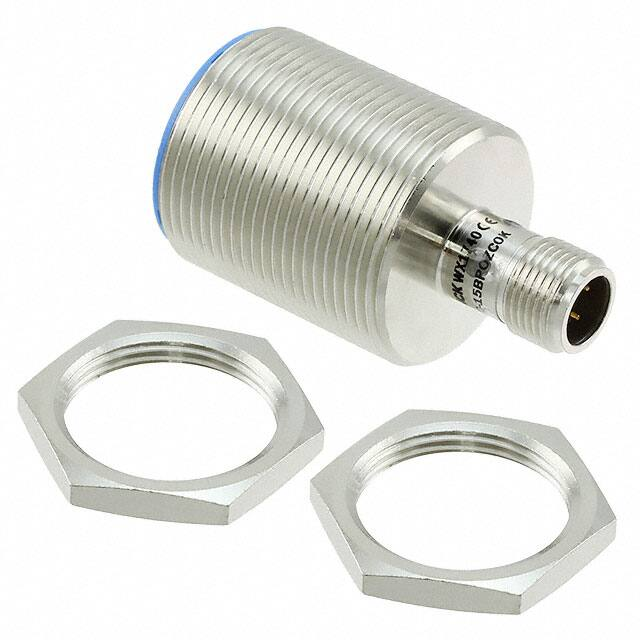

IME30-15BPOZC0K 数据手册
Product data sheet IME30-15BPOZC0K IME INDUCTIVE PROXIMITY SENSORS IME30-15BPOZC0K | IME INDUCTIVE PROXIMITY SENSORS A B C D E F H I J K L M N O P Q R S T Ordering information Type Part no. IME30-15BPOZC0K 1041033 Included in delivery: BEF-MU-M30 (1) Other models and accessories www.sick.com/IME Illustration may differ Detailed technical data Features Housing Cylindrical thread design Housing Short-body Thread size M30 x 1.5 Diameter Ø 30 mm Sensing range Sn 15 mm Safe sensing range Sa 12.15 mm Installation type Flush Switching frequency 500 Hz Connection type Male connector M12, 4-pin Switching output PNP Output function NC Electrical wiring DC 3-wire Enclosure rating IP67 1) 1)  According to EN 60529. Mechanics/electronics Supply voltage 10 V DC ... 30 V DC Ripple ≤ 10 % Voltage drop ≤ 2 V 1) Current consumption 10 mA 2) 1) 2) 3) 4) 2  At Ia max.  Without load.  Ub and Ta constant.  Of Sr. INDUCTIVE PROXIMITY SENSORS | SICK Product data sheet | 2021-11-22 12:29:53 Subject to change without notice IME30-15BPOZC0K | IME INDUCTIVE PROXIMITY SENSORS Time delay before availability ≤ 125 ms Hysteresis 3 % ... 15 % Reproducibility ≤ 2 % 3) 4) Temperature drift (of Sr) ± 10 % EMC According to EN 60947-5-2 Continuous current Ia ≤ 200 mA Short-circuit protection ✔ Reverse polarity protection ✔ Power-up pulse protection ✔ Shock and vibration resistance 30 g, 11 ms/10 Hz ... 55 Hz, 1 mm Ambient operating temperature –25 °C ... +75 °C Housing material Brass, nickel-plated Sensing face material Plastic, PA 66 Housing length 52 mm Thread length 35 mm Tightening torque, max. ≤ 100 Nm Items supplied Mounting nut, brass, nickel-plated (2x) UL File No. NRKH.E181493 1) 2) 3) 4)  At Ia max.  Without load.  Ub and Ta constant.  Of Sr. Safety-related parameters MTTFD 1,735 years DCavg 0 % Reduction factors Note The values are reference values which may vary St37 steel (Fe) 1 Stainless steel (V2A, 304) Approx. 0.8 Aluminum (Al) Approx. 0.45 Copper (Cu) Approx. 0.4 Brass (Br) Approx. 0.4 Installation note Remark Associated graphic see "Installation" B 60 mm C 30 mm D 45 mm F 120 mm Classifications ECl@ss 5.0 27270101 ECl@ss 5.1.4 27270101 2021-11-22 12:29:53 | Product data sheet  Subject to change without notice INDUCTIVE PROXIMITY SENSORS | SICK 3 IME30-15BPOZC0K | IME INDUCTIVE PROXIMITY SENSORS A B C D E F H I J K L M N O P Q R S T ECl@ss 6.0 27270101 ECl@ss 6.2 27270101 ECl@ss 7.0 27270101 ECl@ss 8.0 27270101 ECl@ss 8.1 27270101 ECl@ss 9.0 27270101 ECl@ss 10.0 27270101 ECl@ss 11.0 27270101 ETIM 5.0 EC002714 ETIM 6.0 EC002714 ETIM 7.0 EC002714 ETIM 8.0 EC002714 UNSPSC 16.0901 39122230 Installation note Flush installation F B C D Connection diagram Cd-008 4 BN 1 BK 4 BU 3 WH 2 + (L+) not connected - (M) NC INDUCTIVE PROXIMITY SENSORS | SICK Product data sheet | 2021-11-22 12:29:53 Subject to change without notice IME30-15BPOZC0K | IME INDUCTIVE PROXIMITY SENSORS Dimensional drawing (Dimensions in mm (inch)) IME30 Short-body housing, connector, flush 3 M30 x 1.5 2 1 35 (1.28) 52 (2.05) ①  Connection ②  Display LED ③  Fastening nuts (2x); width across 36, metal Recommended accessories Other models and accessories www.sick.com/IME Brief description Type Part no. Mounting plate for M30 sensors, steel, zinc coated, without mounting hardware BEF-WG-M30 5321871 Mounting bracket for M30 sensors, steel, zinc coated, without mounting hardware BEF-WN-M30 5308445 Head A: female connector, M12, 4-pin, straight, A-coded Head B: Flying leads Cable: Sensor/actuator cable, PVC, unshielded, 2 m YF2A14020VB3XLEAX 2096234 Head A: female connector, M12, 4-pin, straight, A-coded Head B: Flying leads Cable: Sensor/actuator cable, PVC, unshielded, 5 m YF2A14050VB3XLEAX 2096235 Head A: female connector, M12, 4-pin, straight, A-coded Head B: Flying leads Cable: Sensor/actuator cable, PVC, unshielded, 10 m YF2A14100VB3XLEAX 2096236 Head A: female connector, M12, 4-pin, angled, A-coded Head B: Flying leads Cable: Sensor/actuator cable, PVC, unshielded, 2 m YG2A14020VB3XLEAX 2095895 Head A: female connector, M12, 4-pin, angled, A-coded Head B: Flying leads Cable: Sensor/actuator cable, PVC, unshielded, 5 m YG2A14050VB3XLEAX 2095897 Head A: female connector, M12, 4-pin, angled, A-coded Head B: Flying leads Cable: Sensor/actuator cable, PVC, unshielded, 10 m YG2A14100VB3XLEAX 2095898 DOS-1204-G 6007302 Mounting brackets and plates Plug connectors and cables Head A: female connector, M12, 4-pin, straight Head B: Cable: unshielded 2021-11-22 12:29:53 | Product data sheet  Subject to change without notice INDUCTIVE PROXIMITY SENSORS | SICK 5 IME30-15BPOZC0K | IME INDUCTIVE PROXIMITY SENSORS A B C D E F H I J K L M N O P Q R S T Brief description Head A: female connector, M12, 4-pin, angled Head B: Cable: unshielded 6 INDUCTIVE PROXIMITY SENSORS | SICK Type Part no. DOS-1204-W 6007303 Product data sheet | 2021-11-22 12:29:53 Subject to change without notice Online data sheet SICK at a glance SICK is one of the leading manufacturers of intelligent sensors and sensor solutions for industrial applications. A unique range of products and services creates the perfect basis for controlling processes securely and efficiently, protecting individuals from accidents and preventing damage to the environment. We have extensive experience in a wide range of industries and understand their processes and requirements. With intelligent sensors, we can deliver exactly what our customers need. In application centers in Europe, Asia and North America, system solutions are tested and optimized in accordance with customer specifications. All this makes us a reliable supplier and development partner. Comprehensive services complete our offering: SICK LifeTime Services provide support throughout the machine life cycle and ensure safety and productivity. For us, that is “Sensor Intelligence.” Worldwide presence: Contacts and other locations – www.sick.com SICK AG | Waldkirch | Germany | www.sick.com
