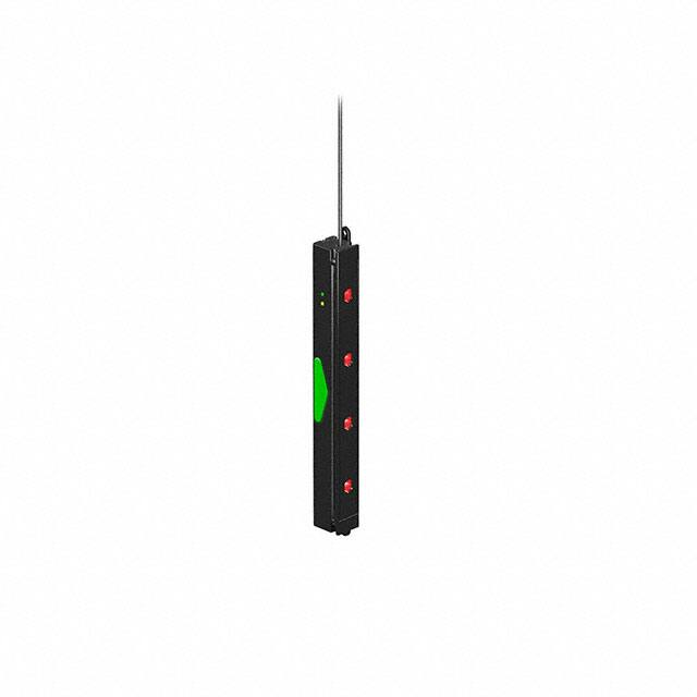

    PHOTO SEN 225MM PAIR 1500MM
PVL225PQ 数据手册
PVL Parts Verification Array Datasheet Retroreflective Array Sensor Error Proofing and Light-Guided Assembly • • • • • Rugged metal frame with 225 mm (8.9 in) or 500 mm (19.7 in) sensing length; 1.5 m (4.9 ft) sensing range using included retroreflective tape (up to 6 m (20 ft) range when used with multiple BRT-84X84A retroreflectors) Highly visible green pick arrow Red mis-pick arrow Flexible mounting options; rugged steel mounting brackets Fast response time—excellent for part detection applications WARNING: • Do not use this device for personnel protection • Using this device for personnel protection could result in serious injury or death. • This device does not include the self-checking redundant circuitry necessary to allow its use in personnel safety applications. A device failure or malfunction can cause either an energized (on) or de-energized (off) output condition. Models Model Number Description Cable PVL225P PVL225N PVL225PQ 225 mm (8.9 in) length, with up to 1.5 m (4.9 ft) separation between sensor and retroreflective tape (included) PVL225NQ PVL500P PVL500N PVL500PQ 500 mm (19.7 in) length with up to 1.5 m (4.9 ft) separation between sensor and retroreflective tape (included) PVL500NQ Output 2 m (6.5 ft) 4-wire unterminated cable 2 m (6.5 ft) cable with a 5-pin male M12 quick disconnect connector 2 m (6.5 ft) 4-wire unterminated cable 2 m (6.5 ft) cable with a 5-pin male M12 quick disconnect connector PNP, Normally Open NPN, Normally Open PNP, Normally Open NPN, Normally Open PNP, Normally Open NPN, Normally Open PNP, Normally Open NPN, Normally Open Installation Multiple sensors located farther than the sensor's maximum range from one another are unlikely to cause crosstalk problems. However, when multiple sensors are mounted in a confined area, take care to avoid crosstalk between them. Verify the sensor's beams fall in the center of the reflector. Figure 1. Correct Alignment Figure 2. Incorrect Alignment Sensor Sensor Reflector Reflector Original Document 165037 Rev. G 9 November 2021 165037 PVL Parts Verification Array Wiring Diagram Figure 3. NPN wiring bn (1) bn (1) + 12-30 V DC – bu (3) bk (4) Figure 4. PNP wiring Load wh (2) Job Light Enable < 1.0 V DC 1 + 12-30 V DC bu (3) bk (4) Figure 5. 5-pin male M12 quick disconnect connector 2 – 4 5 3 Load wh (2) Job Light Enable > 7.0 V DC Pin 5 (center) is not used. Status Indicators/Troubleshooting Target * Pick/Mis-Pick Indicator Power Indicator Output Indicator Job Enable (white wire) Pick/Mis-pick Indicator Power Indicator Output Indicator Output inactive Not sensed inactive off green off Sensed inactive flashing red green amber active Not sensed active green green off inactive Sensed active green green amber active Target not sensed = All beams are unbroken. Target sensed = One or more beams are broken. Specifications Minimum Object Detection Size Object Width (mm) Supply Voltage 12 V DC to 30 V DC Supply Current PVL225: < 140 mA max current at 12 V DC (exclusive of load) < 70 mA max current at 30 V DC (exclusive of load) PVL500: < 220 mA max current at 12 V DC (exclusive of load) < 100 mA max current at 30 V DC (exclusive of load) Supply Protection Circuitry Protected against reverse polarity and transient voltages Output Rating Maximum Load: 150 mA ON-state saturation voltage: PNP: < 2 V DC at 10 mA; < 2.5 V DC at 150 mA NPN: < 1.5 V DC at 10 mA; < 2.0 V DC at 150 mA OFF-state leakage current:
