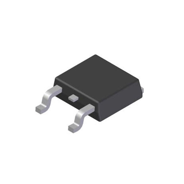

    DIODE SCHOTTKY 650V 4A TO252
C3D04065E-TR 数据手册
C3D04065E VRRM Silicon Carbide Schottky Diode = IF (TC=135˚C) Z-Rec Rectifier ® Qc Features Package • • • • • • • • TO-252-2 650-Volt Schottky Rectifier Optimized for PFC Boost Diode Application Zero Reverse Recovery Current Zero Forward Recovery Voltage High-Frequency Operation Temperature-Independent Switching Behavior Extremely Fast Switching Positive Temperature Coefficient on VF 650 V = = 6A   10 nC Benefits • • • • • Replace Bipolar with Unipolar Rectifiers Essentially No Switching Losses Higher Efficiency Reduction of Heat Sink Requirements Parallel Devices Without Thermal Runaway PIN 1 Applications • • • • CASE PIN 2 Part Number Package Marking C3D04065E TO-252-2 C3D04065 Switch Mode Power Supplies (SMPS) Boost diodes in PFC or DC/DC stages Free Wheeling Diodes in Inverter stages AC/DC converters Maximum Ratings (TC = 25 ˚C unless otherwise specified) Symbol Value Unit Test Conditions VRRM Repetitive Peak Reverse Voltage 650 V VRSM Surge Peak Reverse Voltage 650 V VDC DC Blocking Voltage 650 V Continuous Forward Current 13.5 6 4 A TC=25˚C TC=135˚C TC=155˚C IF Note Fig. 3 IFRM Repetitive Peak Forward Surge Current 17 12 A TC=25˚C, tP = 10 ms, Half Sine Wave TC=110˚C, tP = 10 ms, Half Sine Wave IFSM Non-Repetitive Peak Forward Surge Current 25 19 A TC=25˚C, tp = 10 ms, Half Sine Wave TC=110˚C, tp = 10 ms, Half Sine Wave Fig. 8 IF,Max Non-Repetitive Peak Forward Surge Current 220 160 A TC=25˚C, tP = 10 µs, Pulse TC=110˚C, tP = 10 µs, Pulse Fig. 8 Power Dissipation 52 22.5 W TC=25˚C TC=110˚C Fig. 4 dV/dt Diode dV/dt ruggedness 200 V/ns VR=0-650V ∫i2dt i2t value 3.1 1.8 A2s -55 to +175 ˚C Ptot TJ , Tstg 1 Parameter Operating Junction and Storage Temperature C3D04065E Rev. A, 08-2016 TC=25˚C, tP=10 ms TC=110˚C, tP=10 ms Electrical Characteristics Symbol Parameter Typ. Max. Unit VF Forward Voltage 1.4 1.7 1.7 2.4 V IR Reverse Current 6 12 30 120 QC Total Capacitive Charge C Total Capacitance EC Capacitance Stored Energy Test Conditions Note IF = 4 A TJ=25°C IF = 4 A TJ=175°C Fig. 1 μA VR = 650 V TJ=25°C VR = 650 V TJ=175°C Fig. 2 10 nC VR = 400 V, IF = 4 A di/dt = 500 A/μs TJ = 25°C Fig. 5 231 18.5 15 pF VR = 0 V, TJ = 25°C, f = 1 MHz VR = 200 V, TJ = 25˚C, f = 1 MHz VR = 400 V, TJ = 25˚C, f = 1 MHz Fig. 6 1.4 μJ VR = 400 V Fig. 7 Note: This is a majority carrier diode, so there is no reverse recovery charge. Thermal Characteristics Symbol RθJC Parameter Thermal Resistance from Junction to Case Typ. Unit Note 2.9 °C/W Fig. 9 Typical Performance 100 12 TJ = -55 °C 10 Reverse LeakageICurrent, (mA) IRR (uA) 8 TJ = 75 °C TJ = 125 °C 6 4 2 0 0.0 0.5 1.0 1.5 2.0 2.5 3.0 FowardVVoltage, (V) VF (V) F Figure 1. Forward Characteristics 2 80 TJ = 175 °C 60 TJ = 125 °C R TJ = 175 °C F Foward I Current, (A) IF (A) TJ = 25 °C C3D04065E Rev. A, 08-2016 3.5 4.0 TJ = 75 °C 40 TJ = 25 °C 20 TJ = -55 °C 0 0 200 400 600 800 1000 (V) VR (V) ReverseVVoltage, R Figure 2. Reverse Characteristics 1200 Typical Performance 50 60 10% Duty 20% Duty 30% Duty 50% Duty 70% Duty DC 45 40 30 40 (W) PP Tot(W) TOT IF(peak) (A) IF (A) 35 50 25 20 30 20 15 10 10 5 0 25 50 75 100 125 150 0 175 25 50 75 T ˚C TCC(°C) 175 Figure 4. Power Derating 250 Conditions: TJ = 25 °C Ftest = 1 MHz Vtest = 25 mV 200 12 10 Capacitance C (pF) (pF) CapacitiveQCharge, (nC) QC (nC) C 150 C Conditions: TJ = 25 °C 14 125 ˚C TTC (°C) Figure 3. Current Derating 16 100 8 6 4 150 100 50 2 0 0 100 200 300 400 500 600 700 ReverseVVoltage, (V) VR (V) R Figure 5. Total Capacitance Charge vs. Reverse Voltage 3 C3D04065E Rev. A, 08-2016 0 0 1 10 100 (V) VR (V) ReverseVVoltage, R Figure 6. Capacitance vs. Reverse Voltage 1000 Typical Performance 1,000 4 3 TJ_initial = 25 °C TJ_initial = 110 °C IIFSM (A) (A) 2.5 FSM 2 C Capacitance StoredE Energy, µJ) (mJ) EC (µ 3.5 1.5 100 1 0.5 0 0 100 200 300 400 500 600 10 10E-6 700 ReverseVVoltage, (V) VR (V) 0.5 0.3 0.1 100E-3 0.05 0.02 SinglePulse 0.01 10E-3 1E-6 10E-6 100E-6 1E-3 Time, tp (s) T (Sec) 10E-3 Figure 9. Transient Thermal Impedance 4 C3D04065E Rev. A, 08-2016 10E-3 Figure 8. Non-repetitive peak forward surge current versus pulse duration (sinusoidal waveform) Figure 7. Capacitance Stored Energy Thermal Resistance (oC/W) Thermal Resistance (˚C/W) 1E-3 tp (s) Time, tp (s) R 1 100E-6 100E-3 1 Package Dimensions SYMBOL Package TO-252-2 A A1 b b2 b3 c c2 D D1 E E1 e H L L2 L3 L4 θ Tjb June 2015 MX+DI+PSI MILLIMETERS MIN MAX 2.159 2.413 0 0.13 0.64 0.89 0.653 1.143 5.004 5.6 0.457 0.61 0.457 0.864 5.867 6.248 5.21 6.35 7.341 4.32 4.58 BSC 9.65 10.414 1.106 1.78 0.51 BSC 0.889 1.27 0.64 1.01 0° 8° Recommended Solder Pad Layout TO-252-2 Part Number Package Marking C3D04065E TO-252-2 C3D04065 Note: Recommended soldering profiles can be found in the applications note here: http://www.wolfspeed.com/power_app_notes/soldering 5 C3D04065E Rev. A, 08-2016 Diode Model Diode Model CSD04060 Vf T = VT + If*RT VT= 0.965 + (Tj * -1.3*10-3) RT= 0.096 + (Tj * 1.06*10-3) VfT = VT + If * RT VT = 1.00 + (TJ * -1.1*10-3) RT = 0.069 + (TJ * 8.3*10-4) VT RT Note: Tj = Diode Junction Temperature In Degrees Celsius, valid from 25°C to 175°C Notes • RoHS Compliance The levels of RoHS restricted materials in this product are below the maximum concentration values (also referred to as the threshold limits) permitted for such substances, or are used in an exempted application, in accordance with EU Directive 2011/65/EC (RoHS2), as implemented January 2, 2013. RoHS Declarations for this product can be obtained from your Wolfpseed representative or from the Product Ecology section of our website at http:// www.wolfspeed.com/Power/Tools-and-Support/Product-Ecology. • REACh Compliance REACh substances of high concern (SVHCs) information is available for this product. Since the European Chemical Agency (ECHA) has published notice of their intent to frequently revise the SVHC listing for the foreseeable future,please contact a Cree representative to insure you get the most up-to-date REACh SVHC Declaration. REACh banned substance information (REACh Article 67) is also available upon request. • This product has not been designed or tested for use in, and is not intended for use in, applications implanted into the human body nor in applications in which failure of the product could lead to death, personal injury or property damage, including but not limited to equipment used in the operation of nuclear facilities, life-support machines, cardiac defibrillators or similar emergency medical equipment, aircraft navigation or communication or control systems, or air traffic control systems. Related Links • • • Cree SiC Schottky diode portfolio: http://www.wolfspeed.com/Power/Products#SiCSchottkyDiodes Schottky diode Spice models: http://www.wolfspeed.com/power/tools-and-support/DIODE-model-request2 SiC MOSFET and diode reference designs: http://go.pardot.com/l/101562/2015-07-31/349i Copyright © 2016 Cree, Inc. All rights reserved. The information in this document is subject to change without notice. Cree, the Cree logo, and Zero Recovery are registered trademarks of Cree, Inc. 6 C3D04065E Rev. A, 08-2016 Cree, Inc. 4600 Silicon Drive Durham, NC 27703 USA Tel: +1.919.313.5300 Fax: +1.919.313.5451 www.cree.com/power
