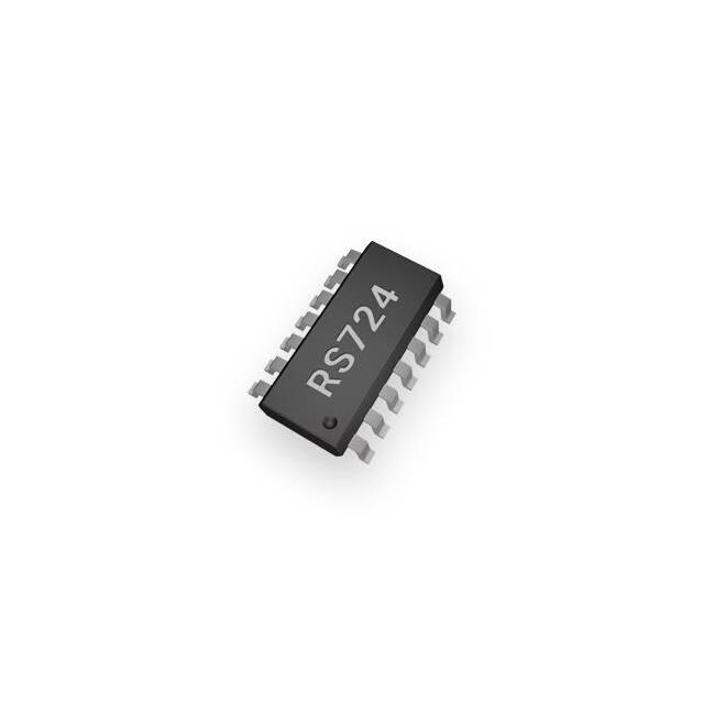

RS2254 CMOS Quad Bilateral Analog Switch FEATURES • -3dB Bandwidth: 180MHz • Single Supply Operation +2.5V to +5.5V • Low ON Resistance, 24Ω(TYP) With 5V Supply • High Off-Isolation: -83dB (RL = 50Ω, f = 1MHz) DESCRIPTION The RS2254 device is a CMOS analog IC configured as quad bilateral single-pole/single-throw (SPST) switches. It intended for the transmission or multiplexing of analog or digital signals. This CMOS device can operate from 2.5 V to 5.5 V. • Guaranteed On-Resistance Match Between Channels • Extremely Low Off-State Switch Leakage: 1nA (TYP) at 25°C • Operating Temperature Range: -40°C to +125°C • PACKAGES: SOIC-14(SOP14) and TSSOP-14 The RS2254 device consists of four bilateral switches, each with independent controls. It has low on-resistance (24Ω TYP) and very low off-leakage current (1nA TYP). The RS2254 is available in Green SOIC-14 and TSSOP-14 packages. It operates over an ambient temperature range of -40°C to +125°C. Functional Diagrams of RS2254 APPLICATIONS • Transmission-Gate Logic Implementation • Analog and Digital Multiplexing and Demultiplexing • A/D and D/A Conversion • Signal Gating • Battery-Operated Equipment • Factory Automation • Communications Circuits C C on trol A A IN /OU T D B A A OU T/IN C on trol B B IN /OU T B OU T/IN C on trol C C IN /OUT C OU T/IN C on trol D D IN /OUT D OU T/IN R S2 25 4 REV B.1 1 www.run-ic.com RS2254 PIN CONFIGURATIONS (TOP VIEW) 1 A OUT/IN 2 B OUT/IN 3 B IN/OUT 4 B 5 C 6 GND 7 RS2254 A IN/OUT 14 VCC 13 A 12 D 11 D IN/OUT 10 D OUT/IN 9 C OUT/IN 8 C IN/OUT SOIC-14(SOP14)/ TSSOP-14 PIN DESCRIPTION PIN 1 2 3 4 5 6 7 8 9 10 11 12 13 14 NAME A IN/OUT A OUT/IN B OUT/IN B IN/OUT B C GND C IN/OUT C OUT/IN D OUT/IN D IN/OUT D A VCC I/O I/O I/O I/O I/O I I I/O I/O I/O I/O I I - DESCRIPTION Input/Output for Switch A Output/Input for Switch A Output/Input for Switch B Input/Output for Switch B Control pin for Switch B Control pin for Switch C Ground Input/Output for Switch C Output/Input for Switch C Output/Input for Switch D Input/Output for Switch D Control pin for Switch D Control pin for Switch A Power Supply FUNCTION TABLE SELECT INPUTS A/B/C/D High Low SWITCH STATUS All Switches ON All Switches OFF NOTE: Input and output pins are identical and interchangeable. Any may be considered an input or output; signals pass equally well in both directions. 2 www.run-ic.com RS2254 SPECIFICATIONS Absolute Maximum Ratings Over operating free-air temperature range (unless otherwise noted) (1) SYMBOL PARAMETER MIN MAX VCC Supply Voltage -0.3 6 VIN Input Voltage (All inputs) -0.3 VCC+0.3 IIN Switch Input Current Any one input -20 +20 IPEAK Peak Switch Current Pulsed at 1ms Duration,
