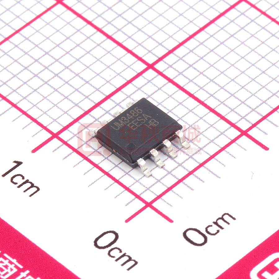

UM3486EESA
UM3486EESA
    UNION(英联)
    SOP-8
    3V至5.5V供电,±15kV ESD保护,转换速率受限,真RS-485收发器
UM3486EESA 数据手册
UM3483E/UM3486E 3V to 5.5V-Powered, ±15kV ESD-Protected, Slew-Rate-Limited, True RS-485 Transceivers UM3483E/UM3486E SOP8/DIP8 General Description The UM3483E, UM3486E are 3V to 5.5V-powered, ±15kV ESD-protected, slew-rate-limited differential transceivers which provide full RS485 compatibility. Each part contains one driver and one receiver, which is designed for data transmission with extended common mode range (-7V to 12V). The UM3483E features slew-rate-limited driver which minimizes EMI and reduces reflections resulted from improperly terminated cables. The UM3483E allows up to 500kbps error-free data transmission, while the partially slew-rate-limited UM3486E transmits at data rates up to 2.5Mbps. The UM3483E, UM3486E also feature enhanced electrostatic discharge (ESD) protection. All of the transmitter outputs and receiver inputs are protected to ±15kV using IEC61000-4-2 Air-Gap Discharge, ±15kV using the Human Body Model and ±8kV using IEC61000-4-2 Contact Discharge. Drivers are short-circuit current limited. When the driver outputs are placed into a high-impedance state by thermal shutdown circuitry, drivers are protected against excessive power dissipation. And the fail-safe feature of the receiver input guarantees a logic-high output if both inputs are open, shorted or idle. Both parts have power up/down mode, the glitch-free driver outputs permit live insertion or removal of the transceiver into/from the data bus. The CMOS design offers significant power savings without sacrificing ruggedness against overload or ESD damage. The typical quiescent current is only 300μA during operation and 1μA in shutdown mode. The UM3483E, UM3486E are intended for half-duplex communication and are available in SOP8 and DIP8 packages. Applications Features         Telecommunications Low-Power RS-485 Transceivers Integrated Services Digital Networks Industrial-Control Local Area Networks Transceivers for EMI-Sensitive Applications Packet Switching Level Translators        ESD Protection for RS-485 I/O Pins ±15kV—Human Body Model ±15kV—IEC61000-4-2, Air-Gap Discharge ±8kV—IEC61000-4-2, Contact Discharge 3V to 5.5V Supply Voltage Range Enhanced Slew-Rate Limiting Facilitates Error-Free Data Transmission 1μA Low-Current Shutdown Mode -7V to +12V Common-Mode Input Voltage Range Allows up to 256 Transceivers on the Bus Thermal Shutdown Current-Limiting for Driver Overload Protection ________________________________________________________________________ http://www.union-ic.com Rev.06 May.2020 1/18 UM3483E/UM3486E Ordering Information Part Number Operating Temperature Mark Code Package Type UM3483EESA -40°C to +85°C UM3483EESA SOP8 UM3483EEPA -40°C to +85°C UM3483EEPA DIP8 UM3486EESA -40°C to +85°C UM3486EESA SOP8 UM3486EEPA -40°C to +85°C UM3486EEPA DIP8 Shipping Qty 3000pcs/13 Inch Tape & Reel 50pcs/Tube 3000pcs/13 Inch Tape & Reel 50pcs/Tube Selection Guide Part Number UM3483E UM3486E Guaranteed Date Rate (Mbps) 0.5 2.5 Low-Power Shutdown Slew-Rate Limited Yes Yes Yes Yes Pin Configurations Driver/ Receiver Enable Yes Yes Shutdown Current (μA) 1 1 Transceivers On Bus 256 256 ±15kV ESD Protection Yes Yes Top View RO 1 8 VCC RE 2 7 B DE 3 6 A DI 4 5 GND RO 1 8 VCC RE 2 7 B DE 3 6 A DI 4 5 GND XX: Week Code UM3483EESA SOP8 XX: Week Code UM3486EESA SOP8 XX: Week Code UM3483EEPA DIP8 XX: Week Code UM3486EEPA DIP8 ________________________________________________________________________ http://www.union-ic.com Rev.06 May.2020 2/18 UM3483E/UM3486E Absolute Maximum Ratings Symbol VCC PD TA TSTG TL Parameter Supply Voltage Value +7 Unit V Control Input Voltage (/RE, DE) -0.3V to (VCC + 0.3V) V Driver Input Voltage (DI) -0.3V to (VCC + 0.3V) V Driver Output Voltage (A, B) -7 to +12 V Receiver Input Voltage (A, B) -7 to +12 V Receiver Output Voltage (RO) -0.3V to (VCC + 0.3V) V Continuous Power Dissipation at TA = 70°C DIP8 727 SOP8 471 -40 to +85 -65 to +160 +300 Ambient Temperature Storage Temperature Range Lead Temperature for Soldering 10 seconds mW °C °C °C DC Electrical Characteristics (VCC = +3V to 5.5V, TA = TMIN to TMAX, unless otherwise noted. Typical values are at TA = +25°C.) Parameter SUPPLY CURRENT Supply Current Supply Current in Shutdown Mode LOGIC Input High Voltage Input Low Voltage Logic Input Current Driver Symbol ICC ISHDN VIH VIL IIN1 Test Conditions DE=VCC, No load, /RE=0V or VCC DI = GND or VCC DE=0V, /RE=0V DE, DI, /RE DE, DI, /RE DE, DI, /RE VOD RL=54Ω Figure 1 RL=60Ω Figure 1 Change in Magnitude of Driver Differential Output Voltage for Complementary Output States (Note 1) Driver Common-Mode Output Voltage Change in Magnitude of Common-Mode Output Voltage (Note 1) Driver Short-Circuit Output Current VCC=3.3V VCC=5V VCC=3.3V VCC=5V VCC=3.3V VCC=5V Typ Max 0.15 1 0.15 1 DE=0V, /RE=VCC, DI=VCC or 0V No Load Figure 1 Differential Driver Output Min Unit mA 1 µA 0.8 1 V V µA 2.0 3.3 5 1.2 1.5 1.3 1.5 V ΔVOD RL=54Ω or 100Ω, Figure 1 0.2 V VOC RL=54Ω or 100Ω, Figure 1 3 V ΔVOC RL=54Ω or 100Ω, Figure 1 0.2 V IOSD VOUT = -7V VOUT = 12V -250 +250 mA ________________________________________________________________________ http://www.union-ic.com Rev.06 May.2020 3/18 UM3483E/UM3486E DC Electrical Characteristics (Continued) (VCC = +3V to 5.5V, TA = TMIN to TMAX, unless otherwise noted. Typical values are at TA = +25°C.) Parameter Symbol Test Conditions Min Typ -0.2 -0.05 Max Unit RECEIVER Receiver Differential Threshold Voltage VTH -7V≤VCM≤12V Receiver Input Hysteresis ΔVTH VCM=0V Receiver Input Resistance RIN -7V≤VCM≤12V Input Current (A, B) IIN2 DE=0V, VCC=0V or +3V to 5.5V 0.2 25 V mV 96 kΩ VIN = 12V 1 VIN = -7V -0.8 mA Receiver Output High Voltage VOH IOUT=-1.5mA, VID=200mV, Figure 2 Receiver Output Low Voltage VOL IOUT=2.5mA, VID=200mV, Figure 2 0.4 V Three-State (High Impedance) Output Current at Receiver IOZR 0V≤VOUT≤VCC 1 µA Receiver Short-Circuit Output Current IOSR 0V≤VRO≤VCC ±60 mA Vcc-1.5 V ±20 ESD Protection ESD Protection for A, B Human Body Model IEC61000-4-2 Air Discharge ±15 ±15 IEC61000-4-2 Contact Discharge ±8 kV ________________________________________________________________________ http://www.union-ic.com Rev.06 May.2020 4/18 UM3483E/UM3486E Driver Switching Characteristics (UM3483E) (VCC = +3V to 5.5V, TA = +25°C.) Parameter Symbol Maximum Data Rate fMAX Driver Differential Output Delay tDD RL=60Ω, Figure 3 250 500 1000 ns tTD RL=60Ω, Figure 3 250 500 750 ns tPLH RL=27Ω, Figure 4 250 550 1000 ns tPHL RL=27Ω, Figure 4 250 550 1000 ns tPDS RL=27Ω, Figure 4 10 30 ns Driver Output Enable Time to Low Level tPZL RL=110Ω, Figure 6 100 2500 ns Driver Output Enable Time to High Level tPZH RL=110Ω, Figure 5 100 2500 ns tPHZ RL=110Ω, Figure 5 100 100 ns tPLZ RL=110Ω, Figure 6 100 100 ns tPSL RL=110Ω, Figure 6 500 2500 ns tPSH RL=110Ω, Figure 5 500 2500 ns Typ Max Unit Driver Differential Output Transition Time Driver Propagation Delay, Low-to-High Level Driver Propagation Delay, High-to-Low Level | tPLH – tPHL | Driver Propagation Delay Skew (Note 2) Test Conditions Min Typ Max 500 Unit kbps Driver-Output Enable/Disable Times Driver Output Disable Time from High Level Driver Output Disable Time from Low Level Driver Output Enable Time from Shutdown to Low Level Driver Output Enable Time from Shutdown to High Level Driver Switching Characteristics (UM3486E) (VCC = +3V to 5.5V, TA = +25°C.) Parameter Symbol Maximum Data Rate fMAX Driver Differential Output Delay tDD RL=60Ω, Figure 3 20 50 100 ns tTD RL=60Ω, Figure 3 20 50 100 ns tPLH RL=27Ω, Figure 4 25 55 100 ns tPHL RL=27Ω, Figure 4 25 55 100 ns tPDS RL=27Ω, Figure 4 2 10 ns Driver Output Enable Time to Low Level tPZL RL=110Ω, Figure 6 60 100 ns Driver Output Enable Time to High Level tPZH RL=110Ω, Figure 5 60 100 ns tPHZ RL=110Ω, Figure 5 60 100 ns tPLZ RL=110Ω, Figure 6 60 100 ns tPSL RL=110Ω, Figure 6 500 800 ns tPSH RL=110Ω, Figure 5 500 800 ns Driver Differential Output Transition Time Driver Propagation Delay, Low-to-High Level Driver Propagation Delay, High-to-Low Level | tPLH – tPHL | Driver Propagation Delay Skew (Note 2) Test Conditions Min 2500 kbps Driver-Output Enable/Disable Times Driver Output Disable Time from High Level Driver Output Disable Time from Low Level Driver Output Enable Time from Shutdown to Low Level Driver Output Enable Time from Shutdown to High Level ________________________________________________________________________ http://www.union-ic.com Rev.06 May.2020 5/18 UM3483E/UM3486E Receiver Switching Characteristics (VCC = +3V to 5.5V, TA = +25°C.) Parameter Symbol Test Conditions Min Typ Max Unit Time to Shutdown tSHDN UM3483E/UM3486E (Note 3) 50 200 600 ns Receiver Propagation Delay, Low-to-High Level tRPLH 100 200 ns Receiver Propagation Delay, High-to-Low Level tRPHL 100 200 ns | tRPLH – tRPHL | Receiver Propagation Delay Skew tRPDS 30 ns 20 100 ns 20 100 ns 30 200 ns 30 200 ns 20 100 ns 20 100 ns Receiver Output Enable Time to Low Level Receiver Output Enable Time to High Level Receiver Output Disable Time from High Level Receiver Output Disable Time from Low Level Receiver Output Enable Time from Shutdown to Low Level Receiver Output Enable Time from Shutdown to High Level tPRZL tPRZH tPRHZ tPRLZ tPRSL tPRSH VID=0 to 3.0V, CL=15pF, Figure 7 UM3483E VID=0 to 3.0V, CL=15pF, Figure 7 UM3483E VID=0 to 3.0V, CL=15pF, Figure 7 UM3483E CL=15pF, Figure 8, UM3483E/UM3486E CL=15pF, Figure 8, UM3483E/UM3486E CL=15pF, Figure 8, UM3483E/UM3486E CL=15pF, Figure 8, UM3483E/UM3486E CL=15pF, Figure 8, UM3483E/UM3486E CL=15pF, Figure 8, UM3483E/UM3486E Note 1: ΔVOD and ΔVOC are the changes in VOD and VOC, respectively, when the DI input changes state. Note 2: Measured on | tPLH (A)– tPHL (A)| and | tPLH (B)– tPHL (B)|. Note 3: The transceivers are put into shutdown by bringing /RE high and DE low. If the inputs are in this state for less than 80ns, the parts are guaranteed not to enter shutdown. If the inputs are in this state for at least 300ns, the parts are guaranteed to have entered shutdown. See Low-Power Shutdown Mode section. ________________________________________________________________________ http://www.union-ic.com Rev.06 May.2020 6/18 UM3483E/UM3486E Typical Operating Characteristics (VCC=+3.3V, TA=+25ºC, unless otherwise noted.) Supply Current vs. Temperature DE=1, /RE=0, DI=1 Supply Current vs. Temperature DE=1, /RE=0, DI=0 Output Current vs. Receiver Output High Voltage Output Current vs. Receiver Output Low Voltage Receiver Output High Voltage vs. Temperature Receiver Output Low Voltage vs. Temperature Driver Differential Output Voltage vs. Temperature DI=1 Driver Differential Output Voltage vs. Temperature DI=0 ________________________________________________________________________ http://www.union-ic.com Rev.06 May.2020 7/18 UM3483E/UM3486E Typical Operating Characteristics (Continued) (VCC=+3.3V, TA=+25ºC, unless otherwise noted.) Differential Output Current vs. Differential Output Voltage Shutdown Current vs. Temperature A B Short-Circuit Current vs. Temperature DI=1 A B Short-Circuit Current vs. Temperature DI=0 RO Short-Circuit Current vs. Temperature R0=1 RO Short-Circuit Current vs. Temperature R0=0 ________________________________________________________________________ http://www.union-ic.com Rev.06 May.2020 8/18 UM3483E/UM3486E Typical Operating Characteristics (Continued) (VCC=+5.0V, TA=+25ºC, unless otherwise noted.) Supply Current vs. Temperature DE=1, /RE=0, DI=1 Output Current vs. Receiver Output High Voltage Supply Current vs. Temperature DE=1, /RE=0, DI=0 Output Current vs. Receiver Output Low Voltage Receiver Output High Voltage vs. Temperature Receiver Output Low Voltage vs. Temperature Driver Differential Output Voltage vs. Temperature DI=1, RL=54Ω Driver Differential Output Voltage vs. Temperature DI=0, RL=54Ω ________________________________________________________________________ http://www.union-ic.com Rev.06 May.2020 9/18 UM3483E/UM3486E Typical Operating Characteristics (Continued) (VCC=+5.0V, TA=+25ºC, unless otherwise noted.) Differential Output Current vs. Differential Output Voltage Shutdown Current vs. Temperature A B Short-Circuit Current vs. Temperature DI=1 A B Short-Circuit Current vs. Temperature DI=0 RO Short-Circuit Current vs. Temperature R0=1 RO Short-Circuit Current vs. Temperature R0=0 ________________________________________________________________________ http://www.union-ic.com Rev.06 May.2020 10/18 UM3483E/UM3486E Pin Description Pin Number Symbol Function 1 RO Receiver Output. If A>B by -50mV, RO will be high; if A<B by 200mV, RO will be low. 2 ______ ______ RE Receiver Output Enable. RO is enabled when RE is low; RO is ______ ______ high impedance when RE is high. Drive RE high and DE low to enter low-power shutdown mode. Driver Output Enable. The driver outputs are enabled by bringing ______ 3 DE DE high. They are high impedance when DE is low. If RE is high and DE is low, the device will enter a low-power shutdown mode. If the driver outputs are enabled, the parts function as line drivers. While they are high impedance, they function as line receivers if ______ RE is low. Driver Input. A low on DI forces output A low and output B high. Similarly, a high on DI forces output A high and output B low. Ground 4 DI 5 GND 6 A Non-inverting Receiver Input and Non-inverting Driver Output 7 B Inverting Receiver Input and Inverting Driver Output. 8 VCC Positive Supply: 3.0V≤VCC≤5.5V RS-485 Communication Function Table Table1. Transmitting INPUTS OUTPUTS DE DI B A RE X 1 1 0 1 X 1 0 1 0 0 0 X High-Z High-Z 1 0 X High-Z High-Z X=Don’t care; High-Z=High impedance ______ MODE Normal Normal Normal Shutdown Table2. Receiving INPUTS DE A, B RE 0 X >-50mV 0 X
