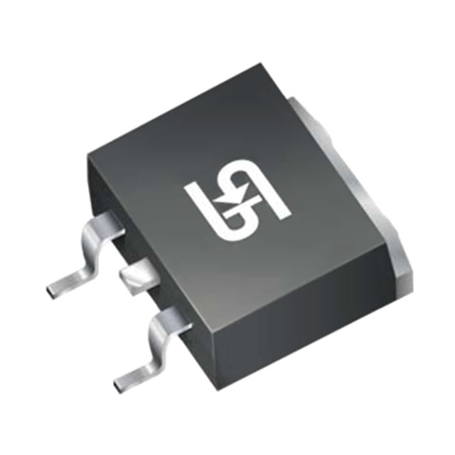

TS2940 Taiwan Semiconductor 1A Ultra Low Dropout Voltage Regulator GENERAL DESCRIPTION FEATURES The TS2940 series of fixed-voltage monolithic micropower voltage regulators is designed for a wide range of applications. This device excellent choice of use in battery-power application. Furthermore, the quiescent current increases on slightly at dropout, which prolongs battery life. This series of fixed-voltage regulators features low drop output voltage (Typ. 60mV at light load and 600mV at 800mA). This includes a tight initial tolerance of 2%, extremely good line regulation of 0.05% typ., and very low output temperature coefficient. ● Dropout voltage typically 0.6V @ Io=800mA ● Output current up to 1A ● Output voltage trimmed before assembly ● -18V Reverse peak voltage ● +30V Input over voltage protection ● +60V Transient peak voltage ● Internal current limit ● Thermal shutdown protection TO-220 2 TO-263 (D PAK) APPLICATION ● Post Regulator for SMPS ● Industrial Instrumentation TO-252 (DPAK) SOT-223 Pin Definition: 1. Input 2. Ground 3. Output Notes: Moisture sensitivity level: level 3. Per J-STD-020 TYPICAL APPLICATION CIRCUIT Document Number: DS_P0000211 1 Version: D15 TS2940 Taiwan Semiconductor ABSOLUTE MAXIMUM RATINGS (TA = 25°C unless otherwise noted) PARAMETER Input Supply Voltage (Note 2) Input Supply Voltage Power Dissipation (Note 3) Operating Junction Temperature Range Storage Temperature Range SYMBOL LIMIT UNIT VIN -18 ~ +60 V VOPR 26 V PD Internally Limited W TJ -40 ~ +125 °C TSTG -65 ~ +150 °C SYMBOL LIMIT UNIT THERMAL PERFORMANCE PARAMETER PACKAGE TYPE 60 TO-220 Thermal Resistance TO-263 Junction to Ambient TO-252 80 RӨJA °C/W 150 SOT-223 170 Notes: RӨJA is the sum of the junction-to-case and case-to-ambient thermal resistances. The case thermal reference is defined at the solder mounting surface of the drain pins. RӨJA is guaranteed by design while RӨCA is determined by the user’s board design. RӨJA shown below for single device operation on FR-4 PCB in still air. ELECTRICAL SPECIFICATIONS (VIN=VOUT+1V, IL=5mA, CO=22µF, TA=25°C, unless otherwise noted) PARAMETER CONDITIONS Input Supply Voltage 5mA ≤ IL ≤ 800mA, Output Voltage MIN TYP MAX UNIT -- -- 26 V 1.030|Vo| V 0.970|Vo| Vo+5V ≤ VIN ≤ 26V Output Voltage Temperature Coefficient 5.0 3.3 -- 50 150 ppm/°C Line Regulation Vo+2V ≤ VIN ≤ 26V -- 0.05 0.5 % Load Regulation 5mA ≤ IL ≤ 800mA -- 0.2 1.0 % IL=100mA -- 100 200 IL=500mA -- 300 500 IL=800mA -- 600 800 IL=5mA -- 10 15 IL=800mA -- 75 110 VOUT =0 -- -- 1.5 CL=2.2µF -- 500 -- CL=3.3µF -- 350 -- CL=33µF -- 120 -- Dropout Voltage (Note 4) Quiescent Current (Note 5) Short Circuit Current (Note 6) Output Noise, 10Hz to 100KHz, IL=10mA Document Number: DS_P0000211 2 mV mA A µVrms Version: D15 TS2940 Taiwan Semiconductor ELECTRICAL SPECIFICATIONS Note: 1. 2. 3. 4. 5. 6. Absolute Maximum Rating is limits beyond which damage to the device may occur. For guaranteed specifications and test conditions see the electrical characteristics. Maximum positive supply voltage of 60V must be limited duration (

物料型号:TS2940,来自台湾半导体公司。
器件简介:TS2940系列是固定电压单片微功耗电压调节器,适用于广泛的应用场景,特别适合电池供电的应用。在接近掉电时,静态电流略有增加,有助于延长电池寿命。该系列调节器具有低掉电输出电压(典型值为轻载时60mV,800mA时600mV),初始精度紧为2%,极好的线条调节为0.05%,输出温度系数非常低。
引脚分配:以SOT-223封装为例,引脚定义为1. 输入,2. 地,3. 输出。
参数特性: - 掉电电压典型值为0.6V(Io=800mA)。 - 输出电流高达1A。 - 输出电压在组装前已调整。 - 反向峰值电压-18V。 - 输入过电压保护+30V。 - 瞬态峰值电压+60V。 - 内部电流限制。 - 热关断保护。
功能详解: - TS2940系列是高性能低掉电电压调节器,适用于中到高电流和电压调节器应用。 - 与传统NPN晶体管设计不同,PNP输出的掉电性能仅受低Vce饱和电压限制。 - 该系列具有全面的保护措施,包括线性电流限制和热关断保护。
应用信息: - 适用于SMPS的后调节器、工业仪表等。 - 需要一个输出电容器来维持稳定性和改善瞬态响应。 - 如果输出电流过小,泄漏电流将占主导地位,输出电压会上升。至少需要10mA的最小负载电流以确保正确的调节。
封装信息:提供多种封装类型,包括TO-220、TO-263、TO-252和SOT-223,每种封装都有详细的尺寸和标记图。
订购信息:列出了不同输出电压的型号、封装类型和包装方式。
