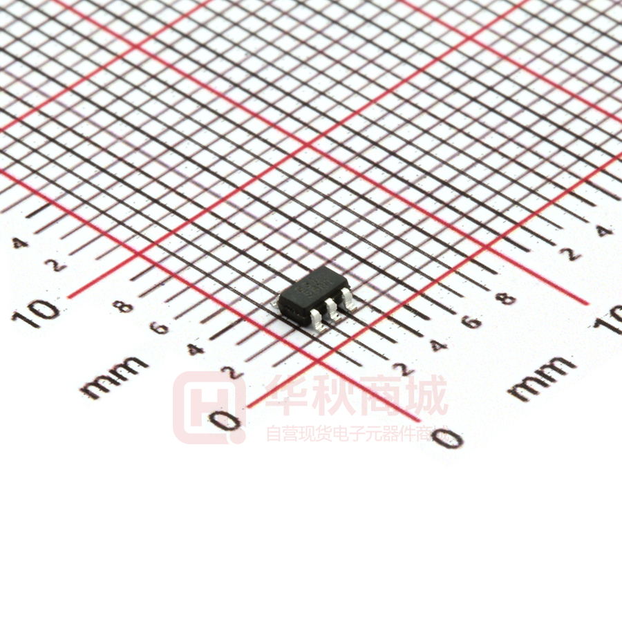

RS331, RS393, RS339 General-Purpose Low-Voltage Open-Drain Output Comparator FEATURES • Supply Range: +1.8V to +5.5V • Low Supply Current 50μA (TYP) per channel at VS = 5V Input Common-Mode Voltage Range Includes Ground • • Low Output Saturation Voltage 150mV Typical • Open-Drain Output for Maximum Flexibility • SPECIFIED UP TO +85°C • Micro SIZE DESCRIPTION The RS331 and RS393 is the single and dual comparator version, the RS339 is quad comparator version, and both are open-drain output comparators for maximum flexibility. It can operate from 1.8V to 5.5V, and have low power consuming 50μA (TYP) per channel. The RS331, RS393 and RS339 are the most costeffective solutions for applications where low voltage operation, low power and space saving are the primary specifications in circuit design for portable consumer products. PACKAGES: SOT23-5 The RS331, RS393 and RS339 are available in Green SOT23-5, SOIC-8, SOIC-14 and TSSOP-14 packages. It operates over an ambient temperature range of 40°C to +85°C. Device Information (1) APPLICATIONS • Hysteresis Comparators • • Oscillators Window Comparators • Industrial Equipment • Test and Measurement PART NUMBER PACKAGE BODY SIZE (NOM) RS331 SOT23-5 1.60mm×2.92mm RS393 RS339 (1) REV A.3 1 SOIC-8 4.90mm×3.90mm SOIC-14 8.65mm×3.90mm TSSOP-14 5.00mm×4.40mm For all available packages, see the orderable addendum at the end of the data sheet. www.run-ic.com RS331, RS393, RS339 Pin Configuration and Functions (Top View) RS331 1 V- 2 -IN 3 5 V+ 4 OUT + +IN - SOT23-5 Pin Description PIN SOT23-5 1 2 3 4 5 NAME +IN V-IN OUT V+ I/O (1) DESCRIPTION I P I O P Noninverting input Negative (lowest) power supply Inverting input Output Positive (highest) power supply (1)I=Input, O=Output, P=Power RS393 OUT A 1 -IN A 2 +IN A 3 V- + A B+ 4 8 V+ 7 OUTB 6 -IN B 5 +IN B SOIC-8(SOP8) Pin Description NAME OUTA -INA +INA V+INB -INB OUTB V+ PIN SOIC-8(SOP8) 1 2 3 4 5 6 7 8 I/O (1) O I I P I I O P DESCRIPTION Output, channel A Inverting input, channel A Noninverting input, channel A Negative (lowest) power supply Noninverting input, channel B Inverting input, channel B Output, channel B Positive (highest) power supply (1)I=Input, O=Output, P=Power 2 www.run-ic.com RS331, RS393, RS339 Pin Configuration and Functions (Top View) RS339 OUT B 1 14 OUT C OUT A 2 13 OUT D V+ 3 12 V- -IN A 4 11 +IN D +IN A 5 10 -IN D -IN B 6 9 +IN C +IN B 7 8 -IN C SOIC-14(SOP14)/TSSOP-14 Pin Description NAME OUTB OUTA V+ -INA +INA -INB +INB -INC +INC -IND +IND VOUTD OUTC PIN SOIC-14(SOP14)/TSSOP-14 1 2 3 4 5 6 7 8 9 10 11 12 13 14 I/O (1) O O P I I I I I I I I P O O DESCRIPTION Output, channel B Output, channel A Positive (highest) power supply Inverting input, channel A Noninverting input, channel A Inverting input, channel B Noninverting input, channel B Inverting input, channel C Noninverting input, channel C Inverting input, channel D Noninverting input, channel D Negative (lowest) power supply Output, channel D Output, channel C (1)I=Input, O=Output, P=Power 3 www.run-ic.com RS331, RS393, RS339 SPECIFICATIONS Absolute Maximum Ratings Over operating free-air temperature range (unless otherwise noted) (1) MIN Voltage Current Temperature MAX 7 (V-)-0.3 (V+) +0.3 (V-)-0.3 (V+) +0.3 -10 10 -55 55 Continuous -40 85 150 -65 150 Supply, Vs=(V+) - (V-) Input pin (IN+, IN-) (2) Signal output pin (3) Signal input pin (IN+, IN-) (2) Signal output pin (3) Output short-circuit (4) Operating range, TA Junction, TJ Storage, Tstg UNIT V mA mA °C (1) Stresses above these ratings may cause permanent damage. Exposure to absolute maximum conditions for extended periods may degrade device reliability. These are stress ratings only, and functional operation of the device at these or any other conditions beyond those specified is not implied. (2) Input terminals are diode-clamped to the power-supply rails. Input signals that can swing more than 0.5V beyond the supply rails should be currentlimited to 10mA or less. (3) Output terminals are diode-clamped to the power-supply rails. Output signals that can swing more than 0.5V beyond the supply rails should be current-limited to ±55mA or less. (4) Short-circuit from output to VCC can cause excessive heating and eventual destruction. ESD Ratings VALUE V(ESD) Electrostatic discharge Human-body model (HBM), per ANSI/ESDA/JEDEC JS001, all pins (1) Charged device model (CDM), per JEDEC specification JESD22-C101, all pins (2) UNIT 2000 V 1000 (1) JEDEC document JEP155 states that 500V HBM allows safe manufacturing with a standard ESD control process. (2) JEDEC document JEP157 states that 250V CDM allows safe manufacturing with a standard ESD control process. Recommended Operating Conditions Over operating free-air temperature range (unless otherwise noted) Supply voltage,Vs= (V+) - (V-) MIN 1.8 ±0.9 Single-supply Dual-supply NOM MAX 5.5 ±2.75 UNIT V Thermal Information:RS331 THERMAL METRIC (1) RS331 5PINS SOT23-5 273.8 °C/W UNIT RϴJA Junction-to-ambient thermal resistance RϴJC(top) Junction-to-case(top) thermal resistance 126.8 °C/W RϴJB Junction-to-board thermal resistance 85.9 °C/W ѰJT ѰJB Junction-to-top characterization parameter Junction-to-board characterization parameter 10.9 84.9 °C/W °C/W RϴJC(bot) Junction-to-case(bottom) thermal resistance N/A °C/W 4 www.run-ic.com RS331, RS393, RS339 Thermal Information:RS393 THERMAL METRIC (1) RS393 8PINS SOIC-8(SOP-8) 116 °C/W 60 °C/W UNIT RϴJA Junction-to-ambient thermal resistance RϴJC(top) Junction-to-case(top) thermal resistance RϴJB Junction-to-board thermal resistance 56 °C/W ѰJT ѰJB Junction-to-top characterization parameter Junction-to-board characterization parameter 12.8 98.3 °C/W °C/W RϴJC(bot) Junction-to-case(bottom) thermal resistance N/A °C/W Thermal Information:RS339 RS339 14PINS SOIC-14(SOP-14) TSSOP-14 83.8 205.8 THERMAL METRIC (1) UNIT RϴJA Junction-to-ambient thermal resistance RϴJC(top) Junction-to-case(top) thermal resistance 70.7 106.7 °C/W °C/W RϴJB Junction-to-board thermal resistance 59.5 133.9 °C/W ѰJT ѰJB Junction-to-top characterization parameter Junction-to-board characterization parameter 11.6 37.7 34.4 132.6 °C/W °C/W RϴJC(bot) Junction-to-case(bottom) thermal resistance N/A N/A °C/W PACKAGE/ORDERING INFORMATION Orderable Device Package Type Pin Channel Op Temp(°C) Device Marking Package Qty RS331XF SOT23-5 5 1 -40°C ~+85°C 331 Tape and Reel,3000 RS393XK SOIC-8(SOP8) 8 2 -40°C ~+85°C RS393 Tape and Reel,2500 RS339XP SOIC-14(SOP14) 14 4 -40°C ~+85°C RS339 Tape and Reel,2500 RS339XQ TSSOP-14 14 4 -40°C ~+85°C RS339 Tape and Reel,3000 5 www.run-ic.com RS331, RS393, RS339 ELECTRICAL CHARACTERISTICS(VS=5.0V) (At TA = +25C, VCM=Vs/2, unless otherwise noted.) PARAMETER CONDITIONS RS331/RS393/RS339 TYP MAX MIN UINTS POWER SUPPLY Vs Operating Voltage Range IQ Quiescent Current/per channel PSRR Power-Supply Rejection Ratio 1.8 50 Vs=1.8V to 5.5V, VCM=(V)+0.5V 5.5 V 100 μA 70 dB INPUT VOS ΔVos/ΔT Input offset voltage Input Offset Voltage Drift -3.5 VCM =Vs/2, -40°C ≤ TA ≤ 85°C ±0.6 3.5 mV μV/°C 0.5 IB Input Bias Current 1 10 pA IOS Input Offset Current 1 10 pA VCM Common-Mode Voltage Range TA = –40°C to 85°C (V+)+0.1 V CMRR Power-Supply Rejection Ratio VCM =-0.1 to 5.6V 70 VSAT Saturation Voltage Io≤4mA 150 VOH Output Pull-up Voltage Range VO≤1.5V 27 (V-)-0.1 dB OUTPUT IO Output Current(sinking) ILEAK Output Leakage Current 350 5.6 0.01 mV V mA 10 nA SWITCHING TPHL TPLH TF Propagation Delay H To L Propagation Delay L To H Fall Time RPU=5.1KΩ, Overdrive =10mV 205 RPU=5.1KΩ, Overdrive =100mV 185 RPU=5.1KΩ, Overdrive =10mV 660 RPU=5.1KΩ, Overdrive =100mV 700 RPU=5.1KΩ, Overdrive =100mV 42 6 ns ns www.run-ic.com RS331, RS393, RS339 ELECTRICAL CHARACTERISTICS(VS=2.7V) (At TA = +25C, VCM=Vs/2, unless otherwise noted.) PARAMETER CONDITIONS RS331/RS393/RS339 TYP MAX MIN UINTS POWER SUPPLY Vs Operating Voltage Range IQ Quiescent Current/per channel PSRR Power-Supply Rejection Ratio 1.8 48 Vs=1.8V to 5.5V, VCM=(V)+0.5V 5.5 V 80 μA 70 dB INPUT VOS ΔVos/ΔT Input offset voltage Input Offset Voltage Drift -3.5 VCM =Vs/2, -40°C ≤ TA ≤85°C ±0.6 3.5 mV μV/°C 0.5 IB Input Bias Current 1 10 pA IOS Input Offset Current 1 10 pA VCM Common-Mode Voltage Range TA = –40°C to 85°C (V+)+0.1 V CMRR Power-Supply Rejection Ratio VCM =-0.1 to 2.8V 70 dB VSAT Saturation Voltage Io≤2.2mA 144 mV VOH Output Pull-up Voltage Range VO≤1.5V 13 (V-)-0.1 OUTPUT IO Output Current(sinking) ILEAK Output Leakage Current 5.6 0.01 V mA 10 nA SWITCHING TPHL TPLH TF Propagation Delay H To L Propagation Delay L To H Fall Time RPU=5.1KΩ, Overdrive =10mV 250 RPU=5.1KΩ, Overdrive=100mV 230 RPU=5.1KΩ, Overdrive =10mV 680 RPU=5.1KΩ, Overdrive=100mV 702 RPU=5.1KΩ, Overdrive=100mV 52 7 ns ns www.run-ic.com RS331, RS393, RS339 ELECTRICAL CHARACTERISTICS(VS=1.8V) (At TA = +25C, VCM=Vs/2, unless otherwise noted.) PARAMETER CONDITIONS RS331/RS393/RS339 TYP MAX MIN UINTS POWER SUPPLY Vs Operating Voltage Range IQ Quiescent Current/per channel PSRR Power-Supply Rejection Ratio 1.8 40 Vs=1.8V to 5.5V, VCM=(V)+0.5V 5.5 V 70 μA 70 dB INPUT VOS ΔVos/ΔT Input offset voltage Input Offset Voltage Drift -3.5 VCM =Vs/2, -40°C ≤ TA ≤85°C ±0.6 3.5 mV μV/°C 0.5 IB Input Bias Current 1 10 pA IOS Input Offset Current 1 10 pA VCM Common-Mode Voltage Range TA = –40°C to 85°C (V+)+0.1 V CMRR Power-Supply Rejection Ratio VCM =-0.1 to 1.9V 70 dB VSAT Saturation Voltage Io≤1.5mA 144 mV VOH Output Pull-up Voltage Range VO≤0.8V 5 (V-)-0.1 OUTPUT IO Output Current(sinking) ILEAK Output Leakage Current 5.6 0.01 V mA 10 nA SWITCHING TPHL TPLH TF Propagation Delay H To L Propagation Delay L To H Fall Time RPU=5.1KΩ, Overdrive =10mV 272 RPU=5.1KΩ, Overdrive=100mV 270 RPU=5.1KΩ, Overdrive =10mV 712 RPU=5.1KΩ, Overdrive=100mV 706 RPU=5.1KΩ, Overdrive=100mV 110 8 ns ns www.run-ic.com RS331, RS393, RS339 TYPICAL CHARACTERISTICS At TA = +25C, Vs=5V, VCM = VS/2, CL=15pF unless otherwise noted. Supply Current vs Supply Voltage Output Low 55 50 50 Supply Current(μA) Supply Current(μA) Supply Current vs Supply Voltage Output High 55 45 40 35 30 25 45 40 35 30 25 20 20 1 2 3 4 5 1 2 Supply Voltage(V) Output Voltage vs Output Current 4 5 INPUT BIAS CURRENT vs TEMPERATURE 10K 2000 3 Supply Voltage(V) Input Bias Current(pA) Output Voltage(mV) 1800 1600 1400 1200 1000 800 600 400 1K 100 10 1 200 0 0.1 0 10 15 20 Output Current(mA) 25 30 -40 -20 Response Time vs Input Overdrives Negative Transition(VCC=5V) 730 210 720 205 710 Time(ns) Time(ns) 215 5 200 195 20 40 60 80 100 120 140 Temperature(℃) Response Time vs Input Overdrives Positive Transition(VCC=5V) 700 690 190 680 185 670 180 0 660 0 10 20 30 40 50 60 70 80 90 100 0 Overdrive(mV) 9 10 20 30 40 50 60 70 80 90 100 Overdrive(mV) www.run-ic.com RS331, RS393, RS339 800 310 780 300 760 Time(ns) Time(ns) 320 Response Time vs Input Overdrives Negative Transition(VCC=1.8V) 290 280 740 720 270 700 260 680 250 660 240 Response Time vs Input Overdrives Positive Transition(VCC=1.8V) 640 0 10 20 30 40 50 60 70 80 90 100 0 Overdrive(mV) 10 10 20 30 40 50 60 70 80 90 100 Overdrive(mV) www.run-ic.com RS331, RS393, RS339 Detailed Description Overview The RS331, RS393 and RS339 family of comparators can operate up to 5.5V on the supply pin. This standard device has proven ubiquity and versatility across a wide range of applications. This is due to its low power and high speed. The open-drain output allows the user to configure the output's logic low voltage (VOL) and can be utilized to enable the comparator to be used in AND functionality. V+ IN+ IN- + OUT - V- Figure 1. Functional Block Diagram 11 www.run-ic.com RS331, RS393, RS339 Application and Implementation Application Information RS331, RS393 and RS339 will typically be used to compare a single signal to a reference or two signals against each other. Many users take advantage of the open drain output (logic high with pull-up) to drive the comparison logic output to a logic voltage level to an MCU or logic device. Typical Application VLOGIC VLOGIC VSUP VIN VSUP RPULLUP + VIN+ RS331 RPULLUP + RS331 Vref VIN- Figure 2. Typical Application Schematic Power Supply Recommendations For fast response and comparison applications with noisy or AC inputs, it is recommended to use a bypass capacitor on the supply pin to reject any variation on the supply voltage. This variation causes temporary fluctuations in the comparator's input common mode range and create an inaccurate comparison. Layout Layout Guidelines For accurate comparator applications without hysteresis it is important maintain a stable power supply with minimized noise and glitches, which can affect the high-level input common mode voltage range. In order to achieve this, it is best to add a bypass capacitor between the supply voltage and ground. This should be implemented on the positive power supply and negative supply (if available). If a negative supply is not being used, do not put a capacitor between the IC's GND pin and system ground. Layout Example Gro und Bypass Ca pacito r Ne gative Supply or Ground Only n eeded for dual pow er supplies IN+ 1 GND IN – 2 3 5 VCC 4 OUT 0.1 μ F Positive Su pply 0.1 μ F Gro und Figure 3. RS331 Layout Example 12 www.run-ic.com RS331, RS393, RS339 PACKAGE OUTLINE DIMENSIONS SOT23-5 D 1.90 b 2.59 E1 E 0.99 0.95 0.69 e e1 RECOMMENDED LAND PATTERN (Unit: mm) 0.2 A A2 L A1 Symbol c θ Dimensions In Millimeters Dimensions In Inches Min Max Min Max A 1.050 1.250 0.041 0.049 A1 0.000 0.100 0.000 0.004 A2 1.050 1.150 0.041 0.045 b 0.300 0.500 0.012 0.020 c 0.100 0.200 0.004 0.008 D 2.820 3.020 0.111 0.119 E 1.500 1.700 0.059 0.067 E1 2.650 2.950 0.104 0.116 e 0.950(BSC) 0.037(BSC) e1 1.800 2.000 0.071 0.079 L 0.300 0.600 0.012 0.024 θ 0° 8° 0° 8° 13 www.run-ic.com RS331, RS393, RS339 SOIC-8(SOP8) b e 5.2 E E1 2.2 D 1.27 0.6 RECOMMENDED LAND PATTERN (Unit: mm) A2 c A A1 Symbol L Dimensions In Millimeters θ Dimensions In Inches Min Max Min Max A 1.350 1.750 0.053 0.069 A1 0.100 0.250 0.004 0.010 A2 1.350 1.550 0.053 0.061 b 0.330 0.510 0.013 0.020 c 0.170 0.250 0.007 0.010 D 4.800 5.000 0.189 0.197 e 1.270(BSC) 0.050(BSC) E 5.800 6.200 0.228 0.244 E1 3.800 4.000 0.150 0.157 L 0.400 1.270 0.016 0.050 θ 0° 8° 0° 8° 14 www.run-ic.com RS331, RS393, RS339 SOIC-14(SOP14) e b 5.2 1.27 E E1 0.6 D 1.27 RECOMMENDED LAND PATTERN (Unit: mm) A2 A1 A c θ L Symbol Dimensions In Millimeters Dimensions In Inches Min Max Min Max A 1.350 1.750 0.053 0.069 A1 0.100 0.250 0.004 0.010 A2 1.350 1.550 0.053 0.061 b 0.310 0.510 0.012 0.020 c 0.100 0.250 0.004 0.010 D 8.450 8.850 0.333 0.348 e 1.270(BSC) 0.050(BSC) E 5.800 6.200 0.228 0.244 E1 3.800 4.000 0.150 0.157 L 0.400 1.270 0.016 0.050 θ 0° 8° 0° 8° 15 www.run-ic.com RS331, RS393, RS339 TSSOP-14 e b 5.6 E1 E 1.78 D 0.65 0.42 RECOMMENDED LAND PATTERN (Unit: mm) A2 A A1 Symbol H C θ L Dimensions In Millimeters Min Max A Dimensions In Inches Min Max 1.200 0.047 A1 0.050 0.150 0.002 0.006 A2 0.800 1.050 0.031 0.041 b 0.190 0.300 0.007 0.012 c 0.090 0.200 0.004 0.008 D 4.860 5.100 0.191 0.201 E 4.300 4.500 0.169 0.177 E1 6.250 6.550 0.246 0.258 e L 0.650(BSC) 0.500 H θ 0.026(BSC) 0.700 0.020 0.25(TYP) 1° 0.028 0.01(TYP) 7° 16 1° 7° www.run-ic.com
RS331XF
物料型号: - RS331:单通道版本,SOT23-5封装 - RS393:双通道版本,SOIC-8封装 - RS339:四通道版本,SOIC-14和TSSOP-14封装
器件简介: 这些是比较器,具有开漏输出,可在1.8V至5.5V的电压范围内工作,具有低功耗(每通道50μA典型值)和包括地在内的输入共模电压范围。它们适用于便携式消费产品的电路设计,具有成本效益。
引脚分配: - RS331:SOT23-5封装,包括非反相输入(+IN)、反相输入(-IN)、输出(OUT)、正电源(V+)和负电源(V-) - RS393:SOIC-8封装,包括两个通道的非反相输入、反相输入和输出 - RS339:SOIC-14/TSSOP-14封装,包括四个通道的非反相输入、反相输入和输出
参数特性: - 供电电压范围:1.8V至5.5V - 静态电流:每通道50μA(典型值) - 输出饱和电压:典型值150mV - 工作温度范围:-40°C至+85°C
功能详解: 这些比较器可以用于滞后比较器、振荡器、窗口比较器等应用,适用于工业设备和测试测量设备。
应用信息: 用户通常使用这些比较器将单个信号与参考电压比较,或将两个信号相互比较。开漏输出允许用户配置输出的低电平电压,并可用于使比较器在AND功能中使用。
