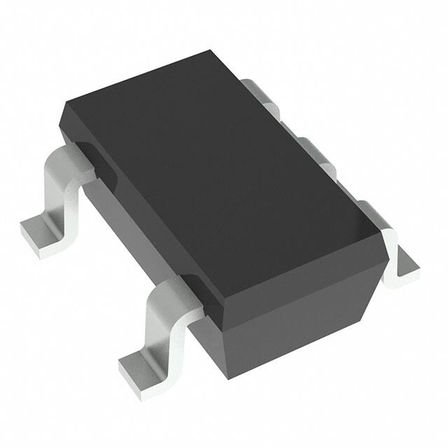

NJU77240/NJU77241/NJU77242 Excellent EMI Immunity Rail-to-Rail Input, Open-Drain Output Low power CMOS Comparators + - ■ FEATURES (V =3V, V =0V, Ta=25°C) ●Rail-to-Rail Input ●Open-Drain Output ●Supply Current ●Propagation Delay ●Operating Voltage ●Input Offset Voltage ●Operating Temperature ●Integrated EMI filter ●Package NJU77240 NJU77241 NJU77242 ■ GENERAL DESCRIPTION The NJU77240/NJU77241/NJU77242 are rail-to-rail input CMOS comparators featuring low-power and opendrain output. 6µA/ch typ. 840ns typ. 1.8 to 5.5V 6mV max. -40 to 125°C These comparators operate from 1.8V to 5.5V and low supply current of 6µA/ch. typ. This feature is suitable for battery powered application. EMIRR=62dB typ. @f=900MHz The NJU77241/NJU77242 are available in small size package, DFN6-G1 (1616), DFN8-U1 (2020), significantly reducing the required portable application's board area. SOT-23-5, SC88A SOT-23-5, SC88A, DFN6-G1 (ESON6-G1) MSOP8 (TVSP8)* *meet JEDEC MO-187-DA / thin type, DFN8-U1 (ESON8-U1) ■ APPLICATIONS ■ RELATED PRODUCTS ●Portable and Battery-Powered Applications ●Alarm and Surveillance Circuits ●Industrial Instruments ●Sensor Applications Features Rail-to-Rail Input Push-Pull Output, Low power CMOS Comparators Single Dual NJU77230 NJU77231 NJU77232 ■ PIN CONFIGURATIONS PRODUCT NAME NJU77240F NJU77240F3 NJU77241F NJU77241F3 Package SOT-23-5 SC-88A SOT-23-5 SC-88A (Top View) Pin Functions +INPUT 1 V- 2 -INPUT 3 (Top View) 5 V+ 4 OUTPUT -INPUT 1 V- 2 +INPUT 3 5 V+ 4 OUTPUT PRODUCT NAME NJU77241KG1 NJU77242RB1 NJU77242KU1 Package DFN6-G1 (ESON6-G1)* MSOP8 (TVSP8) DFN8-U1 (ESON8-U1) * V+ 1 Pin Functions NC 2 OUTPUT 3 Exposed Pad on Underside (Top View) (Top View) (Top View) 6 V- 5 -INPUT 4 +INPUT A OUTPUT 1 8 V+ A -INPUT 2 7 B OUTPUT A +INPUT V- 3 4 6 5 A OUTPUT 1 A -INPUT 2 B -INPUT A +INPUT 3 B +INPUT V- 4 Exposed Pad on Underside 8 V+ 7 B OUTPUT 6 B -INPUT 5 B +INPUT - *Connect to exposed pad to V Ver.6 http://www.njr.com/ -1- NJU77240/NJU77241/NJU77242 ■ BLOCK DIAGRAM V+ -INPUT OUTPUT +INPUT V- ■ PRODUCT NAME INFORMATION NJU77240 F (TE1) Package Part Number Taping Form ■ ORDERING INFORMATION PACKAGE RoHS HALOGENFREE TERMINAL FINISH MARKING NJU77240F SOT-23-5 Yes Yes Sn2Bi 1K 15 3000 NJU77240F3 SC-88A Yes Yes Sn2Bi F3 7.5 3000 NJU77241F SOT-23-5 Yes Yes Sn2Bi 1L 15 3000 NJU77241F3 SC-88A Yes Yes Sn2Bi F4 7.5 3000 NJU77241KG1 DFN6-G1 Yes Yes Sn2Bi 77241 3.5 3000 NJU77242RB1 MSOP8 (TVSP8) Yes Yes Sn2Bi 77242 18 2000 NJU77242KU1 DFN8-U1 Yes Yes Sn2Bi 77242 5.3 3000 PART NUMBER WEIGHT (mg) MOQ (pcs) ■ ABSOLUTE MAXIMUM RATINGS PARAMETER + Supply Voltage Input Voltage (1,2) Input Current (2) Differential Input Voltage SYMBOL (3) RATING - UNIT V -V 7 VIN V - 0.3 to V + 0.3 V IIN 10 mA - V + VID ±7 Output Terminal Input Voltage Power Dissipation (Ta=25°C) (5) SOT-23-5 (5) SC-88A (6) DFN6-G1 (5) MSOP8 (TVSP8) (6) DFN8-U1 Vo V - 0.3 to V +7 2-Layer / 4-Layer 480 / 650 360 / 490 330 / 1200 510 / 680 450 / 1200 Junction Temperature Range Tjmax 150 °C Storage Temperature Range Tstg - 55 to 150 °C (4) PD - V - V mW (1) The absolute maximum input voltage is limited at 7V. (2) Input voltages outside the supply voltage will be clamped by ESD protection diodes. If the input voltage exceeds the supply voltage, the input current must be limited 10 mA or less by using a restriction resistance. (3) Differential voltage is the voltage difference between +INPUT and - INPUT. For supply voltage less than +7V, the absolute maximum rating is equal to the supply voltage. (4) The absolute maximum of Output Terminal Input Voltage is limited at 7V. (5) 2-Layer:Mounted on glass epoxy board. (76.2×114.3×1.6mm:based on EIA/JDEC standard, 2-layer FR-4) 4-Layer:Mounted on glass epoxy board. (76.2×114.3×1.6mm:based on EIA/JDEC standard, 4-layer FR-4), internal Cu area: 74.2 x 74.2mm (6) 2-Layer:Mounted on glass epoxy board. (101.5×114.5×1.6mm: based on EIA/JEDEC standard, 2-layer FR-4, with Exposed Pad) 4-Layer:Mounted on glass epoxy board. (101.5×114.5×1.6mm: based on EIA/JEDEC standard, 4-layer FR-4, with Exposed Pad) *For 4-layer: Applying 99.5×99.5mm inner Cu area and a thermal via hole to a board based on JEDEC standard JESD51-5 Ver.6 http://www.njr.com/ -2- NJU77240/NJU77241/NJU77242 ■ THERMAL CHARACTERISTICS PARAMETER SYMBOL Junction-to-Ambient Thermal Resistance (7) SOT-23-5 (7) SC-88A (8) DFN6-G1 (7) MSOP8 (TVSP8) (8) DFN8-U1 Junction-to-Top of Package Characterization Parameter (7) SOT-23-5 (7) SC-88A (8) DFN6-G1 (7) MSOP8 (TVSP8) (8) DFN8-U1 VALUE UNIT θja 2-Layer / 4-Layer 259 / 193 352 / 256 381 / 106 244 / 185 278 / 107 °C /W ψjt 2-Layer / 4-Layer 67 / 58 91 / 73 64 / 26 51 / 45 42 / 25 °C /W (7) 2-Layer:Mounted on glass epoxy board. (76.2×114.3×1.6mm:based on EIA/JDEC standard, 2-layer FR-4) 4-Layer:Mounted on glass epoxy board. (76.2×114.3×1.6mm:based on EIA/JDEC standard, 4-layer FR-4), internal Cu area: 74.2 x 74.2mm (8) 2-Layer:Mounted on glass epoxy board. (101.5×114.5×1.6mm: based on EIA/JEDEC standard, 2-layer FR-4, with Exposed Pad) 4-Layer:Mounted on glass epoxy board. (101.5×114.5×1.6mm: based on EIA/JEDEC standard, 4-layer FR-4, with Exposed Pad) *For 4-Layer: Applying 99.5×99.5mm inner Cu area and a thermal via hole to a board based on JEDEC standard JESD51-5) ■ POWER DISSIPATION vs. AMBIENT TEMPERATURE Power Dissipation vs. Temperature Power Dissipation vs. Temperature 2-Layer 700 4-Layer 1400 Power Dissipation PD [mW] Power Dissipation PD [mW] MSOP8(TVSP8) 600 SOT-23-5 500 DFN8-U1(ESON8-U1) 400 SC-88A 300 200 DFN6-G1(ESON6-G1) 100 0 1200 DFN6-G1(ESON6-G1) DFN8-U1(ESON8-U1) 1000 MSOP8(TVSP8) 800 SOT-23-5 600 400 SC-88A 200 0 0 25 50 75 100 125 Ambient Temperature Ta [ºC] 150 0 25 50 75 100 125 Ambient Temperature Ta [ºC] 150 ■ RECOMMENDED OPERATING CONDITIONS PARAMETER Supply Voltage Single Supply Dual Supply Operating Temperature Range Output Terminal Input Voltage Ver.6 SYMBOL + - V -V + V /V Topr Vo http://www.njr.com/ VALUE UNIT 1.8 to 5.5 ±0.9 to ±2.75 - 40 to 125 V - - V to V +5.5 °C V -3- NJU77240/NJU77241/NJU77242 ■ ELECTRICAL CHARACTERISTICS ● DC CHARACTERISTICS + - (Unless otherwise specified, V =3V, V =0V, Ta=25°C) °C PARAMETER SYMBOL Supply Current (per comparator) ISUPPLY TEST CONDITIONS MIN TYP MAX UNIT VID=100mV,VCOM=0V, RL=∞ - 6 10 µA VID=100mV,VCOM=3V, RL=∞ - 9 14 µA VCOM=0V - 1 6 mV Input Offset Voltage VIO - 1 7 mV Input Offset Current IIO - 1 - pA Input Bias Current IB - 1 - pA Common Mode Input Voltage Range Open-Loop Voltage Gain VCOM=3V VICM Av Common Mode Rejection Ratio CMR CMR≥50dB 0 - 3 V RL=5.1kΩ - 100 - dB 50 70 - dB 65 85 - dB VICM=0V to 3V + Supply Voltage Rejection Ratio SVR VCOM=0V, V =1.8V to 5.5V, Output Leakage Current ILEAK VO=3.0V - 0.001 500 nA Low-level Output Voltage VOL ISINK=3mA - 0.2 0.3 V ● SWITCHING CHARACTERISTICS + - (Unless otherwise specified, V =+3V, V =0V, Ta=25°C, CL=15pF, RL=5.1kΩ) PARAMETER SYMBOL TEST CONDITIONS MIN TYP MAX UNIT Propagation Delay Low to High tPLH Overdrive=100mV - 840 - ns Propagation Delay High to Low tPHL Overdrive =100mV - 450 - ns Output Signal Rising Time tTLH Overdrive =100mV - 260 - ns Output Signal Falling Time tTHL Overdrive =100mV - 7 - ns ■ TIMING WAVEFORM Over Drive INPUT Over Drive V IN V OH OUTPUT V OL 90% 90% 50% 50% 10% 10% tTHL tTLH tPLH Ver.6 tPHL http://www.njr.com/ -4- NJU77240/NJU77241/NJU77242 ■ TYPICAL CHARACTERISTICS Supply Current per Comparator vs. Supply Voltage Supply Current per Comparator [μA] 20 VCOM=0V, VID=100mV, RL=∞ 18 16 14 12 Ta=125ºC Ta=25ºC 10 8 6 4 Ta=-40ºC 2 Supply Current per Comparator vs. Supply Voltage V- =0V, VCOM=V+, VID=100mV, RL=∞ 20 Supply Current per Comparator [μA] V- =0V, 0 18 16 Ta=25ºC 14 12 10 8 6 Ta=-40ºC 4 2 0 0 1 2 3 4 5 Supply Voltage V+ [V] 6 7 0 V- =0V, VCOM=0V, VID=100mV, RL=∞ 18 16 14 V+=1.8V 12 V+=3V V+=5.5V 10 8 6 4 2 0 6 7 V- =0V, VCOM=V+, VID=100mV, RL=∞ 18 16 V+=1.8V V+=3V V+=5.5V 14 12 10 8 6 4 2 0 -50 -25 0 25 50 75 100 125 150 Ambient Temperature [ºC] -50 Supply Current per Comparator vs. Common-Mode Input Voltage Supply Current per Comparator [μA] 16 14 12 Ta=125ºC 10 8 6 4 Ta=-40ºC 2 0 25 50 75 100 125 150 Ambient Temperature [ºC] V+=3V, V- =0V, VID=100mV, RL=∞ 20 18 Ta=25ºC -25 Supply Current per Comparator vs. Common-Mode Input Voltage V+=3V, V- =0V, VID=100mV, RL=∞ 20 Supply Current per Comparator [μA] 2 3 4 5 Supply Voltage V+ [V] 20 Supply Current per Comparator [μA] Supply Current per Comparator [μA] 20 1 Supply Current per Comparator vs. Temperature Supply Current per Comparator vs. Temperature 0 18 16 14 Ta=25ºC 12 Ta=125ºC 10 8 6 4 Ta=-40ºC 2 0 0 Ver.6 Ta=125ºC 0.5 1 1.5 2 Input Voltage [V] 2.5 3 0 http://www.njr.com/ 0.5 1 1.5 2 Input Voltage [V] 2.5 3 -5- NJU77240/NJU77241/NJU77242 ■ TYPICAL CHARACTERISTICS Input Offset Voltage vs. Temperature 4 4 3 3 2 V+=1.8V 1 0 -1 -2 V+=5.5V V+=3V -3 V- =0V , VCOM=V+ 5 Input Offset Voltage [mV] Input Offset Voltage [mV] Input Offset Voltage vs. Temperature V- =0V , VCOM=0V 5 -4 2 V+=1.8V 1 0 -1 -2 -4 -5 -5 -50 -25 0 25 50 75 100 125 150 Ambient Temperature [ºC] -50 -25 Input Offset Voltage vs. Temperature 2 Input Offset Voltage [mV] Input Offset Voltage [mV] V+=3V, V-=0V, VCOM=V+ 3 1 0 -1 -2 -3 2 1 0 -1 -2 -3 -50 -25 0 25 50 75 100 125 150 Ambient Temperature [ºC] -50 Input Offset Voltage vs. Supply Voltage -25 0 25 50 75 100 125 150 Ambient Temperature [ºC] Input Offset Voltage vs. Supply Voltage V- =0V, VCOM=0V 5 V- =0V, VCOM=V+ 5 4 4 3 Ta=25ºC 2 Input Offset Voltage [mV] Input Offset Voltage [mV] 0 25 50 75 100 125 150 Ambient Temperature [ºC] Input Offset Voltage vs. Temperature V+=3V, V-=0V, VCOM=0V 3 Ta=125ºC 1 0 -1 -2 Ta=-40ºC -3 -4 3 Ta=125ºC 2 1 0 -1 Ta=-40ºC -2 Ta=25ºC -3 -4 -5 -5 1 Ver.6 V+=5.5V V+=3V -3 2 3 4 Supply Voltage V+ [V] 5 6 1 http://www.njr.com/ 2 3 4 Supply Voltage V+ [V] 5 6 -6- NJU77240/NJU77241/NJU77242 ■ TYPICAL CHARACTERISTICS Input Offset Voltage vs. Common-Mode Input Voltage Input Offset Voltage vs. Common-Mode Input Voltage V+=1.8V, V- =0V 5 4 4 3 Input Offset Voltage [mV] Input Offset Voltage [mV] V+=3V, V- =0V 5 Ta=-40ºC 2 1 0 -1 -2 Ta=25ºC Ta=125ºC -3 3 2 Ta=-40ºC 1 0 -1 -2 Ta=25ºC Ta=125ºC -3 -4 -4 -5 -5 0 0.3 0.6 0.9 1.2 1.5 Common-Mode Input Voltage [V] 1.8 0 0.5 1 1.5 2 2.5 Common-Mode Input Voltage [V] 3 Input Offset Voltage vs. Common-Mode Input Voltage 5 V+=5.5V, V- =0V Input Offset Voltage [mV] 4 3 2 Ta=-40ºC 1 0 -1 -2 Ta=25ºC Ta=125ºC -3 -4 -5 0 0.5 1 1.5 2 2.5 3 3.5 4 4.5 5 5.5 Common-Mode Input Voltage [V] Ver.6 http://www.njr.com/ -7- NJU77240/NJU77241/NJU77242 ■ TYPICAL CHARACTERISTICS Input Bias Current vs. Temperature Open-Loop Voltage Gain vs. Temperature VCOM=V+/2, V- =0V Input Bias Current [nA] 10 V+=5.5V 1 V+=3V 0.1 V+=3V, V- =0V, RL=5.1kΩ 140 Open-Loop Voltage Gain [dB] 100 V+=1.8V 0.01 0.001 120 100 80 60 40 20 0 25 50 75 100 125 Ambient Temperature [ºC] 150 -50 -25 SVR vs. Temperature V+=3V, V- =0V, VICM=0 to 3V 120 Common-Mode Rejection Ratio [dB] Supply Voltage Rejection Ratio [dB] CMR vs. Temperature V+=1.8V to 5.5V, V- =0V, VCOM=V+ 140 0 25 50 75 100 125 150 Ambient Temperature [ºC] 120 100 80 60 40 20 0 100 80 60 40 20 0 -50 -25 0 25 50 75 100 125 150 Ambient Temperature [ºC] -50 -25 0 25 50 75 100 125 150 Ambient Temperature [ºC] Output Leakage Current vs. Temperature V- =0V, VO=V+ Output Leakage Current [nA] 100 V+=5.5V 10 V+=3V 1 V+=1.8V 0.1 0.01 0.001 25 Ver.6 50 75 100 125 Ambient Temperature [ºC] 150 http://www.njr.com/ -8- NJU77240/NJU77241/NJU77242 ■ TYPICAL CHARACTERISTICS Low-level Output Voltage vs. Output Current 0.9 1.6 Ta=125ºC 1.4 1.2 Ta=25ºC 1 Ta=-40ºC 0.8 0.6 0.4 0.2 0.8 0.7 0.6 0.5 0.4 0.3 0.2 0.1 0 0 0 3 6 9 12 Output Current [mA] 15 -50 V+=3V, V- =0V, VID=100mV 0.9 Low-level Output Voltage [V] Low-level Output Voltage [V] 1.6 Ta=25ºC 1.4 1.2 Ta=-40ºC 1 0.8 0.6 0.4 0.8 0.7 0.6 0.5 0.4 0.3 0.2 0.1 0.2 0 0 0 3 6 9 12 15 18 21 24 27 30 Output Current [mA] -50 Low-level Output Voltage vs. Output Current -25 0 25 50 75 100 125 150 Ambient Temperature [ºC] Low-level Output Voltage vs. Temperature V+=5.5V, V- =0V, VID=100mV 2 V+=5.5V, V- =0V, VID=100mV, Iout=3mA 1 0.9 Low-level Output Voltage [V] 1.8 Low-level Output Voltage [V] 0 25 50 75 100 125 150 Ambient Temperature [ºC] V+=3V, V- =0V, VID=100mV, Iout=3mA 1 Ta=125ºC 1.8 -25 Low-level Output Voltage vs. Temperature Low-level Output Voltage vs. Output Current 2 Ta=125ºC 1.6 1.4 Ta=25ºC 1.2 Ta=-40ºC 1 0.8 0.6 0.4 0.2 0.8 0.7 0.6 0.5 0.4 0.3 0.2 0.1 0 0 0 Ver.6 V+=1.8V, V- =0V, VID=100mV, Iout=3mA 1 Low-level Output Voltage [V] Low-level Output Voltage [V] Low-level Output Voltage vs. Temperature V+=1.8V, V- =0V, VID=100mV 1.8 3 6 9 12 15 18 21 24 27 30 Output Current [mA] -50 http://www.njr.com/ -25 0 25 50 75 100 125 150 Ambient Temperature [ºC] -9- NJU77240/NJU77241/NJU77242 ■ TYPICAL CHARACTERISTICS Propagation Delay Low to High vs. Temperature V- =0V, overdrive=100mV, RL=5.1kΩ, CL=15pF 0.7 V+=5.5V 1.4 Propagation Delay High to Low [μs] Propagation Delay Low to High [μs] 1.6 Propagation Delay High to Low vs. Temperature 1.2 V+=3V 1 0.8 V+=1.8V 0.6 0.4 0.2 0 0.6 V+=5.5V 0.5 0.4 0.3 V+=1.8V -25 0.1 0 25 50 75 100 125 150 Ambient Temperature [ºC] -50 Output Signal Falling Time [ns] V+=3V V+=5.5V V+=1.8V 150 100 50 0 14 V+=1.8V 12 10 8 6 V+=5.5V 4 V+=3V 2 0 -50 -25 0 25 50 75 100 125 150 Ambient Temperature [ºC] -50 -25 V+=3V,V- =0V, RL=5.1kΩ, CL=15pF V+=3V,V- =0V, RL=5.1kΩ, CL=15pF INPUT:0.2V/div Overdrive=20mV Overdrive=100mV Overdrive=50mV 4 3.5 Overdrive=100mV 2.5 2 Overdrive=50mV 1.5 Overdrive=20mV 5 0.4 4.5 0.2 4 OUTPUT:0.5V/div 0 -0.5 0 0.5 1 1.5 500ns/div 2 2.5 3 0.6 INPUT:0.2V/div 0.4 Overdrive=100mV Overdrive=50mV 0.2 Overdrive=20mV 3.5 -0.2 3 -0.4 2.5 -0.6 2 -0.8 1.5 -1 0.5 Ver.6 0.6 0 3 0 25 50 75 100 125 150 Ambient Temperature [ºC] Response time(Fall) Response time(Rise) 1 0 25 50 75 100 125 150 Ambient Temperature [ºC] V- =0V, overdrive=100mV, RL=5.1kΩ, CL=15pF 16 250 200 -25 Output Signal Falling Time vs. Temperature V- =0V, overdrive=100mV, RL=5.1kΩ, CL=15pF 300 5 V+=3V 0.2 Output Signal Rising Time vs. Temperature 4.5 overdrive=100mV, RL=5.1kΩ, CL=15pF 0 -50 Output Signal Rising Time [ns] V- =0V, 0 -0.2 Overdrive=100mV Overdrive=50mV -0.4 Overdrive=20mV -0.6 -0.8 -1 1 -1.2 0.5 -1.4 0 -1.2 OUTPUT:0.5V/div -1.4 -0.5 http://www.njr.com/ 0 0.5 1 1.5 500ns/div 2 2.5 3 - 10 - NJU77240/NJU77241/NJU77242 ■ TYPICAL TEST CIRCUIT ●Supply Current (ISUPPLY) + ・V =3V,V-=0V,Vcom=0V, VID=100m V + ・V =3V,V-=0V,Vcom=3V, VID=100mV V+ A V ID V COM ●Output Leakage Current (ILEAK) ●Low-level Output Voltage (VOL) + ・V =3V,V-=0V, VID=100m V, Vo=3V + ・V =3V,V-=0V,ISINK=3mA,VID=100mV V+ V+ A V VID VID ISINK ●Propagation Delay (tPLH, tPHL), Output Signal Rising Time (tTLH), Output Signal Falling Time (tTHL) + ・V =3V,V-=0V,VCOM=0V,RL=5.1kΩ,CL=15pF,Over drive=100mV V+ Input Wave Form (Rise Measurement) Over Drive RL VCOM 100mV V IN Input Wave Form (Fall Measurement) CL VCOM 100mV VCOM Over Drive Ver.6 http://www.njr.com/ - 11 - NJU77240/NJU77241/NJU77242 ■ APPLICATION NOTE ・ Input Voltage Exceeding the Supply Voltage Inputs of the NJU77240/NJU77241/NJU77242 are protected by ESD diodes (shown in Figure1) that will conduct if the input voltages exceed the power supplies by more than approximately 300mV. Momentary voltages greater than 300mV beyond the power supply, inputs can be tolerated if the current is limited to 10mA. Figure2 is easily accomplished with an input resistor. If the input voltage exceeds the supply voltage, the input current must be limited 10mA or less by using a restriction resistance (RLIMIT) as shown in figure2. V+ +INPUT OUTPUT -INPUT V- Figure1. Simplified Schematic Current Limit 10mA V+ Vin Vout RLIMIT VFigure2. Input Current Protection for Voltages exceeding the Supply Voltage. ・ Bypass Capacitor It is advised to add a bypass capacitor between the supply voltage and ground as close as possible to device. Ver.6 http://www.njr.com/ - 12 - NJU77240/NJU77241/NJU77242 ・ EMIRR (EMI Rejection Ratio) Definition EMIRR is a parameter indicating the EMI robustness of an OP-Amp. The definition of EMIRR is given by the following a formula (1). We can grasp the tolerance of the RF signal by measuring an RF signal and offset voltage shift quantity. EMIRR=20∙log ቆ VRF_PEAK ቇ |∆VIO | … (1) VRF_PEAK :RF Signal Amplitude [ VP ] ΔVIO :Input offset voltage shift quantity [ V ] Offset voltage shift is small so that a value of EMIRR is big. And it understands that the tolerance for the RF signal is high. In addition, about the input offset voltage shift with the RF signal, there is the thinking that influence applied to the input terminal is dominant. Therefore, generally the EMIRR becomes value that applied an RF signal to +INPUT terminal. EMIRR vs. Frequency 120 V+=3V, V-=0V, VREF=1.5V, VRF_PEAK=100mVPP EMIRR [dB] 100 80 60 40 20 0 100M 1G Frequency [Hz] 10G Figure3. EMIRR vs. Frequency *For details, refer to " Application Note for EMI Immunity" in our HP: http://www.njr.com/ Ver.6 http://www.njr.com/ - 13 - NJU77240/NJU77241/NJU77242 SOT-23-5 Unit: mm ■ PACKAGE DIMENSIONS 2.9 ±0.2 0 ~ 15 ° 1.9 ±0.2 4 0.6 2. 8 ± 0 .2 1 .6 +0.2 -0.1 0 .2 5 2 1 3 0.1 0.95 ± 0.1 +0.1 -0.03 0.4 ±0.1 0.1 0 .1 m ax 1 .1 ± 0 .1 0.6max ■ EXAMPLE OF SOLDER PADS DIMENSIONS 2. 4 1 .0 0 .7 0 .95 Ver.6 0 .95 http://www.njr.com/ - 14 - NJU77240/NJU77241/NJU77242 SC-88A Unit: mm 0. 4 25 ± 0. 2 ■ PACKAGE DIMENSIONS 2.0 ±0.2 1.3 ±0.2 5 2 (0 .2 45 ) 2. 1 ± 0. 2 1 . 25 ± 0 .1 0.23 +0.1 -0.03 4 3 0 .4 25 ± 0 .2 1 0.13 +0.1 -0.05 0 ~ 10 ° +0.05 -0.15 0 .9 5 0. 05 ±0 .0 5 0 . 9 ±0 . 1 +0.2 0. 2 -0.1 0.65 ±0.07 0.1 ■ EXAMPLE OF SOLDER PADS DIMENSIONS 1 .9 0 .8 0.3 0.65 Ver.6 0.65 http://www.njr.com/ - 15 - NJU77240/NJU77241/NJU77242 DFN6-G1 (ESON6-G1) Unit: mm ■ EXAMPLE OF SOLDER PADS DIMENSIONS ■ PACKAGE DIMENSIONS 0.10 M 1.28 A S 0.28 0.397 ± 0.030 1.8 0.62 0.10 1.14 S 0.075 +0.01 0.01 -0.008 S M 1.60 ± 0.05 S B 0.31 1.60 ±0.05 0.05 S A 1.20 +0.06 -0.04 C0 .2 0.5 0.5 0.26 +0.06 -0.04 Ver.6 0.21+0.06 -0.04 3- R0 .2 +0.06 0.68 -0.04 B φ 0.05 M S AB http://www.njr.com/ - 16 - NJU77240/NJU77241/NJU77242 MSOP8 (TVSP8) MEET JEDEC MO-187-DA/thin type Unit: mm ■ PACKAGE DIMENSIONS 2.9 ±0.1 1 0.55 ± 0.1 4.0 ± 0.2 5 2.8 ± 0.1 8 0 ~10゚ 4 0.127 +0.05 -0.03 0.65 0.08 0.2 ±0.05 0.05 M 0.1 ± 0.05 1.0max 0.475 ±0.1 ■ EXAMPLE OF SOLDER PADS DIMENSIONS 0.65 3. 5 1 .0 0.23 1.95 Ver.6 http://www.njr.com/ - 17 - NJU77240/NJU77241/NJU77242 DFN8-U1 (ESON8-U1) Unit: mm ■ PACKAGE DIMENSIONS ■ EXAMPLE OF SOLDER PADS DIMENSIONS 0.28 0.5 2. 20 1 .0 2 2.0 ±0.05 0. 31 2.0 ±0.05 0.075 +0.010 -0.008 S 0.397 ± 0.03 1.54 1.78 S S 0.01 0.05 A 0.21 -0.04 +0.06 1.6 +0.06 -0.04 0.25 C0 .3 3- R0 .3 1.08 -0.04 +0.06 B 0.5 0.26 +0.06 -0.04 Ver.6 φ0.05 M S AB http://www.njr.com/ - 18 - NJU77240/NJU77241/NJU77242 SOT-23-5 ■ PACKING SPEC Unit: mm TAPING DIMENSIONS SYMBOL A B D0 D1 E F P0 P1 P2 T T2 K0 W W1 Feed direction P0 φ D0 T B W1 W F E P2 A P1 K0 φD1 T2 DIMENSION 3.3±0.1 3.2±0.1 1.55 1.05 1.75±0.1 3.5±0.05 4.0±0.1 4.0±0.1 2.0±0.05 0.25±0.05 1.82 1.5±0.1 8.0±0.3 5.5 REMARKS BOTTOM DIMENSION BOTTOM DIMENSION THICKNESS 0.1MAX REEL DIMENSIONS W1 SYMBOL A B C D E W W1 E A D B C DIMENSION φ180±1 φ 60±1 φ 13±0.2 φ 21±0.8 2±0.5 9±0.5 1.2±0.2 W TAPING STATE Insert direction Sealing with covering tape (TE1) Drawing direction Empty tape Device attaching tape more than 20pitch 3000pcs/reel Empty tape Covering tape more than 20pitch reel more than 1 round PACKING STATE Label Label Put a reel into a box Ver.6 http://www.njr.com/ - 19 - NJU77240/NJU77241/NJU77242 SC-88A Unit: mm ■ PACKING SPEC TAPING DIMENSIONS Feed direction P0 φD0 SYMBOL A B D0 D1 E F P0 P1 P2 T T2 W W1 T B W1 W F E P2 A P1 T2 φ D1 DIMENSION 2.3±0.1 2.5±0.1 1.55±0.05 1.05±0.05 1.75±0.1 3.5±0.05 4.0±0.1 4.0±0.1 2.0±0.05 0.25±0.05 1.3±0.1 8.0±0.2 5.5 REMARKS BOTTOM DIMENSION BOTTOM DIMENSION THICKNESS 0.1max REEL DIMENSIONS W1 SYMBOL A B C D E W W1 E B A D C DIMENSION φ180±1 φ 60±1 φ 13±0.2 φ 21±0.8 2±0.5 9±0.5 1.2±0.2 W TAPING STATE Insert direction Sealing with covering tape (TE1) Drawing direction Empty tape Device attaching tape more than 20pitch 3000pcs/reel Empty tape Covering tape more than 20pitch reel more than 1 round PACKING STATE Label Label Put a reel into a box Ver.6 http://www.njr.com/ - 20 - NJU77240/NJU77241/NJU77242 DFN6-G1 (ESON6-G1) ■ PACKING SPEC Unit: mm TAPING DIMENSIONS Fe ed d ire c tio n φ D0 P0 SYMBOL A B D0 D1 E F P0 P1 P2 T T2 W W1 T B W1 W F E P2 A φD1 P1 T2 DIMENSION 1.85±0.05 1.85±0.05 1.5 +0.1 0 0.5±0.1 1.75±0.1 3.5±0.05 4.0±0.1 4.0±0.1 2.0±0.05 0.25±0.05 0.65±0.05 8.0±0.2 5.5 REMARKS BOTTOM DIMENSION BOTTOM DIMENSION THICKNESS 0.1max REEL DIMENSIONS W1 SYMBOL A B C D E W W1 E B A D C DIMENSION 0 φ180 -1.5 φ 60 +10 φ 13±0.2 φ 21±0.8 2±0.5 9 +0.3 0 1.2 W TAPING STATE Insert direction Sealing with covering tape (TE3) Feed direction Empty tape Devices more than 40 pitch 3000pcs/reel Empty tape Covering tape more than 25 pitch reel more than 1 round PACKING STATE Label Label Put a reel into a box Ver.6 http://www.njr.com/ - 21 - NJU77240/NJU77241/NJU77242 MSOP8 (TVSP8) MEET JEDEC MO-187-DA/THIN TYPE Unit: mm ■ PACKING SPEC TAPING DIMENSIONS Fe ed d irec tio n P2 P0 φD0 SYMBOL A B D0 D1 E F P0 P1 P2 T T2 W W1 B W1 W F E T A P1 φD1 T2 DIMENSION 4.4 3.2 1.5 +0.1 0 1.5 +0.1 0 1.75±0.1 5.5±0.05 4.0±0.1 8.0±0.1 2.0±0.05 0.30±0.05 1.75 (MAX.) 12.0±0.3 9.5 REMARKS BOTTOM DIMENSION BOTTOM DIMENSION THICKNESS 0.1max REEL DIMENSIONS W1 C SYMBOL A B C D E W W1 B A D E DIMENSION φ254±2 φ100±1 φ 13±0.2 φ 21±0.8 2±0.5 13.5±0.5 2.0±0.2 W TAPING STATE Insert direction Sealing with covering tape (TE1) Empty tape Feed direction more than 20pitch Devices 2000pcs/reel Empty tape Covering tape more than 20pitch reel more than 1round PACKING STATE Label Label Put a reel into a box Ver.6 http://www.njr.com/ - 22 - NJU77240/NJU77241/NJU77242 DFN8-U1 (ESON8-U1) Unit: mm ■ PACKING SPEC TAPING DIMENSIONS Fe ed dire ct io n P0 φ D0 SYMBOL A B D0 D1 E F P0 P1 P2 T T2 K0 W W1 T B W1 W F E P2 K0 A T2 φD1 P1 DIMENSION 2.25±0.05 2.25±0.05 1.5 +0.1 0 0.5±0.1 1.75±0.1 3.5±0.05 4.0±0.1 4.0±0.1 2.0±0.05 0.25±0.05 1.00±0.07 0.65±0.05 8.0±0.2 5.5 REMARKS BOTTOM DIMENSION BOTTOM DIMENSION THICKNESS 0.1max REEL DIMENSIONS W1 SYMBOL A B C D E W W1 E B A D C DIMENSION 0 φ180 -1.5 +1 φ 60 0 φ 13±0.2 φ 21±0.8 2±0.5 9 +0.3 0 1.2 W TAPING STATE Insert direction Sealing with covering tape (TE3) Feed direction Empty tape Devices more than 40 pitch 3000pcs/reel Empty tape Covering tape more than 25 pitch reel more than 1 round PACKING STATE Label Label Put a reel into a box Ver.6 http://www.njr.com/ - 23 - NJU77240/NJU77241/NJU77242 ■ RECOMMENDED MOUNTING METHOD *Recommended reflow soldering procedure f 260℃ e 230℃ 220℃ d 180℃ 150℃ Room Temp. a b a:Temperature ramping rate b:Pre-heating temperature time c:Temperature ramp rate d:220℃ or higher time e:230℃ or higher time f:Peak temperature g:Temperature ramping rate c g : 1 to 4℃/s : 150 to 180℃ : 60 to 120s : 1 to 4℃/s : Shorter than 60s : Shorter than 40s : Lower than 260℃ : 1 to 6℃/s *The temperature indicates at the surface of mold package. ■ REVISION HISTORY Date Ver.6 Revision Changes 2016/11/30 Ver.0 First edition 2017/5/24 Ver.1 Added information of NJU77242. 2017/6/6 Ver.2 Corrected BLOCK DIAGRAM. 2017/10/12 Ver.3 Changed GENERAL DESCRIPTION and APPLICATION Corrected ELECTRICAL CHARACTERISTICS 2017/12/1 Ver.4 Changed TITLE Corrected ELECTRICAL CHARACTERISTICS 2018/8/7 Ver.5 2019/3/29 Ver.6 Changed TEST CONDITION in ELECTRICAL CHARACTERISTICS Changed RECOMMENDED OPERATING CONDITIONS Changed TEST CONDITION in TYPICAL CHARACTERISTICS Changed PARAMETER in RECOMMENDED OPERATING CONDITIONS Changed TIMING WAVEFORM Changed TEST CONDITION in TYPICAL CHARACTERISTICS http://www.njr.com/ - 24 - NJU77240/NJU77241/NJU77242 [ CAUTION ] 1. NJR strives to produce reliable and high quality semiconductors. NJR’s semiconductors are intended for specific applications and require proper maintenance and handling. To enhance the performance and service of NJR's semiconductors, the devices, machinery or equipment into which they are integrated should undergo preventative maintenance and inspection at regularly scheduled intervals. Failure to properly maintain equipment and machinery incorporating these products can result in catastrophic system failures 2. The specifications on this datasheet are only given for information without any guarantee as regards either mistakes or omissions. The application circuits in this datasheet are described only to show representative usages of the product and not intended for the guarantee or permission of any right including the industrial property rights. All other trademarks mentioned herein are the property of their respective companies. 3. To ensure the highest levels of reliability, NJR products must always be properly handled. The introduction of external contaminants (e.g. dust, oil or cosmetics) can result in failures of semiconductor products. 4. NJR offers a variety of semiconductor products intended for particular applications. It is important that you select the proper component for your intended application. You may contact NJR's Sale's Office if you are uncertain about the products listed in this datasheet. 5. Special care is required in designing devices, machinery or equipment which demand high levels of reliability. This is particularly important when designing critical components or systems whose failure can foreseeably result in situations that could adversely affect health or safety. In designing such critical devices, equipment or machinery, careful consideration should be given to amongst other things, their safety design, fail-safe design, back-up and redundancy systems, and diffusion design. 6. The products listed in this datasheet may not be appropriate for use in certain equipment where reliability is critical or where the products may be subjected to extreme conditions. You should consult our sales office before using the products in any of the following types of equipment.        7. 8. 9. Ver.6 Aerospace Equipment Equipment Used in the Deep Sea Power Generator Control Equipment (Nuclear, steam, hydraulic, etc.) Life Maintenance Medical Equipment Fire Alarms / Intruder Detectors Vehicle Control Equipment (Airplane, railroad, ship, etc.) Various Safety Devices NJR's products have been designed and tested to function within controlled environmental conditions. Do not use products under conditions that deviate from methods or applications specified in this datasheet. Failure to employ the products in the proper applications can lead to deterioration, destruction or failure of the products. NJR shall not be responsible for any bodily injury, fires or accident, property damage or any consequential damages resulting from misuse or misapplication of the products. The products are sold without warranty of any kind, either express or implied, including but not limited to any implied warranty of merchantability or fitness for a particular purpose. Warning for handling Gallium and Arsenic (GaAs) Products (Applying to GaAs MMIC, Photo Reflector). These products use Gallium (Ga) and Arsenic (As) which are specified as poisonous chemicals by law. For the prevention of a hazard, do not burn, destroy, or process chemically to make them as gas or power. When the product is disposed of, please follow the related regulation and do not mix this with general industrial waste or household waste. The product specifications and descriptions listed in this datasheet are subject to change at any time, without notice. http://www.njr.com/ - 25 -
