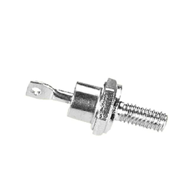

    DIODE ZENER 3.9V 50W DO5

S O L I D S TAT E Your TOTAL solutions source! INC. 1N3305 – 1N3350 1N4549 – 1N4556 50 WATTS ZENER DIODES DO5 ZENER DIODES Units are available with anodeto-case and cathode-to-case connections (standard and reverse polarity). For reverse polarity add suffix “R” to type number. MAXIMUM RATINGS: Junction and Storage Temperature: -65°C to +175°C DC Power Dissipation: 50 Watts (Derate 0.5W/°C above 75°C) • Standard polarity is anode-to-case TOLERANCE DESIGNATION: Standard voltage tolerances are +/-5% with B suffix, +/-10% with an A suffix and +/-20% with no suffix. S O LID • Reverse polarity with cathode-to-case by designation R suffix in part number, e.g. 1N3305RB, etc. S T A T E 46 Farrand Street, Bloomfield, NJ 07003 • 800.631.2075 Your TOTAL solutions source! INC. In NJ: 973.429.8700 • Fax: 973.429.8683 • www.solidstateinc.com S O L I D S TAT E 1N3305 – 1N3350 1N4549 – 1N4556 INC. Your TOTAL solutions source! 50 WATTS ZENER DIODES ELECTRICAL CHARACTERISTICS (TC = 30°C unless otherwise specified, VF = 1.5 V max @ 10 A on all types) Type Number *VR1 – Test Voltage for 5% Tolerance Device VR2 – Test Voltage for 10% Tolerance Device No Leakage Specified as 20% Tolerance Device • Standard voltage tolerance are +/-5% with B suffix, +/-10% with an A suffix, and +/-20% with no suffix • Standard polarity is anode-to-case • Reverse polarity with cathode-to-case by designating R suffix in part number, e.g. 1N3305RB, etc S O LID 1N4549 1N4550 1N4551 1N4552 1N4553 1N4554 1N3305 1N4555 1N3306 1N4556 1N3307 1N3308 1N3309 1N3310 1N3311 1N3312 1N3313 1N3314 1N3315 1N3316 1N3317 1N3318 1N3319 1N3320 1N3321 1N3322 1N3323 1N3324 1N3325 1N3326 1N3327 1N3328 1N3329 1N3330 1N3331 1N3332 1N3333 1N3334 1N3335 1N3336 1N3337 1N3338 1N3339 1N3340 1N3341 1N3342 1N3343 1N3344 1N3345 1N3346 1N3347 1N3348 1N3349 1N3350 Nominal Zener Voltage VZ @ IZT Volts Test Current (IZT) mA Max Zener Impedance ZZT @ IZT Ohms ZZK @ IZT = 5mA Ohms Max DC Zener 75°C Case Temp (IZM)mA 3.9 4.3 4.7 5.1 5.6 6.2 6.8 6.8 7.5 7.5 8.2 9.1 10 11 12 13 14 15 16 17 18 19 20 22 24 25 27 30 33 36 39 43 45 47 50 51 52 56 62 68 75 82 91 100 105 110 120 130 140 150 160 175 180 200 3200 2900 2650 2450 2250 2000 1850 1850 1700 1650 1500 1370 1200 1100 1000 960 890 830 780 740 700 660 630 570 520 500 460 420 380 350 320 290 280 270 250 245 240 220 200 180 170 150 140 120 120 110 100 95 90 85 80 70 68 65 0.16 0.16 0.12 0.12 0.12 0.14 0.2 0.16 0.3 0.24 0.4 0.5 0.6 0.8 1.0 1.1 1.2 1.4 1.6 1.8 2.0 2.2 2.4 2.5 2.6 2.7 2.8 3.0 3.2 3.5 4.0 4.5 4.5 5.0 5.0 5.2 5.5 6 7 8 9 11 15 20 25 30 40 50 60 75 80 85 90 100 400 500 600 650 900 1000 70 200 70 100 70 70 80 80 80 80 80 80 80 80 80 80 80 80 80 90 90 90 90 90 90 90 100 100 100 100 100 110 120 140 150 160 180 200 210 220 240 275 325 400 450 500 525 600 11900 10650 9700 8900 8100 7300 6600 6650 5900 6050 5200 4800 4300 3900 3600 3300 3000 2800 2650 2500 2300 2200 2100 1900 1750 1550 1500 1400 1300 1150 1050 975 930 880 830 810 790 740 660 600 540 490 420 400 380 365 335 310 290 270 250 230 220 200 Reverse Leakage Current IRMax VR1 VR2 150 150 100 20 20 20 150 10 75 10 50 25 10 5 5 5 5 5 5 5 5 5 5 5 5 5 5 5 5 5 5 5 5 5 5 5 5 5 5 5 5 5 5 5 5 5 5 5 5 5 5 5 5 5 0.5 0.5 1.0 1.0 1.0 2.0 4.5 2.0 5.0 3.0 5.4 6.1 6.7 8.4 9.1 9.9 10.6 11.4 12.2 13.0 13.7 14.4 15.2 16.7 18.2 19.0 20.6 22.8 25.1 27.4 29.7 32.7 34.2 35.8 38.0 38.8 39.5 42.6 47.1 51.7 56.0 62.2 69.2 76.0 79.8 83.6 91.2 98.8 106.4 114.0 121.6 133.0 136.8 152.0 0.5 0.5 1.0 1.0 1.0 2.0 4.3 2.0 4.7 3.0 5.2 5.7 6.3 8.0 8.6 9.4 10.1 10.8 11.5 12.2 13.0 13.7 14.4 15.8 17.3 18.0 19.4 21.6 23.8 25.9 28.1 31.0 32.4 33.8 36.0 36.7 37.4 40.3 44.6 49.0 54.0 59.0 65.5 72.0 75.6 79.2 86.4 93.6 100.8 108.0 115.2 126.0 129.6 144.0 Typical Zener Voltage Temperature Coeff. %/°C -.025 -.025 .010 .015 .030 .040 .040 .045 .045 .053 .048 .051 .055 .060 .065 .065 .070 .070 .070 .075 .075 .075 .075 .080 .080 .080 .085 .085 .085 .085 .090 .090 .090 .090 .090 .090 .090 .090 .090 .090 .090 .090 .090 .090 .095 .095 .095 .095 .095 .095 .095 .095 .095 .100 S T A T E 46 Farrand Street, Bloomfield, NJ 07003 • 800.631.2075 Your TOTAL solutions source! INC. In NJ: 973.429.8700 • Fax: 973.429.8683 • www.solidstateinc.com
