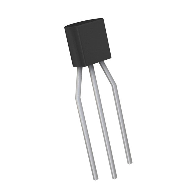

    TRANSISTOR, NPN, 50V, 0.15A, 300
KTC3198-Y A1G 数据手册
KTC3198-O/Y/GR/BL Taiwan Semiconductor Small Signal Product TO-92 NPN Bipolar Transistor FEATURES - The transistor is subdivided into four groups according to its DC current gain: O, Y, GR, BL - Pb free and RoHS compliant MECHANICAL DATA - Case: TO-92 small outline plastic package - High temperature soldering guaranteed: 260°C/10s 1. Emitter - Weight: 195mg (approximately) 2. Collector 3. Base APPLICATION TO-92 - General purpose switching and AF amplifier application MAXIMUM RATINGS AND ELECTRICAL CHARACTERISTICS (TA=25℃ unless otherwise noted) PARAMETER SYMBOL VALUE UNIT Collector Power Dissipation Collector-Base Voltage PC VCBO 0.5 60 W V Collector-Emitter Voltage VCEO 50 V Emitter-Base Voltage VEBO 5 V IC 0.15 A RθJA 250 ℃/W TJ , TSTG -55 to + 150 °C Collector Current Thermal Resistance From Junction to Ambient Junction and Storage Temperature Range SYMBOL MIN Collector Cut-off Current VCB= 60V, IE= 0 ICBO Emitter Cut-off Current VEB= 5V, IC= 0 IEBO VCE= 6V, IC= 2mA MAX UNIT - 0.1 μA - 0.1 μA hFE(1) 70 700 VCE= 6V, IC= 150mA hFE(2) 25 Collector-Emitter Saturation Voltage IC= 100mA, IB=10mA VCE(sat) 0.25 V Base-Emitter Saturation Voltage IC= 100mA, IB=10mA VBE(sat) 1 V Transition Frequency VCE= 10V, IC=1mA Collector Output Capacitance VCB= 10V, IE=0, f=1MHz PARAMETER DC Current Gain fT 80 MHz Cob 3.5 pF CLASSIFIACTION OF hFE RANK O Y GR BL RANGE 70-140 120-240 200-400 300-700 Document Number: DS_S1405004 Version: A14 KTC3198-O/Y/GR/BL Taiwan Semiconductor Small Signal Product RATINGS AND CHARACTERISTICS CURVES (TA=25℃ unless otherwise noted) FIG.1 Static Characteristic FIG.3 VCE(sat) vs. IC FIG.5 Cob / CIb vs. VCB / VEb Document Number: DS_S1405004 FIG.2 hFE vs. IC FIG.4 VBBE(sat) vs. IC FIG.6 fT vs. IC Version: A14 KTC3198-O/Y/GR/BL Taiwan Semiconductor Small Signal Product ORDERING INFORMATION MANUFACTURE GREEN COMPOUND PACKING CODE PART NO. CODE KTC3198-xx (Note2) PACKAGE PACKING MARKING 4K / Ammo KTC 3198 xx021 (Note3) CODE (Note1) A1 G B1 G A2 G B2 G TO-92 TO-92 TO-92 TO-92 5K / Bulk 2K / Ammo 10K / Bulk KTC3198-xx (Note2) B0 A1 G TO-92 4K / Ammo KTC3198-xx (Note2) B0 B1 G TO-92 5K / Bulk KTC3198-xx (Note2) M0 A2 G TO-92 2K / Ammo KTC3198-xx (Note2) M0 B2 G TO-92 10K / Bulk KTC 3198 xx021 (Note3) Note1: Indicator of manufacturing site for manufacture special control, if empty means no special control requirement Note2: "xx" means device code of "O", "Y", "GR", "BL" Note3: "MARKING" should follow the "PART NO.", for example, if "PART NO." is KTC3198-O, which "MARKING" is KTC 3198 O021 EXAMPLE MANUFACTURE PREFERRED P/N GREEN COMPOUND PACKING CODE PART NO. CODE KTC3198-O A1G KTC3198-O KTC3198-O-B0 A1G KTC3198-O KTC3198-O-B0 B1G DESCRIPTION CODE A1 G Green compound B0 A1 G Green compound KTC3198-O B0 B1 G Green compound KTC3198-O-M0 A2G KTC3198-O M0 A2 G Green compound KTC3198-O-M0 B2G KTC3198-O M0 B2 G Green compound Document Number: DS_S1405004 Version: A14 KTC3198-O/Y/GR/BL Taiwan Semiconductor Small Signal Product PACKAGE OUTLINE DIMENSIONS TO-92 Bulk DIM. Unit (mm) Unit (inch) Min Max Min Max A 4.30 4.70 0.169 0.185 B 4.30 4.70 0.169 0.185 C 12.50 14.50 0.492 0.571 D 1.17 1.37 0.046 0.054 E 0.35 0.55 0.014 0.022 F 1.17 1.37 0.046 0.054 G 0.59 1.20 0.023 0.047 H 0.29 0.51 0.011 0.020 I 3.30 3.70 0.130 0.146 TO-92 Ammo A G B C E H DIM. Unit (mm) Unit (inch) Min Max Min Max A 4.30 4.70 0.169 0.185 B 4.30 4.70 0.169 0.185 C 12.50 - 0.492 - D 2.20 2.80 0.087 0.110 E 0.35 0.55 0.014 0.022 G 0.59 1.20 0.023 0.047 H 0.29 0.51 0.011 0.020 I 3.30 3.70 0.130 0.146 D SUGGEST PAD LAYOUT I Document Number: DS_S1405004 Version: A14 KTC3198-O/Y/GR/BL Small Signal Product Notice Specifications of the products displayed herein are subject to change without notice. TSC or anyone on its behalf, assumes no responsibility or liability for any errors inaccuracies. Information contained herein is intended to provide a product description only. No license, express or implied, to any intellectual property rights is granted by this document. Except as provided in TSC's terms and conditions of sale for such products, TSC assumes no liability whatsoever, and disclaims any express or implied warranty, relating to sale and/or use of TSC products including liability or warranties relating to fitness for a particular purpose, merchantability, or infringement of any patent, copyright, or other intellectual property right. The products shown herein are not designed for use in medical, life-saving, or life-sustaining applications. Customers using or seling these products for use in such applications do so at their own risk and agree to fully indemnify TSC for any damages resulting from such improper use or sale. Document Number: DS_S1405004 Version: A14
