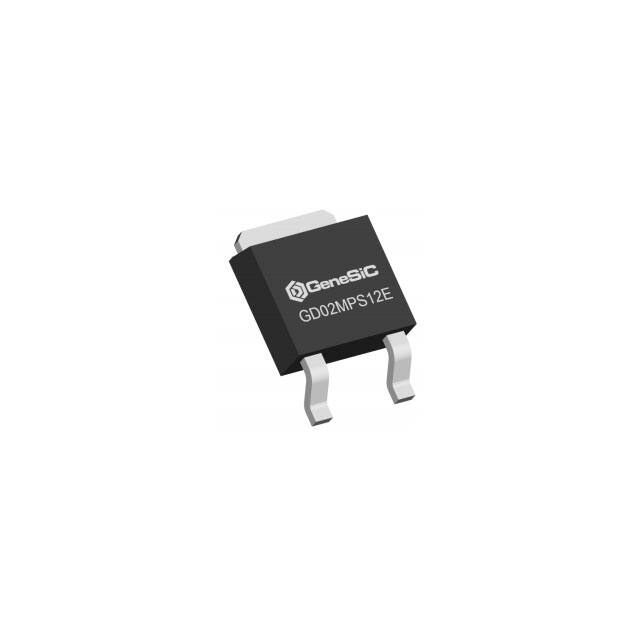

GD02MPS12E 1200V 2A SiC Schottky MPS™ Diode TM Silicon Carbide Schottky Diode VRRM = IF (TC = 166°C) = QC = Features • • • • • • • • Package Gen4 Thin Chip Technology for Low VF Superior Figure of Merit QC*VF 100% Avalanche (UIL) Tested Enhanced Surge Current Withstand Capability Temperature Independent Fast Switching Low Thermal Resistance Positive Temperature Coefficient of VF High dV/dt Ruggedness Case RoHS TO-252-2 Advantages • • • • • • • • 1200 V 2A 6 nC K REACH A Applications Improved System Efficiency High System Reliability Optimal Price Performance Reduced Cooling Requirements Increased System Power Density Zero Reverse Recovery Current Easy to Parallel without Thermal Runaway Enables Extremely Fast Switching • • • • • • • • High Voltage Sensing Solar Inverters Electric Vehicles High Frequency Converters Battery Chargers AC/DC Power Supplies Anti-Parallel / Free-Wheeling Diode LED and HID Lighting Absolute Maximum Ratings (At TC = 25°C Unless Otherwise Stated) Parameter Repetitive Peak Reverse Voltage Continuous Forward Current Symbol VRRM IF Non-Repetitive Peak Forward Surge Current, Half Sine Wave IF,SM Repetitive Peak Forward Surge Current, Half Sine Wave IF,RM Non-Repetitive Peak Forward Surge Current i2t Value Non-Repetitive Avalanche Energy Diode Ruggedness Power Dissipation Operating and Storage Temperature Rev 21/Jul IF,MAX ∫i2dt EAS dV/dt PTOT T j , T stg Conditions TC = 100°C, D = 1 TC = 135°C, D = 1 TC = 166°C, D = 1 TC = 25°C, tP = 10 ms TC = 150°C, tP = 10 ms TC = 25°C, tP = 10 ms TC = 150°C, tP = 10 ms TC = 25°C, tP = 10 µs TC = 25°C, tP = 10 ms L = 9.0 mH, IAS = 2 A VR = 0 ~ 960 V TC = 25°C Values 1200 7 5 2 16 12 9 6 80 1.28 19 200 65 -55 to 175 Latest Version at: www.genesicsemi.com/sic-schottky-mps/GD02MPS12E/GD02MPS12E.pdf Unit V Note A Fig. 4 A A A A2s mJ V/ns W °C Fig. 3 Page 1 of 7 GD02MPS12E 1200V 2A SiC Schottky MPS™ Diode TM Electrical Characteristics Parameter Symbol Diode Forward Voltage VF Reverse Current IR Total Capacitive Charge QC Switching Time tS Total Capacitance C Conditions Min. IF = 2 A, Tj = 25°C IF = 2 A, Tj = 175°C VR = 1200 V, Tj = 25°C VR = 1200 V, Tj = 175°C VR = 400 V VR = 800 V IF ≤ IF,MAX dIF/dt = 200 A/µs VR = 400 V VR = 800 V VR = 1 V, f = 1MHz VR = 800 V, f = 1MHz Values Typ. 1.5 1.9 1 2 4 6 Max. 1.8 10 Unit Note V Fig. 1 µA Fig. 2 nC Fig. 7 < 10 ns 73 4 pF Fig. 6 Unit Note °C/W g Fig. 9 Thermal/Package Characteristics Parameter Symbol Thermal Resistance, Junction - Case Weight Rev 21/Jul RthJC WT Conditions Min. Values Typ. 2.31 0.3 Max. Latest Version at: www.genesicsemi.com/sic-schottky-mps/GD02MPS12E/GD02MPS12E.pdf Page 2 of 7 GD02MPS12E 1200V 2A SiC Schottky MPS™ Diode Figure 1: Typical Forward Characteristics I F = f(VF,Tj); tP = 250 µs Figure 3: Power Derating Curves PTOT = f(TC ); Tj = 175°C Rev 21/Jul TM Figure 2: Typical Reverse Characteristics I R = f(VR,Tj) Figure 4: Current Derating Curves (Typical VF) I F = f(TC ); D = tP/T; Tj ≤ 175°C; fSW > 10kHz Latest Version at: www.genesicsemi.com/sic-schottky-mps/GD02MPS12E/GD02MPS12E.pdf Page 3 of 7 GD02MPS12E 1200V 2A SiC Schottky MPS™ Diode Figure 5: Current Derating Curves (Maximum VF) I F = f(TC ); D = tP/T; Tj ≤ 175°C; fSW > 10kHz Figure 7: Typical Capacitive Charge vs Reverse Voltage Characteristics QC = f(VR); f = 1MHz Rev 21/Jul TM Figure 6: Typical Junction Capacitance vs Reverse Voltage Characteristics C = f(VR); f = 1MHz Figure 8: Typical Capacitive Energy vs Reverse Voltage Characteristics EC = f(VR); f = 1MHz Latest Version at: www.genesicsemi.com/sic-schottky-mps/GD02MPS12E/GD02MPS12E.pdf Page 4 of 7 GD02MPS12E 1200V 2A SiC Schottky MPS™ Diode TM Figure 9: Transient Thermal Impedance Zth,jc = f(tP,D); D = tP/T Figure 10: Forward Curve Model Forward Curve Model Equation: I F = (VF - VBI)/RDIFF (A) Built-In Voltage (VBI): VBI(Tj) = m × Tj + n (V) m = -0.00119 (V/°C) n = 1.01 (V) Differential Resistance (RDIFF): 1/RDIFF RDIFF(Tj) = a × Tj2 + b × Tj + c (Ω) a = 5.95e-06 (Ω/°C2) b = 0.000824 (Ω/°C) c = 0.245 (Ω) VBI Forward Power Loss Equation: PLOSS = VBI(Tj) × I AVG + RDIFF(Tj) × I RMS2 I F = f(VF,Tj) Rev 21/Jul Latest Version at: www.genesicsemi.com/sic-schottky-mps/GD02MPS12E/GD02MPS12E.pdf Page 5 of 7 GD02MPS12E 1200V 2A SiC Schottky MPS™ Diode TM Package Dimensions TO-252-2 Package Outline 0.265 (6.73) 0.252 (6.40) 0.094 (2.38) 0.087 (2.20) 0.050 (1.27) 0.035 (0.89) 0.215 (5.46) 0.205 (5.21) 0.023 (0.58) 0.018 (0.46) SEATING PLANE 0.409 (10.40) 0.370 (9.40) 0.245 (6.22) 0.236 (6.00) 0.173 (4.40) min 0.205 (5.21) min 0.005 (0.127) max 0.045 (1.14) 0.030 (0.77) 0.090 BSC (2.286 BSC) 0.035 (0.88) 0.025 (0.64) 0.180 BSC (4.572 BSC) Recommended Solder Pad Layout 0.023 (0.58) 0.018 (0.46) 0.1080 REF (2.743 REF) 0.070 (1.77) 0.055 (1.40) 0.020 BSC (0.508 BSC) Package View 0.236 (6.00) Case (K) Case (K) 0.256 (6.50) 0.246 (6.25) 0.118 (3.00) 0.055 (1.40) 0.090 (2.29) 0.055 (1.40) K A 0.090 (2.29) NOTE 1. CONTROLLED DIMENSION IS INCH. DIMENSION IN BRACKET IS MILLIMETER. 2. DIMENSIONS DO NOT INCLUDE END FLASH, MOLD FLASH, MATERIAL PROTRUSIONS. Rev 21/Jul Latest Version at: www.genesicsemi.com/sic-schottky-mps/GD02MPS12E/GD02MPS12E.pdf Page 6 of 7 GD02MPS12E 1200V 2A SiC Schottky MPS™ Diode TM Compliance RoHS Compliance The levels of RoHS restricted materials in this product are below the maximum concentration values (also referred to as the threshold limits) permitted for such substances, or are used in an exempted application, in accordance with EU Directive 2011/65/EC (RoHS 2), as adopted by EU member states on January 2, 2013 and amended on March 31, 2015 by EU Directive 2015/863. RoHS Declarations for this product can be obtained from your GeneSiC representative. REACH Compliance REACH substances of high concern (SVHCs) information is available for this product. Since the European Chemical Agency (ECHA) has published notice of their intent to frequently revise the SVHC listing for the foreseeable future, please contact a GeneSiC representative to insure you get the most up-to-date REACH SVHC Declaration. REACH banned substance information (REACH Article 67) is also available upon request. Disclaimer GeneSiC Semiconductor, Inc. reserves right to make changes to the product specifications and data in this document without notice. GeneSiC disclaims all and any warranty and liability arising out of use or application of any product. No license, express or implied to any intellectual property rights is granted by this document. Unless otherwise expressly indicated, GeneSiC products are not designed, tested or authorized for use in life-saving, medical, aircraft navigation, communication, air traffic control and weapons systems, nor in applications where their failure may result in death, personal injury and/or property damage. Related Links • SPICE Models: https://www.genesicsemi.com/sic-schottky-mps/GD02MPS12E/GD02MPS12E_SPICE.zip • PLECS Models: https://www.genesicsemi.com/sic-schottky-mps/GD02MPS12E/GD02MPS12E_PLECS.zip • CAD Models: https://www.genesicsemi.com/sic-schottky-mps/GD02MPS12E/GD02MPS12E_3D.zip • Evaluation Boards: https://www.genesicsemi.com/technical-support • Reliability: https://www.genesicsemi.com/reliability • Compliance: https://www.genesicsemi.com/compliance • Quality Manual: https://www.genesicsemi.com/quality Revision History • Rev 21/Jul: Updated with most recent data • Supersedes: Rev 20/Jun www.genesicsemi.com/sic-schottky-mps/ Rev 21/Jul Copyright© 2021 GeneSiC Semiconductor Inc. All Rights Reserved. Published by GeneSiC Semiconductor, Inc. 43670 Trade Center Place Suite 155, Dulles, VA 20166; USA Page 7 of 7

物料型号: GD02MPS12E
器件简介: - 采用Gen4 Thin Chip Technology,具有低VF和优越的QVF特性。 - 100%雪崩测试,增强的浪涌电流承受能力。 - 符合RoHS标准,具有温度无关的快速开关特性和低热阻。 - 正温度系数的VF和高dV/dt的鲁棒性。
引脚分配: TO-252-2封装,引脚K为阳极,引脚A为阴极。
参数特性: - 重复峰值反向电压(VRRM): 1200V - 连续正向电流(IF): 根据结温(Tc)不同,分别为7A、5A和2A - 非重复峰值正向浪涌电流(IFSM): 16A (Tc=25°C, 10ms) 和 12A (Tc=150°C, 10ms) - 重复峰值正向浪涌电流(IFRM): 9A (Tc=25°C, 10ms) 和 6A (Tc=150°C, 10ms) - 非重复峰值正向浪涌电流(IFMAX): 80A (Tc=25°C, 10s) - 电容电荷(Qc): 6nC - 开关时间(ts): <10ns - 总电容(C): 73pF (VR=1V, f=1MHz)
功能详解: - 提高系统效率,高系统可靠性,最佳性价比,减少冷却需求。 - 增加系统功率密度,零反向恢复电流,易于并联且无热失控风险。 - 支持极快的开关速度。
应用信息: - 高压传感、太阳能逆变器、电动车、高频转换器、电池充电器、交流/直流电源、反并联/自由轮二极管、LED和HID照明。
封装信息: - TO-252-2封装,提供了详细的封装尺寸和推荐的焊盘布局。
