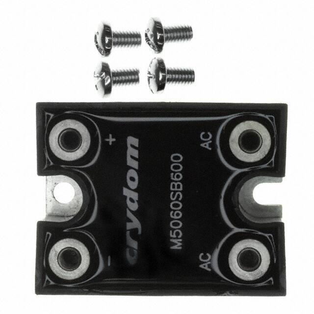

    BRIDGE RECT 1P 600V 60A MODULE
M5060SB600 数据手册
| M50 DIODE SERIES POWER MODULES Features • High Surge Current Rectifier Circuits • 5 Different Circuits to Choose from • Up to 1600 Volt Blocking Standard • UL Recognized E72445 SPECIFICATIONS Electrical Part Number Symbol M5060 M50100 Maximum DC Output Current (Tc= 85°C) ID 60 A 100 A Maximum Voltage Drop @ Amps Peak VF 1.35V @ 50A 1.2V @ 100 A Operating Junction Temperature Range TJ -40 - 125°C -40 - 125°C 400 (120 VAC) 600 (240 VAC) Repetitive Peak Reverse Voltage (AC Line Nominal) [Vpk] VRRMS 800 (280 VAC) VRRMS 1200 (480 VAC) 1400 (530 VAC) 1600 (600 VAC) Maximum Non-Repetitive Surge Current (1/2 Cycle, 60 Hz) [A] ITSM 800 1500 Maximum I² t for Fusing (t=8.3ms)[A² sec] l2t 2650 9350 Maximum Thermal Resistance, Junction to Ceramic Base per Chip [°C/W] RJC 0.45°C/W 0.3°C/W Insolation Voltage [Vrms] VISOL 2500 General Weight (typical) 4.5 oz (158g) Page 1 Copyright © 2020 Sensata Technologies, Inc. www.sensata.com EQUIVALENT CIRCUIT DIAGRAMS / MECHANICAL SPECIFICATIONS CIRCUIT DIAGRAMS Page 2 Copyright © 2020 Sensata Technologies, Inc. www.sensata.com Example : M5060TB1200 AVAILABLE OPTIONS 60 M50 Not all Combinations available TB 1200 Series M50 Load Current 60: 60 Amps 100: 100 Amps Circuit Type CC SB THA DD TB THC AC Line Voltage 400: 120 VAC 600: 240 VAC 1000: 380 VAC 1200: 480 VAC 1400: 530 VAC 1600: 600 VAC AGENCY APPROVALS & CERTIFICATIONS WARNINGS RISK OF MATERIAL DAMAGE AND HOT ENCLOSURE • The product’s side panels may be hot, allow the product to cool before touching • Follow proper mounting instructions including torque values • Do not allow liquids or foreign objects to enter this product Failure to follow these instructions can result in serious injury, or equipment damage. HAZARD OF ELECTRIC SHOCK, EXPLOSION OR ARC FLASH • Disconnect all power before installing or working with this equipment • Verify all connections and replace all covers before turning on power Failure to follow these instructions will result in death or serious injury. Page 3 Sensata Technologies, Inc. (“Sensata”) data sheets are solely intended to assist designers (“Buyers”) who are developing systems that incorporate Sensata products (also referred to herein as “components”). Buyer understands and agrees that Buyer remains responsible for using its independent analysis, evaluation and judgment in designing Buyer’s systems and products. Sensata data sheets have been created using standard laboratory conditions and engineering practices. Sensata has not conducted any testing other than that specifically described in the published documentation for a particular data sheet. Sensata may make corrections, enhancements, improvements and other changes to its data sheets or components without notice. Buyers are authorized to use Sensata data sheets with the Sensata component(s) identified in each particular data sheet. HOWEVER, NO OTHER LICENSE, EXPRESS OR IMPLIED, BY ESTOPPEL OR OTHERWISE TO ANY OTHER SENSATA INTELLECTUAL PROPERTY RIGHT, AND NO LICENSE TO ANY THIRD PARTY TECHNOLOGY OR INTELLECTUAL PROPERTY RIGHT, IS GRANTED HEREIN. SENSATA DATA SHEETS ARE PROVIDED “AS IS”. SENSATA MAKES NO WARRANTIES OR REPRESENTATIONS WITH REGARD TO THE DATA SHEETS OR USE OF THE DATA SHEETS, EXPRESS, IMPLIED OR STATUTORY, INCLUDING ACCURACY OR COMPLETENESS. SENSATA DISCLAIMS ANY WARRANTY OF TITLE AND ANY IMPLIED WARRANTIES OF MERCHANTABILITY, FITNESS FOR A PARTICULAR PURPOSE, QUIET ENJOYMENT, QUIET POSSESSION, AND NON-INFRINGEMENT OF ANY THIRD PARTY INTELLECTUAL PROPERTY RIGHTS WITH REGARD TO SENSATA DATA SHEETS OR USE THEREOF. All products are sold subject to Sensata’s terms and conditions of sale supplied at www.sensata.com SENSATA ASSUMES NO LIABILITY FOR APPLICATIONS ASSISTANCE OR THE DESIGN OF BUYERS’ PRODUCTS. BUYER ACKNOWLEDGES AND AGREES THAT IT IS SOLELY RESPONSIBLE FOR COMPLIANCE WITH ALL LEGAL, REGULATORY AND SAFETY-RELATED REQUIREMENTS CONCERNING ITS PRODUCTS, AND ANY USE OF SENSATA COMPONENTS IN ITS APPLICATIONS, NOTWITHSTANDING ANY APPLICATIONS-RELATED INFORMATION OR SUPPORT THAT MAY BE PROVIDED BY SENSATA. Mailing Address: Sensata Technologies, Inc., 529 Pleasant Street, Attleboro, MA 02703, USA. Copyright © 2020 Sensata Technologies, Inc. Rev:11/20/20_ ECN 21025 FDE-07-01 Rev. B CONTACT US Americas +1 (877) 502 5500 – Option 2 sales.crydom@sensata.com Europe, Middle East & Africa +44 (1202) 416170 ssr-info.eu@sensata.com Asia Pacific sales.isasia@list.sensata.com China +86 (21) 2306 1500 Japan +81 (45) 277 7117 Korea +82 (31) 601 2004 India +91 (80) 67920890 Rest of Asia +886 (2) 27602006 ext 2808 www.sensata.com
