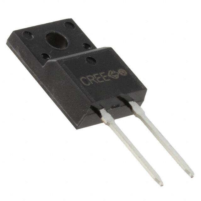

    TO-220-2
C3D06060F 数据手册
C3D06060F VRRM Silicon Carbide Schottky Diode Z-Rec Rectifier (Full-Pak) ® Features • • • • • • • • 600 V IF (TC=125˚C) = 6A Q c Package 600-Volt Schottky Rectifier Zero Reverse Recovery Current Zero Forward Recovery Voltage High-Frequency Operation Temperature-Independent Switching Behavior Extremely Fast Switching Positive Temperature Coefficient on VF Fully Isolated Case = = 15 nC TO-220-F2 Benefits • • • • • Replace Bipolar with Unipolar Rectifiers Essentially No Switching Losses Higher Efficiency Reduction of Heat Sink Requirements Parallel Devices Without Thermal Runaway PIN 1 PIN 2 Applications • • • • Maximum Symbol Package Marking C3D06060F TO-220-F2 C3D06060 Ratings (TC = 25 ˚C unless otherwise specified) Parameter Value Unit Test Conditions VRRM Repetitive Peak Reverse Voltage 600 V VDC DC Blocking Voltage 600 V Continuous Forward Current 11.5 6 4 A TC=25˚C TC=125˚C TC=150˚C IF Note Fig. 3 IFRM Repetitive Peak Forward Surge Current 22 15 A TC=25˚C, tP = 10 ms, Half Sine Wave TC=110˚C, tP=10 ms, Half Sine Wave IFSM Non-Repetitive Peak Forward Surge Current 44 41 A TC=25˚C, tp = 10 mS, Half Sine Wave TC=110˚C, tp = 10 mS, Half Sine Wave Fig. 8 IFSM(Max) Non-Repetitive Peak Forward Surge Current 540 460 A TC=25˚C, tP = 10 µs, Pulse TC=110˚C, tP = 10 µs, Pulse Fig. 8 37 16 W TC=25˚C TC=110˚C Fig. 4 Diode dV/dt ruggedness 200 V/ns i2t value (Per Leg) 9.6 8.4 A2s -55 to +175 ˚C 1 8.8 Nm lbf-in Ptot Power Dissipation dV/dt ∫i2dt TJ , Tstg Operating Junction and Storage Temperature TO-220 Mounting Torque 1 Part Number Switch Mode Power Supplies (SMPS) Boost diodes in PFC or DC/DC stages Free Wheeling Diodes in Inverter stages AC/DC converters C3D06060F Rev. F, 02-2019 VR=0-600V TC=25˚C, tP=10 ms TC=110˚C, tP=10 ms M3 Screw 6-32 Screw Electrical Characteristics Symbol Parameter Typ. Max. Unit VF Forward Voltage 1.5 2.0 1.7 2.4 V IR Reverse Current 6.5 13 33 132 QC Total Capacitive Charge C Total Capacitance EC Capacitance Stored Energy Test Conditions Note IF = 6 A TJ=25°C IF = 6 A TJ=175°C Fig. 1 μA VR = 600 V TJ=25°C VR = 600 V TJ=175°C Fig. 2 15 nC VR = 400 V, IF = 6 A di/dt = 500 A/μs TJ = 25°C Fig. 5 295 28.5 25.5 pF VR = 0 V, TJ = 25°C, f = 1 MHz VR = 200 V, TJ = 25˚C, f = 1 MHz VR = 400 V, TJ = 25˚C, f = 1 MHz Fig. 6 2.3 μJ VR = 400 V Fig. 7 Note: This is a majority carrier diode, so there is no reverse recovery charge. Thermal Characteristics Symbol RθJC Parameter Thermal Resistance from Junction to Case Typ. Unit Note 4.0 °C/W Fig. 9 Typical Performance 100 14 8 6 TJ = 25 °C TJ = 75 °C TJ = 125 °C IR (mA) 10 TJ = -55 °C Reverse LeakageICurrent, (mA) IRR (uA) F Foward I Current, (A) IF (A) 12 TJ = 175 °C 4 2 0 0 0.0 0.5400 1.0 200 1.5 600 2.0 800 2.5 3.012003.5 1000 FowardVVoltage, (V) VF (V) F Figure 1. Forward Characteristics 2 C3D06060F Rev. F, 02-2019 4.0 80 60 TJ = 175 °C TJ = 125 °C 40 TJ = 75 °C TJ = 25 °C 20 0 TJ = -55 °C 0 200 400 600 800 VVRVoltage, (V) (V) VR (V) Reverse R Figure 2. Reverse Characteristics 1000 1200 Typical Performance 4025 18 40 10% 10%Duty Duty 20%Duty Duty 20% 30%Duty Duty 30% 50%Duty Duty 50% 70%Duty Duty 70% DC DC 35 20 30 14 30 PP (W) (W) PTOT (W) Tot Tot IF(peak) (A) IF(peak) (A) IF (A) 2515 16 35 20 10 15 12 25 10 20 8 15 6 10 104 5 52 5 00 25 25 50 50 75 75 100 100 T ˚C ˚C TTCCC(°C) 125 150 150 0 175 175 25 Figure 3. Current Derating 25 75 100 100 T ˚C T ˚C TCCC (°C) 125 125 150 150 175 175 Figure 4. Power Derating 350 Conditions: TJ = 25 °C Conditions: TJ = 25 °C Ftest = 1 MHz Vtest = 25 mV 300 20 250 Capacitance C (pF) (pF) CapacitiveQCharge, (nC) QC (nC) C 50 15 10 200 150 100 5 50 0 0 100 200 300 400 500 600 700 ReverseVVoltage, (V) VR (V) R Figure 5. Total Capacitance Charge vs. Reverse Voltage 3 C3D06060F Rev. F, 02-2019 0 0 1 10 100 (V) VR (V) ReverseVVoltage, R Figure 6. Capacitance vs. Reverse Voltage 1000 Typical Performance 1,000 25 6 FSM Capacitive Charge, QC (nC) 20 IIFSM (A) (A) 4 3 C Capacitance Stored µJ) E (Energy, mJ) EC (µ 5 Conditions: TJ = 25 °C 2 1 0 0 100 200 300 400 500 600 ReverseVVoltage, V (V) (V) R 700 TJ_initial = 25 °C TJ_initial = 110 °C 15 100 10 5 10 0 10E-6 0 100 100E-6 300 200 400 1E-3500 Figure 7. Capacitance Stored Energy Figure 8. Non-repetitive peak forward surge current versus pulse duration (sinusoidal waveform) Junction To Case Impedance, ZthJC (oC/W) Thermal Resistance (˚C/W) Thermal Resistance (˚C/W) 10 10 0.5 0.5 0.3 0.3 0.1 0.1 0.05 0.05 100E-3 100E-3 0.02 0.02 0.01 SinglePulse 0.01 10E-3 10E-3 1E-3 1E-3 1E-6 1E-6 SinglePulse 100E-61E-3 1E-3 10E-6 100E-6 10E-6 10E-3 10E-3 100E-3 Time, tp (s) TT(Sec) (Sec) 100E-3 1 Figure 9. Transient Thermal Impedance 4 C3D06060F Rev. F, 02-2019 10E-3 700 tpVoltage, (s) Reverse Time, tp (s)VR (V) R 1 1 600 101 100 10 Package Dimensions Package TO-220-F2 SYMBOL A A1 A2 b b1 b2 b3 C D D1 D2 e E E1 G Ho L L1 M ØP Q Q1 Θ Θ1 Θ2 MIN (mm) 4.30 1.80 2.34 0.40 1.00 0.56 0.24 0.40 14.70 4.83 9.70 6.50 12.10 2.98 3.10 2.70 MAX (mm) 4.93 3.90 2.90 0.91 1.40 0.93 0.55 0.80 16.07 2.50 TYP 2.66 TYP 5.33 10.36 7.00 TYP 7.10 28 TYP 13.50 0.50 2.86 TYP 3.40 3.30 3.50 20° TYP 3° TYP 5° TYP PIN 1 PIN 2 Recommended Solder Pad Layout TO-220-2 Part Number Package Marking C3D06060F TO-220-F2 C3D06060 Note: Recommended soldering profiles can be found in the applications note here: http://www.cree.com/power_app_notes/soldering 5 C3D06060F Rev. F, 02-2019 Notes • RoHS Compliance The levels of RoHS restricted materials in this product are below the maximum concentration values (also referred to as the threshold limits) permitted for such substances, or are used in an exempted application, in accordance with EU Directive 2011/65/EC (RoHS2), as implemented January 2, 2013. RoHS Declarations for this product can be obtained from your Wolfpseed representative or from the Product Ecology section of our website at http:// www.wolfspeed.com/Power/Tools-and-Support/Product-Ecology. • REACh Compliance REACh substances of high concern (SVHCs) information is available for this product. Since the European Chemical Agency (ECHA) has published notice of their intent to frequently revise the SVHC listing for the foreseeable future,please contact a Cree representative to insure you get the most up-to-date REACh SVHC Declaration. REACh banned substance information (REACh Article 67) is also available upon request. • This product has not been designed or tested for use in, and is not intended for use in, applications implanted into the human body nor in applications in which failure of the product could lead to death, personal injury or property damage, including but not limited to equipment used in the operation of nuclear facilities, life-support machines, cardiac defibrillators or similar emergency medical equipment, aircraft navigation or communication or control systems, or air traffic control systems. Related Links • • • Cree SiC Schottky diode portfolio: http://www.wolfspeed.com/Power/Products#SiCSchottkyDiodes Schottky diode Spice models: http://www.wolfspeed.com/power/tools-and-support/DIODE-model-request2 SiC MOSFET and diode reference designs: http://go.pardot.com/l/101562/2015-07-31/349i Copyright © 2019 Cree, Inc. All rights reserved. The information in this document is subject to change without notice. Cree, the Cree logo, and Zero Recovery are registered trademarks of Cree, Inc. 6 C3D06060F Rev. F, 02-2019 Cree, Inc. 4600 Silicon Drive Durham, NC 27703 USA Tel: +1.919.313.5300 Fax: +1.919.313.5451 www.cree.com/power
