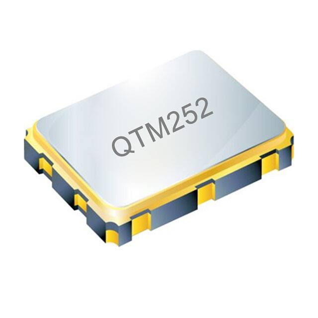

QTM252 MHz CMOS Oscillator Fuel The Digital World Features ● ● ● ● ● ● ● ● Applications Frequency range : 4MHz to 125MHz Compact and thin SMD seam sealing ceramic package Supply voltage : 1.8V ~ 3.3V CMOS output Tri-state function available External dimensions (mm) L : 2.5 x W : 2.0 x H : 0.8 RoHS compliant & Pb free ● ● ● ● ● ● Mobile phone, Wearables Networking, Server, Storage Wireless communications Fibre channel, Ethernet, SATA, SAS, PCI-E, USB, WLAN, BT Notebook, HDD, SSD, Graphics card, Computer peripherals Audio, Video, Gaming, DSC, IP CAM, Portable consumer products Electrical Characteristics Item QTM252 Frequency Range (F0) 4MHz ~ 125MHz Frequency Stability (Fstab) ±50ppm, ±25ppm Operating Temperature Range (TOTR) Supply Voltage (VDD) Current Consumption (IDD) 1.8V, 2.5V, 3.3V Output Load (CL) 15 pF Output Voltage High (VOH) 90% VDD Min. Output Voltage Low (VOL) 10% VDD Max. Rise & Fall Time (Tr / Tf) 5 ns Max. Duty Cycle 45% ~ 55% Start-up Time 5 ms Max. Enable Voltage High, Logic "1" 70% VDD Min. Enable Voltage Low, Logic "0" 30% VDD Max. Storage Temperature Range (TSTR) VDD ± 10% 10 mA Max. CMOS Aging (Faging) Note [1] -40°C ~ +85°C Output Type Phase Jitter, RMS Conditions 1 ps Max. ±3 ppm Max. 10% ~ 90% of VDD Input to Pin1 Note [2] Note [3] at 25°C±3°C,first year -55°C ~ +125°C Notes: [1] Inclusive of frequency tolerance at 25°C, 1st year aging at 25°C, and variations over operating temperature, supply voltage, and load. [2] Output will be enable if Pin1 is Logic "1" or Open; Output will be disable if Pin1 is Logic "0". [3] Freq. 10MHz~40MHz, integrated 12kHz~5MHz; Freq. >40MHz, integrated 12kHz~20MHz. Rev. 1.02 Page 1 www.qstproducts.com QTM252 MHz CMOS Oscillator Fuel The Digital World Dimensions (Unit: mm) Ordering Information QTM252 - 30.000M - B E - T Frequency in Hz Packaging Method T Please contact us for available frequencies Supply Voltage B C D Rev. 1.02 Tape & Reel Frequency Stability 3.3 V 2.5 V 1.8 V E D Page 2 ± 50 ppm ( -40°C ~ +85°C ) ± 25 ppm ( -40°C ~ +85°C ) www.qstproducts.com QTM252 MHz CMOS Oscillator Fuel The Digital World Packing (Unit: mm) (Unit: mm) Reflow Profile Solder melting point : 220°C ± 10°C, 60 sec. Min. Peak temperature : 260°C ± 10°C, 10 sec. Min. (°C) 10 sec 260 220 180 150 120 sec Rev. 1.02 60 sec Page 3 Time (sec) www.qstproducts.com

物料型号:QTM252 MHz CMOS Oscillator
器件简介: - 频率范围:4MHz至125MHz - 紧凑且薄型设计 - 表面贴装密封陶瓷封装 - 外部尺寸:长2.5mm x 宽2.0mm x 高0.8mm - 支持三态功能 - 供电电压:1.8V至3.3V - CMOS输出 - 符合RoHS标准,无铅
引脚分配: - 1: ENABLE CONTROL - 2: GND - 3: OUT - 4: VDD
参数特性: - 频率稳定性:±50ppm(标准)或±25ppm(特定条件下) - 工作温度范围:-40°C至+85°C - 供电电压:1.8V、2.5V、3.3V - 最大电流消耗:10mA - 输出类型:CMOS - 输出负载:15pF - 高电平输出电压:至少90% VDD - 低电平输出电压:最多10% VDD - 上升和下降时间:最多5ns - 占空比:45%至55% - 启动时间:最多5ms - 使能电压高/低:至少70% VDD / 最多30% VDD - 相位抖动(RMS):最多1ps - 老化:第一年最多±3ppm
功能详解: - 振荡器提供CMOS输出,具有三态功能,可通过引脚1控制使能。 - 频率稳定性包括25°C时的频率容差、第一年老化、工作温度、供电电压和负载变化的影响。
应用信息: - 移动电话、可穿戴设备 - 网络、服务器、存储设备 - 无线通信 - 光纤通道、以太网、SATA、SAS、PCI-E、USB、WLAN、蓝牙等计算机外围设备 - 便携式消费产品,如音频、视频、游戏、数码相机、IP摄像头等
封装信息: - 提供胶带和卷轴包装方式 - 订购信息示例:QTM252 - 30.000M T,表示30MHz频率,T表示胶带和卷轴包装。
