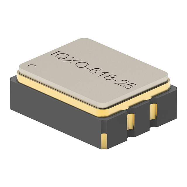

Crystal Clock Oscillator Specification Part No. + Packaging: LFSPXO075115RL3K Customer Part: Description LVDS output crystal oscillator in a hermetically sealed ceramic package with a seam sealed metal lid. Model IQXO-618-25 Model Issue number 2 Frequency Parameters Frequency 125.0MHz Frequency Stability ±50.00ppm Operating Temperature Range Ageing -40.00 to 105.00°C ±3ppm max per year at 25°C Electrical Parameters Supply Voltage Current Draw 2.5V ±5% 50.000mA Output Details LVDS Output Compatibility Drive Capability 100Ω Rise & Fall Time (20 - 80%) 0.5ns max 45/55% Duty Cycle Differential Output Voltage (VOD): 0.247V min, 0.33V typ, 0.454V max Offset Voltage (VOS): 1.125V min, 1.250V typ, 1.375V max. Output Voltage Levels: Output Low (VOL): 0.9V min Output High (VOH): 1.6V max Outline (mm) Output Control Standby Operation: Logic ‘1’ (≥70% Vs) to pad 1 enables oscillator output. Logic ‘0’ (≤30% Vs) to pad 1 disables oscillator output; when disabled the oscillator output goes to the high impedance state. No connection to pad 1 enables oscillator output. Start-Up Time: 10ms max Standby Current: 10μA max Noise Parameters Phase Jitter (12kHz to 20MHz): 1ps rms max Sales Office Contact Details: UK: +44 (0)1460 270200 France: 0800 901 383 Germany: 0800 1808 443 USA: +1.760.318.2824 Printed on 6 Sep 21 12:16 using Part Data Sheet V1.0018 Email: info@iqdfrequencyproducts.com Web: www.iqdfrequencyproducts.com Page 1 of 2 Crystal Clock Oscillator Specification Part No. + Packaging: LFSPXO075115RL3K Customer Part: Environmental Parameters Storage Temperature Range: -55 to 125°C Drop Test (JIS-C0044): the specimen is measured for frequency before the test. It is then dropped from a height of 100cm min as a free fall object onto a hard wooden plate of thickness 30mm min. Vibration (MIL-STD-883F : 2007.3): the specimen is measured for frequency before the test. Test in X,Y and Z axes for the vibration test. Frequency range: 20~2000Hz, peak to peak amplitude: 1.52mm, peak acceleration: 20G, sweep time: 20 minute/axis, pendicular total test time: 4 hours. Low Temp Exposure (JIS-C0020): the specimen is measured for frequency before the test. Expose device to -40°C±3°C for 168±6 hours. Measure electrical performance after leaving 1~2 hours at room temperature. Ageing Test (JIS-C0021): the specimen is measured for frequency before the test. Expose device to +125°C±3°C for 720±48 hours. Measure electrical performance after leaving 1~2 hours at room temperature. High Temperature and Humidity (MIL-STD-883F : 1004.7): the specimen is measured for frequency before the test. Expose device to +85°C±5°C and 85±5% humidity for 168±6 hours. Measure electrical performance after leaving 1~2 hours at room temperature. Temperature Cycle Test (MIL-STD-883F : 1010.8): the specimen is measured for frequency before the test. Expose device to 100 cycles of: Low temp: -55°C±3°C for15±3 min Ramp up to high temp: 2-3 mins High temp:+125°C±3°C for15±3 min Ramp down to low temp: 2-3 mins Measure electrical performance after leaving 1~2 hours at room temperature. RoHS Terminations RoHS Reflow Temp 260°C max for 10s max Compliance RoHS Status (2015/863/EU) REACh Status MSL Rating (JDEC-STD-033): Compliant Compliant Not Applicable Packaging Details Pack Style: RL3K Pack Size: 3,000 Tape & reel in accordance with EIA-481-D Alternative packing option available Sales Office Contact Details: UK: +44 (0)1460 270200 France: 0800 901 383 Germany: 0800 1808 443 USA: +1.760.318.2824 Printed on 6 Sep 21 12:16 using Part Data Sheet V1.0018 Email: info@iqdfrequencyproducts.com Web: www.iqdfrequencyproducts.com Page 2 of 2
