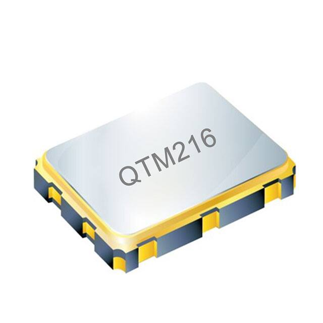

QTM216 MHz CMOS Oscillator Fuel The Digital World Features ● ● ● ● ● ● ● ● Applications Frequency range : 4MHz to 54MHz Ultra compact and thin SMD seam sealing ceramic package Supply voltage : 1.8V ~ 3.3V CMOS output Tri-state function available External dimensions (mm) L : 2.0 x W : 1.6 x H : 0.75 RoHS compliant & Pb free ● ● ● ● ● ● ● Mobile phone, Wearables SiP modules Networking, Server, Storage Wireless communications BT, BLE, WLAN, NFC, USB Notebook, HDD, SSD, Graphics card, Computer peripherals Audio, Video, Gaming, DSC, IP CAM, Portable consumer products Electrical Characteristics Item Frequency Range (F0) Frequency Stability (Fstab) Operating Temperature Range (TOTR) Supply Voltage (VDD) Current Consumption (IDD) QTM216 4MHz ~ 54MHz ±50ppm, ±25ppm 1.8V, 2.5V, 3.3V Output Load (CL) 15 pF Output Voltage High (VOH) 90% VDD Min. Output Voltage Low (VOL) 10% VDD Max. Rise & Fall Time (Tr / Tf) 6 ns Max. Duty Cycle 45% ~ 55% Start-up Time 5 ms Max. Enable Voltage High, Logic "1" 70% VDD Min. Enable Voltage Low, Logic "0" 30% VDD Max. Storage Temperature Range (TSTR) VDD ± 10% 5 mA Max. CMOS Aging (Faging) Note [1] -40°C ~ +85°C Output Type Phase Jitter, RMS Conditions 1 ps Max. ±3 ppm Max. 10% ~ 90% of VDD Input to Pin1 Note [2] Note [3] at 25°C±3°C,first year -55°C ~ +125°C Notes: [1] Inclusive of frequency tolerance at 25°C, 1st year aging at 25°C, and variations over operating temperature, supply voltage, and load. [2] Output will be enable if Pin1 is Logic "1" or Open; Output will be disable if Pin1 is Logic "0". [3] Freq. 10MHz~40MHz, integrated 12kHz~5MHz; Freq. >40MHz, integrated 12kHz~20MHz. Rev. 1.02 Page 1 www.qstproducts.com QTM216 MHz CMOS Oscillator Fuel The Digital World Dimensions (Unit: mm) Ordering Information QTM216 - 30.000M - B E - T Frequency in Hz Packaging Method T Please contact us for available frequencies Supply Voltage B C D Rev. 1.02 Tape & Reel Frequency Stability 3.3 V 2.5 V 1.8 V E D Page 2 ± 50 ppm ( -40°C ~ +85°C ) ± 25 ppm ( -40°C ~ +85°C ) www.qstproducts.com QTM216 MHz CMOS Oscillator Fuel The Digital World Packing (Unit: mm) (Unit: mm) Reflow Profile Solder melting point : 220°C ± 10°C, 60 sec. Min. Peak temperature : 260°C ± 10°C, 10 sec. Min. (°C) 10 sec 260 220 180 150 120 sec Rev. 1.02 60 sec Page 3 Time (sec) www.qstproducts.com

物料型号:QTM216 MHz CMOS Oscillator
器件简介:QTM216是一款CMOS振荡器,频率范围为4MHz至54MHz,适用于移动电话、可穿戴设备、SiP模块、网络、服务器、存储、无线通信、计算机外设和便携式消费产品。
引脚分配:文档中提到了引脚1(用于使能/禁用输出)和引脚4(VDD,电源电压)。
参数特性: - 频率范围:4MHz~54MHz - 频率稳定性:±50ppm(-40°C~+85°C)或±25ppm(特定条件下) - 工作温度范围:-40°C~+85°C - 供电电压:1.8V、2.5V、3.3V - 最大电流消耗:5mA - 输出类型:CMOS - 输出负载:15pF - 高电平输出电压:至少90% VDD - 低电平输出电压:最多10% VDD - 上升/下降时间:最多6ns - 占空比:45%~55% - 最大启动时间:5ms - 使能电压高/低:至少70% VDD / 最多30% VDD - 相位抖动(RMS):最多1ps - 老化(第一年):±3ppm
功能详解:QTM216具有CMOS输出,可提供稳定的频率输出,并具有使能/禁用功能,可通过引脚1控制。
应用信息:适用于多种应用,包括移动电话、可穿戴设备、SiP模块、网络设备、服务器、存储设备、无线通信设备、计算机外设和便携式消费电子产品。
封装信息:超紧凑和薄的SMD密封陶瓷封装,外部尺寸为长2.0mm x 宽1.6mm x 高0.75mm,符合RoHS标准,无铅。
