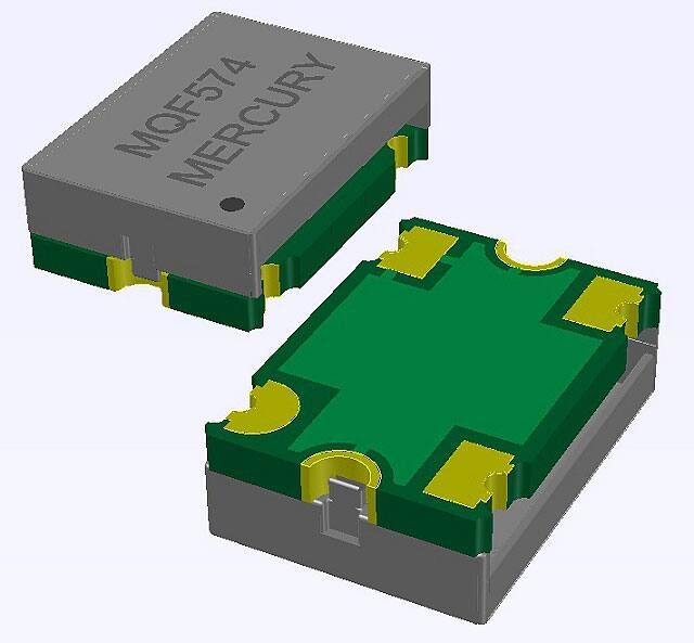

Temperature Compensated Crystal Oscillators [ TCXO " M " and VCTCXO " VM " ] TCXO VCTCXO Min. Max. MQF _ T MQF _ P MQF _ D VMQF _ T VMQF _ P VMQF _ D 10 1,500 CMOS PECL LVDS CMOS PECL LVDS MHz MHz 1.0 pS Phase Jitter ( typical ) Features The (V)MQF___T , (V)MQF___P and (V)MQF___D Series are members of Mercury’s Q-Family Quick-Turn Temperature Compensated oscillators that can be delivered within days. With low current consumption (44 mA for PECL 212.500 MHz at 3.3V) and an integrated phase jitter performance of 1.0 pS RMS, they have gained its precision frequency control market position by providing engineers with next-day samples for prototypes and low cost, fast delivery for volume production ( ± 2.5 ppm over -30°C to +85°C ) . General specifications , at Ta=+25°C (V)MQF574T , (V)MQF576T Model Output Logic Supply Voltage VDD ( code ) (V)MQF576P CMOS PECL LVDS + 2.5 VDD ± 5% ( voltage code " 25 " ) + 2.5 VDD ± 5% ( voltage code " 25 " ) + 2.5 VDD ± 5% ( voltage code " 25 " ) + 3.3 VDD ± 5% ( voltage code " 33 " ) + 3.3 VDD ± 5% ( voltage code " 33 " ) + 3.3 VDD ± 5% ( voltage code " 33 " ) 10 ~ 250 MHz 10 ~ 1,500 MHz 10 ~ 1,500 MHz Available Frequency Range 15 pF 50 Ω into Vcc - 2V or Thevenin equiralent 100 Ω 90 % VDD VDD - 1.03 ( min.) , VDD - 0.6 ( max.) 1.4 V Typical , 1.6 V max. 10 % VDD VDD - 1.85 ( min.) , VDD - 1.6 ( max.) 1.1 V Typical , 0.9 V min. Load Output Logic " High " , " 1 " Output Logic " Low " , " 0 " ( VDD = + 2.5V ) 50 MHz : 24 mA Current Consumption All values are typical and over the 156 MHz : 36 mA 125 MHz : 28 mA 600 MHz : 40 mA 600 MHz : 28 mA 800 MHz : 46 mA 800 MHz : 30 mA 1,000 MHz : 50 mA 1,000 MHz : 34 mA 50 MHz : 26 mA 156 MHz : 40 mA 156 MHz : 25 mA 125 MHz : 30mA 600 MHz : 45 mA 600 MHz : 30 mA operating temperatures. Current Consumption 200 MHz : 34 mA All values are typical and over the 156 MHz : 22 mA 200 MHz : 30 mA ( VDD = + 3.3V ) operating temperatures. Current with Output Disabled Rise Time / Fall Time (V)MQF576D 800 MHz : 48 mA 800 MHz : 32 mA 1,000 MHz : 52 mA 1,000 MHz : 36 mA 18 mA ( typical ) 18 mA ( typical ) 18 mA ( typical ) 1.5 nS. ( Typical ) , 3.0 nS. ( max. ) 0.2 nS. ( Typical ) , 0.5 nS. ( max. ) 0.2 nS. ( Typical ) , 0.4 nS. ( max. ) Tr / Tf : 10% ↔ 90% waveform Tr / Tf : 20% ↔ 80% waveform Tr / Tf : 20% ↔ 80% waveform ±2.0 ppm. max. at +25°C±2°C. ( at the shipment ) Initial Calibration Tolerance ± 2.5 ppm over -30°C to +85°C ( default for Quick - Turn ) Temperature ( refer to +25°C) ± 1.0 ppm over -40°C to +85°C ( available ) Aging ± 1.0 ppm max . , per year at 25°C Frequency Stability Codes Voltage Change ± 0.2 ppm max . , for a ±5% input voltage change. Load Change ± 0.2 ppm max . , for a ±10% load condition change. Reflow ± 1.0 ppm max . , 1 reflow and measured 24 hours afterwards. Duty Cycle 50 % ± 5% Start-up Time 5 m sec. ( max.) Aging at Ta = +25°C ± 2 ppm max. first year at 25°C ; ± 10 ppm max. over 10 years Storage Temperature -55°C to + 150°C SSB Phase Noise [ dBc / Hz ( typical ) ] Offset 10 Hz 100 Hz 1K Hz 10K Hz 100K Hz 1M Hz 10M Hz Phase Jitter ( 12KHz ~ 20 MHz ) 156.25 MHz -65 -92 -108 -114 -117 -139 -147 0.9 pS 212.5 MHz -61 -90 -106 -110 -112 -133 -142 1.2 pS 622.08 MHz -51 -79 -97 -102 -103 -125 -134 1.1 pS Control Voltage Function on Pad 1 Output Enable Function on pad 2 Control Voltage Center and Range +1.5V ± 1.0V for both VDD = 2.5V and 3.3V Frequency Pulling Range ± 8 ppm min. Linearity ± 1 % typical. ± 10% max. Transfer Function Positive Transfer Input Impedance 770 KΩ typical. Harmonics -5.0 dBc max. 70% of VDD (min.) to enable output. (Open connection prohibit.) OE Control 30% of VDD (max.) to disable output Mercury www.mercury-crystal.com Output Enable / Disable Time 200 nS. Max. / 50 nS. Max. ■Taiwan : Tel: (886)-2-2406-2779 / sales-tw@mercury-crystal.com ■USA : Tel: (1)-909-466-0427 / sales-us@mercury-crystal.com ■China : Tel: (86)-512-5763-8100 / sales-cn@mercury-crystal.com 89 A2 Temperature Compensated Crystal Oscillators [ TCXO " M " and VCTCXO " VM " ] TCXO VCTCXO Min. Max. MQF _ T MQF _ P MQF _ D VMQF _ T VMQF _ P VMQF _ D 10 1,500 CMOS PECL LVDS CMOS PECL LVDS MHz MHz Part Number Format and Example Example : 1.VMQF574T33 - 120.000 - 2.5 / -40+85 2.VMQF576P33 - 120.000 - 2.5 / -40+85 VMQF 574 Hold Type Package " MQF " : TCXO T 33 - " 574 " 4pad T : CMOS ( 5.0 * 7.0 mm ) VMQF 576 P 33 Hold Type Package T : CMOS Supply Voltage " 576 " 6pad P : PECL " 33 " for 3.3V ( 5.0 * 7.0 mm ) D : LVDS " 25 " for 2.5V : TCXO " VMQF " : VCTCXO - 2.5 / -40+85 Operating " 33 " for 3.3V " VMQF " : VCTCXO " MQF " 120.000 Supply Voltage Center Freq. ( MHz ) Freq. Stability Temperature " 25 " for 2.5V Range - 120.000 - 2.5 / -40+85 Operating Center Freq. ( MHz ) Freq. Stability Temperature Range Outline Dimensions ( Unit : mm ) , Suggested pad Layout for SMDs [ MQF574T ] [ MQF576T ] , [ MQF576P ] , [ MQF576D ] Test Circuits and Output Waveforms CMOS Mercury PECL www.mercury-crystal.com LVDS ■Taiwan : Tel: (886)-2-2406-2779 / sales-tw@mercury-crystal.com ■USA : Tel: (1)-909-466-0427 / sales-us@mercury-crystal.com 90 ■China : Tel: (86)-512-5763-8100 / sales-cn@mercury-crystal.com A2 Emboss Taping and Reel Specifications [ VCXO ] [ ( VC )TCXO ] Carrier Type Dimensions ( unit : mm ) A B C D E F G H I pcs / reel G_324 ( 6 ) 8.0 3.4 2.7 4.0 1.4 0.3 4.0 Ø 1.50 1.75 3000 G_534 12.0 5.3 3.6 8.0 1.4 0.3 4.0 Ø 1.55 1.75 1000 G_576 16.0 7.3 5.3 8.0 1.9 0.3 4.0 Ø 1.55 1.75 1000 G_42 24.0 12.4 10.3 16.0 5.0 0.3 4.0 Ø 1.55 1.75 500 G_43 24.0 12.4 10.3 16.0 5.0 0.3 4.0 Ø 1.55 1.75 500 G_62 24.0 12.4 10.3 16.0 5.0 0.3 4.0 Ø 1.55 1.75 500 G_63 24.0 12.4 10.3 16.0 5.0 0.3 4.0 Ø 1.55 1.75 500 (V)M_22 8.0 2.8 2.3 4.0 1.1 0.3 4.0 Ø 1.50 1.75 3000 (V)M_32 8.0 3.4 2.7 4.0 1.4 0.3 4.0 Ø 1.50 1.75 3000 (V)MQ_326 12.0 3.6 2.9 4.0 1.7 0.3 4.0 Ø 1.55 1.75 3000 (V)M_53 12.0 5.3 3.6 8.0 1.4 0.3 4.0 Ø 1.55 1.75 1000 (V)M_57 16.0 7.4 5.5 8.0 2.8 0.4 4.0 Ø 1.50 1.75 500 (V)M_42 24.0 12.4 10.3 16.0 5.0 0.3 4.0 Ø 1.55 1.75 500 (V)M_43 24.0 12.4 10.3 16.0 5.0 0.3 4.0 Ø 1.55 1.75 500 (V)M_62 24.0 12.4 10.3 16.0 5.0 0.3 4.0 Ø 1.55 1.75 500 (V)M_63 24.0 12.4 10.3 16.0 5.0 0.3 4.0 Ø 1.55 1.75 500 K L P Q R pcs / reel Reel Dimensions ( unit : mm ) J G_324 ( 6 ) 180.0 9.0 12.0 13.2 2.1 - 3000 G_534 180.0 13.0 16.0 13.2 2.5 - 1000 G_576 180.0 17.2 19.3 13.3 2.2 22.0 1000 G_42 330.0 30.0 25.0 13.4 2.5 19.5 500 G_43 330.0 30.0 25.0 13.4 2.5 19.5 500 G_62 330.0 30.0 25.0 13.4 2.5 19.5 500 G_63 330.0 30.0 25.0 13.4 2.5 19.5 500 (V)M_22 180.0 9.0 12.0 13.2 2.1 - 3000 (V)M_32 180.0 9.0 12.0 13.2 2.1 - 3000 (V)MQ_326 180.0 9.0 12.0 13.2 2.1 - 3000 (V)M_53 180.0 13.0 16.0 13.2 2.5 19.5 1000 (V)M_57 180.0 17.2 19.3 13.3 2.2 22.0 500 (V)M_42 330.0 30.0 25.0 13.4 2.5 19.5 500 (V)M_43 330.0 30.0 25.0 13.4 2.5 19.5 500 (V)M_62 330.0 30.0 25.0 13.4 2.5 19.5 500 (V)M_63 330.0 30.0 25.0 13.4 2.5 19.5 500 Mercury www.mercury-crystal.com ■Taiwan : Tel: (+886)-2-2406-2779 / sales-tw@mercury-crystal.com ■USA : Tel: (+1)-909-466-0427 / sales-us@mercury-crystal.com ■China : Tel: (+86)-512-5763-8100 / sales-cn@mercury-crystal.com 114 A2

物料型号: - TCXO系列:MQF_T, MQF, MQF - VCTCXO系列:VMQF_T, VMQF, VMQF
器件简介: - 这些振荡器属于Mercury的Q-Family快速交付温度补偿振荡器,可在几天内交付。它们具有低电流消耗和集成的相位抖动性能,为原型设计和批量生产提供了快速的样品和低成本、快速交付。
引脚分配: - TCXO和VCTCXO有不同的引脚分配,例如: - Pad 1: VCTCXO的控制电压,TCXO无连接 - Pad 2: 输出使能 - Pad 3: 地 - Pad 4: CMOS输出或PECL/LVDS的差分输出 - Pad 5: CMOS无连接或PECL/LVDS的互补输出 - Pad 6: 供电电压
参数特性: - 工作温度范围:-30°C至+85°C - 频率稳定性:±2.5ppm(快速交付默认值),可选±1.0ppm - 老化:第一年最大2ppm,10年内最大10ppm - 电压变化:最大0.2ppm,对于5%的输入电压变化 - 负载变化:最大0.2ppm,对于10%的负载条件变化
功能详解: - 提供了详细的功能描述,包括初始校准容差、频率稳定性代码、老化、电压变化、负载变化和再流影响。
应用信息: - 适用于需要精密频率控制的应用。
封装信息: - 提供了不同封装的尺寸和建议的SMD焊盘布局。
