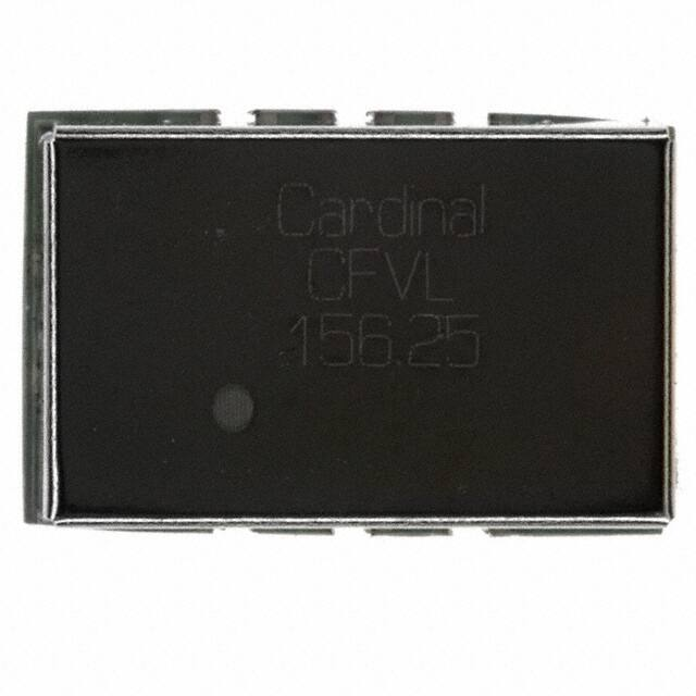

CARDINAL CARDINAL COMPONENTS COMPONENTS LVDS Surface Mount VCXO * Serial Communications * Routers * Switches * WAN Interfaces * Test Equipment * LVDS Output * Industry Standard Outline Part Numbering Example: CFVL Z - A5 BP - 222.5792 TS A5 Z CFVL SERIES CFVL BP OPERATING TEMP. PACKAGING OPTIONS Blank = 0°C ~ +70°C Blank = Bulk A5 = -20°C ~ +70°C Z = Tape and Reel A7 = -40°C ~ +85°C 38 640 MHz -50 + 50 ppm 3.465 V Frequency Range: Stability: Supply Voltage: 3.135 Frequency Tuning Range: Typ 3.3 External Control Voltage: 0.35 3.0 V Operating Temperature: -40 + 85 °C Storage Temperature: -55 + 125 °C Duty Cycle: 45 55 % 10 mS 5 ppm 100 mA 3 Aging: (ppm/1st Year) Ta=25C, Vdd=3.3V Supply Current: Short Circuit Current: ± 50 mA RMS Period Jitter: 5 pS RMS Integrated Jitter: 12kHz to 20MHz 0.7 pS Phase Noise @ 10kHz: Output Voltage: Voh Vol Output Differential Voltage: Rise/Fall Time: -120 dBc/Hz Vdd - 1.6 V V 454 mV 0.8 nS Vdd - 0.9 247 355 0.4 Dimensions are in mm ppm ± 100 Start-Up Time: TS CFVL Unit Min 222.5792 STABILITY FREQUENCY TRI-STATE Blank = ±100 ppm TS = Tri-State BP = ±50 ppm Max Specifications: CFVL Applications PIN Function 1 VCONTROL 2 ENABLE 3 Ground 4 LVDS + 5 LVDS 6 Vdd LVDS Levels Test Circuit OUT Output Level: Packaging: LVDS 50 Ω Tape and Reel 1000 pcs per Reel Vo 50 Ω ___ OUT Cardinal Components, Inc., 155 Rt. 46 W, Wayne, NJ. 07470 TEL: (973)785-1333 FAX: (973)785-0053 E-Mail: sales@cardinalxtal.com http://www.cardinalxtal.com  Rev.3-6/11/07
CFVL-A7BP-156.25TS
1. 物料型号:CFVL系列,具体型号示例为CFVL Z - A5 BP - 222.5792 TS。 2. 器件简介:该VCXO适用于串行通信、LVDS输出、路由器、交换机、广域网接口和测试设备。 3. 引脚分配: - 1号引脚:VCONTROL(控制电压输入) - 2号引脚:ENABLE(使能信号) - 3号引脚:GND(地) - 4号引脚:LVDS+(正差分信号) - 5号引脚:LVDS-(负差分信号) - 6号引脚:Vdd(电源电压) 4. 参数特性: - 频率范围:38 MHz至640 MHz - 稳定性:-50 ppm至+50 ppm - 供电电压:3.135 V至3.465 V - 频率调谐范围:±100 ppm - 外部控制电压:0.35 V至3.0 V - 工作温度:-40°C至+85°C - 存储温度:-55°C至+125°C - 占空比:45%至55% - 启动时间:3 ms至10 ms - 老化率:5 ppm/年(25°C,3.3V供电) - 供电电流:最大100 mA - 短路电流:±50 mA - RMS周期抖动:5 pS - RMS集成抖动(12kHz至20MHz):0.7 pS - 相位噪声@10kHz:-120 dBc/Hz - 输出电压:Voh=Vdd-0.9 V至Vol=Vdd-1.6 V - 输出差分电压:247 mV至454 mV - 上升/下降时间:0.4 ns至0.8 ns 5. 功能详解:文档中提供了LVDS电平测试电路图,展示了如何测试振荡器的输出。 6. 应用信息:适用于需要精确时钟源的通信设备和测试设备。 7. 封装信息:采用胶带和卷轴封装,每卷1000件。
