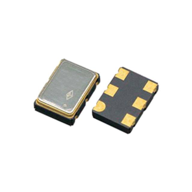

    有源晶振 3.3V 320MHz SMD-6
OTETGCVANF-320.000000 数据手册
OT Type 7.0 x 5.0 mm SMD LVPECL/LVDS/ HCSL Crystal Oscillator Actual Size FEATURE - Typical 7.0 x 5.0 x 1.45 mm hermetically sealed ceramic package. - Very low jitter performance: typical 0.3 pS RMS from 12k-20MHz. - Fundamental/3rd overtone crystal design. - Output frequency up to 320 MHz. - Operating temperature up to 125。C - Tri-state enable/disable RoHS Compliant TYPICAL APPLICATION - 10Gbit Ethernet, Fiber Channel, Storage Area Network, SONET - Enterprise Servers, Reference clocks for ADC and DAC - Telecom OT multiplier SOLDER PAD L AYOUT (mm) DIMENSION (mm) [ TOP VIEW ] [ BOTTOM VIEW ] 5.08±0.20 #4 #4 #5 #6 5.08 #2 #3 #3 #2 1.10±0.20 5.00±0.20 #1 #1 0.1µF 1.40±0.20 0.6 1.45±0.15 [ SIDE VIEW ] Pin# 1 2 3 4 5 6 4.00 #5 3.70±0.20 #6 2.00 7.00±0.20 Function NC/Tri-State Tri-State/NC GND Output Comp.output VDD 1.80 To ensure optimal oscillator performance, place a by-pass capacitor of 0.1μF as close to the part as possible between Vdd and GND pads. ELECTRICAL SPECIFICATION Parameter Supply Voltage Variation (VDD) Frequency Range Standard Frequency Supply Current 10 MHz Fo < 160 MHz 160 MHz Fo < 250 MHz 250 MHz Fo 320 MHz Output High Output Level Output Low Transition Time: Rise/Fall Time+ Start Time Tri-State(Input to Pin 2 or Pin 1) Enable (High voltage or floating) Disable (Low voltage or GND) RMS Phase Jitter (Integrated 12 KHz ~ 20 MHz) Fo < 80 MHz 80 MHz Fo
