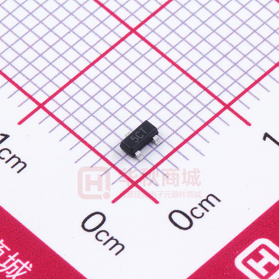

    通用三极管 SOT23-3 PNP VCEO=45V VCE(sat)=0.7V Ic=0.5A PD=300mW
BC807-40 数据手册
BC807/BC808 PNP Transistor Features  SOT-23 For Switching and AF Amplifier Applications. Equivalent Circuit 1.Base 2.Emitter 3.Collector 3.Collector Marking Code : BC807-16 : 5CR BC808-16 : 5CW BC807-25 : 5CS BC808-25 : 5CX BC807-40 : 5CT BC808-40 : 5CY 1.Base 2.. Emitter Absolute Maximum Ratings Ratings at 25℃ ambient temperature unless otherwise specified. Parameter Collector Base Voltage Symbol BC807 BC808 Collector Emitter Voltage BC807 BC808 Emitter Base Voltage -VCBO -VCEO Value 50 30 45 25 Unit V V -VEBO 5 V Collector Current -IC 500 mA Maximum Power Dissipation PD 300 mW Junction Temperature TJ 150 ℃ TSTG -55 to +150 ℃ Storage Temperature Range www.pingjingsemi.com Revision:2.0 Mar-2021 1/6 BC807/BC808 PNP Transistor Electrical Characteristics (TA=25℃) Parameter Symbol Min. Tpy. Max. Unit 100 -- 250 160 -- 400 250 -- 600 40 -- -- -ICBO -- -- 100 nA -IEBO -- -- 100 nA -VCE(sat) -- -- 0.7 V -VBE(on) -- -- 1.2 V FT 80 -- -- MHz Cob -- 9 -- pF DC Current Gain at VCE = -1 V, IC = -100 mA Gain Group -16 -25 HFE -40 at VCE = -1 V, IC = -500 mA Collector Base Cutoff Current at VCB = -20V Emitter Base Cutoff Current at VEB = -5 V Collector Emitter Saturation Voltage at IC = -500 mA, IB = -50 mA Base Emitter On Voltage at VCE = -1 V, IC = -500 mA Transition Frequency at VCE = -5 V, IC = -10 mA, f = 50 MHz Output Capacitance at VCB = -10 V, f = 1 MHz www.pingjingsemi.com Revision:2.0 Mar-2021 -- 2/6 BC807/BC808 PNP Transistor Typical Characteristic Curves Common Emitter VCE = -1V Collector Current IC (mA) DC Current hFE Common Emitter VCE = -1V Ta =25℃ Base-Emitter Voltage VBE (V) Common Emitter VCE = -1V IC/IB = -10 Collector Current IC (mA) www.pingjingsemi.com Revision:2.0 Mar-2021 Power Dissipation PD (mW) Collector Emitter Saturation Voltage VCE(sat) (V) Collector Current IC (mA) Ambient Temperature Ta (℃) 3/6 BC807/BC808 PNP Transistor Package Outline SOT-23 Dimensions in mm Ordering Information Device Package Shipping BC807/BC808 SOT-23 3,000PCS/Reel&7inches www.pingjingsemi.com Revision:2.0 Mar-2021 4/6 BC807/BC808 PNP Transistor Conditions of Soldering and Storage  Recommended condition of reflow soldering Recommended peak temperature is over 245 OC. If peak temperature is below 245 OC, you may adjust the following parameters:  Time length of peak temperature (longer)  Time length of soldering (longer)  Thickness of solder paste (thicker)  Conditions of hand soldering  Temperature: 370 OC  Time: 3s max.  Times: one time   Storage conditions Temperature 5 to 40 OC  Humidity 30 to 80% RH  Recommended period One year after manufacturing www.pingjingsemi.com Revision:2.0 Mar-2021 5/6 BC807/BC808 PNP Transistor Package Specifications  The method of packaging Cover Tape 3,000 pcs per reel SOT-23 Carrier Tape 30,000 pcs per box 10 reels per box 120,000 pcs per carton 4 boxes per carton  Embossed tape and reel data D A T2 T1 Symbol A B C E F D T1 T2 B C E Value (unit: mm) Ø 177.8±1 2.7±0.2 Ø 13.5±0.2 Ø 54.5±0.2 12.3±0.3 9.6+2/-0.3 1.0±0.2 1.2±0.2 F Reel (7'') www.pingjingsemi.com Revision:2.0 Mar-2021 6/6
