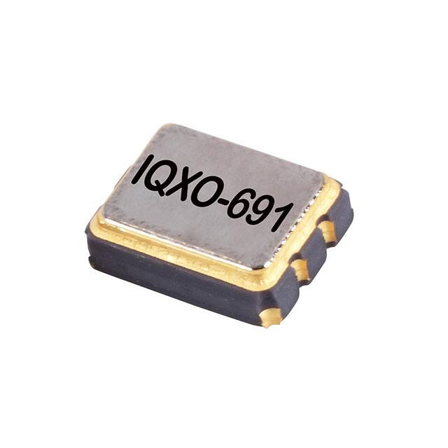

Crystal Clock Oscillator Specification Part No. + Packaging: LFSPXO076032Reel Customer Part: Description 0.9V low voltage oscillator in a hermetically sealed 3.2 x 2.5mm surface mount ceramic package. Model IQXO-691 3225-09 Model Issue number 2 Frequency Parameters Frequency 40.0MHz Frequency Stability ±50.00ppm Operating Temperature Range Ageing -40.00 to 85.00°C ±3ppm max in 1st year @ 25°C Electrical Parameters Supply Voltage Current Draw 0.9V ±5% 10.000mA Output Details Output Compatibility Drive Capability Rise and Fall Time Duty Cycle Output Voltage Levels: Output Low (VoL): 10%Vs max Output High (VoH): 90%Vs min Start Up Time: 10ms max Outline (mm) CMOS 15pF max 5.0ns max 45/55% Output Control Standby Operation: Logic ‘1’ (≥70% Vs) to pad 1 enables oscillator output. Logic ‘0’ (≤30% Vs) to pad 1 disables oscillator output; when disabled the oscillator output goes to the high impedance state. No connection to pad 1 enables oscillator output (internal pull-up resistor). Standby Current: 100μA max Recommended Solder Pad Layout Noise Parameters RMS Phase Jitter (12kHz to 20MHz): 1ps max Environmental Parameters Storage Temperature Range: -55 to 125°C Mechanical Shock: MIL-STD-883, Method 2002, Condition B. Vibration: MIL-STD-883, Method 2007, Condition A. Moisture Resistance: MIL-STD-883, Method 1004. Thermal Cycling: MIL-STD-883, Method 1010, Condition B. Solderability: MIL-STD-883, Method 2003. Resistance to Soldering Heat: MIL-STD-202, Method 210, Condition K. Fine Leak Test: MIL-STD-883, Method 1014, Condition A. Gross Leak Test: MIL-STD-883, Method 1014, Condition C. Manufacturing Details Note: Please connect a bypass capacitor of 0.1μF between +Vs and circuit ground. RoHS Terminations Au RoHS Reflow Temp 260°C max for 10secs max Sales Office Contact Details: UK: +44 (0)1460 270200 France: 0800 901 383 Germany: 0800 1808 443 USA: +1.760.318.2824 Printed on 3 Aug 21 17:17 using Part Data Sheet V1.0018 Email: info@iqdfrequencyproducts.com Web: www.iqdfrequencyproducts.com Page 1 of 2 Crystal Clock Oscillator Specification Part No. + Packaging: LFSPXO076032Reel Customer Part: Compliance RoHS Status (2015/863/EU) REACh Status MSL Rating (JDEC-STD-033): Compliant Compliant 1 Packaging Details Pack Style: Reel Pack Size: 3,000 Tape & reel in accordance with EIA-481D Alternative packing option available Sales Office Contact Details: UK: +44 (0)1460 270200 France: 0800 901 383 Germany: 0800 1808 443 USA: +1.760.318.2824 Printed on 3 Aug 21 17:17 using Part Data Sheet V1.0018 Email: info@iqdfrequencyproducts.com Web: www.iqdfrequencyproducts.com Page 2 of 2
