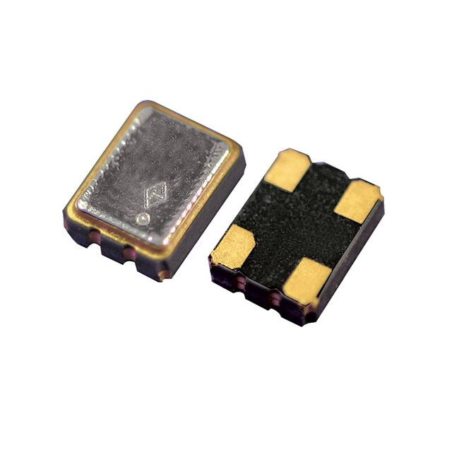

    有源晶振 1.8V 37.125MHz SMD-4
OXKTGCJANF-37.125000 数据手册
OX Type 3.2 x 2.5 mm SMD Crystal Oscillator Actual Size FEATURE - Typical 3.2 x 2.5 x 0.95mm Ceramic SMD Package - Tight Symmetry (45 to 55%) Available - Operation Voltage: 1.8V, 2.5V, 3.3V - Tri-State Enable/Disable TYPICAL APPLICATION - WLAN/WiMAX - Mobile Phone - DSC, Set-Top Box, HDTV RoHS Compliant DIMENSION (mm) SOLDER PAD L AYOUT (mm) [ TO P VIEW ] 2.10 ± 0.15 #2 #2 #1 1.60 1.65 ± 0.15 2.50 ± 0.15 #1 #4 1.10 #3 #3 0.65 ± 0.15 3.20 ± 0.15 #4 0.1 μF [ B O T T O M V IE W ] 2.10 0.90 ± 0.15 Pin# 0.35 0.95 ± 0.15 [ S ID E V IE W ] 1 2 3 4 Function 1.20 Tri-state GND Output VDD To ensure optimal oscillator performance, place a by-pass capacitor of 0.1μF as close to the part as possible between Vdd and GND pads. ELECTRICAL SPECIFICATION 3.3V Parameter Supply Voltage Variation (VDD) Frequency Range 2.5V Min. Max. Min. Max. VDD-5% VDD+5% VDD-5% VDD+5% VDD-5% VDD+5% V 1.25 125 1.25 125 1.25 125 MHz - 15 - 10 - 7 mA - 1.5 - 1.5 - 1.2 mA mA 24, 26, 30, 40 At 15pF Load Fo < 10MHz No Load Condition, 1.25MHz Current Unit Max. Standard Frequency Supply 1.8V Min. MHz No Load Condition, 10MHz Fo < 20MHz - 2 - 2 - 1.5 No Load Condition, 20MHz Fo < 80MHz - 3 - 2.5 - 1.5 mA No Load Condition, 80MHz Fo < 125MHz - 8 - 7 - 5 mA Duty Cycle Output Level 45 55 45 55 45 55 % Output High 2.97 - 2.25 - 1.62 - V Output Low - 0.33 - 0.25 - 0.18 V - 3 - 4 - 5 nSec Fo < 10MHz 1.25MHz Transition Time: 10MHz Fo < 20MHz - 3 - 3 - 4 nSec Rise / Fall Time+ 20MHz Fo < 80MHz - 3 - 3 - 4 nSec 80MHz Fo < 125MHz - 3 - 3 - 4 nSec - 2 - 2 - 2 mSec 2.31 - 1.75 - 1.26 - V - 0.99 - 0.75 - 0.54 Startup Time Tri-State Enable (High Voltage or Floating) (Input to Pin 1) Disable (Low Voltage or GND) Output Loading 15 15 15 V pF Stand by Current (@-40oC to 85oC) - 10 - 10 - 10 Stand by Current (@-40oC to 125oC) - 20 - 20 - 20 Period Jitter (Pk-Pk) - 40 - 40 - 40 pSec RMS Phase Jitter (12kHz to 20MHz) - 1 - 1 - 1 pSec Aging (@ 25oC, 1st Year) - 3 - 3 - 3 ppm -55 +125 -55 +125 -55 +125 Storage Temp. Range A A o C Standard frequencies are frequencies which the crystal has been designed and does not imply a stock position +Transition times are measured between 10% and 90% of VDD,withan output load of 15pF FREQ. STABILITY vs. TEMP. RANGE ppm Temp.( oC) -10~+60 -20~+70 -40~+85 ±20 25 50 * O: Available △:Conditional X: Not available *Inclusive of calibration @ 25℃, operating temperature range, input voltage variation, st load variation, aging (1 year), shock, and vibration load variation Note: not all combination of options are available. Other specifications may be available upon request. 34 Specifications subject to change without notice. www.taitien.com sales@taitien.com.tw Rev(12)08/2019
