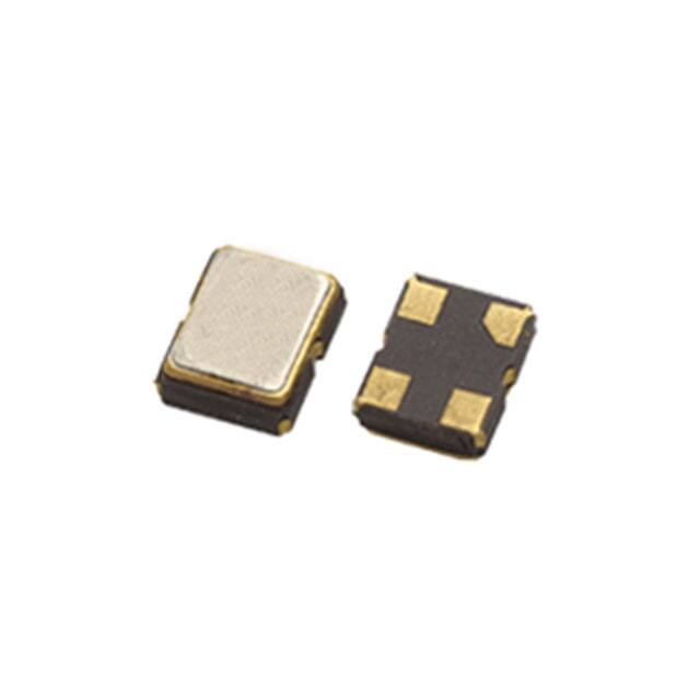

    有源晶振 4MHz 2.8V~3.3V SMD-4
PYETGCJANF-4.000000 数据手册
PY Type 2.5 x 2.0 mm SMD Crystal Oscillator Actual Size FEATURE - Typical 2.5 x 2.0 x 0.81 mm ceramic SMD package. Tight symmetry (45 to 55%) available. Operation voltage: 1.8V, 2.5V, 3.3V Tri-state enable/disable TYPICAL APPLICATION - Computer Peripherals - Set-top Box , HDTV - DSC, PDA RoHS Compliant DIMENSION (mm) SOLDER PAD L AYOUT (mm) 0.1µF #4 2.00±0.20 #1 #2 #2 [ SIDE VIEW ] Pin# 1 2 3 4 0.81±0.15 0.29 #1 0.675±0.10 1.225 #3 #3 1.625±0.10 1.225±0.10 #4 [ BOTTOM VIEW ] 0.80 2.50±0.20 0.57±0.10 [ TOP VIEW ] 0.675 1.625 Function Tri-State GND Output VDD 0.90 To ensure optimal oscillator performance, place a by-pass capacitor of 0.1μF as close to the part as possible between Vdd and GND pads. ELECTRICAL SPECIFICATION Parameter Min. 3.3 V VDD-10% Supply Voltage Variation (VDD) Frequency Range 1 VDD Sensitivity (±10 %) Supply Current 1 MHz Fo < 30 MHz 30 MHz Fo < 75 MHz 75 MHz Fo < 133 MHz 133 MHz Fo < 166 MHz 166 MHz Fo 200 MHz -2 Duty Cycle Output Level (CMOS) Output High (Logic “1”) Output Low (Logic “0”) Transition Time:Rise/Fall Time+ 45 2.97 _ 1 MHz 10 MHz _ _ _ _ _ Fo < 10 MHz Fo Startup Time Tri-State(Input to Pin 1) Enable (High voltage or floating) Disable (Low voltage or GND) Period Jitter(Pk-Pk) Specific Frequency” Others _ _ _ 2.31 _ _ _ _ Aging ( @ 25°C 1st year) Storage Temp. Range -55 Max. Min. 200 1 2.5 V VDD+10% VDD-10% 2 -2 10 12 15 18 20 55 _ 0.33 3 2 8 _ 0.99 40 200 ±3 125 Max. Min. 166 1 1.8 V Max. VDD+10% VDD-10% unit VDD+10% 110 V MHz ppm 2 -2 _ _ _ _ _ 8 10 12 15 _ _ _ _ _ _ 6 8 10 _ _ mA 45 2.25 _ 55 _ 45 1.62 _ 55 _ % _ _ _ 1.75 _ _ _ _ -55 0.25 4 3 8 _ 0.75 40 200 ±3 125 _ _ _ 1.26 _ _ _ _ -55 2 0.18 5 4 8 _ 0.54 40 200 ±3 125 V nSec mSec V pSec ppm °C Standard frequencies are frequencies which the crystal has been designed and does not imply a stock position. + Transition times are measured between 10% and 90% of VDD, with an output load of 15pF. Specific frequncy including 4.0, 13.0, 22.0, 26.0, and 40.0MHz FREQ. STABILITY vs. TEMP. RANGE Temp. (°C) ppm ±25 ±50 ○: Available △:Conditional X: Not available * -40 ~ +85 * Inclusive of calibration @ 25 °C, operating temperature range, input voltage variation, load variation, aging (1st year), shock, and vibration -20 ~ +70 40 ±20 -10 ~ +60 Specifications subject to change without notice. www.taitien.com sales@taitien.com.tw Rev(13)01/2020
PYETGCJANF-4.000000
物料型号:PY Type 2.5 x 2.0 mm SMD Crystal Oscillator
器件简介:这是一个典型的2.5 x 2.0 x 0.81 mm尺寸的陶瓷SMD封装的晶体振荡器,具有紧对称性(45%到55%)和三态使能/禁用功能。它适用于电脑外设、机顶盒、高清电视、数字相机、个人数字助理等应用。
引脚分配:1号引脚为三态引脚,2号引脚为地,3号引脚为输出,4号引脚为电源。
参数特性:工作电压为1.8V、2.5V、3.3V,频率范围从1MHz到200MHz,具有不同的供电电流和输出电平,以及占空比、上升/下降时间、启动时间和三态输入特性。
功能详解:为了确保最佳振荡器性能,应在VDD和GND焊盘之间尽可能靠近器件放置一个0.1μF的旁路电容器。
应用信息:适用于电脑外设、机顶盒、高清电视、数字相机、个人数字助理等。
封装信息:尺寸为2.5 x 2.0 x 0.81 mm,符合RoHS标准。
