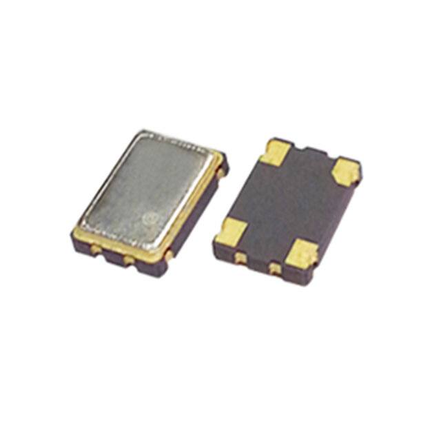

    有源晶振 20MHz 1.8V SMD-4
OCKTGLJANF-20.000000 数据手册
OC Type 7.0 x 5.0 mm SMD Crystal Oscillator Actual Size FEATURE - Typical 7.0 x 5.0 x 1.3 mm ceramic SMD package. - Output frequency up to 166MHz - Tri-state enable/disable. TYPICAL APPLICATION - xDSL, WLAN, Fiber/10G-Bit Ethernet - Notebook, PDA - PC main board, VGA card RoHS Compliant DIMENSION (mm) SOLDER PAD L AYOUT (mm) [ BOTTOM VIEW ] [ TOP VIEW ] 5.08±0.20 5.00±0.20 #1 #2 1.40±0.20 #2 1.30±0.20 [ SIDE VIEW ] Pin# 1 2 3 4 5.08 #4 #1 0.1µF 4.00 #3 2.00 #3 3.70±0.20 #4 1.10±0.20 7.00±0.20 Function Tri-State GND Output VDD 1.80 To ensure optimal oscillator performance, place a by-pass capacitor of 0.1μF as close to the part as possible between Vdd and GND pads. ELECTRICAL SPECIFICATION 3.3V Parameter 2.5V Max. Min. 1.8V Max. Supply Voltage Variation(VDD) VDD -10% VDD+10% VDD -10% VDD+10% VDD -10% VDD+10% Frequency Range 0.0137 166 0.0137 133 0.0137 125 Standard Frequency 2.048, 25, 26, 27, 50, 66, 667, 100, 125 Supply Current _ _ _ 1 13.7 kHz Fo 70 kHz 1 1 _ _ _ 10 0.3125 MHz Fo < 35.328 MHz (A1) 7 8 _ _ _ 20 30 MHz Fo < 75 MHz 15 18 _ _ _ 35 75 MHz Fo < 133 MHz 25 30 _ _ _ _ 45 133 MHz Fo 40 _ _ _ 2.97 2.25 1.62 Output Level (CMOS) Output High (Logic “1”) _ _ _ Output Low (Logic “0”) 0.33 0.25 0.18 Transition Time:Rise/Fall Time _ _ _ 13.7 kHz Fo 70 kHz 50 50 50 _ _ _ 0.3125 MHz Fo < 100 MHz 5 5 5 _ _ _ 100 MHz Fo 3 3 3 _ _ _ 5 5 Start Time 5 _ _ _ 15 Output Drive Capability (CL) 15 15 _ _ _ Tri-State (Input to Pin1) Enable (High voltage or floating) 2.31 1.75 1.26 _ _ _ Disable (Low voltage or GND) 0.99 0.75 0.54 _ _ _ Period Jitter(Pk-Pk) 40 40 40 _ _ _ RMS Phase Jitter (Integrated 12 kHz~20 MHz) 1 1 1 _ _ Standby Current 10 10 10 _ _ _ Aging (@ 25°C 1st year) ±3 ±3 ±3 Storage Temp. Range -55 125 -55 125 -55 125 Min. Max. Min. unit V MHz mA V nSec mSec pF V pSec pSec µA ppm °C Standard frequencies are frequencies which the crystal has been designed and does not imply a stock position. + Transition times are measured between 10% and 90% of VDD, with an output load of 15pF. FREQ. STABILITY vs. TEMP. RANGE Temp. (°C) ppm -10 ~ +60 -20 ~ +70 -40 ~ +85 ±20 ±25 ±50 * ○: Available △:Conditional X: Not available * Inclusive of calibration @ 25 °C, operating temperature range, input voltage variation, load variation, aging (1st year), shock, and vibration -40 ~ +125 Note: not all combination of options are available. Other specifications may be available upon request. Specifications subject to change without notice. www.taitien.com sales@taitien.com.tw Rev(32)08/2019 37
