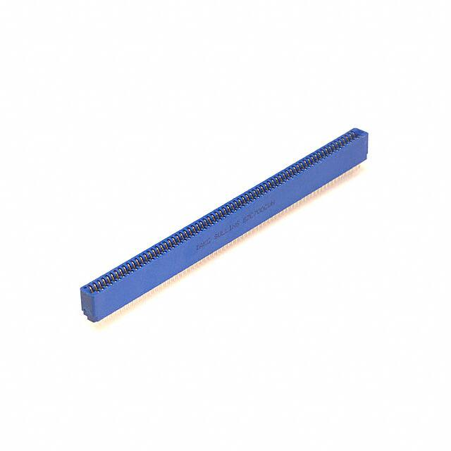

Female Card Edge .100” [2.54 mm] Contact Centers, .610” [15.49 mm] Insulator Height, Dip Solder/Wire Wrap/Right Angle/Card Extender SPECIFICATIONS • Accommodates .062” ± .008” [1.57 mm ± 0.20 mm] mating PCB (For .093” [2.36 mm] or .125” [3.18 mm] mating PCB see following pages) • PBT, PPS or PA9T insulator • Molded-in key available • 3 Amps current rating for one contact energized • 30 milli Ohms maximum at rated current READOUT • UL Flammability Rating: 94V-0 POLARIZING KEY PLC-K1 .038” [0.97] .285” [7.24] EVEN NUMBER SIDE Female Card Edge DUAL (D) .100” [2.54] KEY IN BETWEEN CONTACTS (ORDER SEPARATELY) HALF LOADED (H) TERMINATION TYPE POST LENGTH FITS MIN. L HOLE SIZE .025” [0.64] .015ʺ X .025ʺ[0.38 X 0.64] .125ʺ [3.18] .035ʺ [0.89] HAIRPIN TERMINATION BELLOWS TYPE CW POST CROSS SECTION K DIP SOLDER DIP SOLDER .015ʺ X .025ʺ[0.38 X 0.64] DIP SOLDER .025ʺ [0.64] SQUARE WIRE WRAP .025ʺ [0.64] SQUARE RIGHT ANGLE .025ʺ [0.64] SQUARE RIGHT ANGLE .025ʺ [0.64] SQUARE RIGHT ANGLE .025ʺ [0.64] SQUARE CT CS CM CA CB CC LOOP TERMINATION BELLOWS TYPE TK,CK RS RM TA TB TM POST CROSS SECTION K .025ʺ [0.64] ROUND .025ʺ [0.64] SQUARE .025ʺ [0.64] SQUARE .025ʺ [0.64] SQUARE .025ʺ [0.64] SQUARE .025ʺ [0.64] SQUARE DIP SOLDER DIP SOLDER WIRE WRAP RIGHT ANGLE RIGHT ANGLE RIGHT ANGLE POST CROSS SECTION CANTILEVER TERMINATION TYPE K .170ʺ .160ʺ .560ʺ .100ʺ .180ʺ .250ʺ [4.32] [4.06] [14.20] [2.54] [4.57] [6.35] POST LENGTH L .025”ʺ [0.64] .190ʺ [4.83] .190ʺ [4.83] .560ʺ [14.20] .100ʺ [2.54] .180ʺ [4.57] .250ʺ [6.35] .035ʺ .040ʺ .040ʺ .043ʺ .043ʺ .043ʺ [0.89] [1.02] [1.02] [1.09] [1.09] [1.09] FITS MIN. HOLE SIZE .033ʺ .040ʺ .040ʺ .043ʺ .043ʺ .043ʺ [0.84] [1.02] [1.02] [1.09] [1.09] [1.09] POST LENGTH L .025”ʺ [0.64] .190ʺ [4.83] .040ʺ [1.02] DIP SOLDER .025ʺ [0.64] SQUARE KD DIP SOLDER .025ʺ [0.64] SQUARE .160ʺ [4.06] .043ʺ [1.09] KM WIRE WRAP .025ʺ [0.64] SQUARE .560ʺ [14.20] .040ʺ [1.02] *KA RIGHT ANGLE .025ʺ [0.64] SQUARE .100ʺ [2.54] .043ʺ [1.09] *KE RIGHT ANGLE .025ʺ [0.64] SQUARE .180ʺ [4.57] .043ʺ [1.09] *KU RIGHT ANGLE .025ʺ [0.64] SQUARE .250ʺ [6.35] .043ʺ [1.09] RIGHT ANGLE .025ʺ [0.64] SQUARE .500ʺ [12.70] .043ʺ [1.09] *KR CARD EXTENDER .025ʺ [0.64] SQUARE .235ʺ [5.97] N/A *KN CARD EXTENDER .025ʺ [0.64] SQUARE .605ʺ [15.37] N/A *KJ L .030” [0.76] .275” [6.98] L K .200” [5.08] ODD NUMBER SIDE (CW, CT, CS, CM) .150” [3.81] K (CA, CB, CC, TA, TB, TM, KA, KE, KU, KJ) HAIRPIN or LOOP CARD EXTENDER LOOP BELLOWS L - .015” [0.38] L K .200” [5.08] (TK, CK, RS, RM) FITS MIN. HOLE SIZE KS RIGHT ANGLE HAIRPIN BELLOWS K ACCOMMODATES .062” [1.57] PCB (CT, CS, CM,TK, CK, RS,RM) Example P/N: EBC10DCSN-S288 (Requires -S288 Modification Code) CANTILEVER CARD EXTENDER CANTILEVER .550” [13.97] L L K .200” [5.08] (KS, KD, KM) K ACCOMMODATES .062” [1.57] PCB (KR, KN) Example P/N: EBC10DKRN (Omit Modification Code) * KA, KE, KU, KJ, KR, KN have no standoffs, unless requested. MOUNTING STYLE Ø.125” [3.18] #4-40 Ø.125” [3.18] .250” [6.35] CLEARANCE HOLE (H) 54 .245” [6.22] THREADED INSERT(I) SIDE MOUNTING (S) Ø.125” [3.18] D = .250” [6.35] W = .430” [10.92] NO MOUNTING EARS (N) FLUSH MOUNTING (D, W) #4-40 T = .250” [6.35] X = .430” [10.92] FLUSH MOUNTING WITH THREADED INSERT(T, X) www.sullinscorp.com | 760-744-0125 | toll-free 888-774-3100 | fax 760-744-6081 | info@sullinscorp.com Female Card Edge .100” [2.54 mm] Contact Centers, .610” [15.49 mm] Insulator Height, Dip Solder/Wire Wrap/Right Angle/Card Extender PART NUMBER OPTIONS E B C 70 D CM H - Sxxx All platings are Lead Free and have .000050” Nickel underplate Contact Surface Termination .000010” Gold .000100” Pure Tin, Matte .000030” Gold .000100” Pure Tin, Matte .000010” Gold .000005” Gold .000030” Gold .000005” Gold Contact Surface Overall Plating S = .000010” Gold .000010” Gold M = .000030” Gold .000010” Gold E = .000100” Pure Tin, Matte .000100” Pure Tin, Matte CONTACT CENTERS C = .100” [2.54 mm] NUMBER OF CONTACT POSITIONS See Chart Below READOUT (Opposite Page) D = Dual H = Half Loaded B C G Y = = = = DIMENSIONS Dimensions in [ ] are in millimeters, all others are in inches. .297 [7.54] INSERTION DEPTH C REFER TO MOUNTING STYLE .610 [15.49] .250[6.35] A B D E .060[1.52] CONTACT MARKINGS 1 3 5 . . . 137 139 2 4 6 . . . 138 140 .370 [9.40] .180[4.57] .100[2.54] TYP. F 1 3 5 7 9 131 133 135137 139 2 4 6 8 10 132 134 136 138 140 Female Card Edge MODIFICATION CODE (Consult Factory) OMIT FOR STANDARD -S189 = .200” [5.08 mm] Row to Row on Right Angle -S288* = Card Extender Accepts .062” [1.57 mm] PCB * Not Required on KR or KN Terminations MOUNTING STYLE (Opposite Page) H = Clearance Holes I = Threaded Inserts S = Side Mounting N = No Mounting D, W = Flush Mounting T, X = Flush Mounting With Threaded Inserts TERMINATION TYPE (Opposite Page) Hairpin Bellows - Available with B or C plating and Phosphor Bronze Only CS = .025” [0.64 mm] Square Dip Solder CM = .025” [0.64 mm] Square Wire Wrap CA, CB, CC = .025” [0.64 mm] Square Right Angle CW, CT = .015” X .025” [0.38 mm X 0.64 mm] Dip Solder Loop Bellows RS = .025” [0.64 mm] Square Dip Solder CK, TK = .025” [0.64 mm] Round Dip Solder RM = .025” [0.64 mm] Square Wire Wrap TA, TB, TM = .025” [0.64 mm] Square Right Angle Cantilever Bellows - Available in Y, B, or C plating Only KS, KD = .025” [0.64 mm] Square Dip Solder KM = .025” [0.64 mm] Square Wire Wrap KA, KE, KU, KJ = .025” [0.64 mm] Square Right Angle KR, KN = .025” [0.64 mm] Square Card Extender MATERIALS (INSULATOR/CONTACT) E = PBT/Phosphor Bronze (Standard) R = PPS/Phosphor Bronze G = PA9T/Phosphor Bronze H = PBT/Beryllium Copper A = PPS/Beryllium Copper J = PA9T/Beryllium Copper (Consult factory for other materials.) Refer to Page 7 for Operating/Processing Temperatures CONTACT FINISH - RoHS Compliant REFER TO TERMINATION TYPE Tolerances on non-critical dimensions may very slightly due to shrinkage differential per insulator material; Consult factory. INCHES MILLIMETERS POSITIONS/ CONTACTS 06/12 07/14 08/16 10/20 12/24 13/26 15/30 17/34 18/36 20/40 22/44 24/48 25/50 28/56 30/60 31/62 35/70 36/72 40/80 43/86 44/88 49/98* 50/100 55/110 60/120 61/122 65/130 70/140 80/160* 90/180* 100/200* A±.008 0.500 0.600 0.700 0.900 1.100 1.200 1.400 1.600 1.700 1.900 2.100 2.300 2.400 2.700 2.900 3.000 3.400 3.500 3.900 4.200 4.300 4.800 4.900 5.400 5.900 6.000 6.400 6.900 7.900 8.900 9.900 B±.008 0.700 0.800 0.900 1.100 1.300 1.400 1.600 1.800 1.900 2.100 2.300 2.500 2.600 2.900 3.100 3.200 3.600 3.700 4.100 4.400 4.500 5.000 5.100 5.600 6.100 6.200 6.600 7.100 8.100 9.100 10.100 C±.015 0.860 0.960 1.060 1.260 1.460 1.560 1.760 1.960 2.060 2.260 2.460 2.660 2.760 3.060 3.260 3.360 3.760 3.860 4.260 4.560 4.660 5.160 5.260 5.760 6.260 6.360 6.760 7.260 8.260 9.260 10.260 D±.010 1.175 1.275 1.375 1.575 1.775 1.875 2.075 2.275 2.375 2.575 2.775 2.975 3.075 3.375 3.575 3.675 4.075 4.175 4.575 4.875 4.975 5.475 5.575 6.075 6.575 6.675 7.075 7.575 8.575 9.575 10.575 E±.020 1.435 1.535 1.635 1.835 2.035 2.135 2.335 2.535 2.635 2.835 3.035 3.235 3.335 3.635 3.835 3.935 4.335 4.435 4.835 5.135 5.235 5.735 5.835 6.335 6.835 6.935 7.335 7.835 8.835 9.835 10.835 F±.015 0.750 0.850 0.950 1.150 1.350 1.450 1.650 1.850 1.950 2.150 2.350 2.550 2.650 2.950 3.150 3.250 3.650 3.750 4.150 4.450 4.550 5.050 5.150 5.650 6.150 6.250 6.650 7.150 8.150 9.150 10.150 A±0.20 12.70 15.24 17.78 22.86 27.94 30.48 35.56 40.64 43.18 48.26 53.34 58.42 60.96 68.58 73.66 76.20 86.36 88.90 99.06 106.68 109.22 121.92 124.46 137.16 149.86 152.40 162.56 175.26 200.66 226.06 251.46 B±0.20 17.78 20.32 22.86 27.94 33.02 35.56 40.64 45.72 48.26 53.34 58.42 63.50 66.04 73.66 78.74 81.28 91.44 93.98 104.14 111.76 114.30 127.00 129.54 142.24 154.94 157.48 167.64 180.34 205.74 231.14 256.54 C±0.38 21.84 24.38 26.92 32.00 37.08 39.62 44.70 49.78 52.32 57.40 62.48 67.56 70.10 77.72 82.80 85.34 95.50 98.04 108.20 115.82 118.36 131.06 133.60 146.30 159.00 161.54 171.70 184.40 209.80 235.20 260.60 D±0.25 29.85 32.39 34.93 40.01 45.09 47.63 52.71 57.79 60.33 65.41 70.49 75.57 78.11 85.73 90.81 93.35 103.51 106.05 116.21 123.83 126.37 139.07 141.61 154.31 167.01 169.55 179.71 192.41 217.81 243.21 268.61 E±0.51 36.45 38.99 41.53 46.61 51.69 54.23 59.31 64.39 66.93 72.01 77.09 82.17 84.71 92.33 97.41 99.95 110.11 112.65 122.81 130.43 132.97 145.67 148.21 160.91 173.61 176.15 186.31 199.01 224.41 249.81 275.21 F±0.38 19.05 21.59 24.13 29.21 34.29 36.83 41.91 46.99 49.53 54.61 59.69 64.77 67.31 74.93 80.01 82.55 92.71 95.25 105.41 113.03 115.57 128.27 130.81 143.51 156.21 158.75 168.91 181.61 207.01 232.41 257.81 * Consult factory for availability. www.sullinscorp.com | 760-744-0125 | toll-free 888-774-3100 | fax 760-744-6081 | info@sullinscorp.com 55

物料型号:SULLINS Female Card Edge Connector
器件简介:这是一种女性卡边连接器,具有2.54毫米的接触中心距离和15.49毫米的绝缘体高度。适用于浸焊/线绕/直角/卡扩展器。
引脚分配:文档中未明确列出具体的引脚分配,但提供了不同配置的接触位置和数量,例如6/12、7/14、8/16等,以及相应的尺寸。
参数特性: - 适用于1.57毫米±0.20毫米的配合PCB。 - 绝缘体材料为PBT、PPS或PA9T。 - 电流额定值为每接触3安培。 - 最大30毫欧姆电阻在额定电流下。 - UL阻燃等级94V-0。
功能详解: - 提供了多种终止类型,包括浸焊、线绕和直角。 - 提供了不同形状和尺寸的接触后截面和长度。 - 有模具内键可用,以确保正确的极性。
应用信息:适用于需要高电流和高可靠性的电子设备,如电源供应、信号传输等。
封装信息:提供了详细的尺寸信息,包括插入深度、接触标记和不同配置的尺寸公差。
